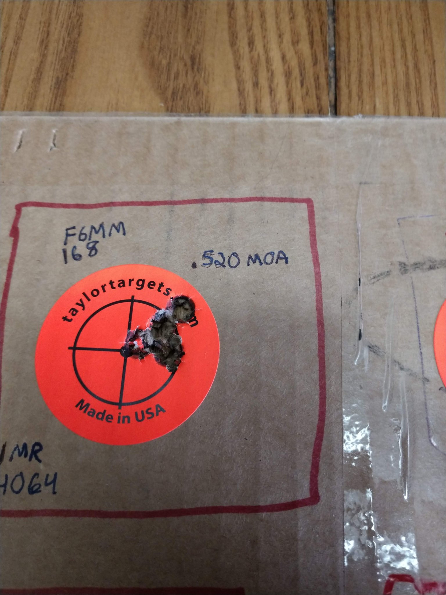

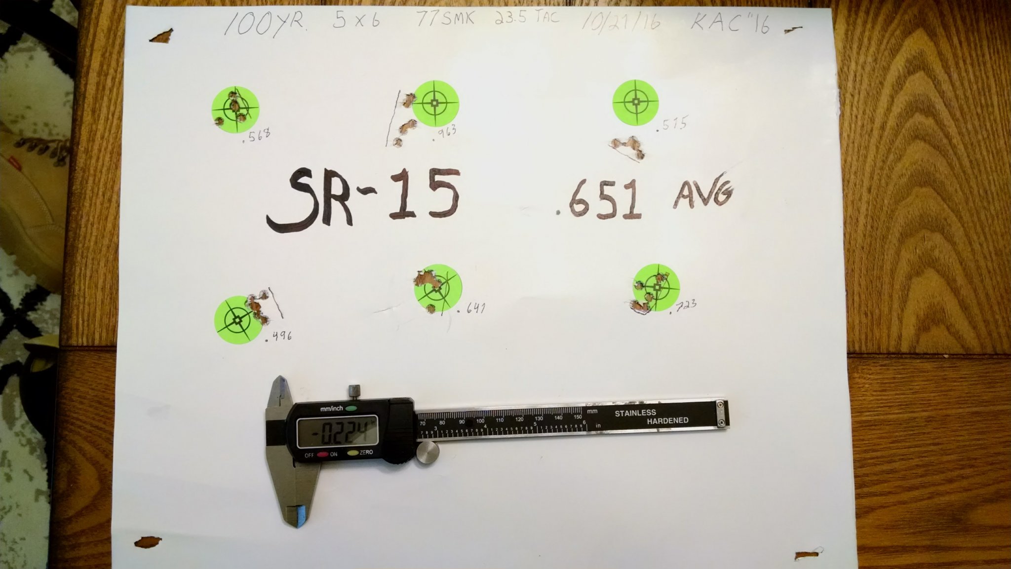

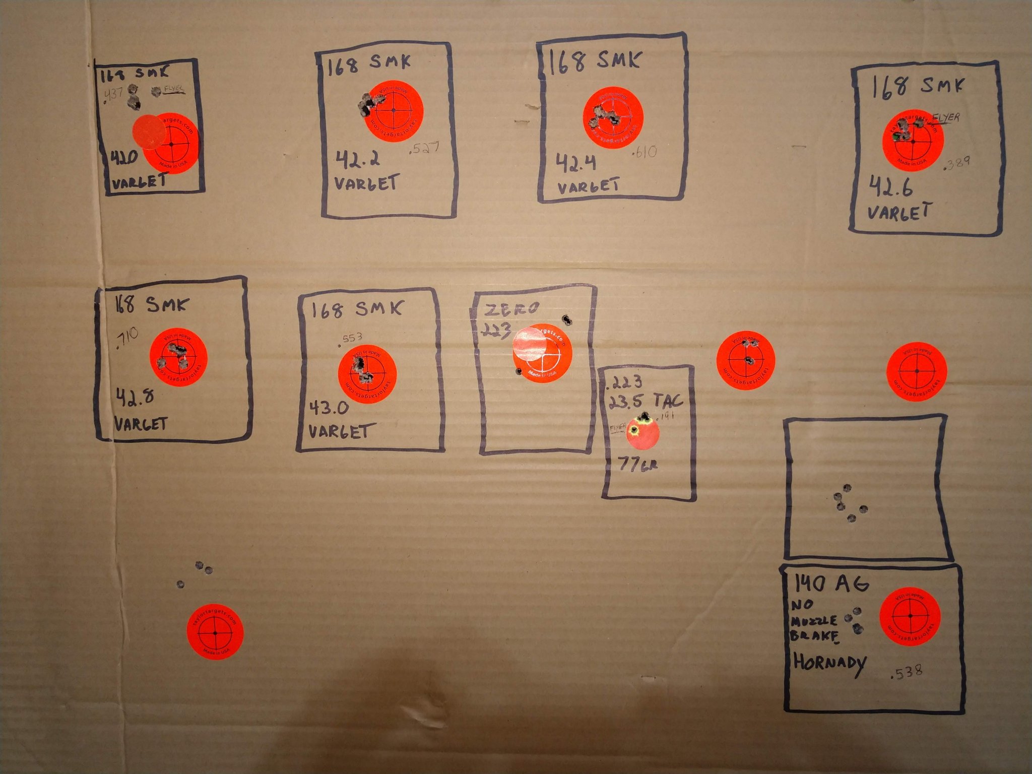

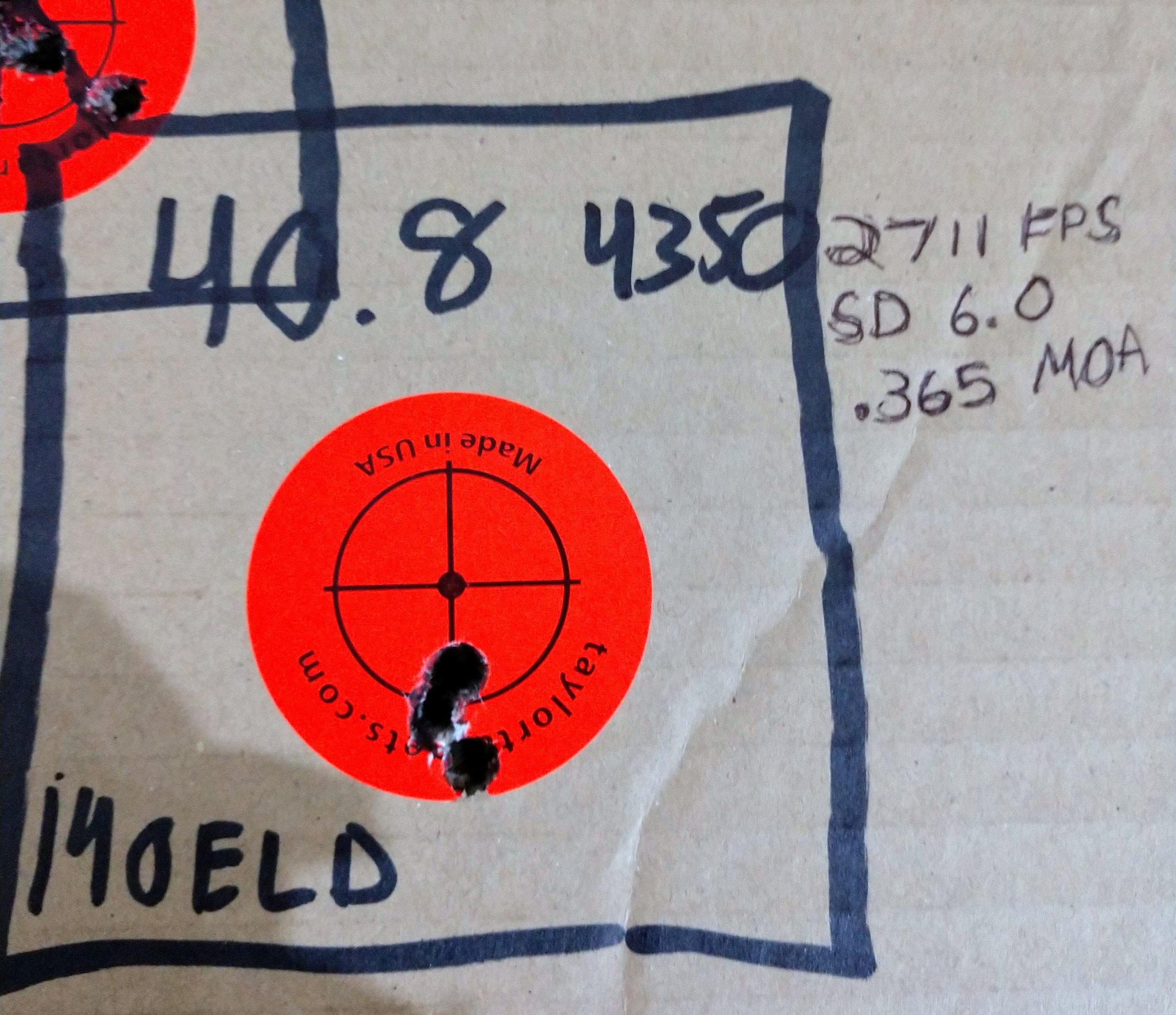

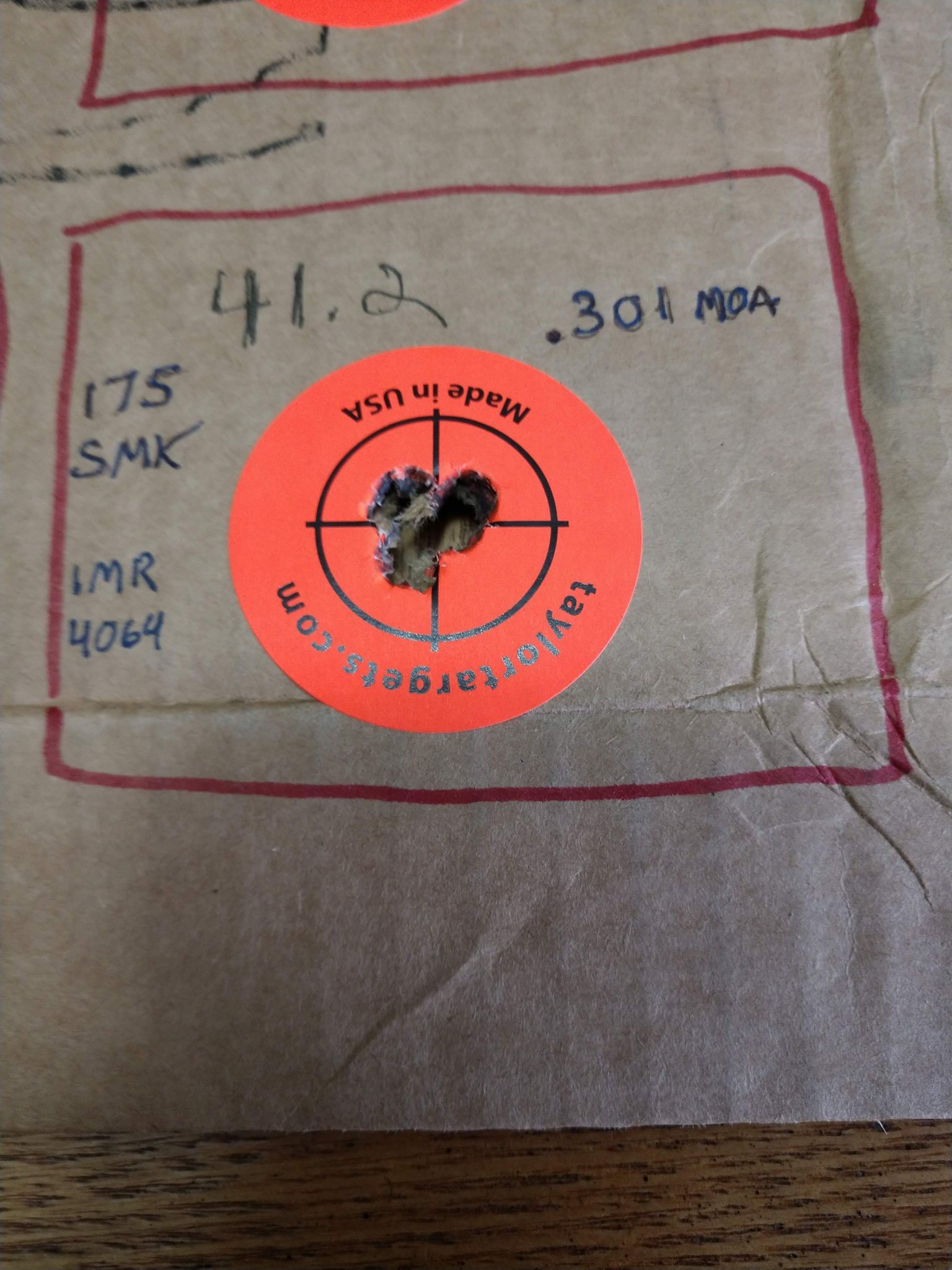

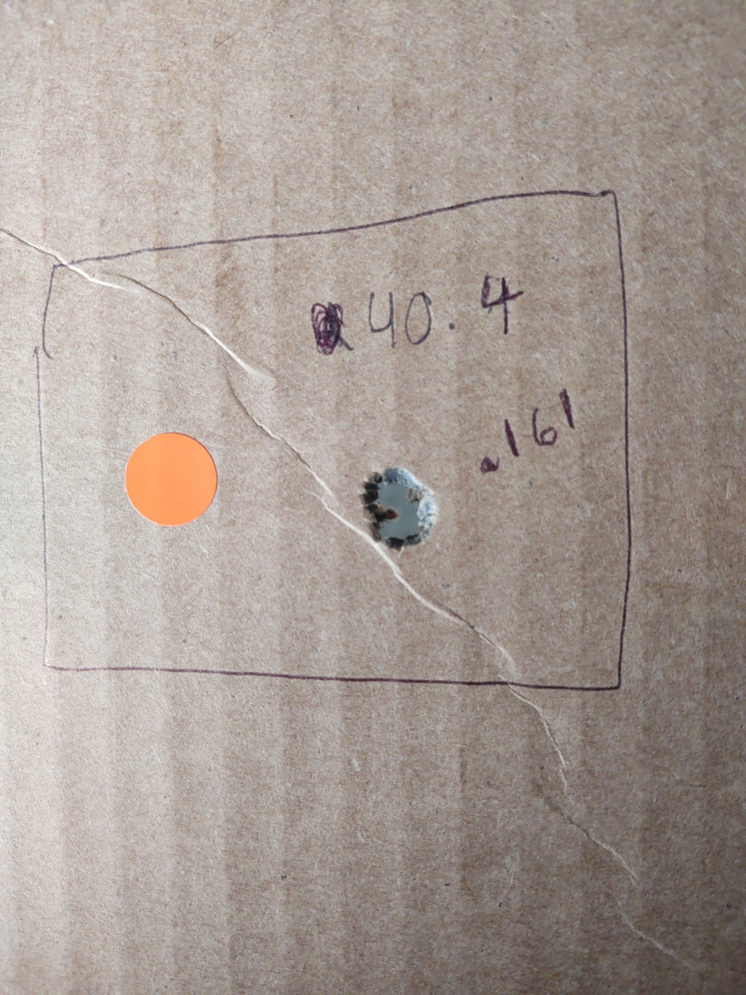

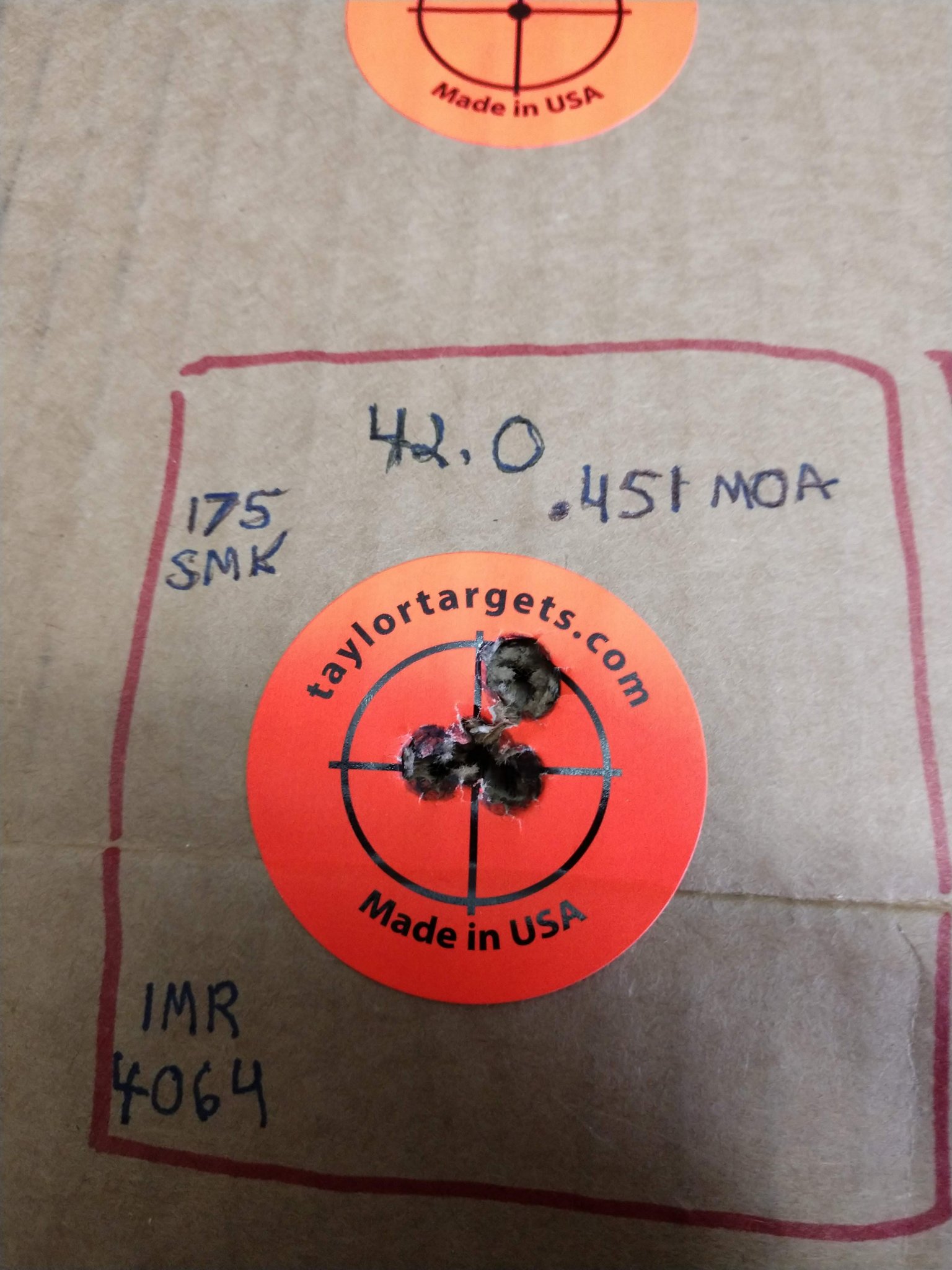

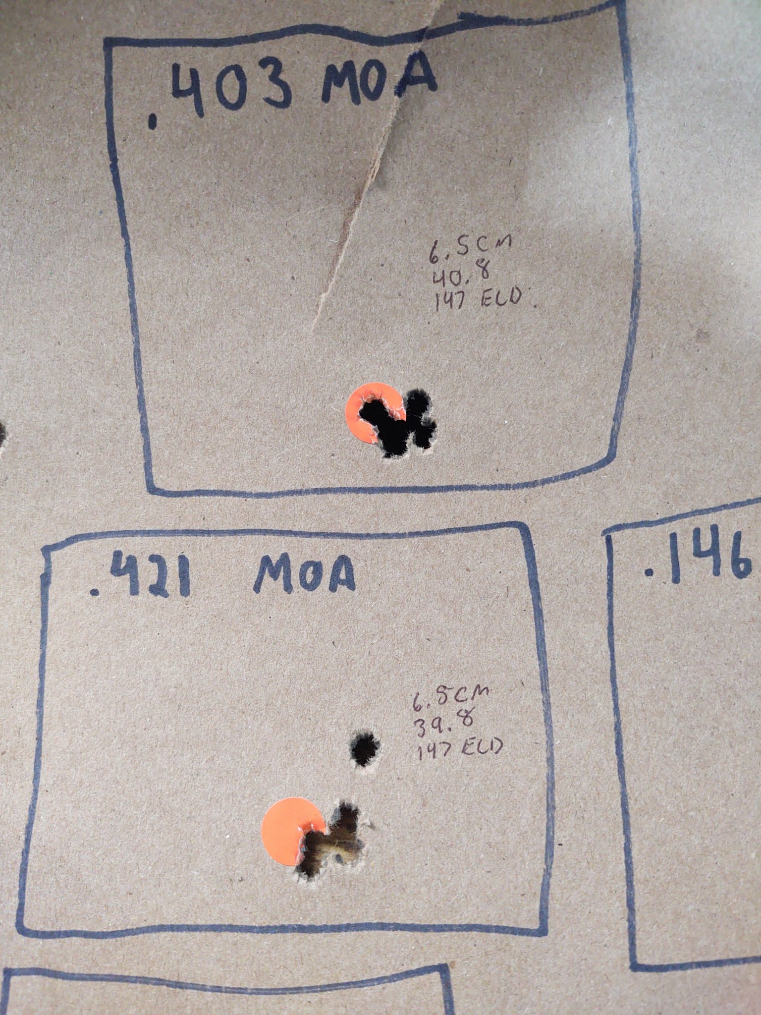

The rifles I make are all guaranteed to shoot sub 1/2 MOA. Achieving Sub Half MOA with a properly built Gasser and handloads isn't all that difficult.
6.5 Creedmoor.
.308
.223

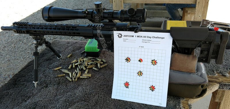

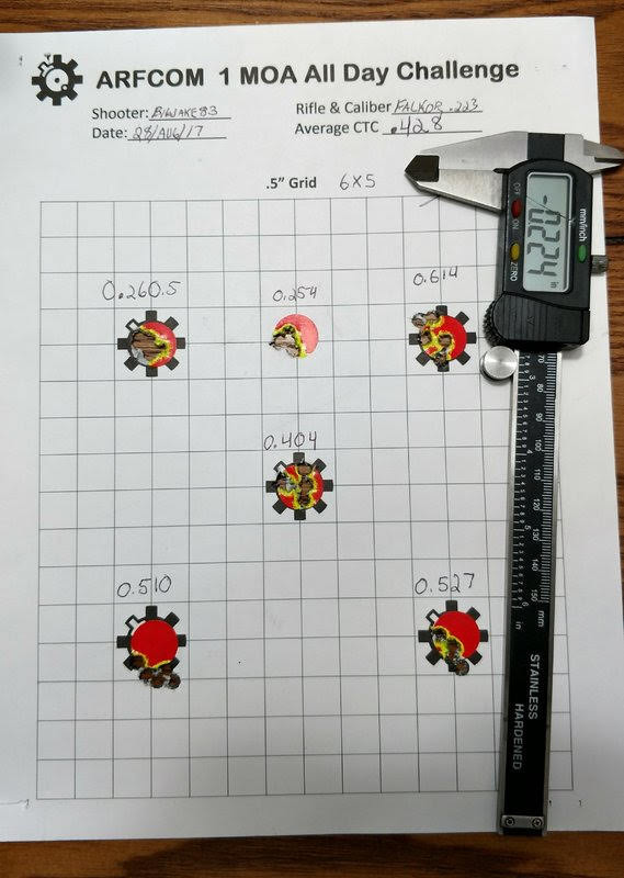

I really dont shoot the Mouse guns any more, I had a bunch of 6x5 .223 pics on my old phone but they didn't make the transfer.
My small frame is under 5 lbs, and is 1/2-2/3's with 53 eld's, out to 600 without wind. V-seven fluted lightweight 16". Some targets starting at post 42 in this thread...

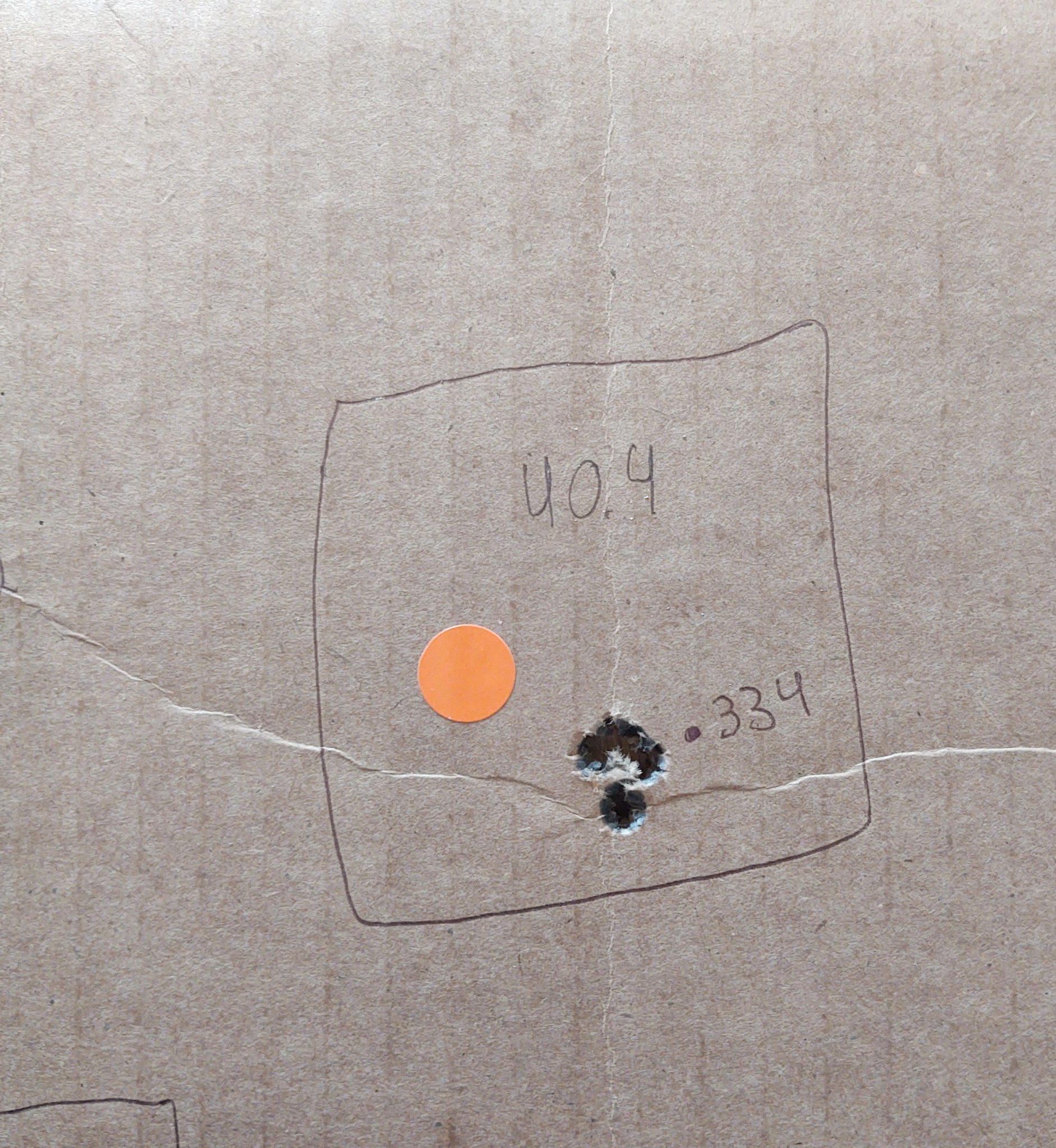

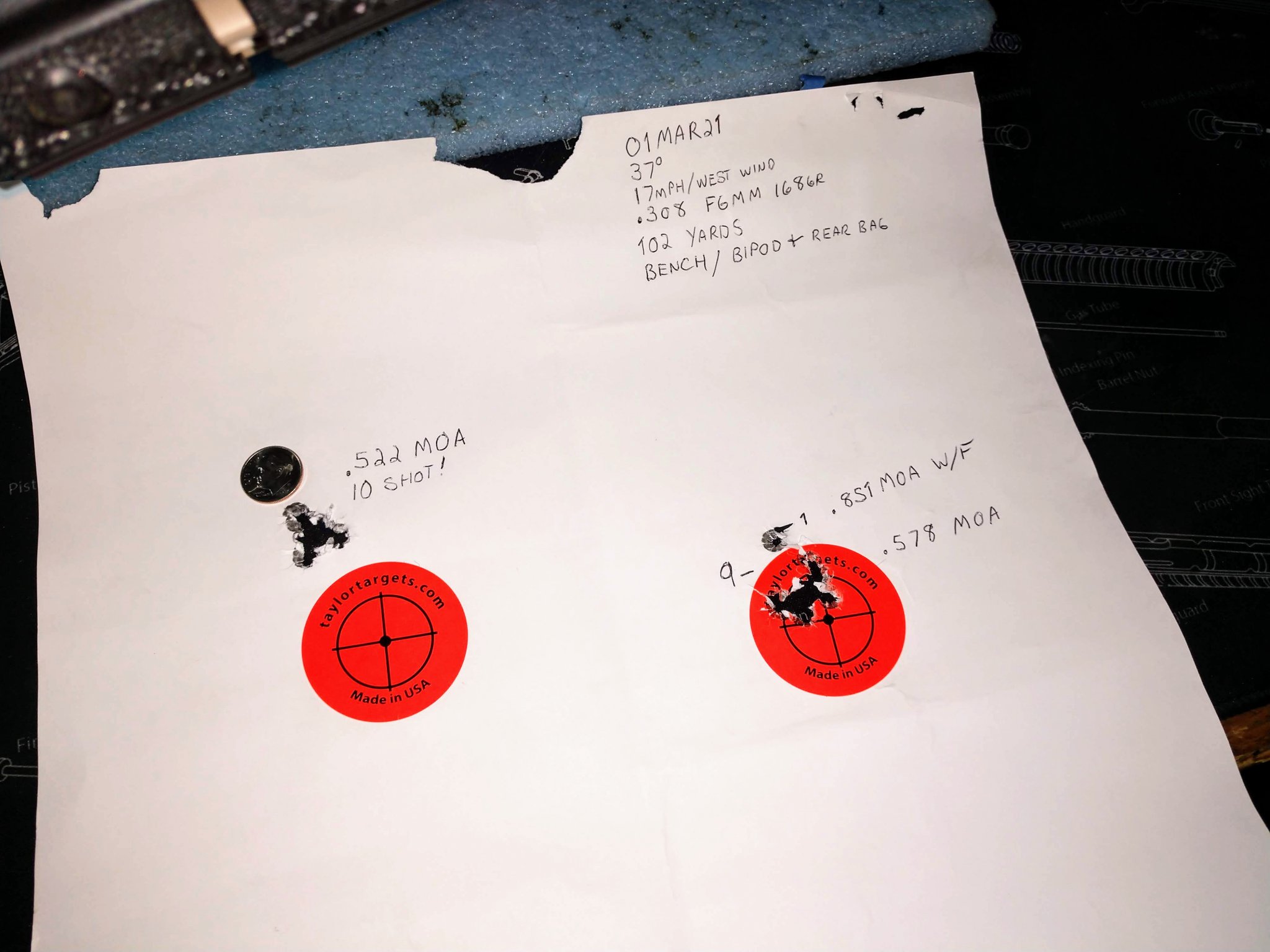

I've been using the 69SMK with 24.5gr RE15 or Varget with the 69 set to 2.28" for over 20 years. I don't use CHF or chromelined barrels but SS or Nitride with a Wylde chamber should do 1/2" easy.
I've used Kriegers DCM (20")short chambered barrels that you have to finish the chamber and crown for a long time. I have shot .151" and .176 groups at 100 with those barrels, yes best groups ever. I'm not that good, especially after coffee.
ETA GI mags should allow 2.28, pmags will not.
Vltor receivers, Geissele National Match triggers(lightest spring)

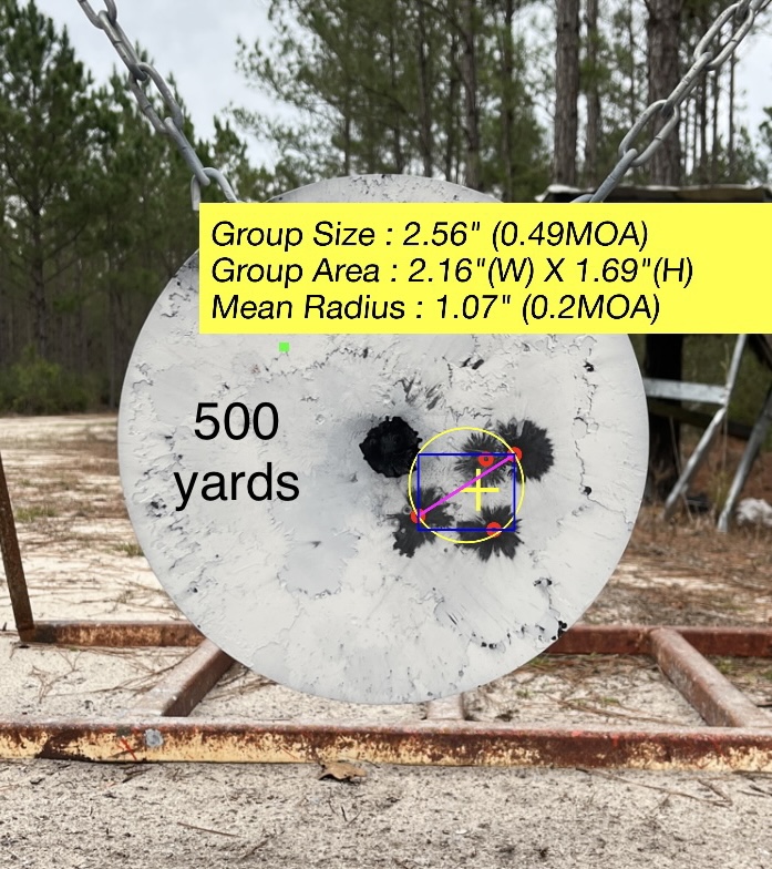

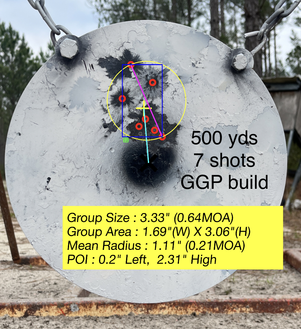

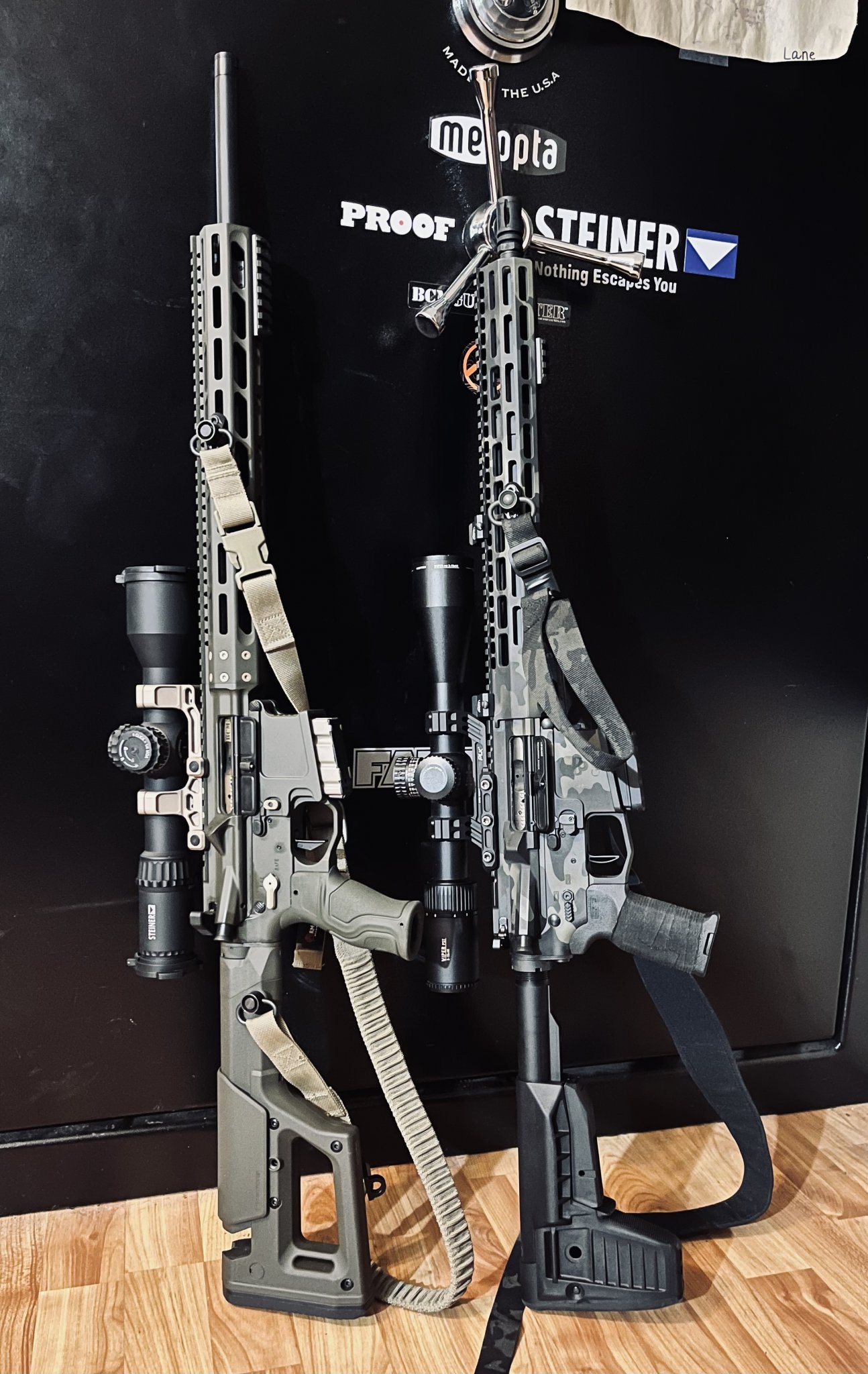

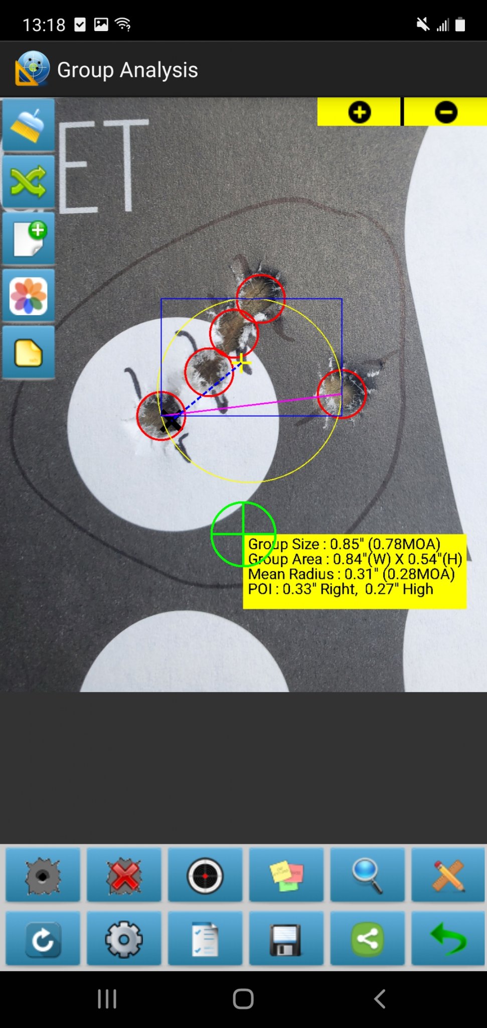

Im a novice compared to a lot of these guys with gas guns. But they are easy to get shooting right with good parts. Both guns are shooting 77gr SMK’s with TAC powder and no brass work other than FL sized and trimmed to length.
