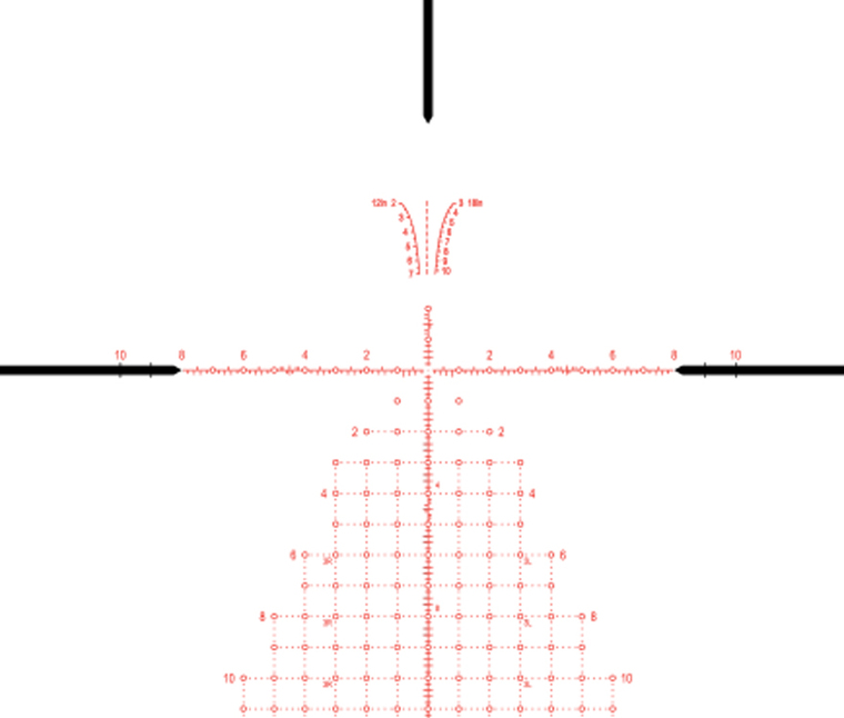

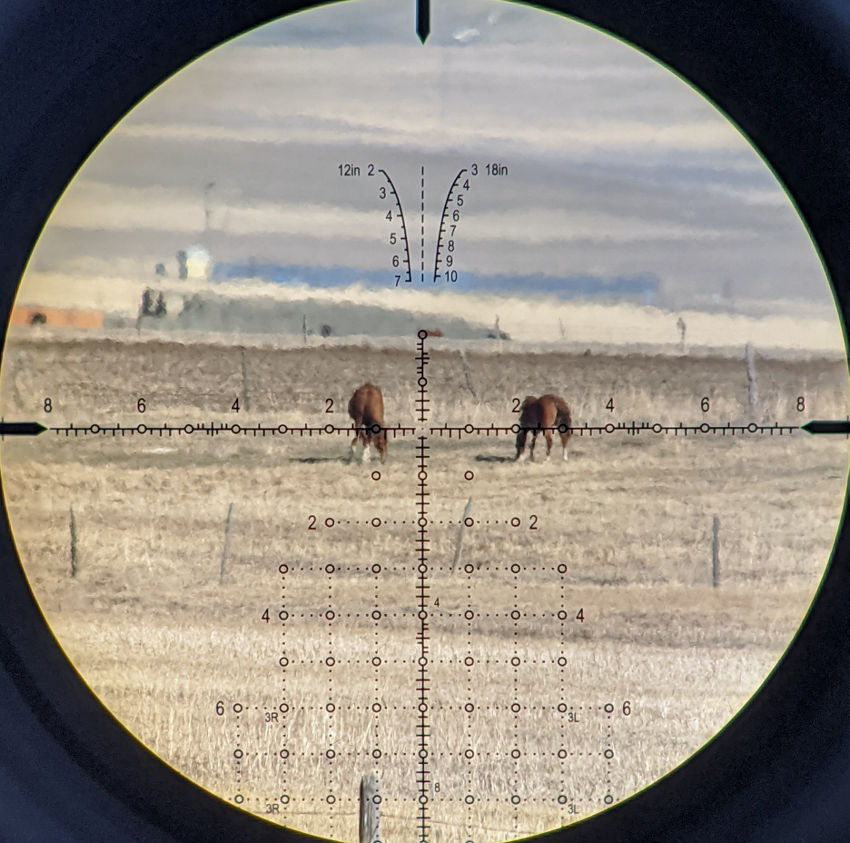

Whats so bad about the MPCT3? I dont know shit about reticles so i'm genuinely interested as to why. I always kind of liked the look of it with the open circles like the H2CMR but again have zero expectance with most reticles and have only run a P4FL.
Reactions: gnochi
For a competition reticle the MPCT3 is decent, for a crossover reticle it makes me vomit :sick: :sick: 🤬😤🥵😫 (PS - I hate the H2CMR as well). But I'm very particular about reticles and I don't expect everyone to think like me. As my old pops used to tell me, "you're entitled to your own wrong opinion" :LOL:

2. FFP Mpct3 reticle or similar tree

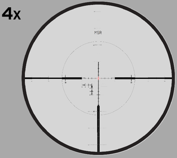

+1 MSR-2 design principles,
but without modification, IMHO
too thin at low power like 2-4x
I'm in the camp that wants, when at 2-4x
a "virtual reticle" to appear, very basic
-> bracket, level and center my target,
something looking like german no 4
I really like the bracket on my little bushy 1-6. With both eyes open everything in the center disappears unless your looking for it and its very fast. I like not having a post at 12 o'clock. Gives a much better view and open feel.

Nice, here is my quick-mock up of modified MSR concept...
(also outlines the 15x scope view)..
Cocktail napkin note(s)
1) Open top design for observation/spotting shots etc
2) Solid post 3/6/9 oclock -> german no 4 in high contrast or wide angles etc
3) MSR L-scale is reduced in size, a la nighforce inverted T (stays out of way when not in use)
4) 99% of "fast-acquisition" scenarios, IMHO 8mil holdover and 4 mil hold-under = enough detail
5) MSR style 10/20/30 mil measuring/level references available for wide angle viewing
