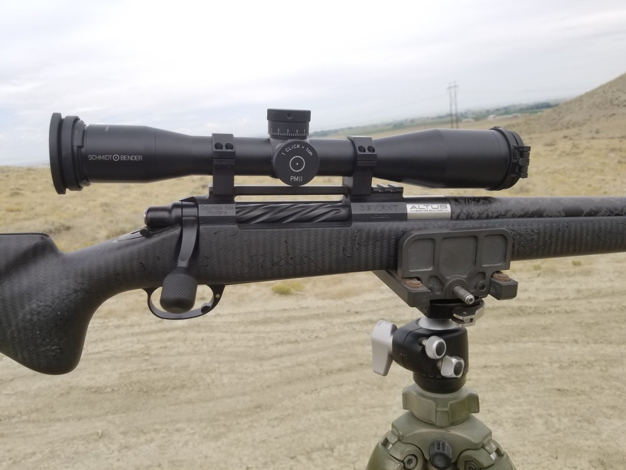

For reference my S&B 10x is pretty close to ideal size and weight.
