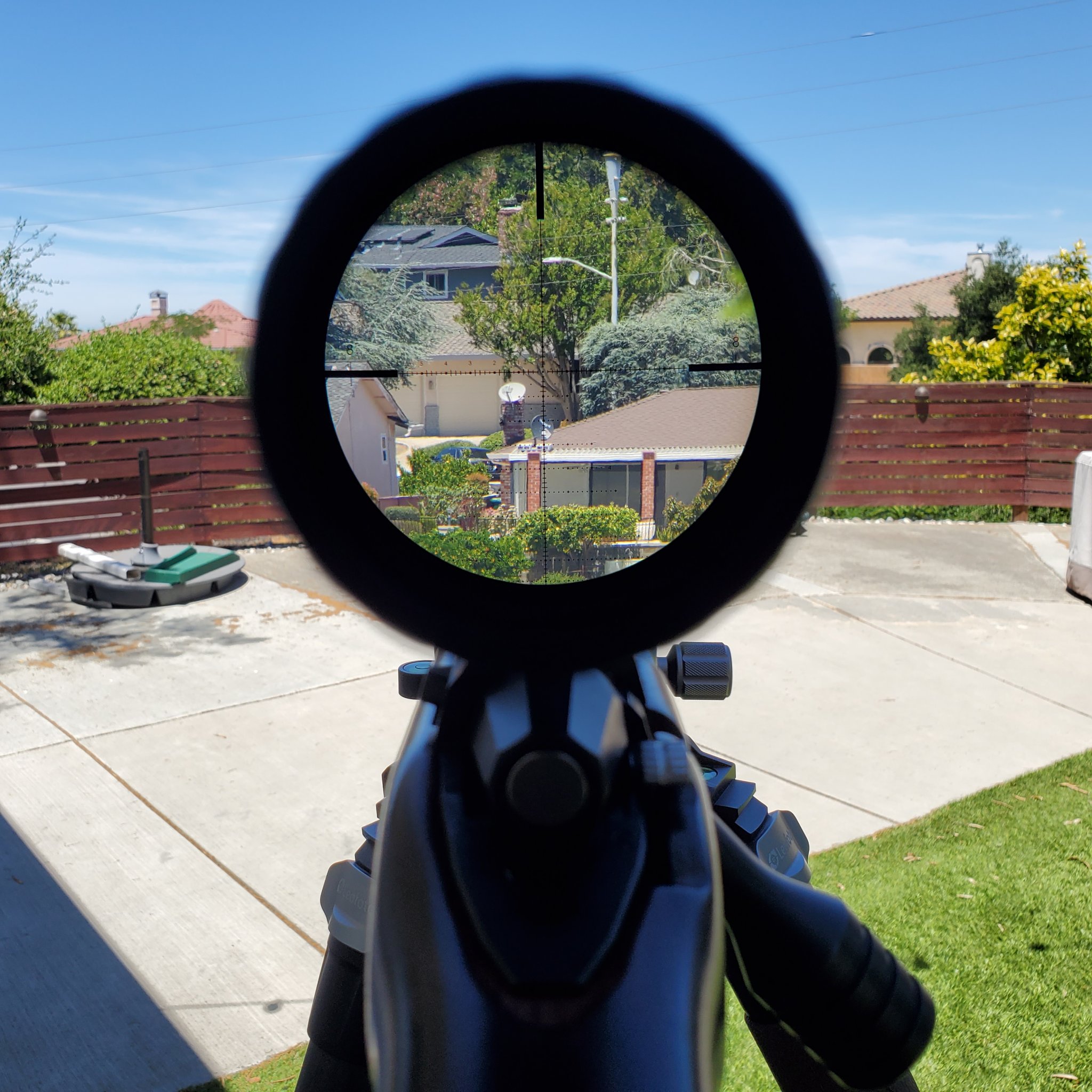

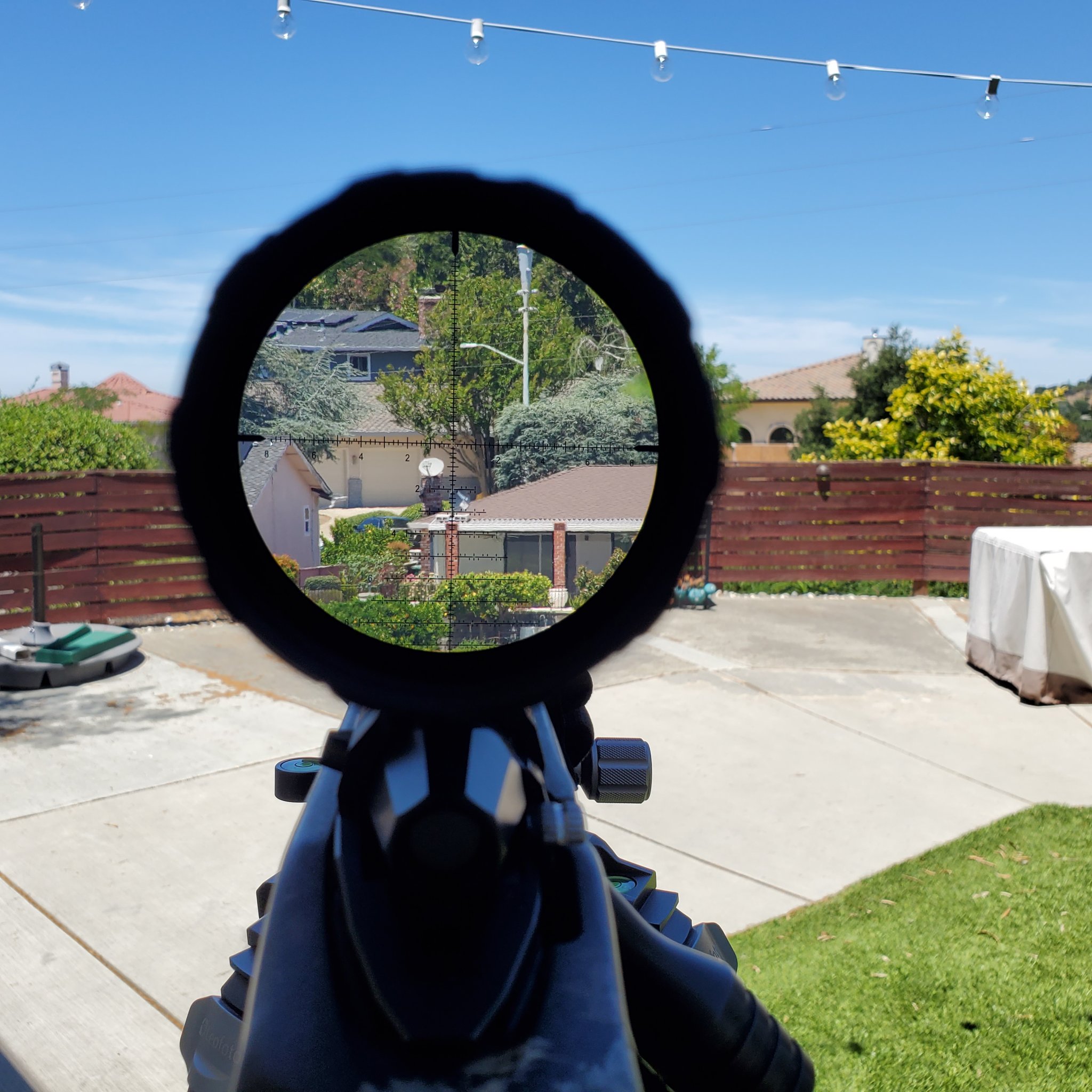

FWIW, heres my $0.02 on ZCO and TT
Top: Zco 527 ~22x @ 670 yards
Bottom: TT 525P 25x @ 670 yards
Observations:
Bigger image for ZCO: It's observable in person, and in the picture below, that the image one sees is "bigger" on the ZCO than the TT. It may relate to the 36mm vs. 34mm main tube.
Image: Related to above, it appears the ZCO not only magnifies the image, but expands it. What I mean is that 25x zoom on the TT equates to 20-22x on the ZCO. A good example I can think of is imagine standing 5ft in front of a 4K TV (Zco) vs standing 7ft in front (TT). Both will be incredibly sharp, but the former will "see less, but appear bigger".
Resolution: The TT was able to pick up the individual bricks on the chimney and columns a tad bit more than the ZCO, as well as the leaves and branches on the trees above the center dot. What I find odd is the TT has a blurry ring around the edges (you can sort of tell in the image) that is a result of me playing with the eye piece when setting it to my eyes. The ZCO occular is also set to my eyes, but maintains more edge to edge clarity.
Color/Contrast: I give this one to ZCO. A joy to look at. Vibrant. Reds seem redder, greens seem greener. The contrast helps objects stand out. Again, look at the bricks. More wow factor. I wouldnt say it is manufactured, but definitely seems to be by design. TT, is more natural I guess. If I were to walk 700 yards right up to that house, the TT. is what I "imagine" the structure would look like up close.
Turrets: Quick comment on something that's been beaten to death. I just got the NLE retrofit on the ZCO and it's a notable improvement that brings the turrets to TT. Hard to say if that is due to the retrofit itself or from ZCO servicing the turrets. Either way, I'll take it. Worth it and I'm may be in the minority, but I may prefer the NLE ZCO.
Reticle: The mpct2 is so thick. Easy to pick up for sure vs the Gen3xr, which isn't usable with my eyes below 16x. but i like that the Gen3xr tree disappears when you aren't focused on it.
