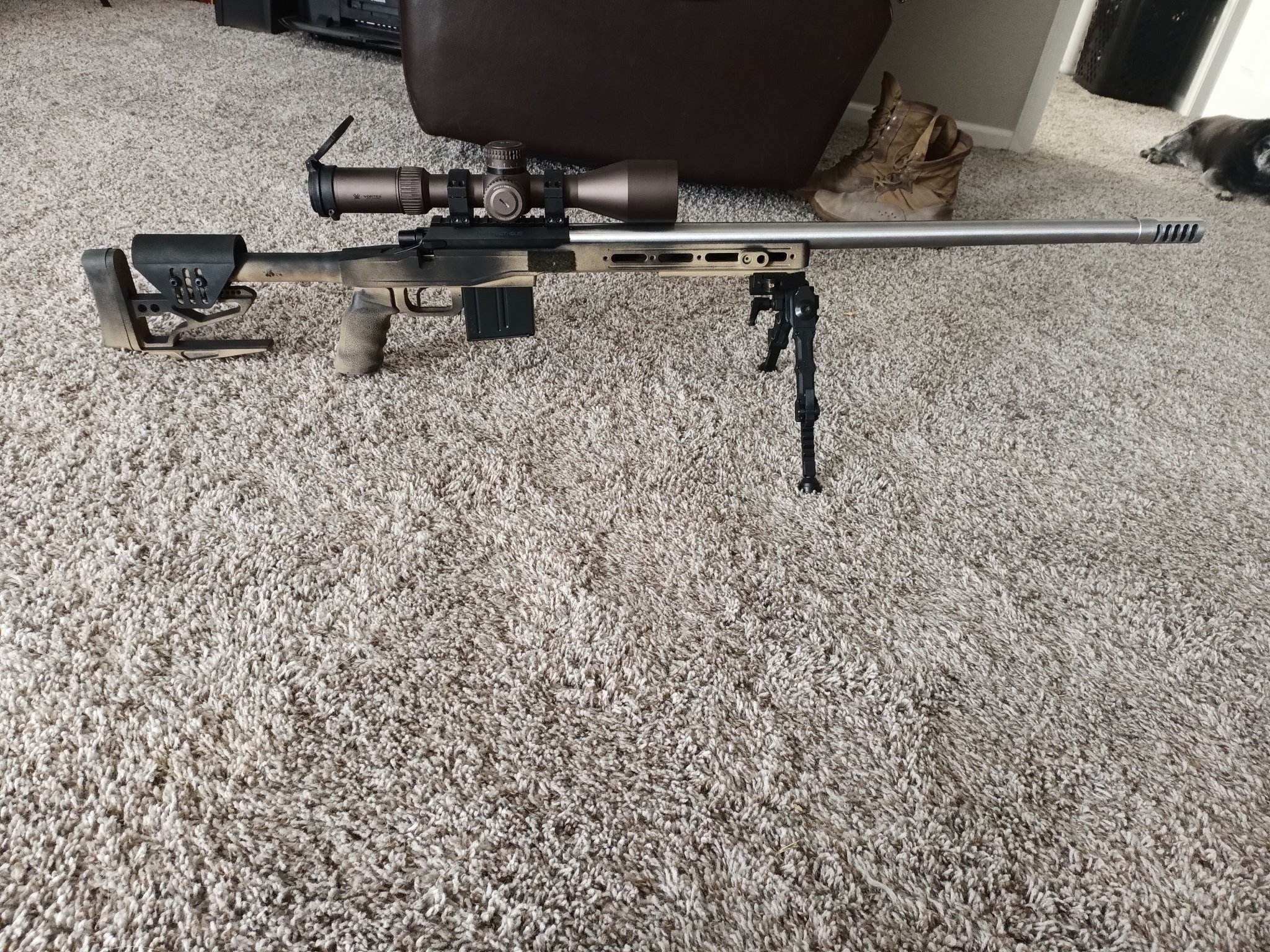

Quick question for the pros
I'm thinking about eventually moving from 204R to 22BR for Yotes. Right now I have a HS DBM Gen 2 for 223. Max coal is approx 2.43in which is perfect for those 75 eld-m/SMK80.
Can I simply open the feedlips and be able to feed the 22BR ? Seems like I would work better than getting a 308SA magazine with a spacer/stop. AFAIK HS doesn't make a dedicated BR magazine. I'd rather not convert to a different BDM/wyatt box.
Here's a pic for reference.
Yes I know it's a retarded choice for a DBM, I was mislead into taking a Manners UC into that dbl inlet rather than M5.

Can't speak to how well the feed lips will work for you, but I can tell you that with 0.130 FB and the 88gr ELD-M jumping 0.050", my COAL is 2.305". You should be good to go from a COAL standpoint unless you go for the 95gr SMK or something, but I bet even that would be fine, sounds like you have like 0.125" to play with beyond my COAL.
Reactions: st1650
I think I could also weld a lip on the follower to bias the rounds up and with a bit of chamfer in the barrel, I think it could feed reliably. I also think the BRs do better with CRF than pushfeed and I still have a Nuke 1.1 with a 308BF so I might also do that rather than use my Defiance.

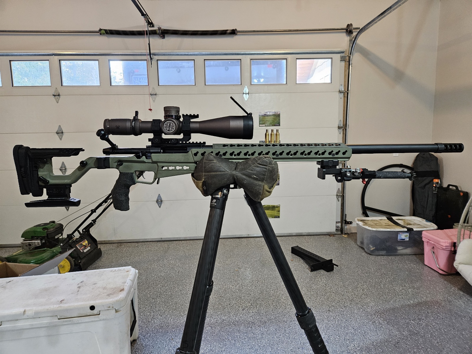

Results from taking the new 22BR barrel out. 28" Bartlein 1-7.5 Heavy Varmint with my new 22BR reamer I had Manson make for me. 0.130FB and .255 neck on my TL3.
Loaded up 100pc of brass with a mild load from my other 22BR barrel...29gr 4166, CCI 450, 1xLapua, 88 ELD 0.015 off lands.
Chrono 10 shots 3020.... SD6
After 6 shots zeroing I shot this 1st 5 shot group. Good start.
0.274"
300yd
0.952"
0.604"
0.600"

Good stuff! What's the color of that chassis?
