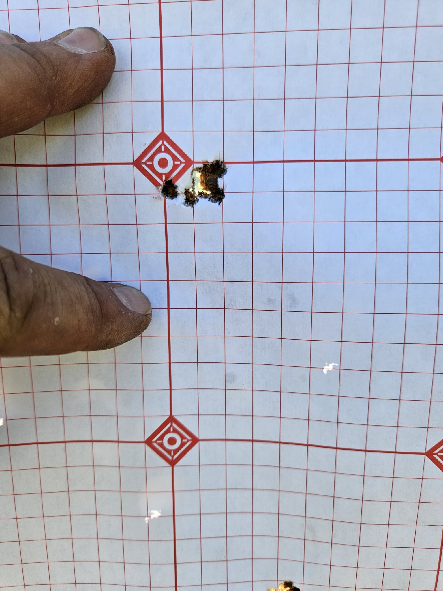

Anyone having luck with 1:8 with bullets in the 80gr or heavier
Just wrapped up..
24" Brux 8tw
80gr Berger Vld
Varget
3135 avg fps sd 6
Gave it 5 @ a hundo
Boxed it up and left

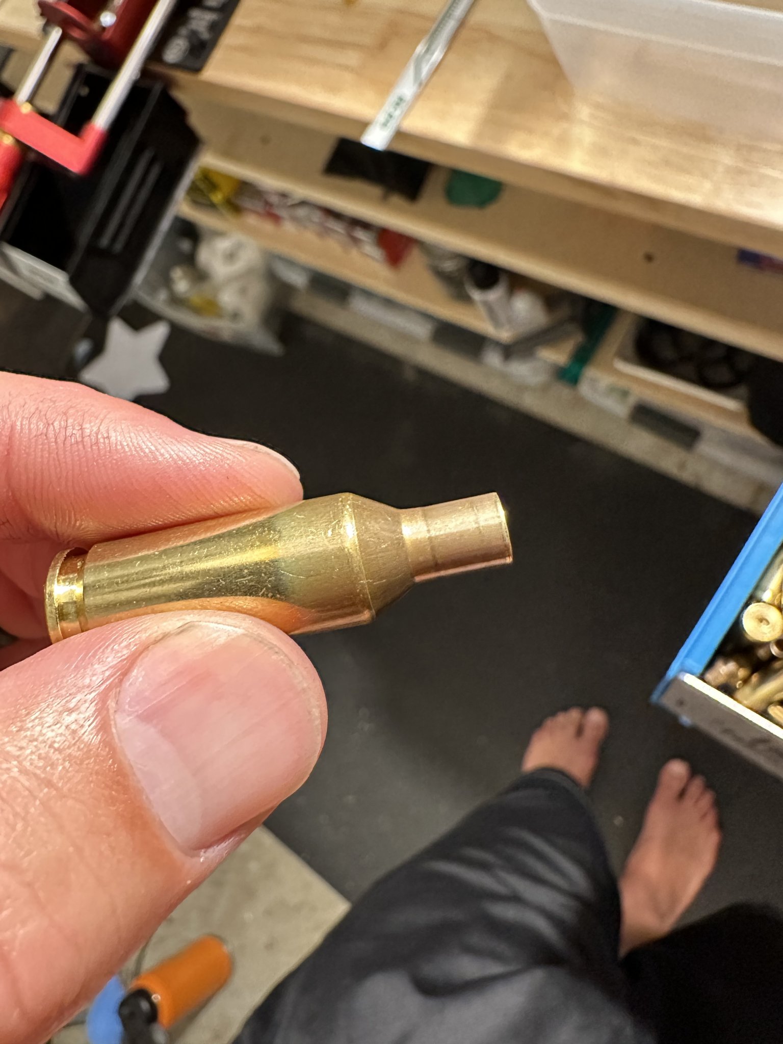

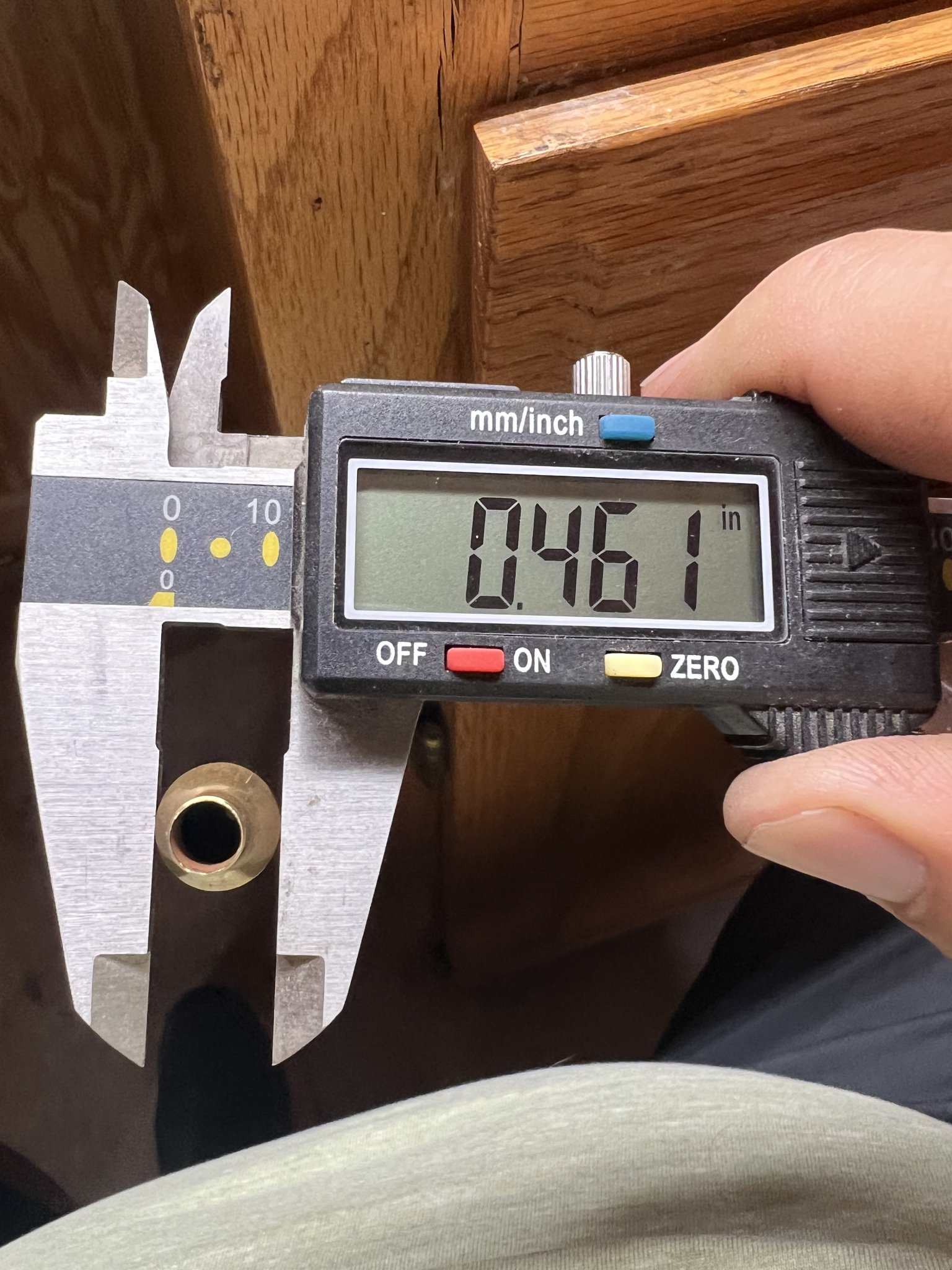

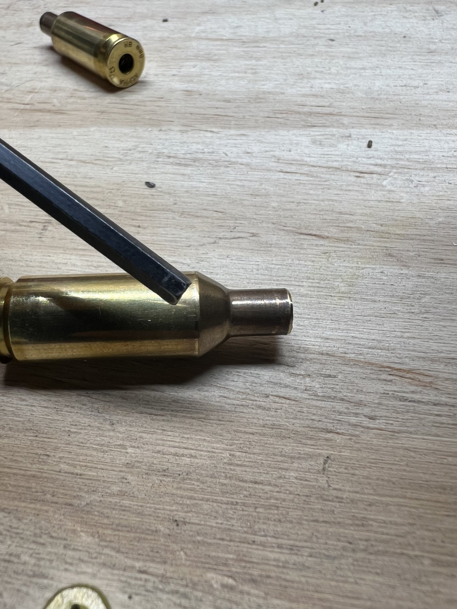

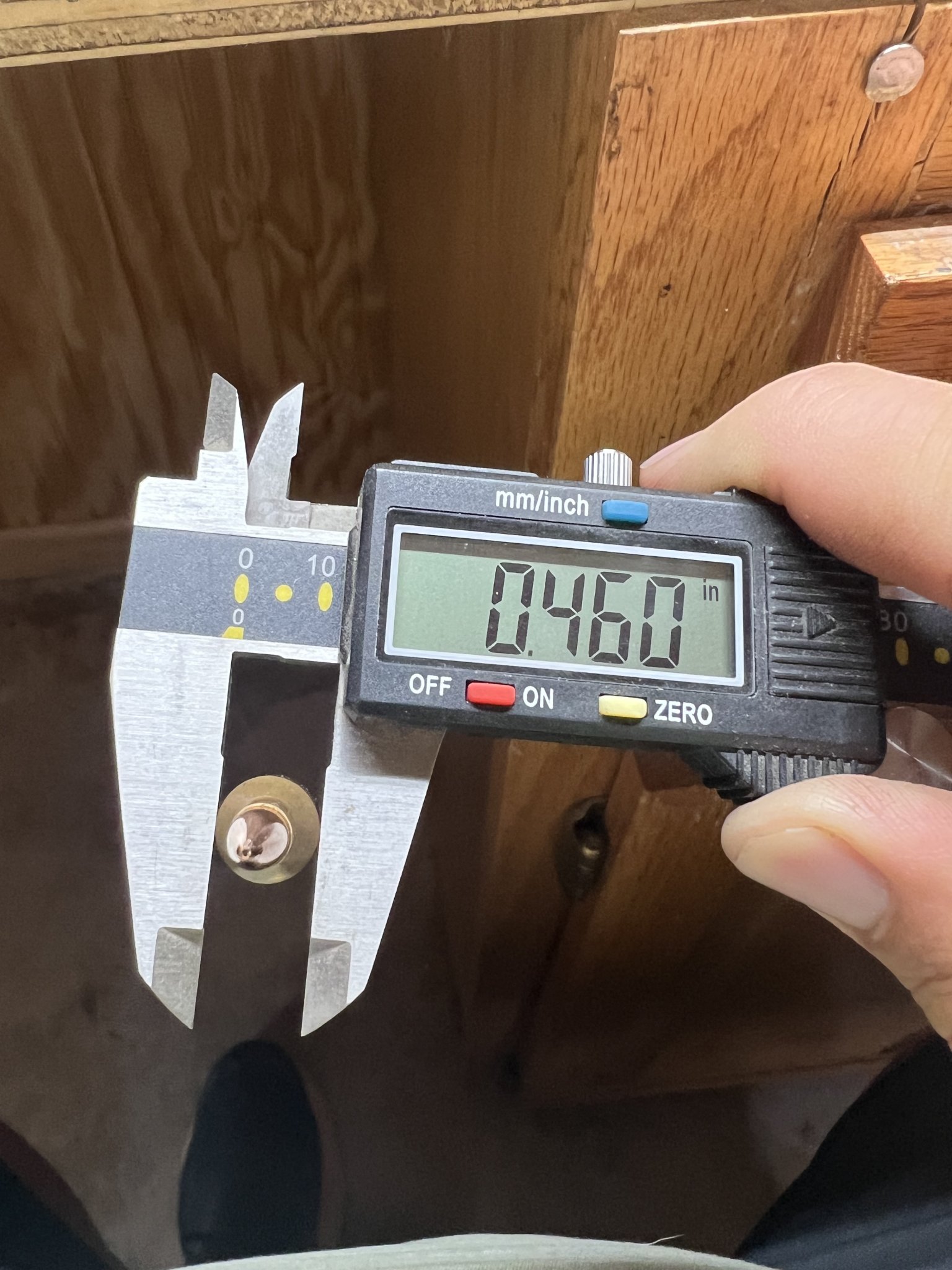

Anybody happen to have data on the spring-back on neck sizing their Lapua 22BR brass? I’m getting what seems like quite a lot: sizing die is 0.247” verified with a pin gauge, neck OD after sizing and no expansion (removed expander ball) is averaging about 0.2506”, so over 3 thou spring-back (or 1.5 thou per side).
I like to try and size mine down to about 3 or 4 thou of tension then use a km expander mandrel to set it back to 2 thou
Do you have any idea what the difference is between your die’s neck size and the OD of your necks coming out of it, with no expansion?
For example, if you’re using a neck bushing, what size is it and what size are your necks (outer diameter) coming out of it?
You know I've never really measured that I usually will use pin gauges to measure the inside of the neck.. also what tool are you using to measure the outside of the neck?
Micrometer with a flat anvil. It’s pretty consistent across cases, and I average the readings taken 90° apart, but they’re consistent too, within generally 0.0002”
So I wonder if what you could be seeing could be the case lube on the neck or the bushing maybe?
I’ll be honest, and a bit blunt. It’d help me if we could focus on the question I asked. It sounds like you haven’t measured what I’m after, and that’s fine; if you happen to take the extra step in your process the next time you resize brass, I’d love to know what you find. Appreciate it!
Ya sorry I understand your question I was just trying to help think of something that could cause that much spring back but I also never check measurement and honestly I don't know how much it would even mean I usually just check a loaded round with a micrometer get that measurement make sure I have 3 or 4 thou chamber clearance and then select a bushing that is 3 or 4 thou less size check the inside with a pin gauge then expand with the mandrel to the final dimension I want

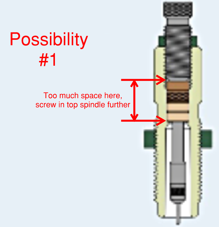

That’s what I did with this setup also, but was getting almost no sensation when running my mandrel after the first firing. Come to find out I’m getting what *seems* like a lot of spring-back, but honestly I never check it on other cartridges so I don’t know what’s normal.

Finally made it out to shoot the virgin 22br in some wonderful 15mph Wyoming winds rocking my truck, which I was using the tailgate as a rest for bipod and bag.
28.5gr Varget, velocity unknown/es
badly runout lapua necked down brass
Cci 450s
88eldm
Not a group over 3/4" and 40-50k jump shot pretty dang well for an unstable rest. Have another 140 rounds that I'll seat to -45 for rest of break in.
Cci 450s
88eldm
