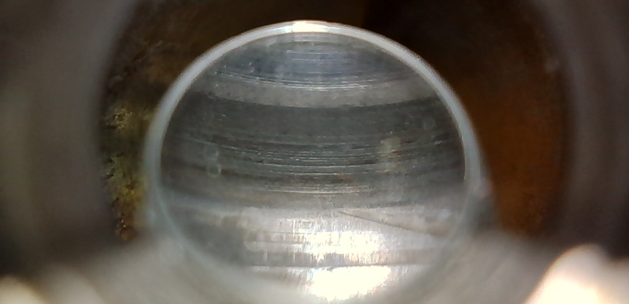

I am using a SAC 22BR die sizing 6BR once fire Alpha Brass. I am having a hard bolt closure. Seems like it’s contacting right below the shoulder. I have some ammo that came with the barreled action that chambers fine to measure off of. Included in attachments
Did you order or purchase a 22 cal mandrel or decapping pin from them? There dies done work without the mandrel or decapping pin in the dies
