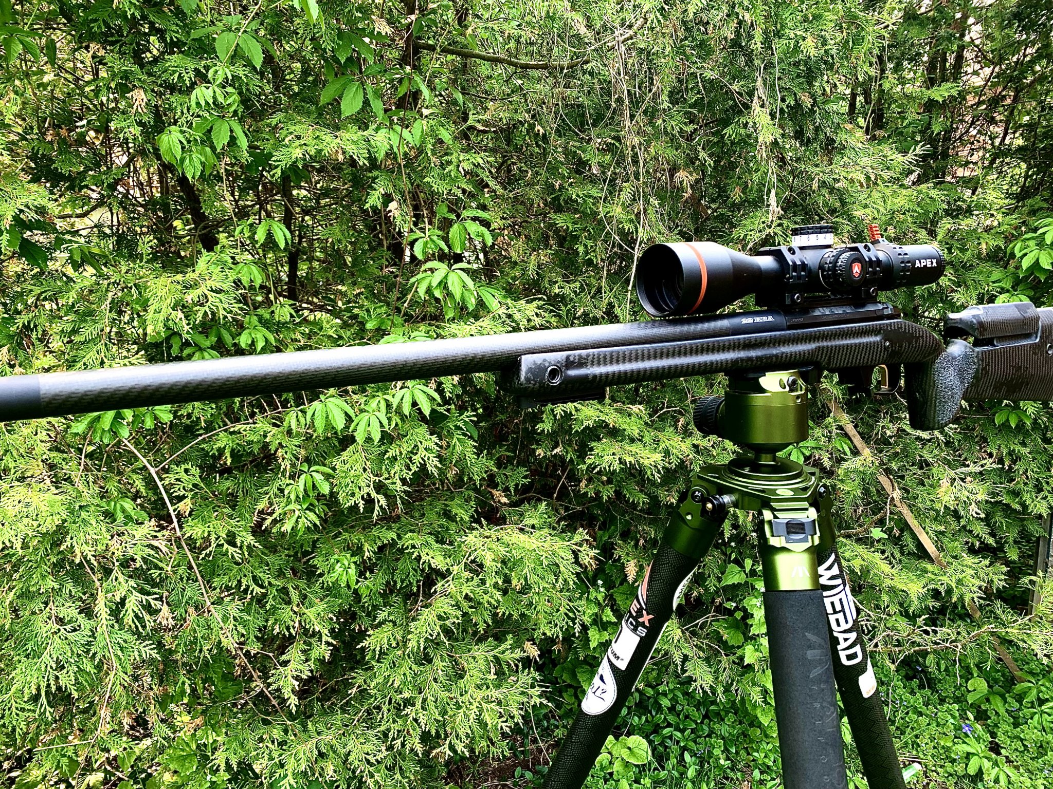

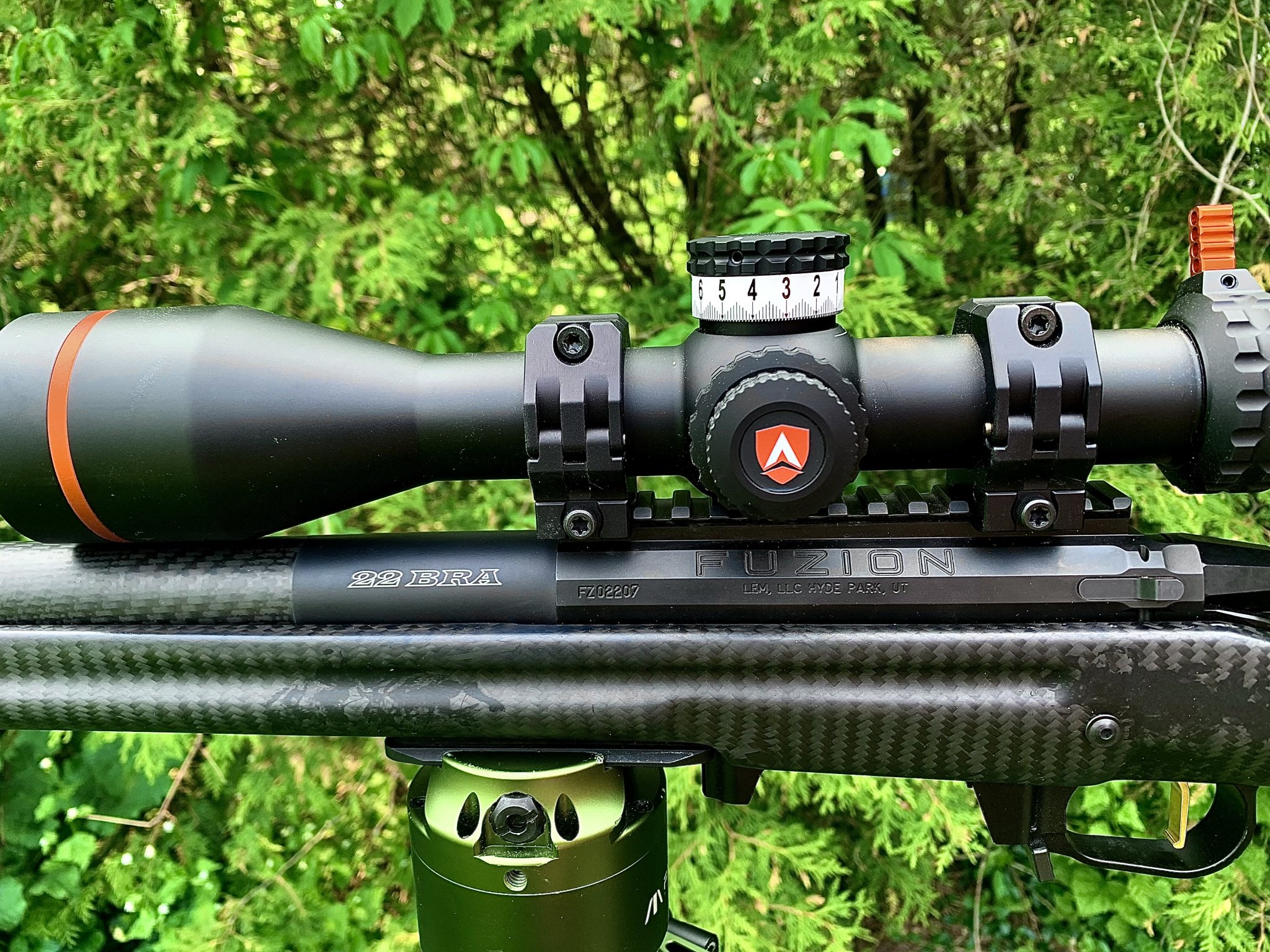

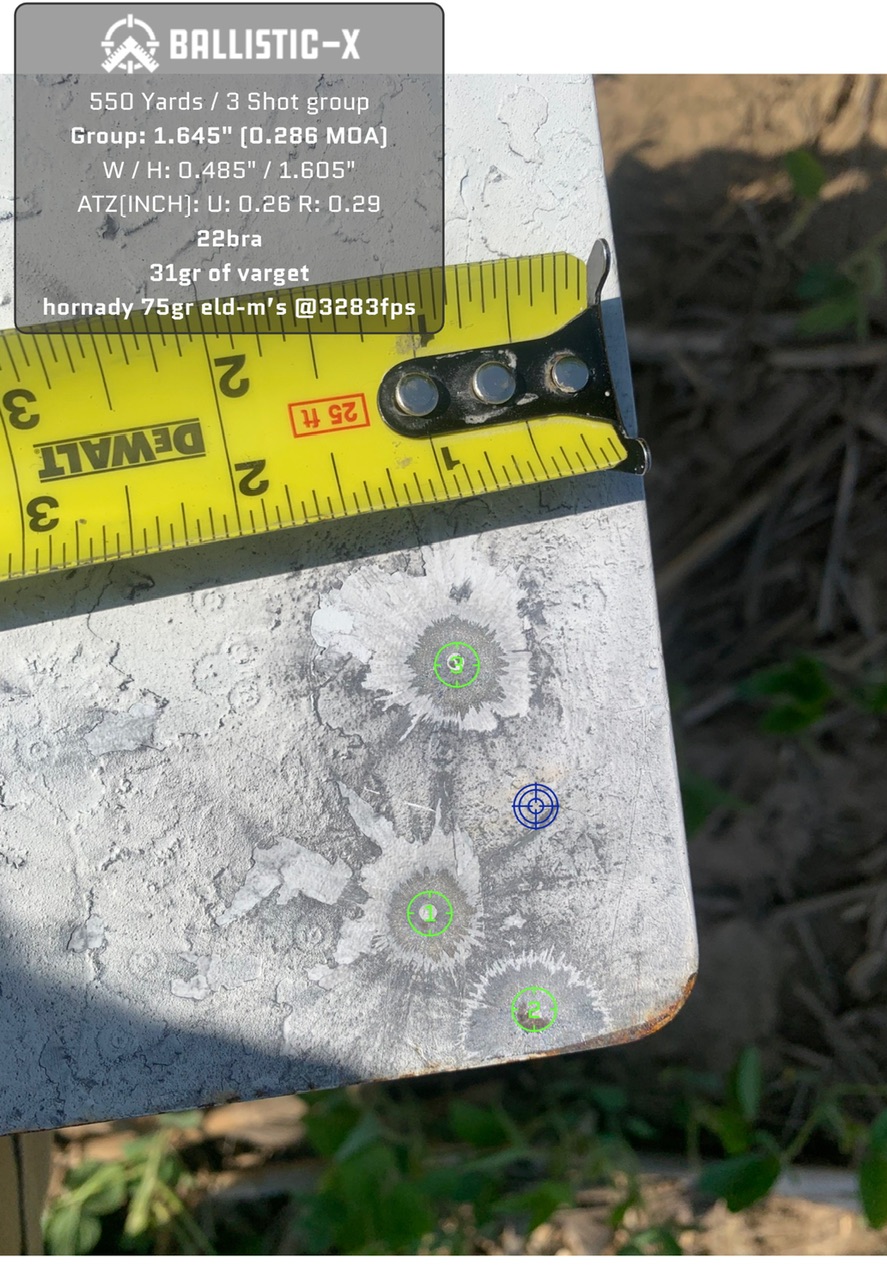

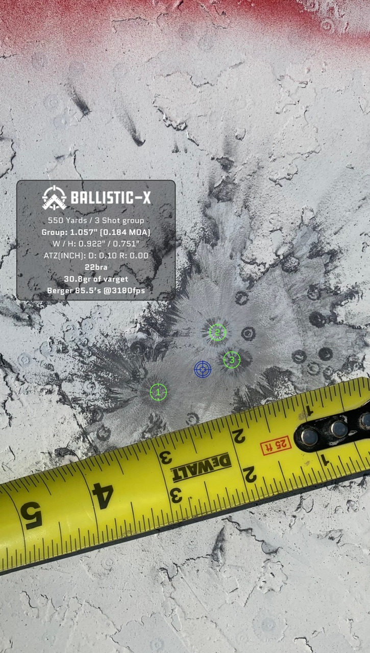

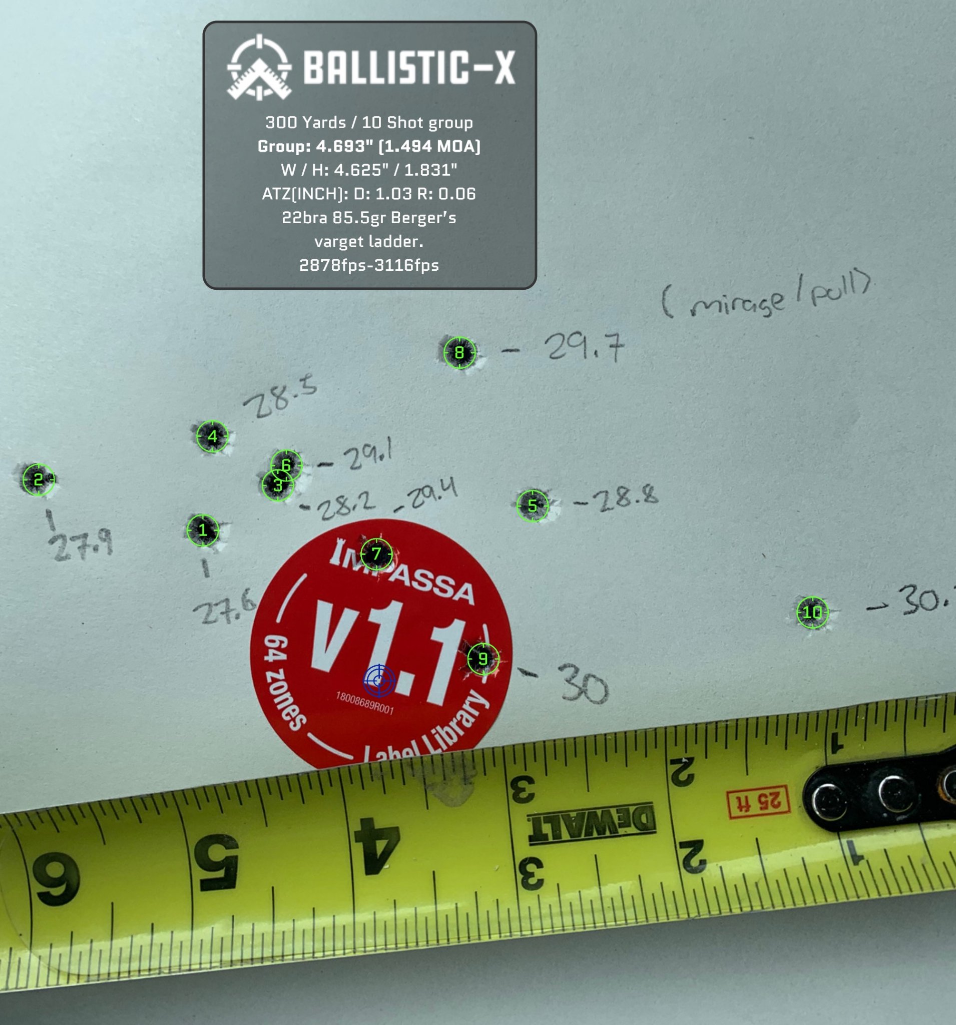

Finally got some time to get some rounds down range, started with seating depth while the barrel speeds up. Starting load of 27.0 grains of Varget with the Berger 85.5 hybrid seated with .005 jump gave me 2,832 fps. Group shown below are shots 9-11 out of the Benchmark 1:7.5 twist in MTU contour finished at 26" and for those that believe shooting suppressed compromises accuracy........
IMG_2632.jpg IMG_2635.jpg Ballistic-X-Export-2022-10-29 14:53:32.856598.jpg
So, I loaded up from 27.6 to 30.4 of varget and an 88gr ELDM and got pressure to the point of popping primers at 30.1.
Any clue.
Group for 27.9gr

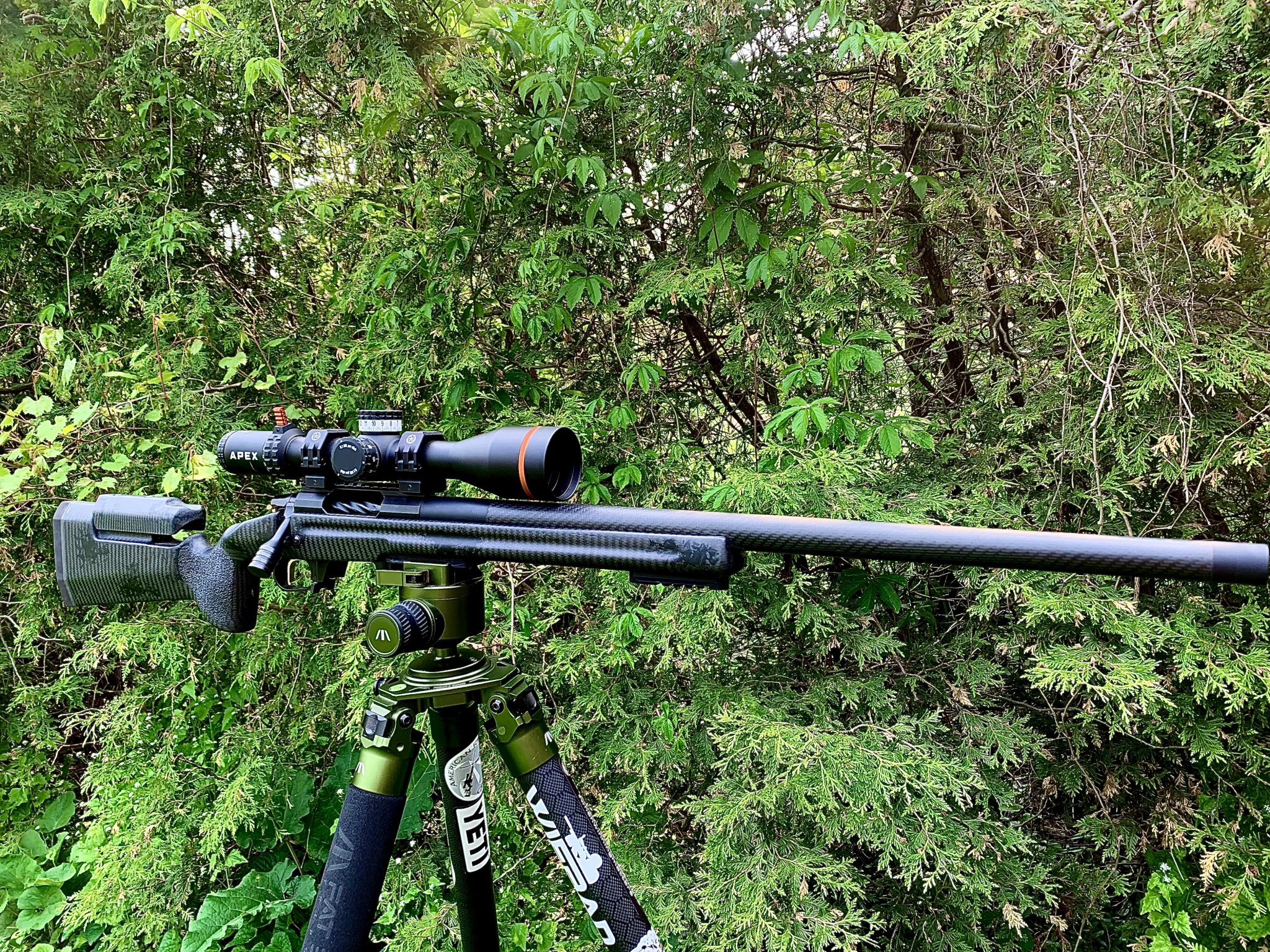

7tw osprey 219 bore at 18" I will likely run 88s for hunting at around 3000fps or so. Faster velocity makes em prone to over expansion for splashy results on game. My 22br reamer is ordered will be 0.140 freebore for heavies like the 90atip. My 22cm is freebore at 0.120 and works with 75s seated 37k off lands. They're well above neck shoulder junction. As throat wears away I'll likely switch to 77tmk as the bearing surface is quite a bit longer.

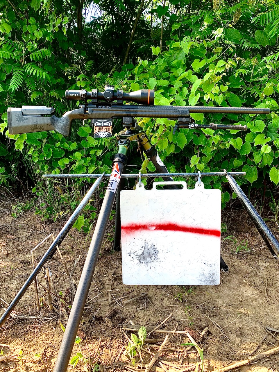

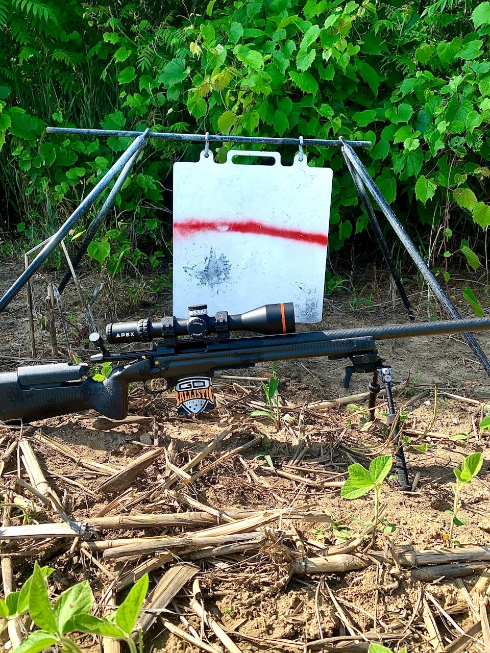

View attachment 7986835 View attachment 7986837 View attachment 7986840
Got the Labradar out this weekend and settled on charge weight of 29.1 grains of Varget which got me 2,992 FPS with ES of 9 and SD of 5.0
