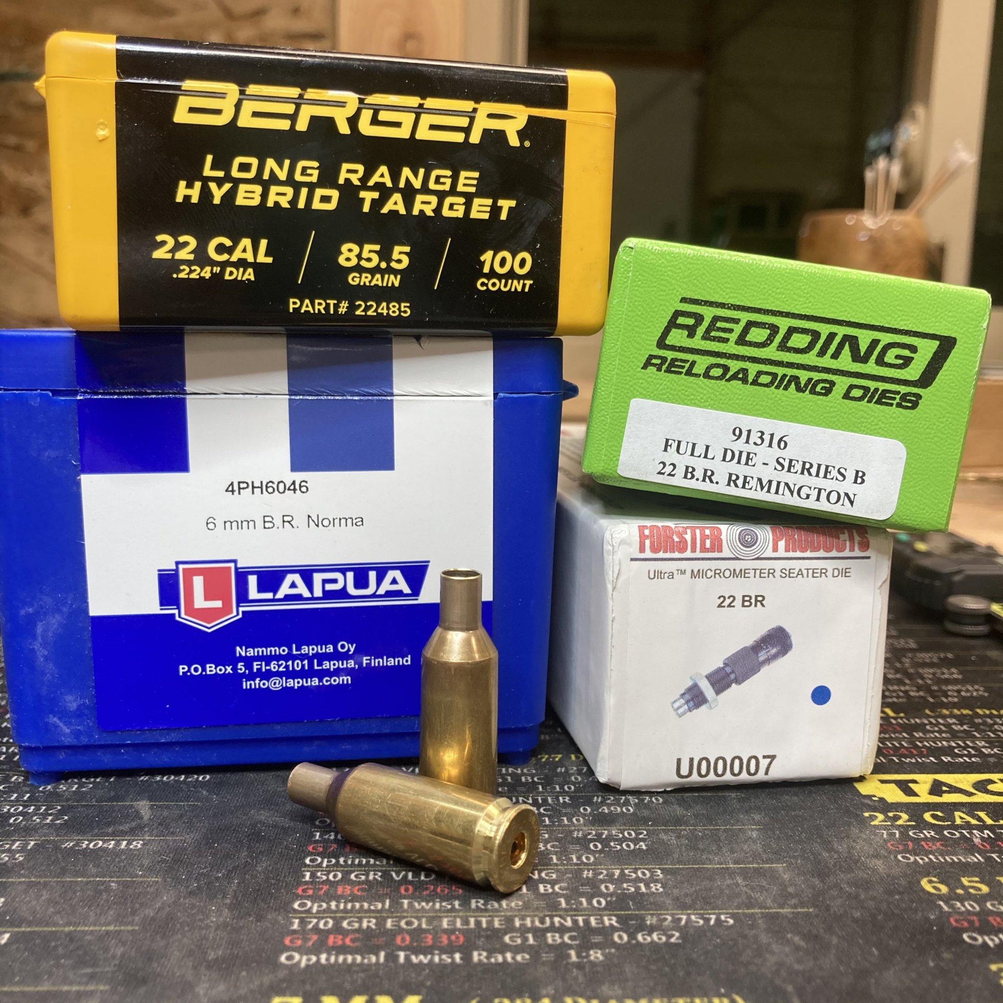

I bought the K&M neck turning tool, and after fooling with it a bit, didn't see the point. Though as the Displaced Texan says, I may not be channeling my inner donut.:)
One thing, run either a Forster and get the neck honed or a Redding Bushing FL die. I made the mistake of buying the regular Redding FL die thinking it would eliminate the donut, but it sizes necks WAY too far down, resulting in an even worse donut (outer, and quite likely, inner), along with several crushed shoulders.
I bought the Redding Bushing Neck die, but I still need something (likely the Redding Bushing FL) to bump shoulders with eventually.
FWIW, I'm running a Hornady 6BR die with a .249 bushing.

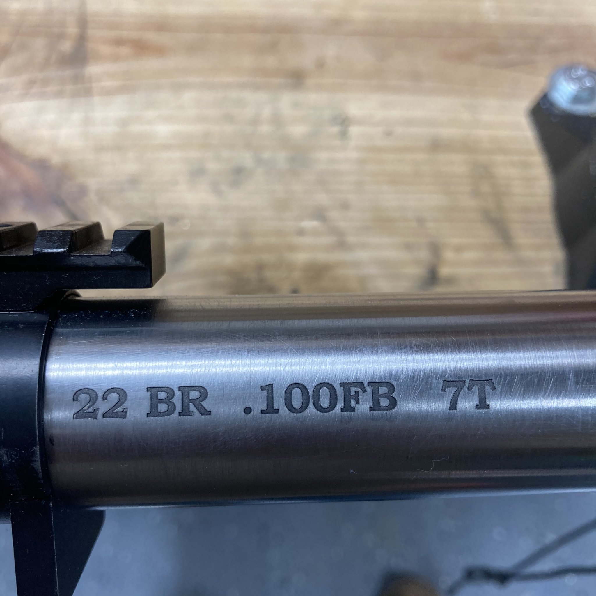

Nick at Straight Jacket Amory has built about 100 of these. He gave up on the .254 neck and went to a .256 with .100 freebore.
Manson messed up my first reamer and sent me a .252. It overpressured and wouldnt even feed properly. My new reamer is .255 for my .250 loaded OD.

Funny I just got my reamer from Manson yesterday that was supposed to be .255 and I got a .252 neck reamer. Aggravating after waiting 10 weeks but mistakes happen I guess.
They sent me a reamer print and I didn't look it over real close. It was a .252 neck, even though I requested a .255. So I didn't make a big stink over it, I should have caught it.
But .252 only works if you neck turn. Which I won't do.
Just wanted to say they had a replacement reamer to me in a week. Happy with the customer service!

Plan on shooting the 85.5 Berger.
Has anyone shot a 22 dasher and went back to a 22 BR?
