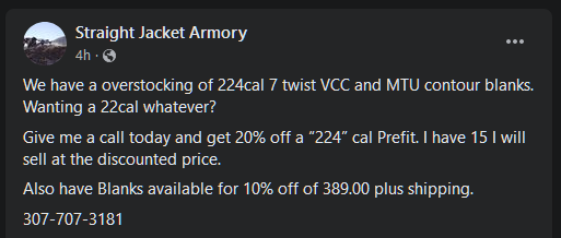

Called straightjacket yesterday asking about 22 BRA. They steered me towards 22GT. With the appha brass it's probably gonna get the nod.
You and I are exactly in the same boat. I want the 22BRA so bad but at 16-18 inches, it's not gonna have the MV or energy I want. I too want to hunt Texas whitetails with it so GT is what I'm considering. I want to go short barrel so I can use it suppressed.

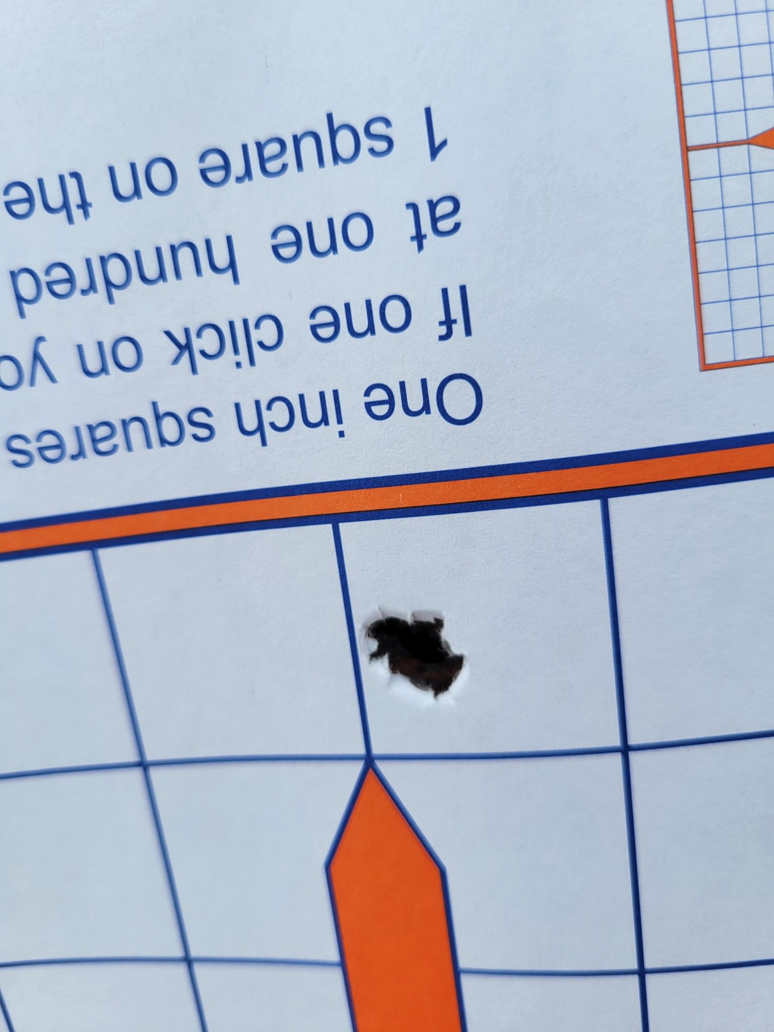

So the other side of the coin is that I'm getting 2850 with the 75 eldm out of a vanilla 223 16" Tikka right now which still carries 1800fps (minimum expansion velocity) well past 500 yards.
It's absolute freakin' lutely devastating on critters.
But I've got the need for speed as well. And hear good things about the 88s on larger mammals.

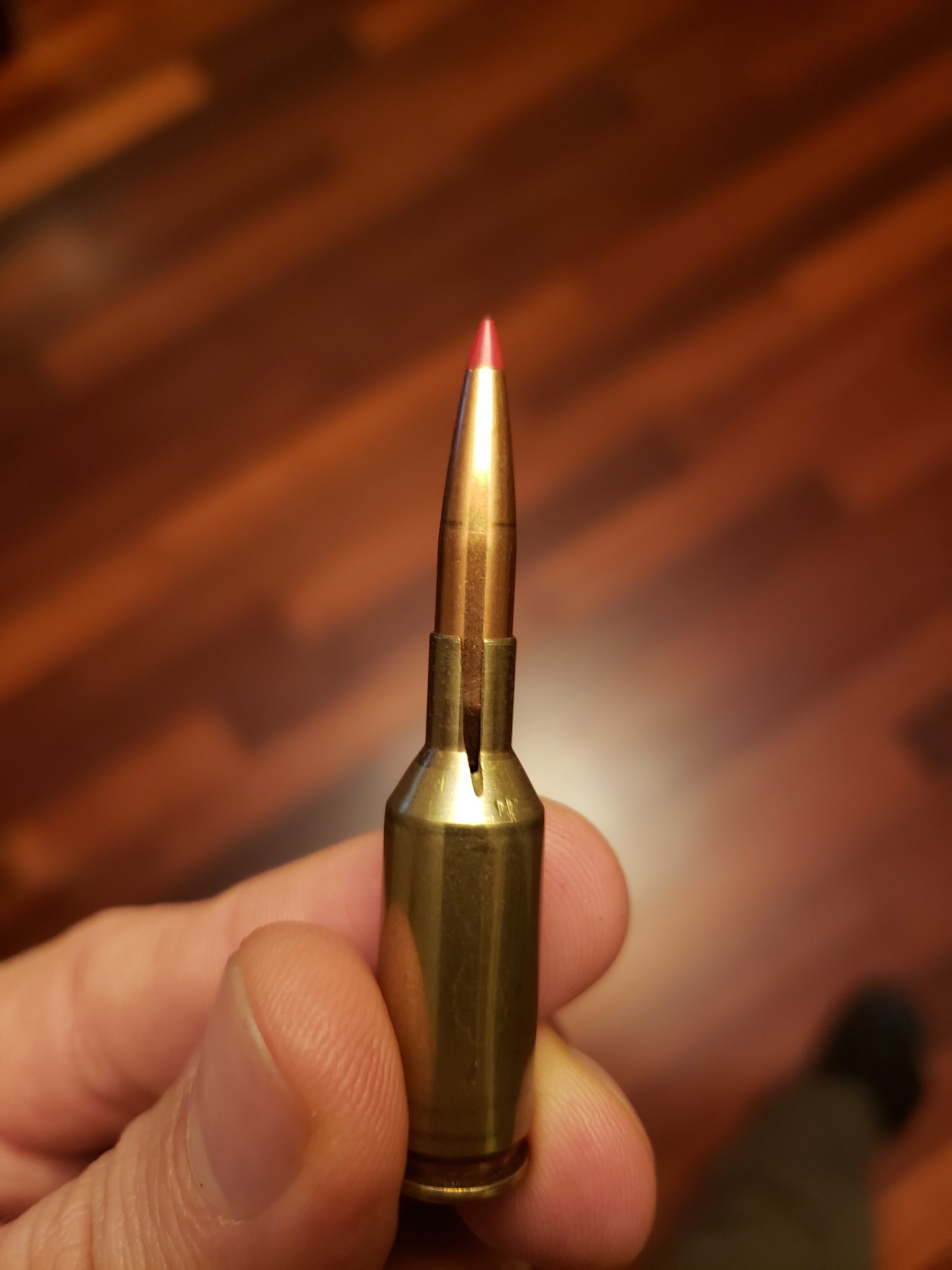

I do love the 22BR. This last round of load development i had with it really found a sweet spot with a longer freebore and jump on the 85s.
I'm just tinkering at this point. I'd really like to find a fast moving wind gun with some decent barrel life and low recoil. Out here in the northwest we get some pretty heavy wind matches. I ran a 6 Creed for years, played around with heavy pill 6.5s. The 22 Creed experiment was very short lived. But I think a fast moving round with a medium sized case has a chance. Fat chance, I know. But maybe ill hit a sweet spot with 85gr hybrids or ATips running 3100 to 3150.. 🤣

I have the .253” BRA chamber from GAP. With turned necks, loaded rounds are measuring right at .249 (using a .249 bushing).
Unturned brass does also fit in this chamber, but with very little room to spare. Loaded rounds measure in around .252, but it definitely does not feed as smoothly as the turned necks do. Also using a .249 bushing.
You can go straight from 6BR down to .249, but it’s definitely not as smooth stepping it at .255. Use plenty of lube, especially on the interior necks… you may crush some shoulders in the process but it does work. I wanted the false shoulder for fireforming anyway so the 2-step process was the way to go for me.
