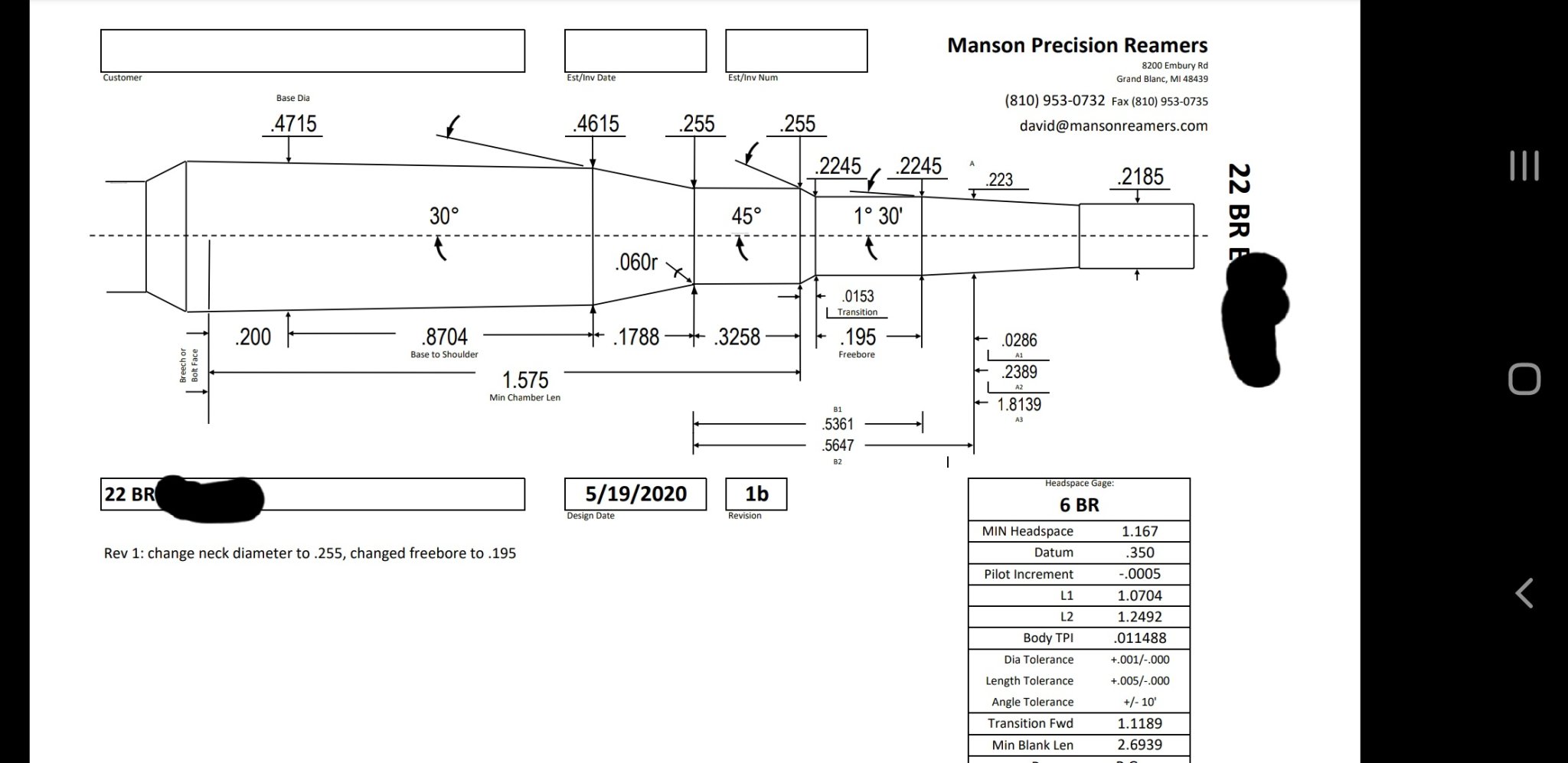

I got my two new barrels squared away and mounted one of them. Throated it out to .120 freebore.
Going to run 1000 Berger 85.5gr Hybrids through it and see how I like them. They are more money then 88s, but a little higher BC, and tougher tip. A little better QC.
I'll keep you posted.

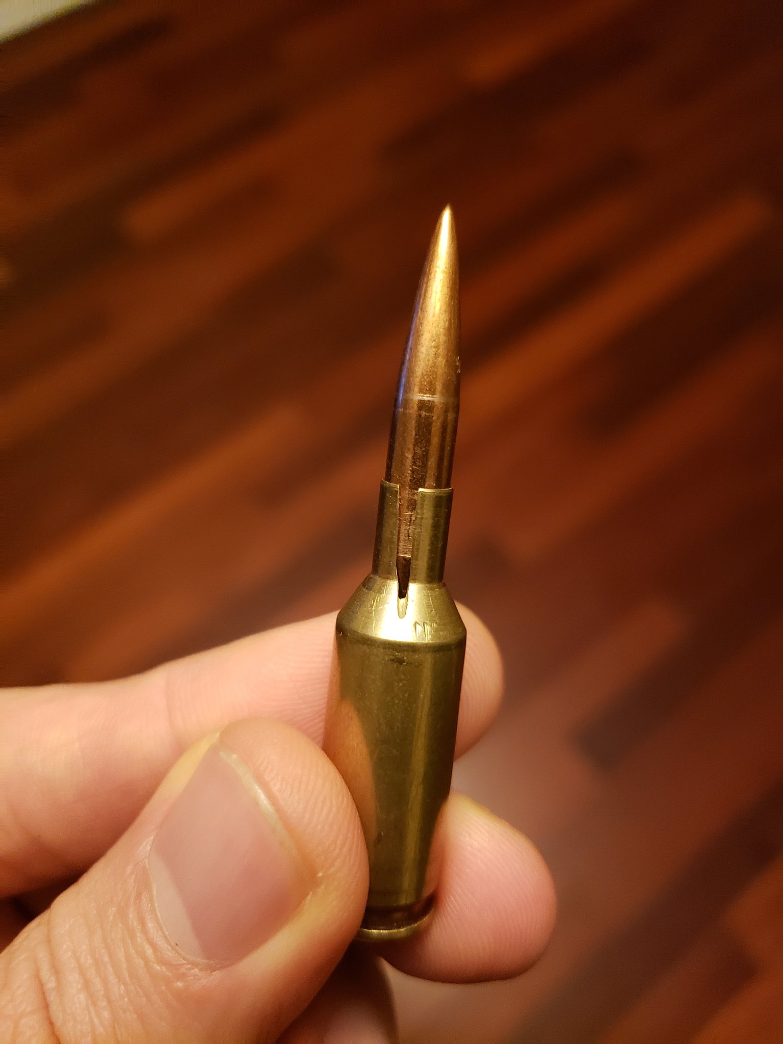

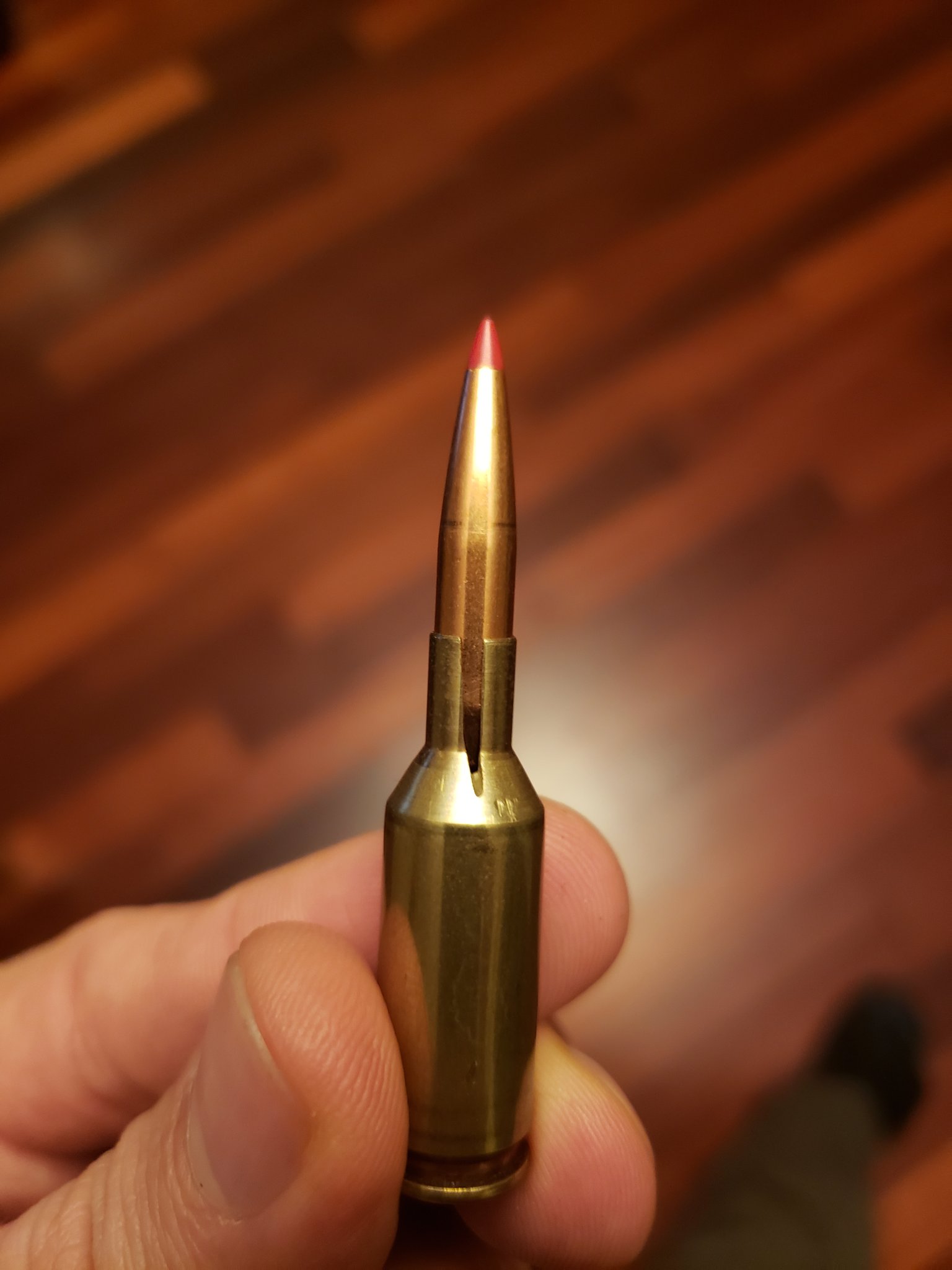

The 88s have some flaws here and there. If you mag jam one, toss it out, the tip gets buggered and its a wasted shot. Other than that they are awfully solid for the price.

We went ahead and ordered a couple of Brux 6.5 twists to get this 22BR project moving over the winter.
Plan is to run 85.5s VLDs or 95 SMKs over Varget around 2900-2950. We’re wondering if the 6.5t will help to stabilize the heavies at distance without having to chase speed (and keep recoil to a minimum) or worry about blowing jackets.
.255 neck with .150 freebore sounds like a good in-between for what we’re trying to accomplish. No need to turn necks and a long enough throat to keep the bearing surface above the shoulder junction.
Will update once we get them spun up and have some time to start messing with them.

Regarding this dog turd. I too have the redding 22br FL die. I lost 10 pieces on my first 100 brass. Then i seemed to have solved the collapsing shoulder issue by making sure everything was lubed quite generously with hornady one shot, including inside of neck. Removed expander ball and used the mandrel to bring the neck back up after. Did 300 more brass with no issues.
Reactions: 260284
I lubed it up inside and out with Imperial Sizing Wax, pulled the expander ball, and still had issues.
The problem is, when you have to use the amount of force I was using on a Rock Chucker to size cases (into the die, and then pushing back over the expander ball as a separate step), something's wrong.
IIRC, my cheap RCBS .223 dies only size .005" under the final diameter before going back over the expander ball. The Redding .22BR die was sizing .018". I fail to see where that's good for buck-a-piece Lapua cases. I've got a dozen sets of el cheapo Lee dies and even they're better than that.
I don't mean to hate on Redding. I've got some of their other stuff, and it's great, but the .22BR FL die is an abortion and better alternatives abound.
