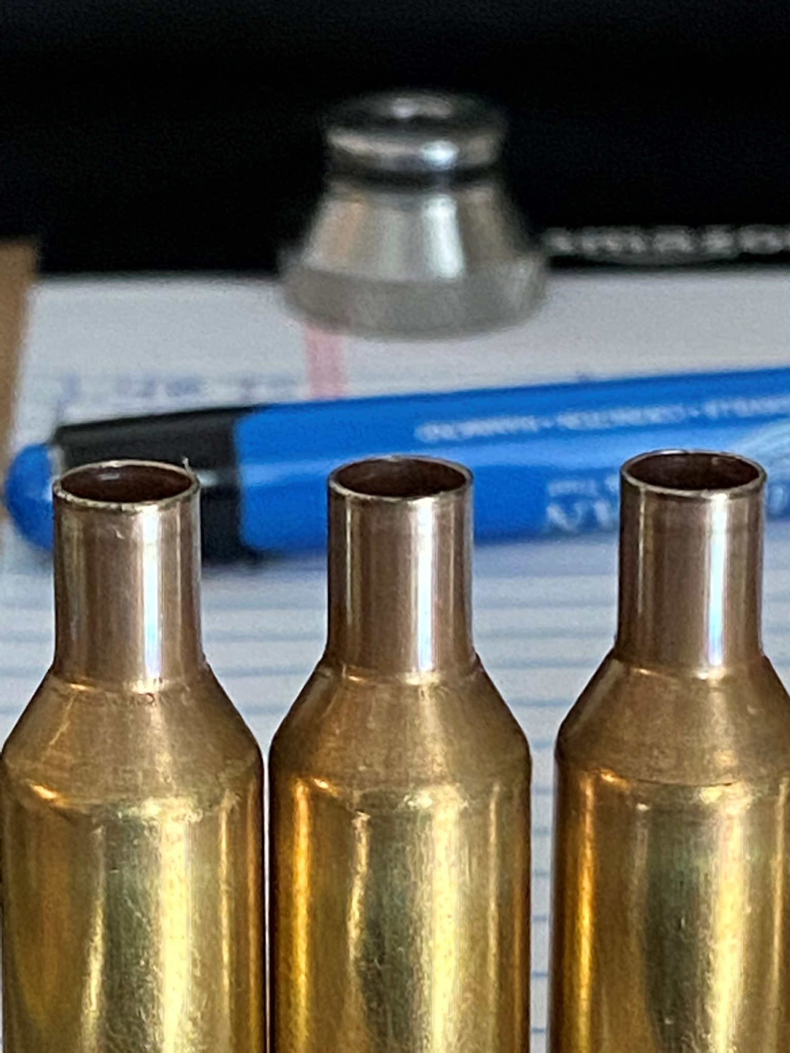

I lubed it up inside and out with Imperial Sizing Wax, pulled the expander ball, and still had issues.
The problem is, when you have to use the amount of force I was using on a Rock Chucker to size cases (into the die, and then pushing back over the expander ball as a separate step), something's wrong.
IIRC, my cheap RCBS .223 dies only size .005" under the final diameter before going back over the expander ball. The Redding .22BR die was sizing .018". I fail to see where that's good for buck-a-piece Lapua cases. I've got a dozen sets of el cheapo Lee dies and even they're better than that.
I don't mean to hate on Redding. I've got some of their other stuff, and it's great, but the .22BR FL die is an abortion and better alternatives abound.
I see, yeah i also use a rock chucker and was using imperial wax on my first 100 brass. The one shot lube seemed to make things run ok for me. Just sharong in case anyone else wanted to try it before spending more money on a new die. I do use the bushing die after the first firing and beyond.
You don't have to neck turn or turn the shoulder.
Size it down and shoot it. Its been covered previously in this thread.
Does your reamer have a certain spec neck diameter for no turn cases? From a lot the reading I've done on a few other boards sounds like they were all having to turn. This was some time ago though.
Sizing 6mm BR to 22 BR.
We use a Forster 22 BR Full length die that we had re-polished to .007 larger. Lube new case with imperial, into die. Load
Then go to the bushing die after formed.
I use a .255 Nk
There's always been a lot of variants of this case out there. So getting in on this round for precision rifle (not a varminter) early like I did meant a lot of trial and error.
I started with a rental reamer my gunsmith grabbed. Completely unusable. Had to educate myself on all the variants. Then grabbed a Norma/Lapua reamer from Manson. It had a .252 neck and .050 freebore. That definitely needed to be neck turned. So I bought a neck reamer that opened it up to .2545, which works excellent. And also picked up a throater and experimented with a bunch of different freebores.
I just ordered a reamer from Manson with a .255 neck and .130 freebore. I'll be using that reamer for everything going forward.
You've def done you're homework. 130fb is bout perfect for 85.5-95gr match bullets?
Yes, I've found it to be pretty much the perfect fit. I've ran .050, .100, and .180. My most recent barrel is running .130 freebore and I'm jumping Berger 85.5 Hybrids .050. The bullet is well out into the neck above the juncture, I'm running faster than any previous barrel and pressure is excellent. SD has been <5 for the first 500 rounds. Its absolutely stacking my shots all the way out. My money is on I'll be able to run this load and seating depth for the life of the barrel.. I'm going to stick with this going forward.
Here's my thoughts on bullet selection.
The 85.5 Hybrid is money. Its just that simple. That bullet flat out shoots in this round.
The 88 ELDM is also a very good choice. They are inexpensive and shoot very well. They give up a slight amount of BC to the Berger, and they aren't quite on the same level of performance. I've ran about 5000 or 6000 of these through the 22BR, and I do like them. Inside 900 yards they perform as well as anything out there. But if the BR were my primary competitive rifle, I would run the Bergers.
The 95gr SMK is attractive with that high BC, but I couldn't get the velocity I wanted to run it. I saw a few guys post up that they were able to run them over 2900fps, which is the minimum I would want to be at. But I hit heavy pressure at 2900. And honestly, even at that speed, I'm not sure I would take it over the Hybrids I'm running at 3030fps. So the SMK is going to have to be individual trial and error. It didn't work for me. And ideally it would need more like .150" to .170" freebore. You can get away with less, but I think to seat the bullet in the best spot, more is better.

So my barrel is shipping, brass and bullets. I just need get some dies. Forster micrometer seater, and as far as sizing dies: I can borrow my friends 6br bushing die to step the necks down. I was thinking about getting a forster FL die honed to 249 as loaded necks will be around 251 w/o turning I believe. This sound like it'll work? I have turning and expanding mandrels which leave 2.5 and 1.5k nk tension. The forster expander ball will leave 2k nk tension.
Speaking from experience Forster will only hone out to .245 but thats not really oversizing too much and it's better than most other alternative non bushing FLS dies.
Im just about to start a side by side comparison 220TB shooting 90smk @ 3000 to a 22BR shooting 90smk @ 3000.
I was just about to order a reamer from Manson myself with longer freebore because my smith's 22BR reamer is also in the .050 range and I want something over .100 freebore. Looking for the 90smk and 95smk to have the bearing surface right at the neck/shoulder junction.
Do you have a print for this new manson reamer you can post or PM me??

I have mine but the freebore is .195" if you want it.
Sure send it over . Thank you
I've been very happy with my 2 22brs done with this reamer. No issues at all
Looks like a good print. The .255 neck is a must, and pretty much ideal.. Freebore is easy to set.
I ran a .180 freebore for 95gr SMKs. It was appropriate. I had a lot of jump when I ran 88s through it.
I'll be running 90smk and 95smk. Just want it to be close to the lands with the bearing surface right at the neck/shoulder junction. Plenty of neck to chase the lands down the road.. I won't be shooting lighter bullets
Haven't tried 90s. My first barrel didn't like 95s much and I have so many 88s I didn't try 95s in my second barrel.
