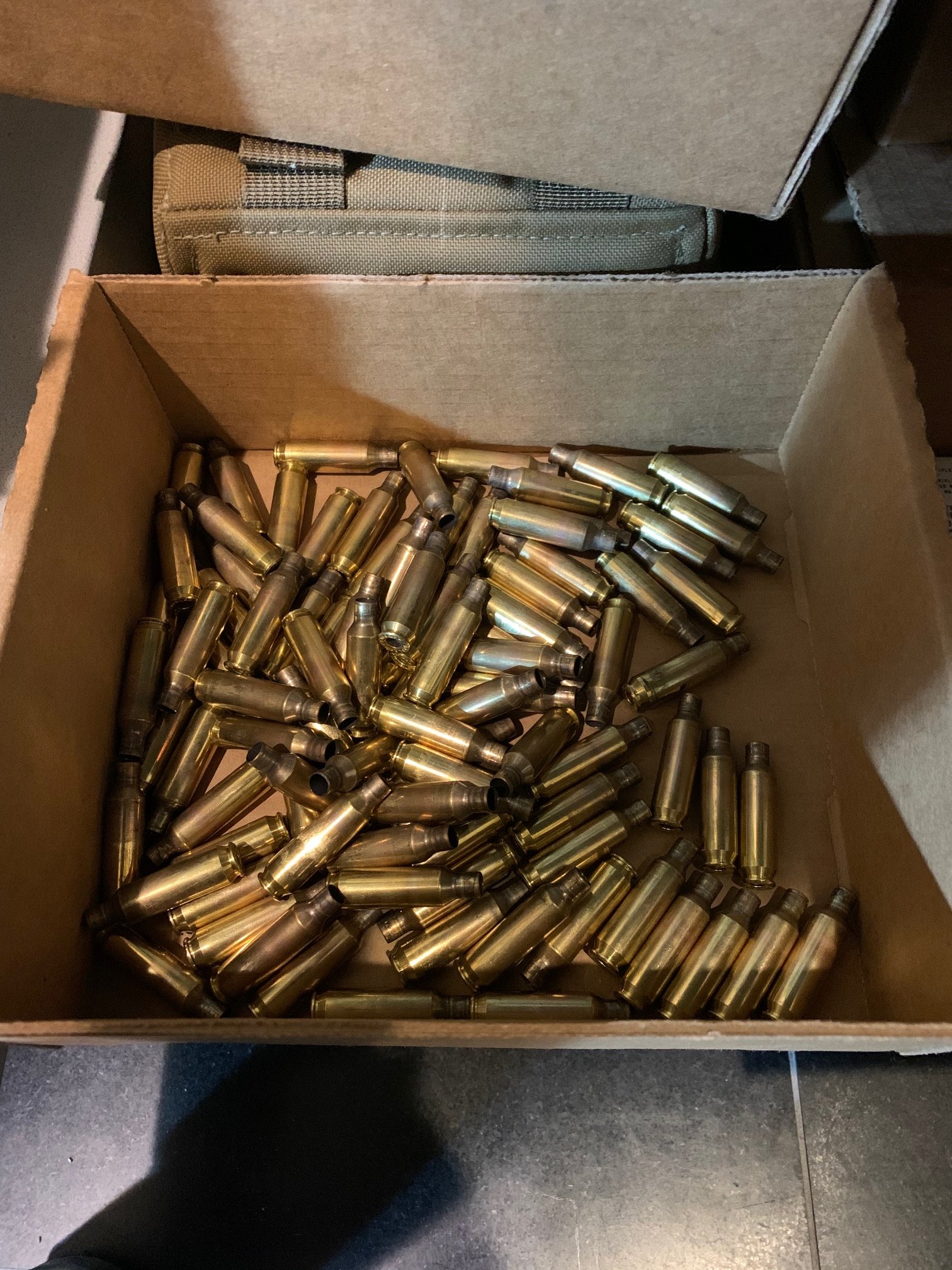

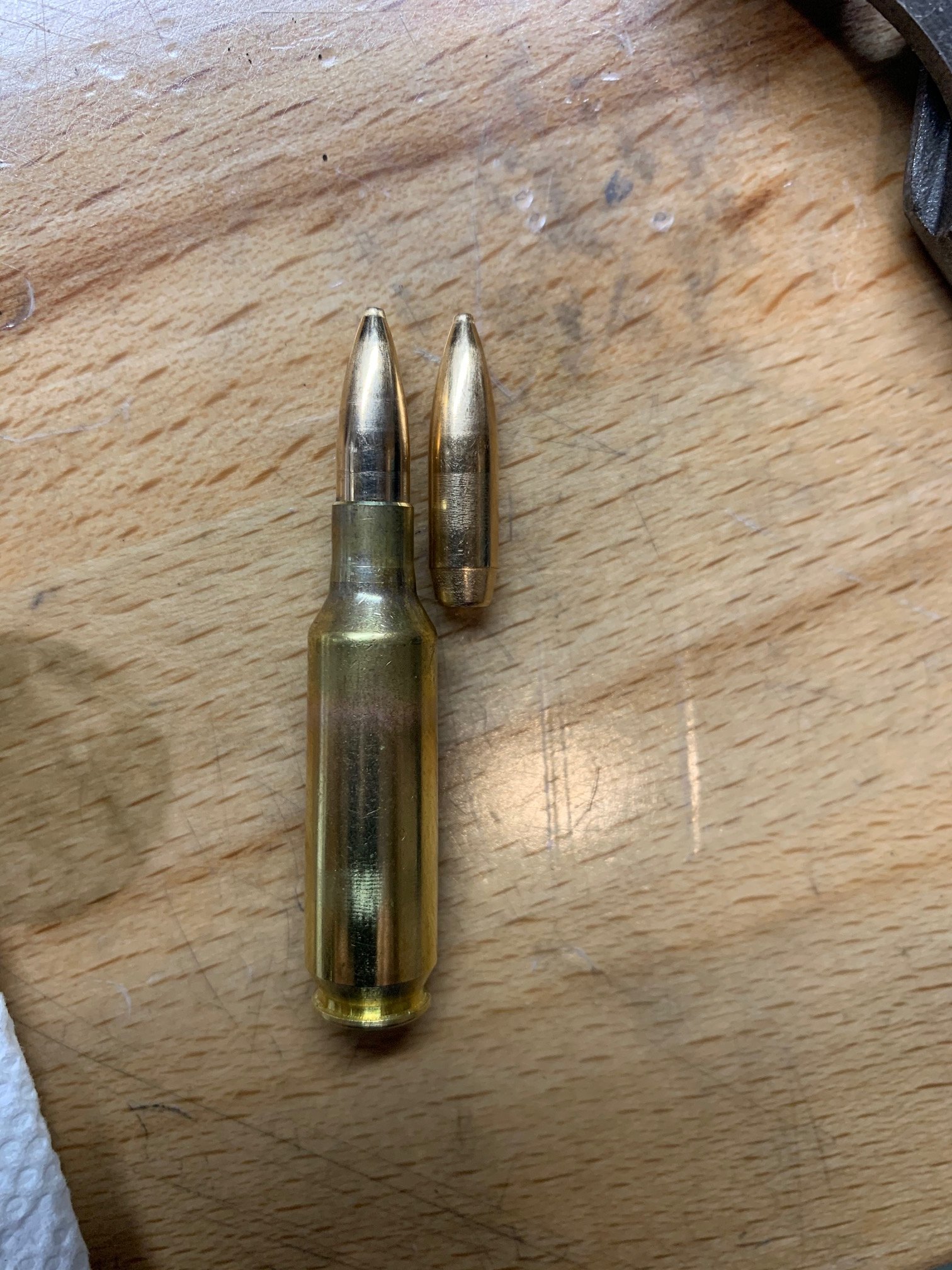

Alright here goes my Poor's attempt to make some Valkyrie brass. Enough at least to standardize on one brand for a bit.
A teaser.
Federal once fired capacity is 32.4 gr
Hornady Twice fired is 31.2 gr
Starline once fired is 31.9 gr
??? Mystery brass 1 x fire formed is 32.7 gr
The bad news is I have to burn components to form this Franken brass.

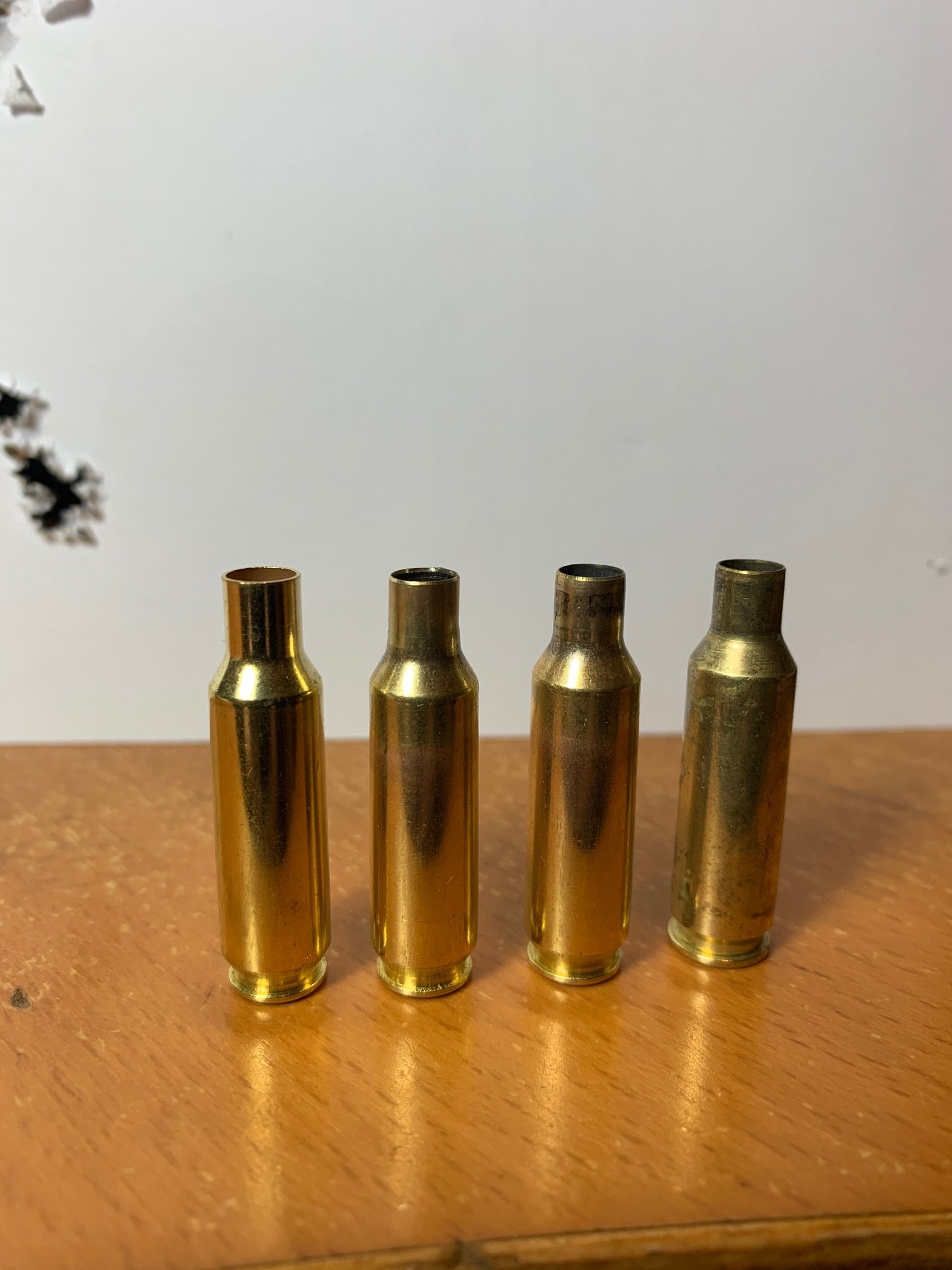

Left - Right: Unmodified 6mm, Neck down with Redding Type S FL die & .248 bushing, Fire formed, Far right is Starline 224.
Any guesses yet?
I did anneal prior to necking down & trimmed to 1.584 (about .008). After firing they avg 1.593. Did a mock up when setting up the sizer to leave a false shoulder. Just ran the bushing down till they would chamber. The datum/shoulder on these are .018 short of the Valk. Loaded these -.010 from the lands.
Didn't put a chrono on these but I'd guess 2950 ish. Good enough for practice shooting steel off bags. Had about 6 mph wind today, didn't matter & didn't care, @300 held center 8" plate - hit everytime.
I'm new to this fire forming crap, so I made a few mistakes with the first 100, but I'm happy to end up with 98 good fire formed cases. The 2 lost are due to loose primer pockets when I de-capped them. Loads were a we bit hot for fire forming. I've got 400 left to hone my skills.
My mistakes:
  1. To hell with the mandrel, next set I'll just neck with the bushing and seat.
  2. I stepped on these fuckers a little hard for a fire forming load. Next time I'll have more neck tension & back off on powder.
So for a load, my rookie ass used 25gr of 8208 under a 69gr RMR (left the cat litter in the HP).
Have a few thousand of these primers so I figured I'd give them a try. Compared to CCI #41 the Wolf seat a little tighter.

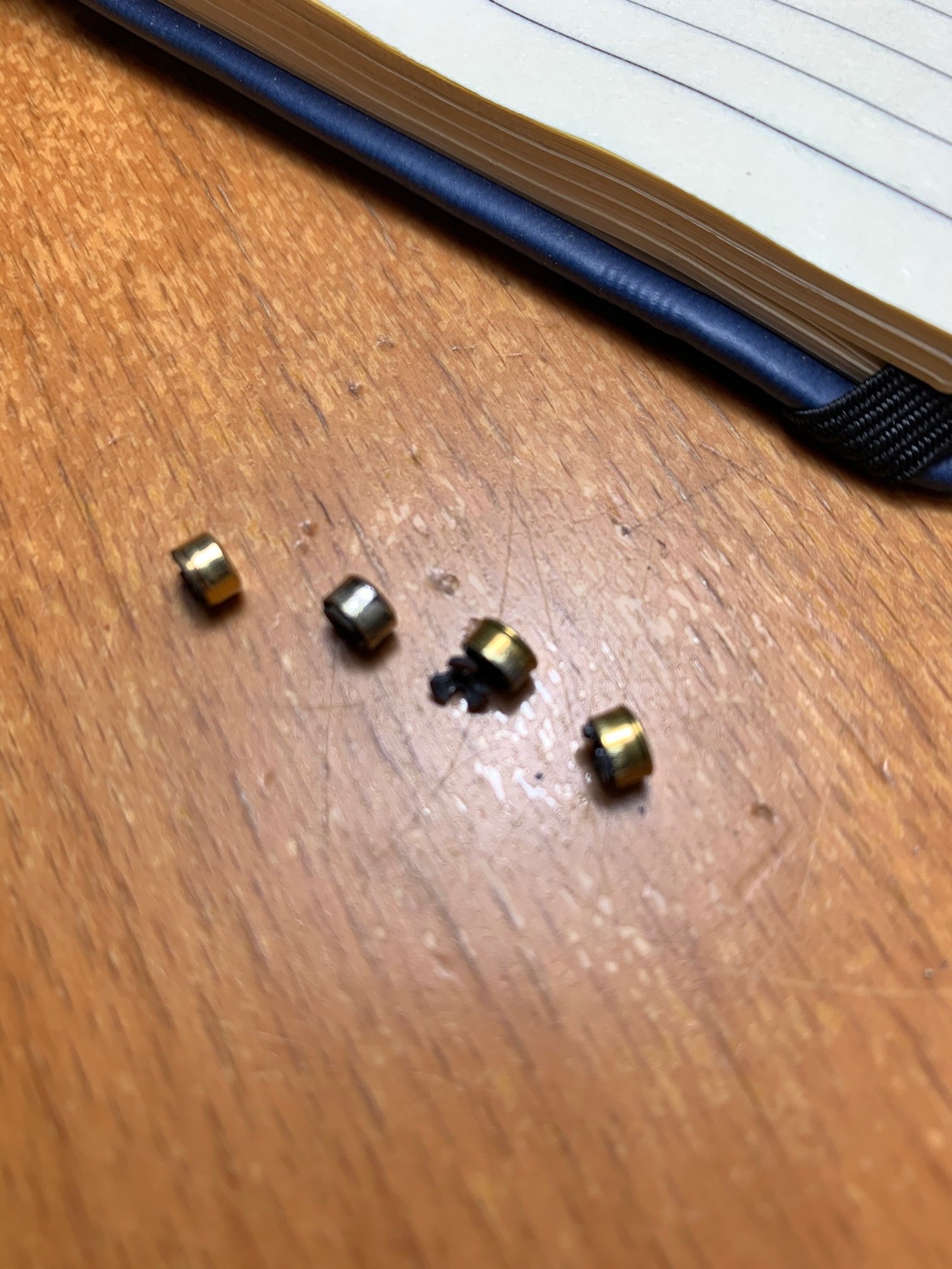

Yeah they were a little hot. Primers on right are from these fire form loads. The 2 on left are from a 224 Starline Lever load & a 6ARC Lever load.
A little extra rounded. So I tested the primer pockets pretty hard & 98 felt good coming out. Another interesting observation is this. The 2 cases that went loose on the pockets stayed at the exact trim length of 1.584, all the others grew to 1.593.

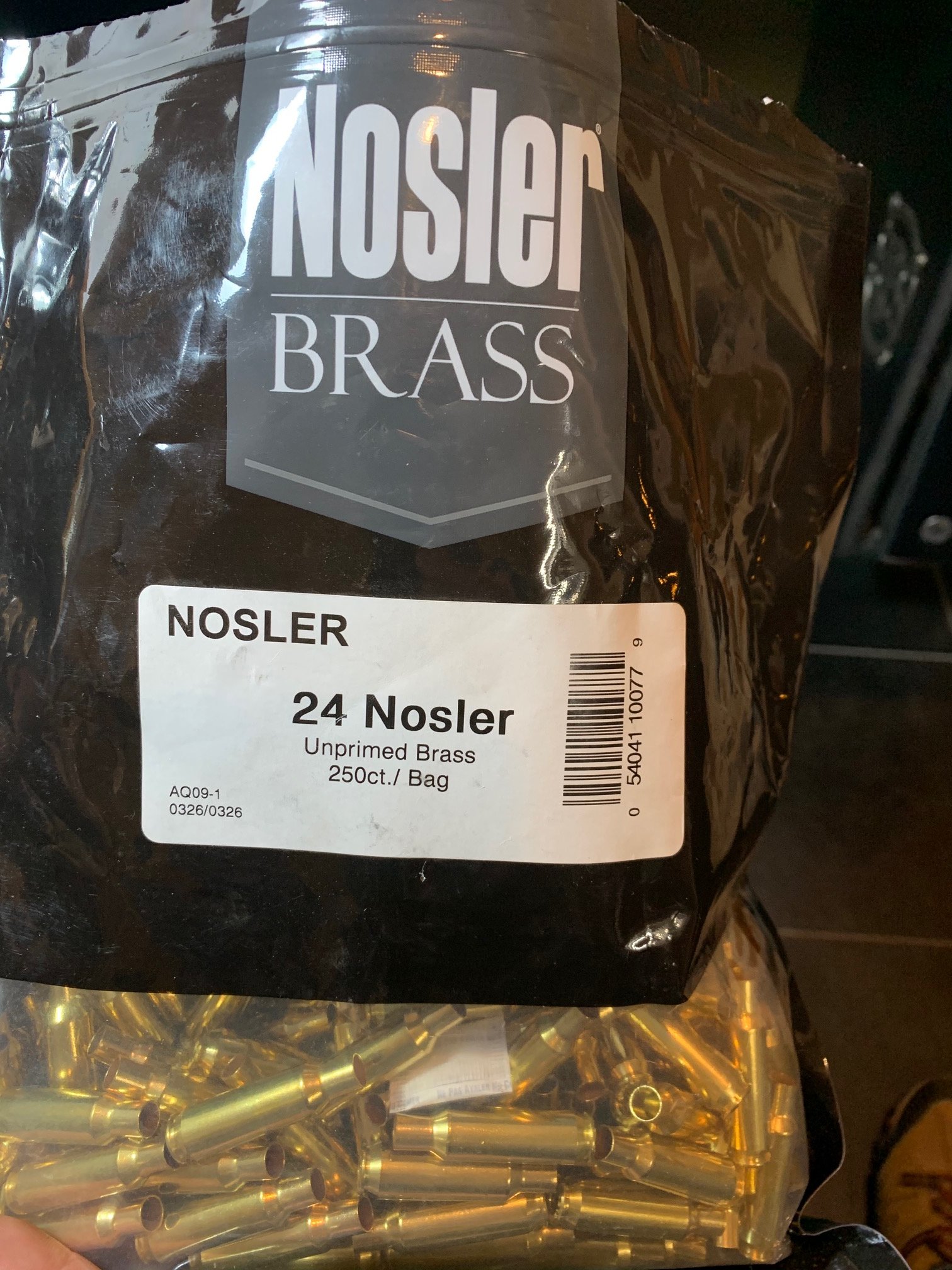

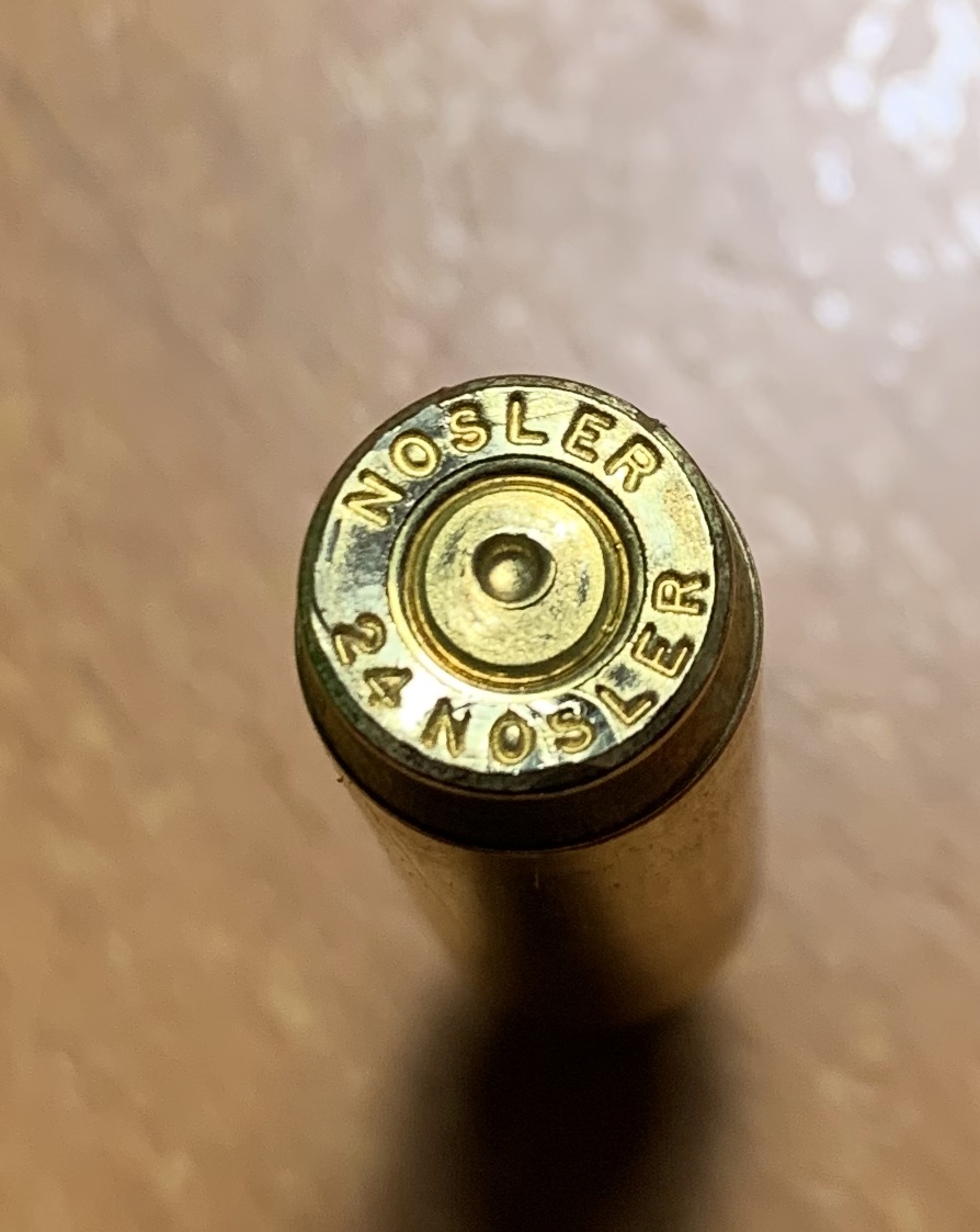

OK you got this far so What the Fuck are they.
View attachment 7866781View attachment 7866782
This is Important! 24 Nosler Brass requires a Std. .223/5.56 Bolt!!!!
I just swapped my 6.8 bolt for a spare .223, it ran fine. The shoulder length of the fire formed 24 Nosler using the 223 bolt is .002 shorter than Valkyrie brass from the 6.8 bolt.
This would be a pretty good solution for .223 bolt guns that want to screw on a Valkyrie barrel. A 223 Tika with a PVA Valk pre fit would be pretty sweet.
Don't know how well this will hold up, but now that I've got formed cases I'll see how it does with 88 ELD's & Lever. Will update after a few loading's.
I said in the beginning this was a poor's solution. Here's why. The 24 Nosler was such a turd they're blowing the brass out on clearance $99.95 per 250 with free shipping. That's the only reason I gave this a try.
It's probably more practical to just pick up a few cases of the cheap Federal 75 TMJ's for the brass, but it was a fun experiment.

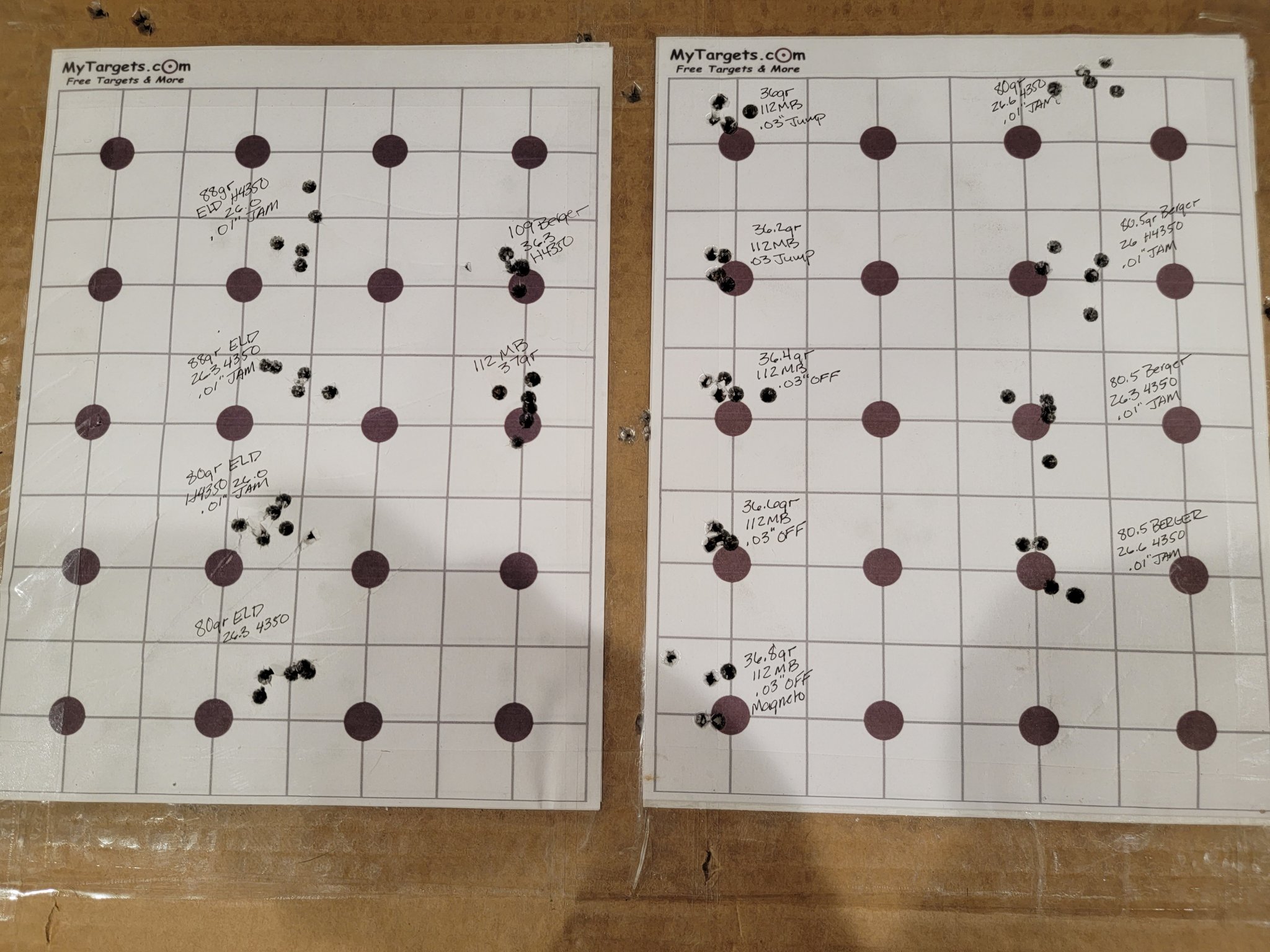

I did run some 88s today with H4350 and had some groups around 1MOA. Going to play with seating depth tomorrow to see if I can shrink those groups down any. Velocity wasn't too impressive, and there's no way to get any more powder in the case. Even so, I will take 2600ish FPS with an 88gr bullet.

Todays results. 5 shots / 100yds. .262 grp

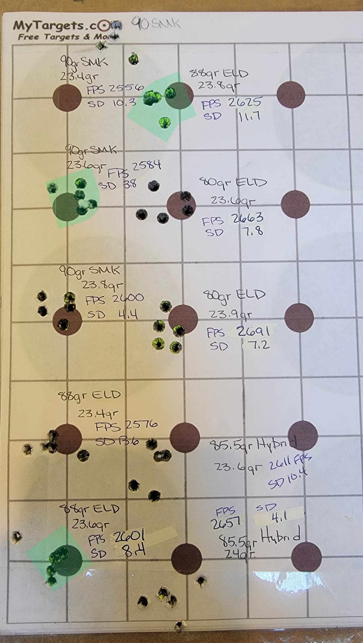

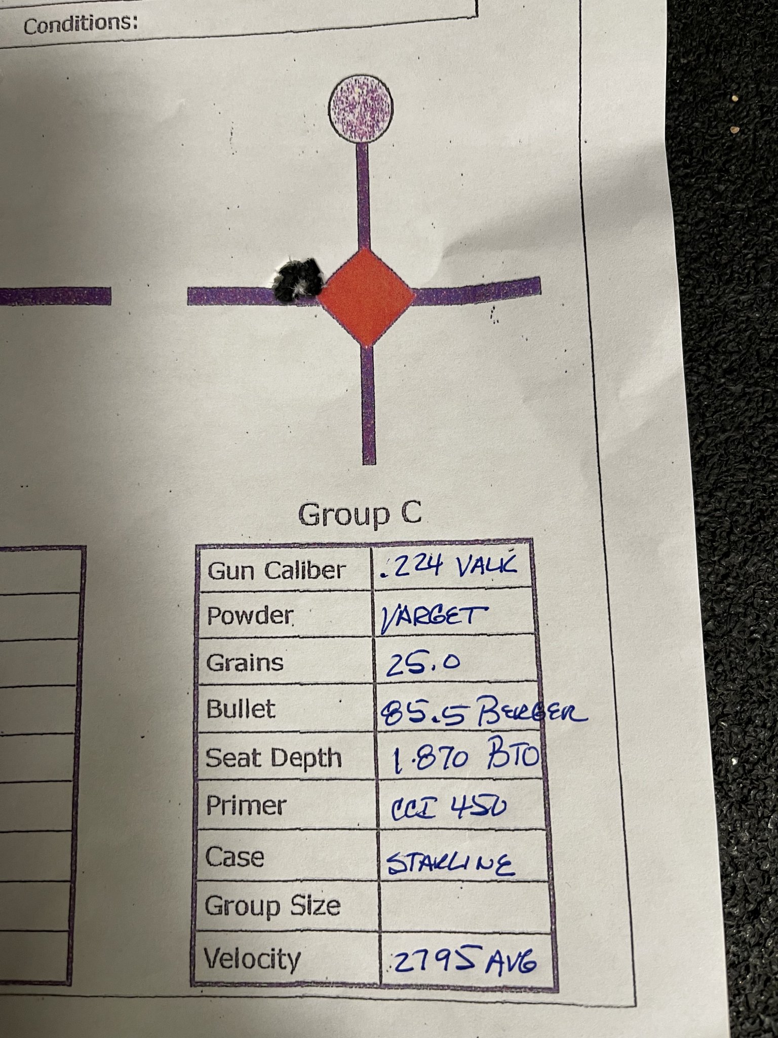

Found a couple pounds of varget to try and I think I'm finally on to something.
The 90 SMK and the 88 ELD both seem to like the varget. I have them seated just so they are touching the lands if not a couple thousandths off. The 90gr SMK were giving me great SDs and they will fit in a standard mag. Those were the first 15 bullets I have tried of those and I bet I can clean that up with seating depth changes. I will have to use a windowed mag for the 88s, but FINALLY I think I have something that will work. Wish I would have tried varget awhile ago, and it was easier to get.
The bottom left group I pulled one shot really bad. Plus for some reason the mirage was horrible today and even at 100 yards my reticle center dot was dancing all around at times. I'm sure some of these groups could be cleaned up a little atleast.

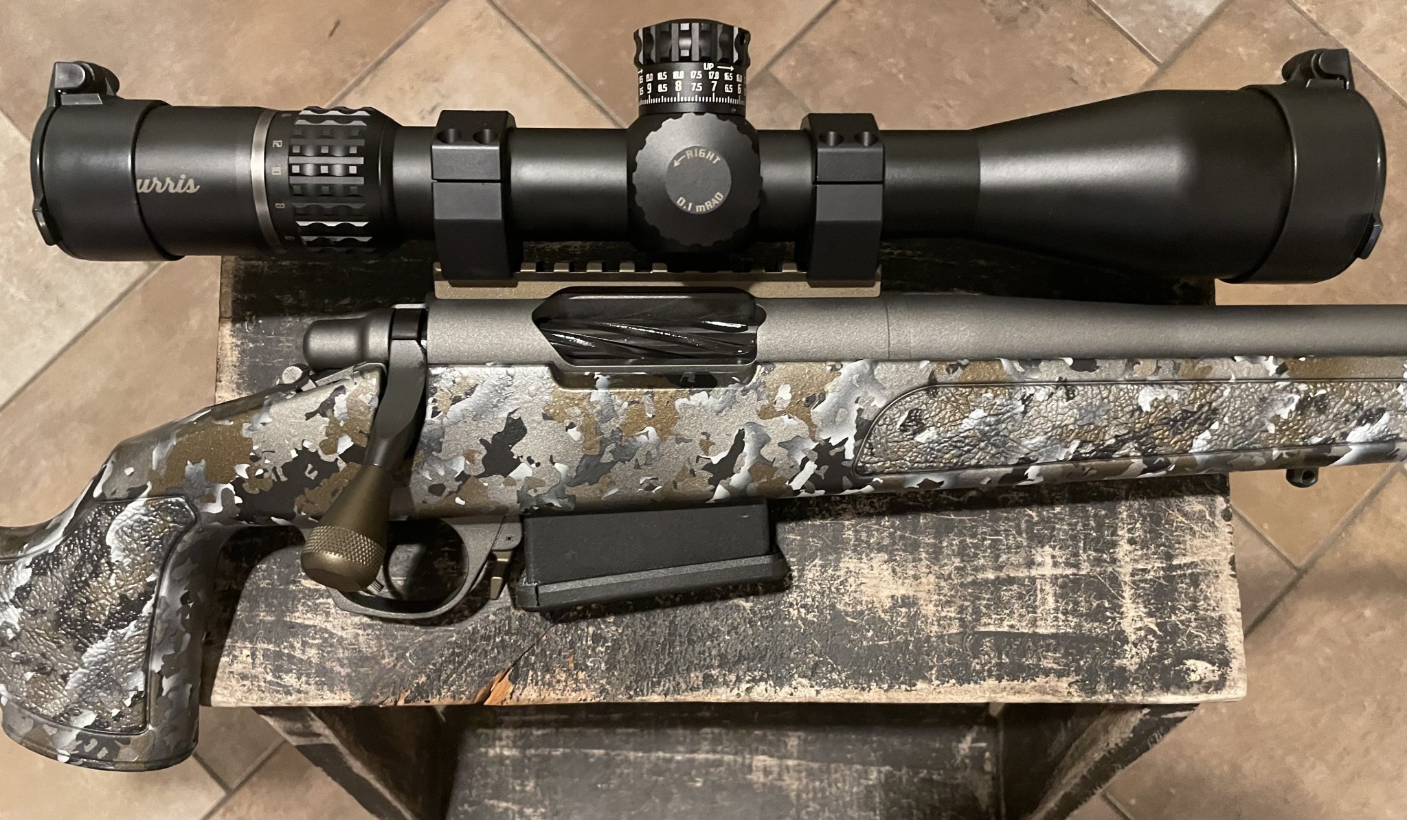

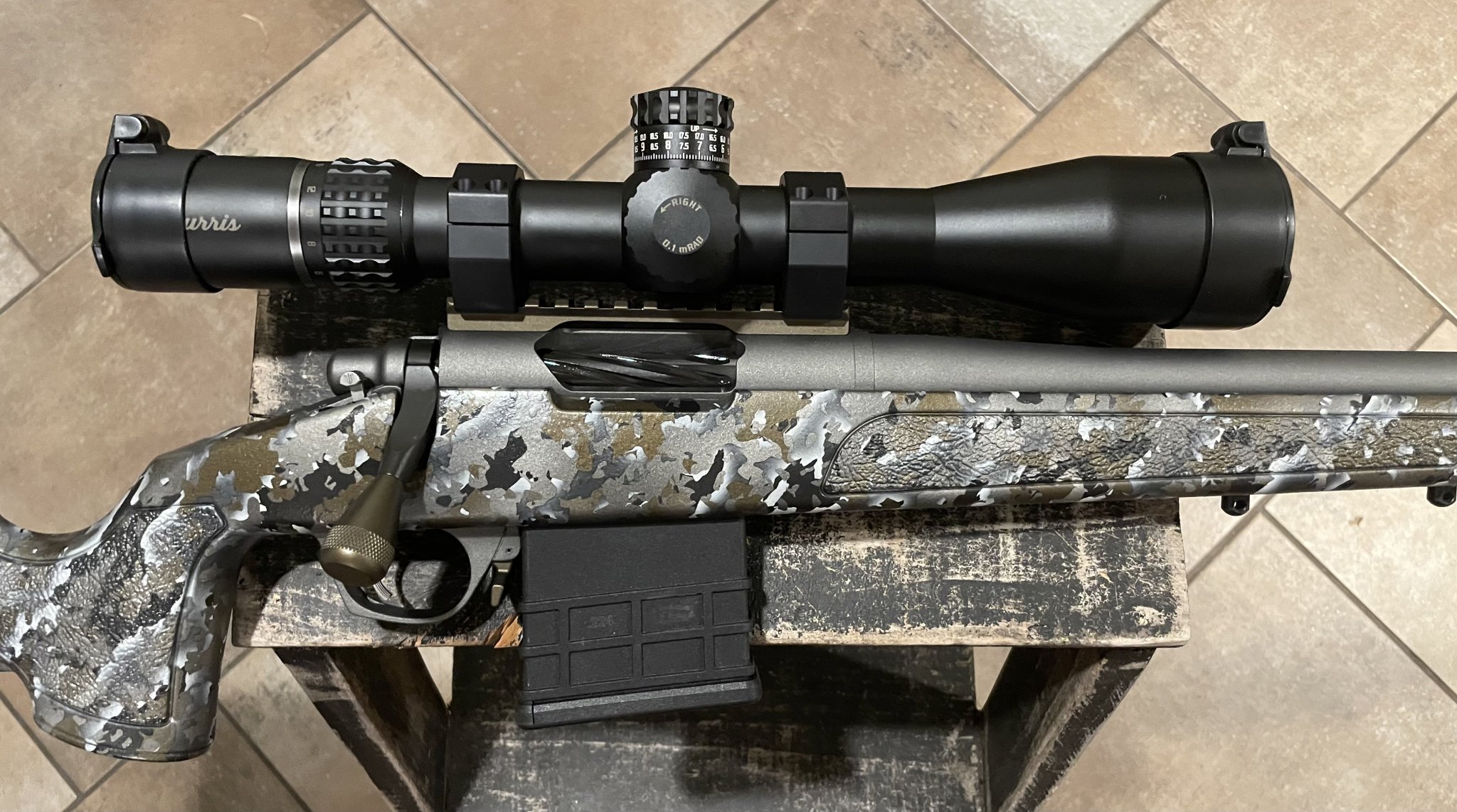

Ok, so as promised, the results of the Valkyrie and the 85.5 Berger bullets. This outing was using the load that I had previously posted a pic, and the data there in. Conditions here in Va today was HOT! 87-90 deg and humidity of 80% +. Overcast skies. About 430’ above sea level. No wind today, so bonus for me!
I shot the second relay around 10AM.
I had not taken this load out to distance, only 100yds indoor. Plugged the data from Berger as far as BC and bullet measurement , and Magneto Speed into the Kestrel, and let her eat.
The accompanying photos show targets and distances, as well as target size. They also show, according to spotter info, approximately where I hit. This is TOTALY a friendly match, and only prize is bragging rights among the small group of shooters, so spotter marks are approx, but generally reliable.
So one thing that stands out is that Valkyrie does not like to kill juice jugs! I shot three relays today and I think I only hit one, and that was with my 6.5x47. Guess Valkyrie has a soft spot for juice jugs? I shot another relay with the Valkyrie and smoked both eggs. So it is accurate and to anyone who doubts higher power scopes- get the 7-35 NF ATACAR! Made a huge diff on the eggs. And while I’m at it….I have an ATACAR on the 6.5x47. It is a 5x25. The glass in the 35x is much clearer to me than the 25x. Anyone know what’s up wit dat? Maybe just me….but I digress.
There is a dude in this thread , Diver something or other, who recommended I try the 85.5’s. I thought he was full of it. 80.5 at 3000+ is where it’s at! No wait, 90grn A-Tips at 2800 is where it’s at. Maybe 90 Grn Sierras?
Gentlemen and ladies, I’m here to tell you, if you can push the 85.5’s at around 2800 or more, it’s fn money!! The dope today was spot on +\- .2. Only targets I missed were the two juice jugs and one egg. I mean come on, an fn egg at 200yds. The juice jugs were totally me. When I sighted in on them the dot in my scope was jumping with every heart beat. I need a better rear bag arrangement to hold that crap rock solid.
This is all from a bolt gun with a brake. Hit me up if you want to know who built it. This is my new match gun. You have to be willing to give up hits at distance because the spotter can’t see it, and because low energy on impact won’t rock the target. On a cpl targets today the reason I got the hit is because they moved a bit when I shot. Valkyrie won’t rock the steel like the 300 Win Mag. It’s a stealth hitter. Sneaks in under cover and love taps the death punch.
I’ve got 6.5x47, 6.5SAUM, 6x47, .308, and am in therapy for the 6.5 Grendel (that POS). I’m telling you, this is my new match gun.
Now, someone shoot this thing suppressed so I can know whether to leave it with a brake or shoot suppressed.

25gr XBR, 85.5gr berger, starline brass and 205m primers 1.850 to ogive.
2896fps, sd 8
26" 1:7 Mueller Works 4 groove

I can't seem to get the accuracy I want with the higher BC bullets out of a gas gun. Maybe it is the barrel, but I haven't had such a hard time as I have had with this setup. Barrel has a 6.5 twist, so it should work. The problem I think has more to do with having to seat these bullets so deep in the case.
At this point, I have 500+ rounds on this barrel and the best loads shoot 1 moa. I guess thats ok, but not what I'm going for.
I can get the lighter weight bullets to shoot better, but it defeats the purpose of the cartridge for my intended use.
With components being as hard to get and as expensive as they are, I'm probably just going to stick with the tried and true stuff I have for now.
