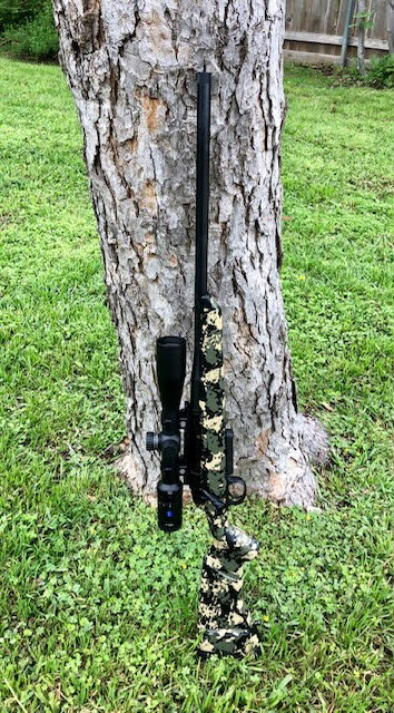

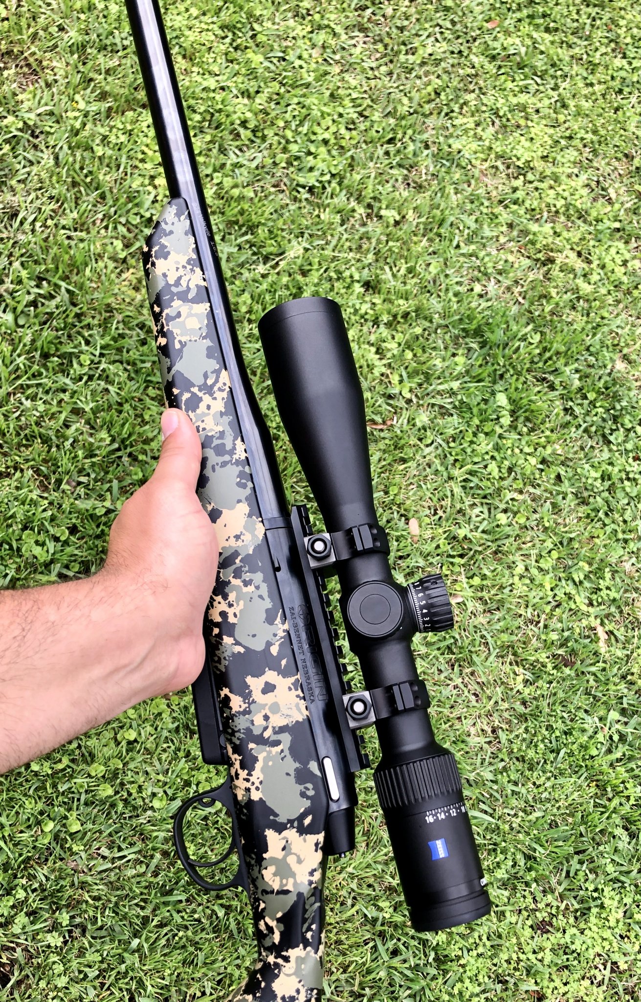

The 85.5gr and 88gr ELD-M shoot very well for me. I have a 6.5 twist Preferred Barrel Blanks in 22.5” for a Bighorn Origin Action w HS Precision DBM.

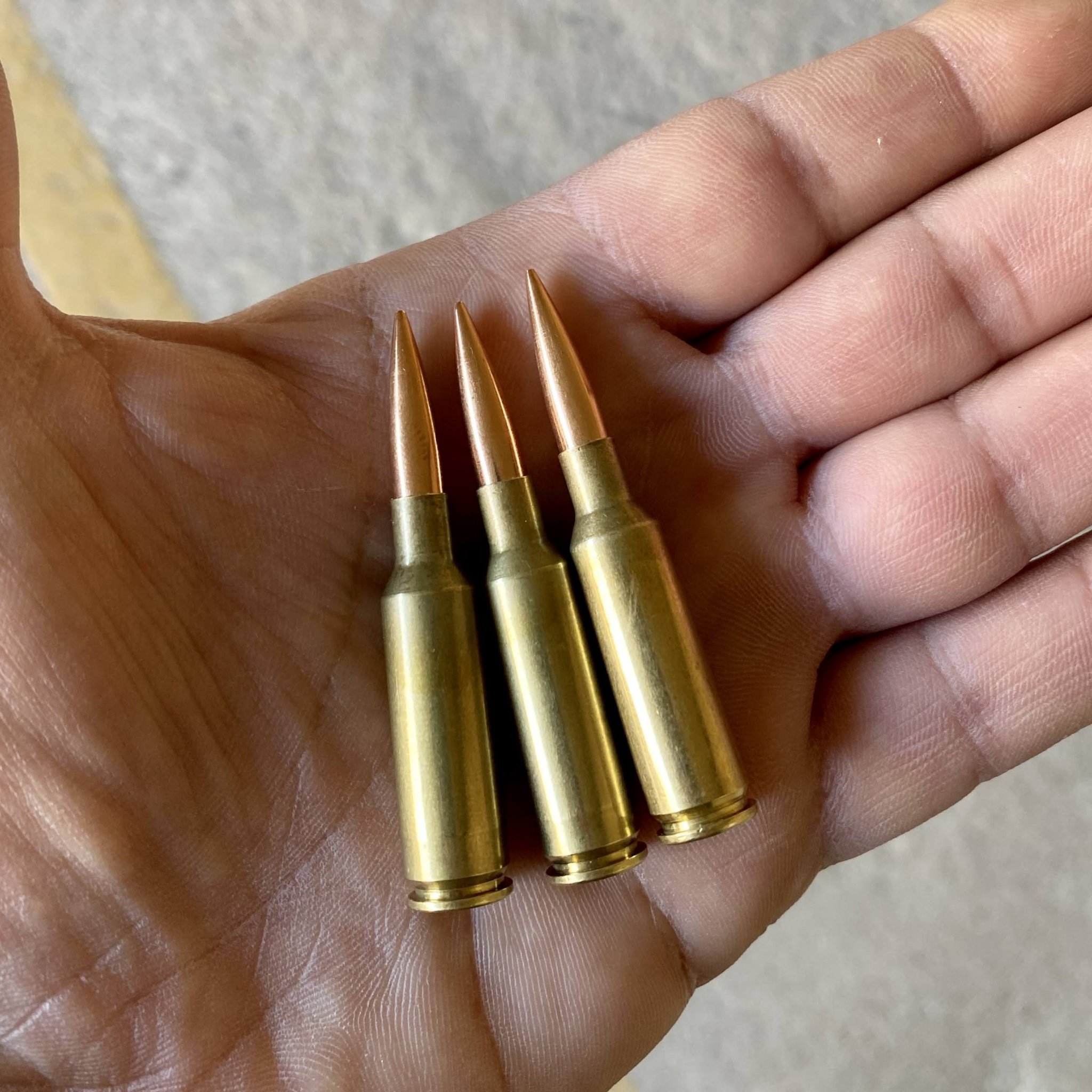

Took the advice of someone on here and had a special reamer cut so I could seat the 90grn Sierra out of the case to take advantage of case capacity. First time out today. This was the second 5 shot group down the barrel. Powder was BLC-2. Primer was 450. Brass was Starline. No data on velocity yet. Length was 1.865 BTO. OAL 2.375 with the Sierras. Group without measurements was with 90Grn A-Tips. Looks like I may have a shooter on my hands!
Can you post some pics of those rounds loaded? How are you liking BLC2?

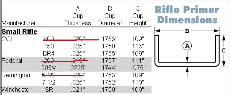

Looks like some of you are using small rifle magnum primers, load data I've seen shows regular small rifle primers. Are you using the SRM in an AR or is that bolt gun? Any particular reason or just what you had available?
I use SRM primers in my Vlak and 6.5 grendel AR's exclusively. Mainly because I use ball powders like CFE223, TAC and BLC-2 to achieve max velocities. That said, nothing wrong with SR primers with stick powders if accuracy is your primary goal.

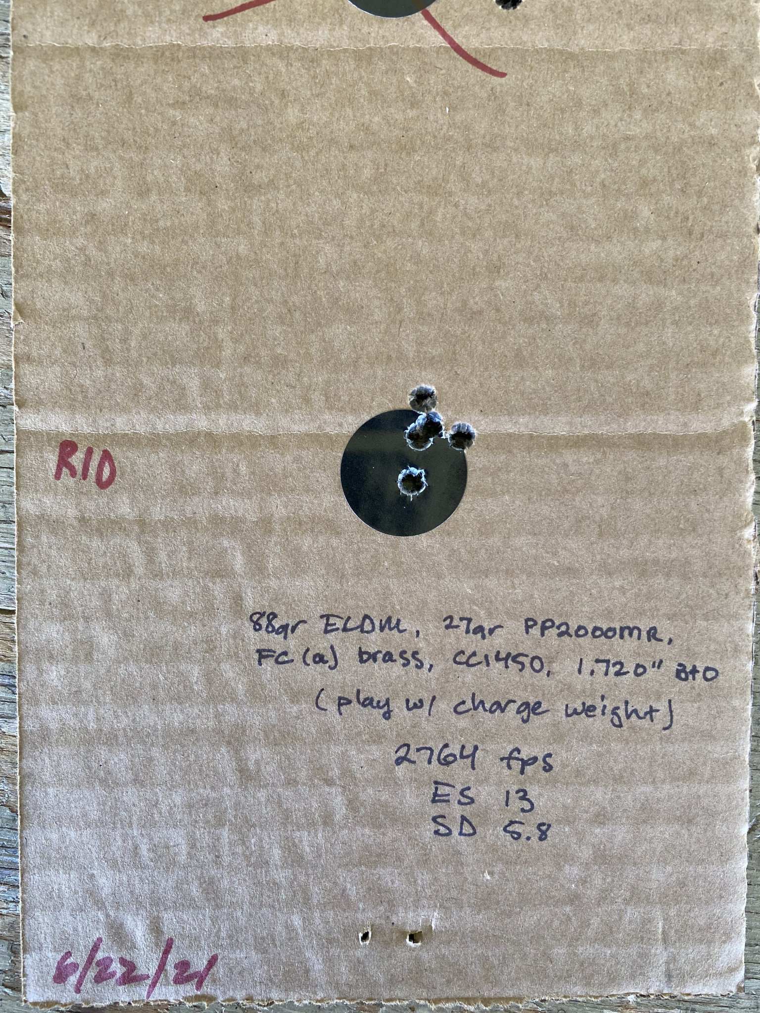

24" 1:7 barrel with 88gr ELD-M's........to get these up to speed any preference on Varget vs CFE223? I'm hoping to get up to 2850 or so.
Bolt gun .224 only got up to 2571 fps, with less than desirable SD. over 25.
I get 88gr ELDM’s with, 27gr PP2000MR, at 1.700” BtO to go 2752 fps ES 20 SD 9 from a 22” 1:6.5 twist bolt gun.
