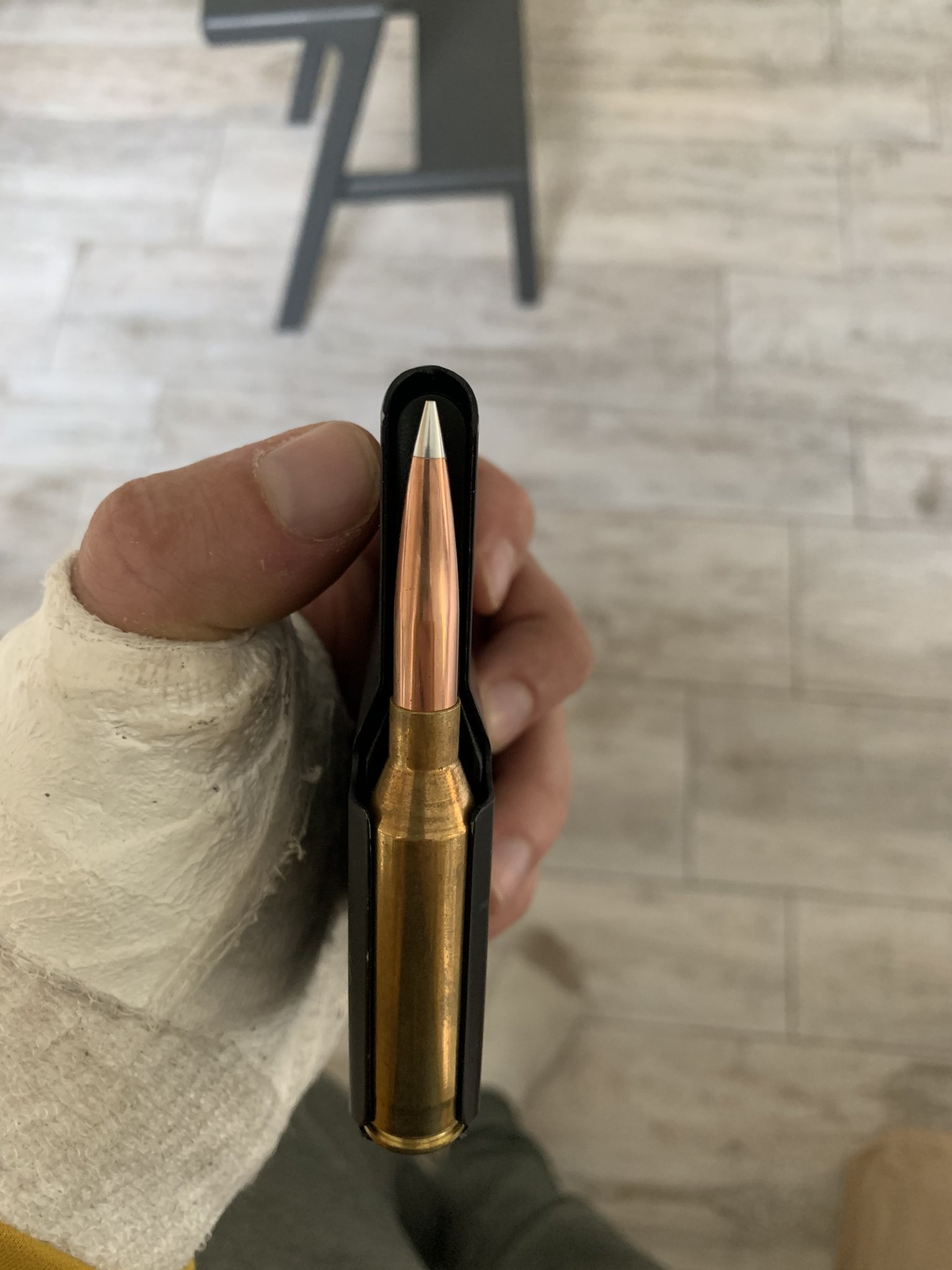

I had lousy luck with the ELDMs. The nose would get damaged in the magazine. First shot was great, the rest sucked.

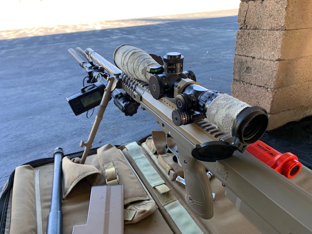

Shot my first rounds through my 300NM this weekend.
I did a work up with the following materials:
Peterson virgin brass
215 Berger Hybrid
FGM215M primers
VV N570 powder
seated at 3.595 OAL based off Mark Gordon’s distance to the lands test.
started at 81 grains because 300NM isn’t your moms 223. VV lists max load for this bullet and powder at 87.3 so I started at 81 and worked up to 84.
84gn N570 was 2940 avg with ES of 19 and SD or 9.5.
AI ASR factory 27 inch barrel that had only been factory test fired. I’m sure I’m going to see it speed up as it wears in. It only has 12 rounds on it now. No pressure signs at all at 84gn. I think I may push to 85 but I don’t really feel the need to find the limit. Peterson brass is known for having a bit smaller capacity than others so I may just stick with 84 and fine tune from there.

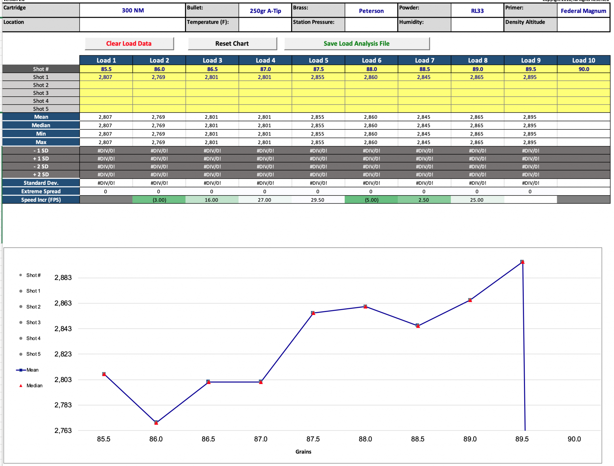

I tried RE33 in my 1st Norma a few years ago and the speed was impressive but the ES was wild, over 100 fps at times according to my cheapo chronograph. I've had much better results with N570, H1000 and Retumbo, with N570 giving the best results for me with the 230s. Now that my current 28" barrel has settled in I'm getting 3045 with N570 and 230 Bergers, single digit ES.
Reactions: Tchitcherine
Okay, RL33 pushed the Berger 220s really fast with no signs of pressure. The last charge weight in my test was 98gr which gave me 3244fps out of a 28" barrel, but the velocity graph for the whole sequence was all over the place, so I can't really identify a node. I'll try again next weekend and try N570 as well.

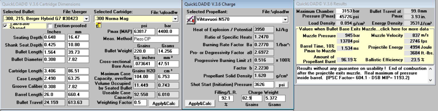

I was planning to load up some 220s with N570 today, but I'm seeing a serious discrepancy between Vihtavuori's data and what Quickload is predicting. There is no data for the 220 LR Hybrid specifically, but the 220 Scenar load range is 71.3 to 82.9gr, while QL says all of that is quite low. Naturally, I'll take the Viht data over QL any day, but it does seem odd to be so far off. I've been using QL long enough that I feel fairly competent setting values to more closely match the ranges I'm working with. In fact, for the past 12 years or so my go to methodology is to look at reference data and then use QL to compute powder type/ ranges to work up to. I've never seen such a wide margin of error before, which has me hesitating a bit.
Had a chance to try those 220s with N570 yet? My rifle just showed up yesterday, should have scope, brass and bullets in the next few days. The numbers you got from QL, is that for Lapua brass? Which primers and what OAL? I'm struggling to find load info for 220s and N570.
No, unfortunately the mismatch with data and QL made me a bit hesitant this round, so I instead explored the 220s a bit further with RL33. I used to run N570 in .338LM and .338LM Improved when I lived overseas and it was an easy powder to get, and while I should be able to compare those loads to get a safe ballpark for what I should use in the .300NM, that particular log book from 2010-2015 I suspect is still packed away in storage.
For the record, I'm using Lapua brass and Fed 215M primers with 3.585" COAL.

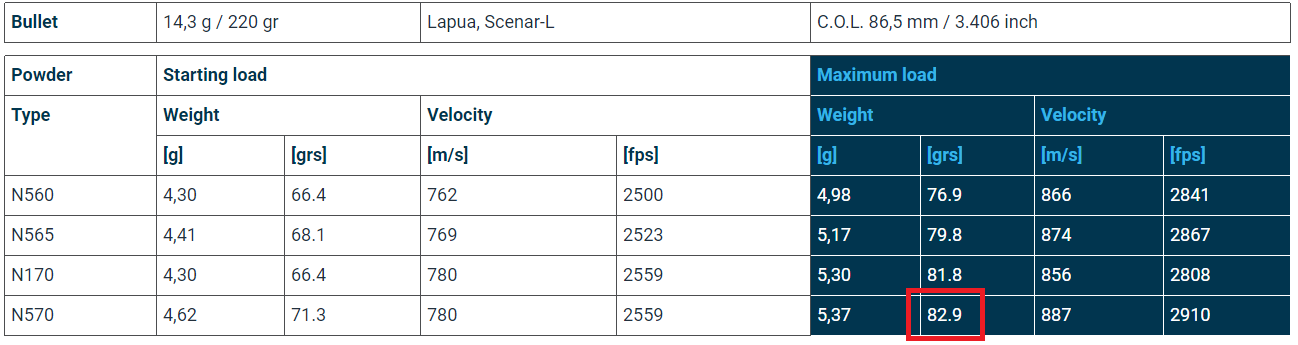

Using the 220gr Scenar-L as an analog for the Berger 220, Vihtavuori says the max load should be 82.9gr
If I try to duplicate those values in QL, I get results that are wildly off. Their max load nowhere near the max pressure and velocity is predicted to be almost 200fps slower. According to QL, the max should be closer to 90.0gr @ 3000fps.
Again, normally I would defer to the load data from the manufacturer, because QL is a general predictor of performance. I've used it for years as a way to test a variety of load parameters virtually, and help guide my load development process. So normally I look at the published data and then fiddle with QL to see the zone I should be working in, but in this case the discrepancy is way off. And with so little published data out there for this combo, I'm a bit hesitant.
To add to the confusion, if I plug the numbers I used with RL33 into QL, they generally correlate with the readings I got at the range (this is normally the case from my experience). The results I got with RL33 were impressive, but the unexpectedly noisy nature of the velocity curve makes me hesitant to continue. I may just take the time to load a batch with N570 working within the VV data's min/max zone, and I suspect there will be quite a bit of room to expand on it. I also have a bunch of that new Ramshot LRT I could try as well.

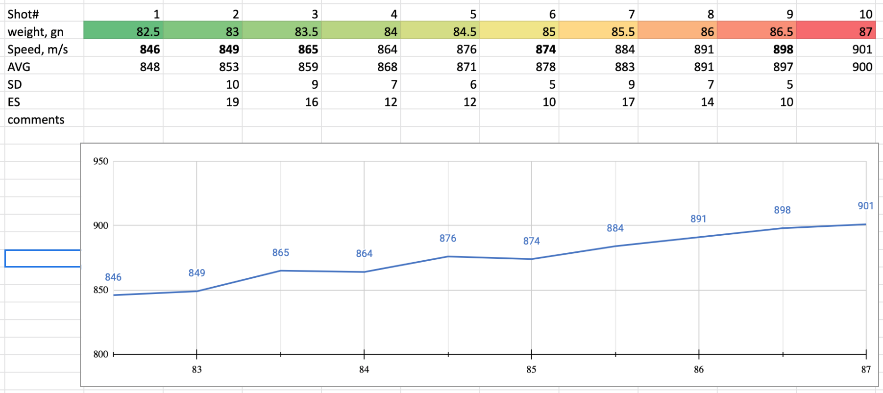

I did some more testing today with 220 Hybrid LRs and both RL33 and N570 and it basically confirmed that RL33 is just varies too much. I was getting really impressive velocities, but shooting a series of 5-shot groups across relatively stable charge weights gave me some unacceptable SDs and no standout groups. For context, in this same session I did some seating depth testing of a 6.5x47L load I've been working on and got some outstanding groups with low single-digit SDs. Switching to N570 and shooting a velocity ladder from 89.6gr to 94.4gr (at 3.585" COAL) I got much more stable results. Velocities were still pretty high (from 3077fps to 3315fps) but the velocity curve was much more consistent than RL33.
