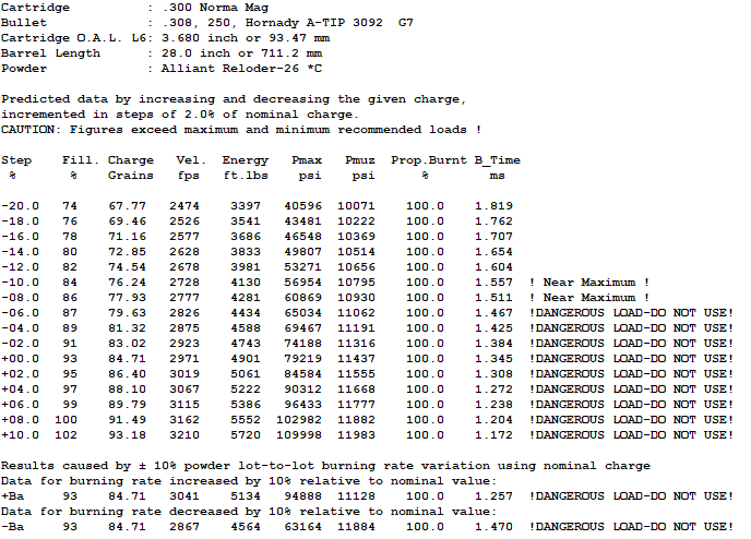

I'd load up that 85 grain load with the cci250's and run that. 2950 for a 250 is nothing to scoff at.

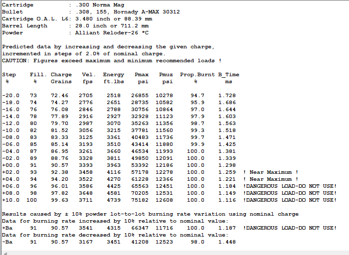

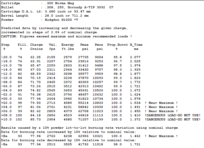

I just played around with what mass bullet would work (fill % > 90) with RL26 in .300NM and the best result was 155gr. So yeah, not a great option.
Go into Options> Loadable Table Settings> Set Loadable Table Step width> User defined>In weight increments. Then you set up in .3 .5 or a grain or what have you. Most of us load into the tenth...

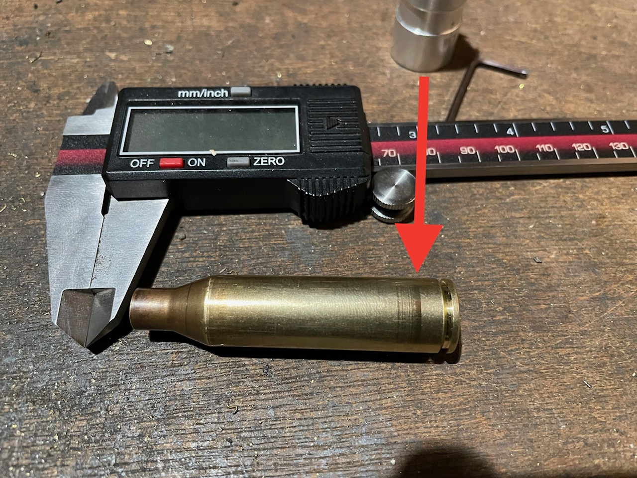

Had a chance to take some measurements tonight. For reference this lapua brass with 3 firings, loading up my 4th now.
Measurements:
- fired case .5845"
- reized cases .5835-.5840
- virgin case- .5775"
Here's a pic for reference. I'm taking my measurement roughly .2-.25" up (red arrow) from the bottom of the case, in the area that the die just barely touches. If it matters I'm targeting .002" shoulder bump. Also the resized cases run fine through my rifle with out firing.

Ah yes..... My trim length is 2.485". After firing and resizing, it seems like the cases have grown to 2.488-2.490".

That case growth is .004-005" more on average than I'm seeing.
Let me know how the test goes and re-measure eveything with that brass tomorrow.

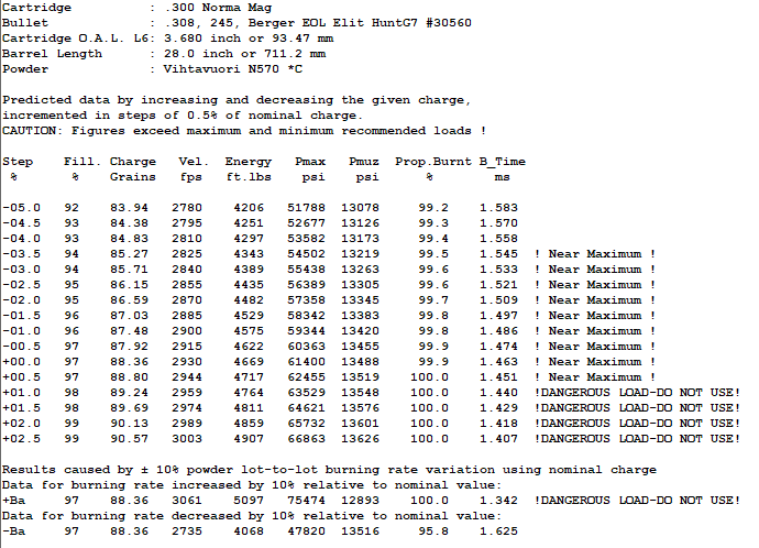

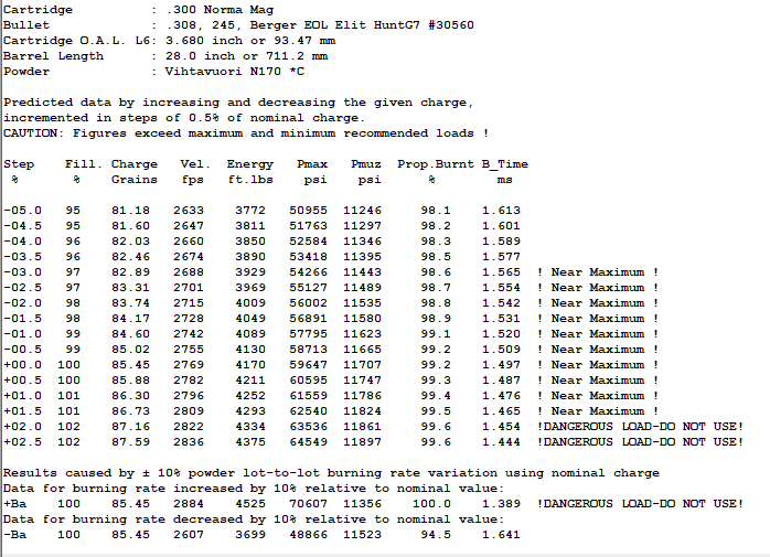

Here are some velocity comparisons:
N570
N170
So right off the bat, you're pretty much losing at least 100fps by switching to N170, but look at the reduced pressure. It's not a huge difference, but you could argue that if you run N170 you'll likely get less throat erosion, at the cost of velocity. But you could also just shoot N570 in a milder load and avoid rapid strings and probably get less throat erosion as well.

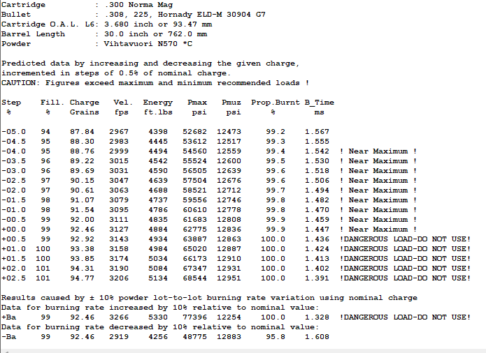

The problem is that N570 is almost the perfect powder for most 200gr+ bullets in .300NM - it's just so well optimized. And if your priority is long range performance then you need to think of barrels as consumables. If you're hunting, you have quite a bit more flexibility and should probably run N170 anyway.

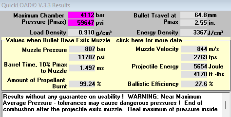

yep, this is what im shooting... I have a 30" 1:8 barrel, using 88.5gr of N570 and 225ELDM. im getting 3140 fps. this is an amazing 1 mile load. ive had consistent hits at 2200m. I do notice that N570 is very very dirty.
I have shot this combo with H1000, and don't love it. im going to explore with Retumbo soon to see if I can get N570 performance without the N570 grime and dirt!
I would say that I run this load quite hard. don't have serious barrel erosion signs, and im 600 rounds down the pipe now.
