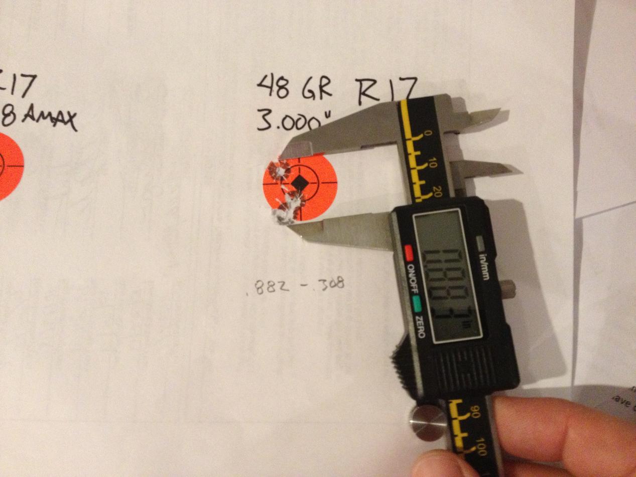

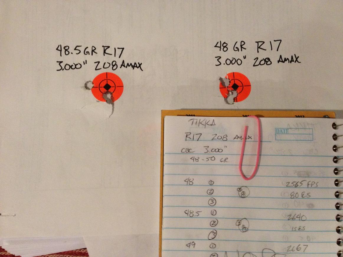

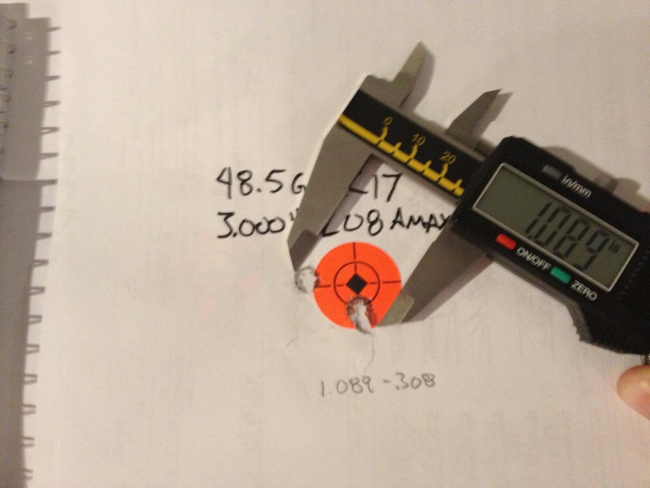

After picking up a Tikka 308 varmint last week I decided to give this a try since mag length will not be a problem ;).
Just like previously mentioned, I saw big changes in mv with each .5 grain increase until it plateaued at 49 grains- just under 2700fps & the group opened up significantly (and the bolt got sticky, and I had a primer loosen up). I didn't have any win brass on hand so i used CBC. Gotta say his breathes new life into the 308 as a hunting round (spare me the "not recommended for hunting" line- I've seen quite a few critters go DRT with these from 300 to 900 yards). I suspect I might soon be looking for some win brass to try it out in, but since it works with the CBC I'll see if I can dial it in a little more (see if the 48.5 gr flyer was me or the load). I'm hoping I'm on each end of a node with these two groups- we'll see. Thank you to the guys who contributed to this thread!
Reading this post got me shooting the 208's out of my .308 28" 5R. I could not get the Amax to group, and crunched powder to the point of inconsistent OAL's using RL17. I switched to Win brass, then switched to the 208gr hpbt, which is shorter, Alliant's 2000mr, then finally, the Wyatt's detach mag box. I have been pushing the 208 hpbt to 2640fps with 47gr of 2000mr. Now that I have a longer mag box, roomy brass and the shorter bullet, I may be able to use the rest of my RL17 in a practical manner. Thanks hardcore to Montana Marine for pioneering this concept here on the Hide. It has brought me into a new realm of distance shooting. Generally, poking steel at 1300yds, 1000ft altitude.
Rob, it was nice meeting you and burning some powder with the 308s. That's a sweet Tikka you have put together.
View attachment 9889 View attachment 9890View attachment 9891
