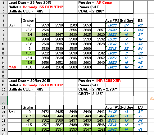

FWIW, my test results out of 16" AR10 "self-build"....
Load Date = 23 Aug 2015Powder = AR Comp
Bullet = Hornady 155 OTM BTHPPrimer =WLR
Ballistic COE = .405COAL =2.280"
GrainsAvg FPSStd DevES
Start42
2659​
2596​
2619​
2659​
26332763
42.2
2514​
2554​
2648​
2657​
259361143
42.4
2643​
2647​
2630​
2625​
2620​
26331027
42.6
2606​
2603​
2588​
2593​
2592​
2596718
42.8
2618​
2595​
2600​
2609​
2628​
26101233
43
2599​
2599​
2585​
2669​
26133384
43.2
2622​
2630​
2630​
2608​
2612​
2620922
43.4
2658​
2630​
2646​
2659​
2662​
26511232
43.6
2656​
2652​
2688​
2663​
2640​
26601648
MAX43.8
2640​
2661​
2683​
2669​
26631643

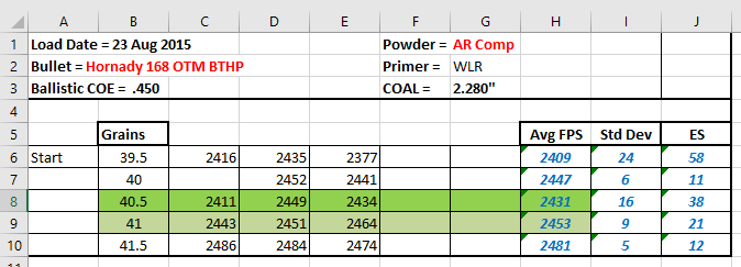

FWIW, 16" AR "self-build"....
Bullet = Hornady 168 OTM BTHPPrimer =WLR
Ballistic COE = .450COAL =2.280"
Start39.5
2416​
2435​
2377​
24092458
40
2452​
2441​
2447611
40.5
2411​
2449​
2434​
24311638
41
2443​
2451​
2464​
2453921

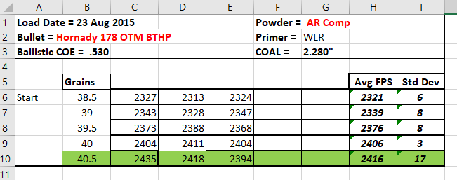

Bullet = Hornady 178 OTM BTHPPrimer =WLR
Ballistic COE = .530COAL =2.280"
Start38.5
2327​
2313​
2324​
23216
39
2343​
2328​
2347​
23398
39.5
2373​
2388​
2368​
23768
40
2404​
2411​
2404​
24063
40.5
2435​
2418​
2394​
241617

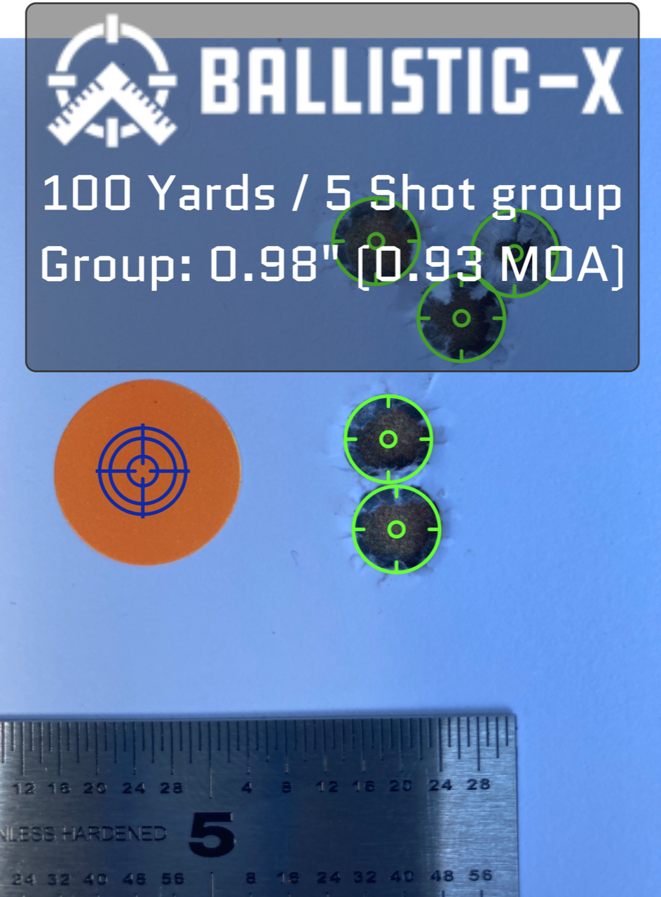

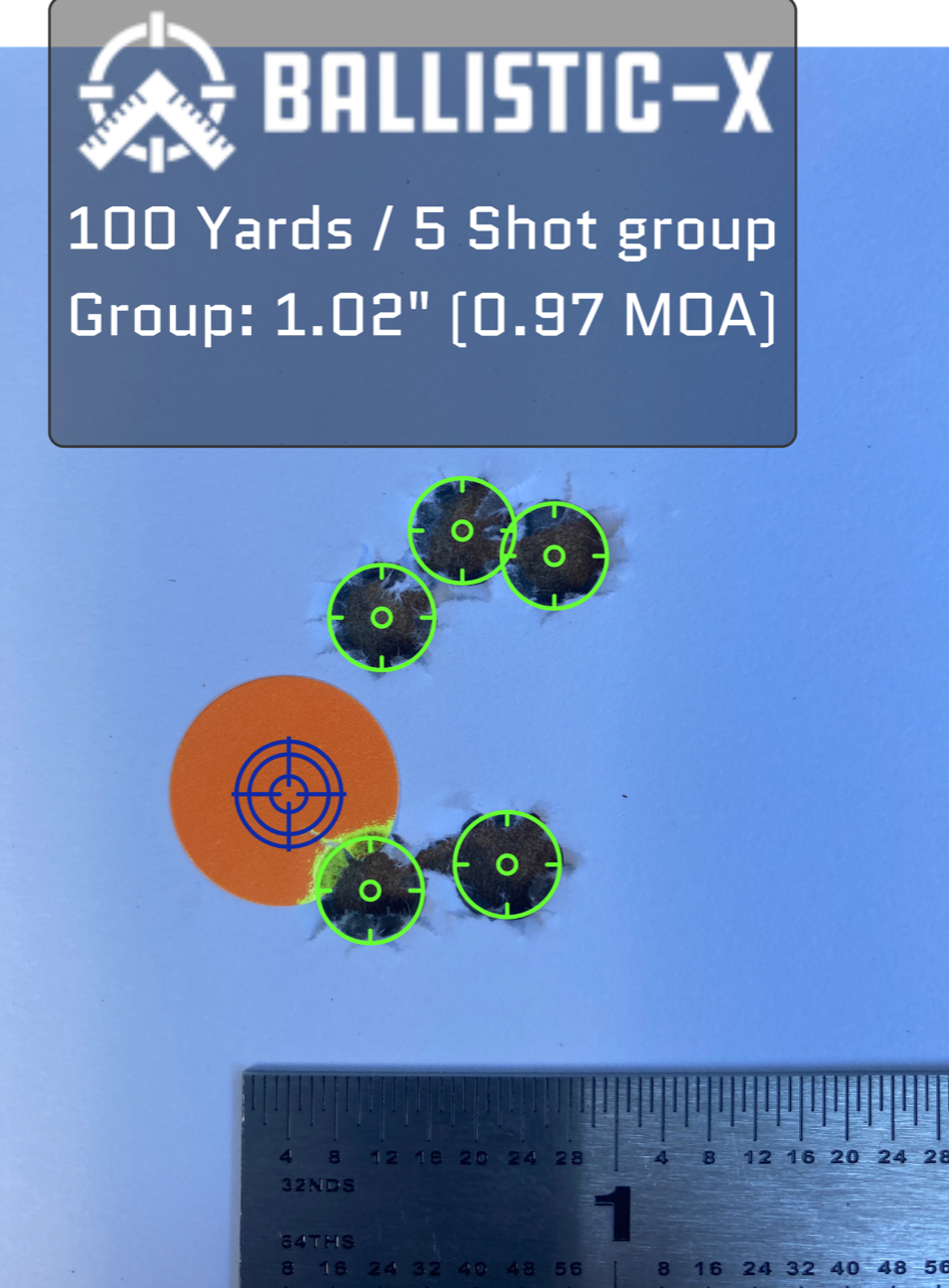

Finally got my AR10 308 shooting the way it's supposed to. Craddock Precision 18" (Bartlein) barrel. 5 rounds each @ 100 yards.
Powder. Varget, 42.0gr.
Case. Lapua
Bullet. Sierra 175 SMK
Primer. CCI LR
Ogive 2.195
What sort of velocity are you getting? Those are some fine groups.
