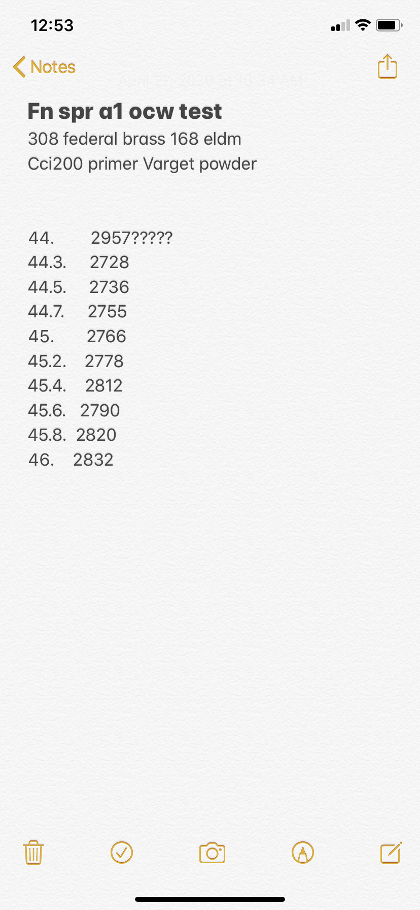

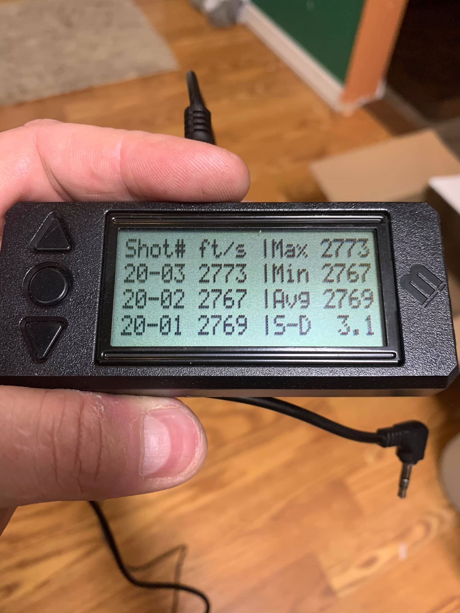

Did some load testing with my FN today.
Usung Federal gold metal match brass, 168 hornady eldm, cci200 primer. Velocity was out of a 24 inch barrel.Don’t know what happened in the first shot, chrono messed up. Started getting primer cratering at 45.8 and flat primers and cratering at 46.
I’m thinking of taking 45.1 grain and doing a seating depth test.
Just a little FYI:
Putting the numbers you have shown, and having pretty much the same MV's you're showing, my QuickLoad app is showing the pressure at 67,240 psi using 46.0 gr. of Varget. Using 45.1 gr it still shows above SAAMI max pressure at 63,153 psi. Though these numbers are really nothing more than an estimate based on available information, I would be very careful about going any higher than 45.1 grs of Varget . . . particularly if that load happens to be used in a much warmer environment. As you search for a more accurate seating depth, seating longer will help lower that pressure. Again, this is just a heads up FYI.
Just a little FYI:
I really appreciate the info, the fn bolt face makes it kinda tough to see pressure signs besides the primer, and bolt lift.
I have all these rounds seated at 2.850. My max mag length is 2.870. So can’t really go out in seating depth by much.
Do you think I should try a test around 44.3-44.5?

I ran those numbers at an estimated 2.840 COAL. For comparison's sake, if you going down to 44.5 gr, QL shows a pressure just under SAAMI max of 60,554 psi (plenty safe at a temperature of 70°F). At 95°F it shows a pressure up to 62,537 psi for the same load, just above SAAMI max, but that is probably still safe given you've started getting pressure signs well above that. Using your max mag length of 2.870, QL the pressure drop from 60,554 psi to 59,086 psi with an MV of around 2732 fps.
You might consider trying this technique: Pick a powder load (maybe like 44.0 gr) and test various seating depths to see which give you best groups. Then using only that seating depth, test various charges above and below that 44.0 gr. This will likely be at your highest accuracy node that is safe.
Based on what I'm seeing in QL, I wouldn't go higher than 44.5 gr so that I'd have plenty of room to work with and room for anything that might result in higher pressures. That's just me, though. ;)

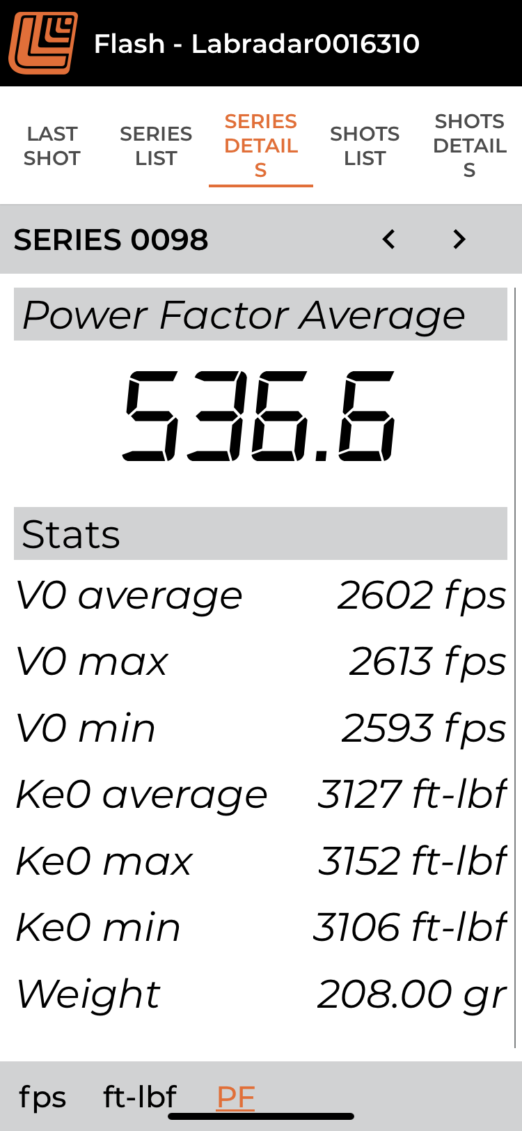

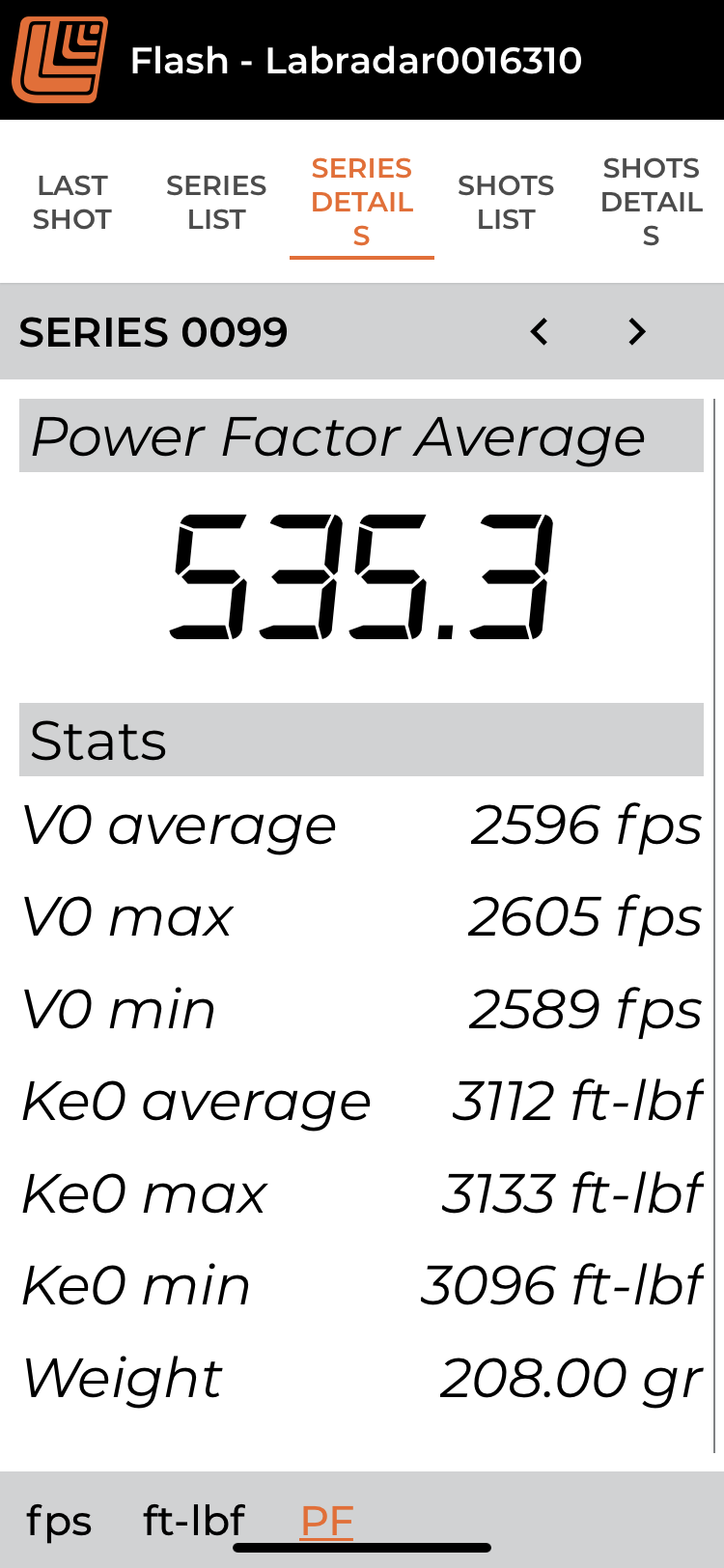

I also worked up some 208 eldm with rl17 with Winchester & lapua brass. OAL was 3.055, br2, 47.5 grains rl17 at .010 off the lands in Winchester brass. The Winchester with 47.5 got 2602 FPS average & es 20. No pressure signs at all in Winchester brass. The lapua was also 3.055, br2, 46.5 grains rl17, & es 16. The lapua brass had no bolt lift, ejector swipes, no flat primers but the base diameter was .4715, so it stretched .0006 over saami. Both of those loads shot .5in groups & bucked the wind better than any 308 bullet I’ve ever shot.
