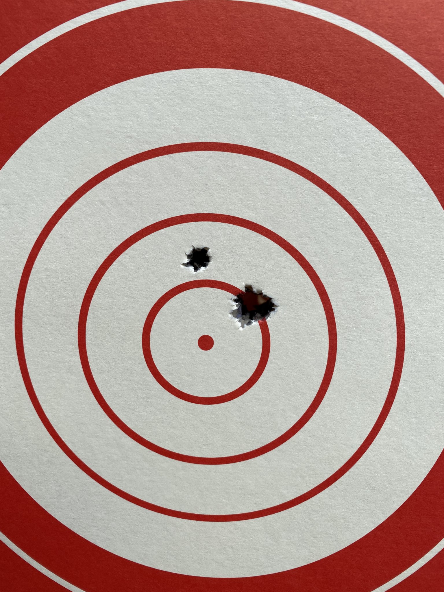

Got out today to test 142gr SMK, 41.5gr H4350, Alpha Munitions Brass (new).
Tikka T3X TAC A1 24in
Forgot I was not using my AR10 on the first shot. Heh.
5 Shots, warm rifle, not hot:
Stats - Average
2754.71​
fps
Stats - Highest
2767.92​
fps
Stats - Lowest
2745.48​
fps
Stats - Ext. Spread
22.44​
fps
Stats - Std. Dev
8.27​
fps
The cold rifle lab radar results:
Stats - Average
2760.36​
fps
Stats - Highest
2767.84​
fps
Stats - Lowest
2755.35​
fps
Stats - Ext. Spread
12.48​
fps
Stats - Std. Dev
5.16​
fps
Guess I’m done with load development.
Superb group!! Well done dude. SD and ES numbers are all superb!
Well, if that group or something vaguely similar repeats itself for 2 successive range session, say a week apart, you are most certainly done! Would be good to know that you don’t drop out of the node because of ambient temperature changes. Unlikely as H4350 is very temp stable (but not exactly perfect, and your primer will be temp sensitive, sadly that is unavoidable). If you are on the edge of the node (flat spot in speed graph), you might need to trim up or down by 0.1 or 0.15 gn. Btw what scale are you using?
Good shooting!

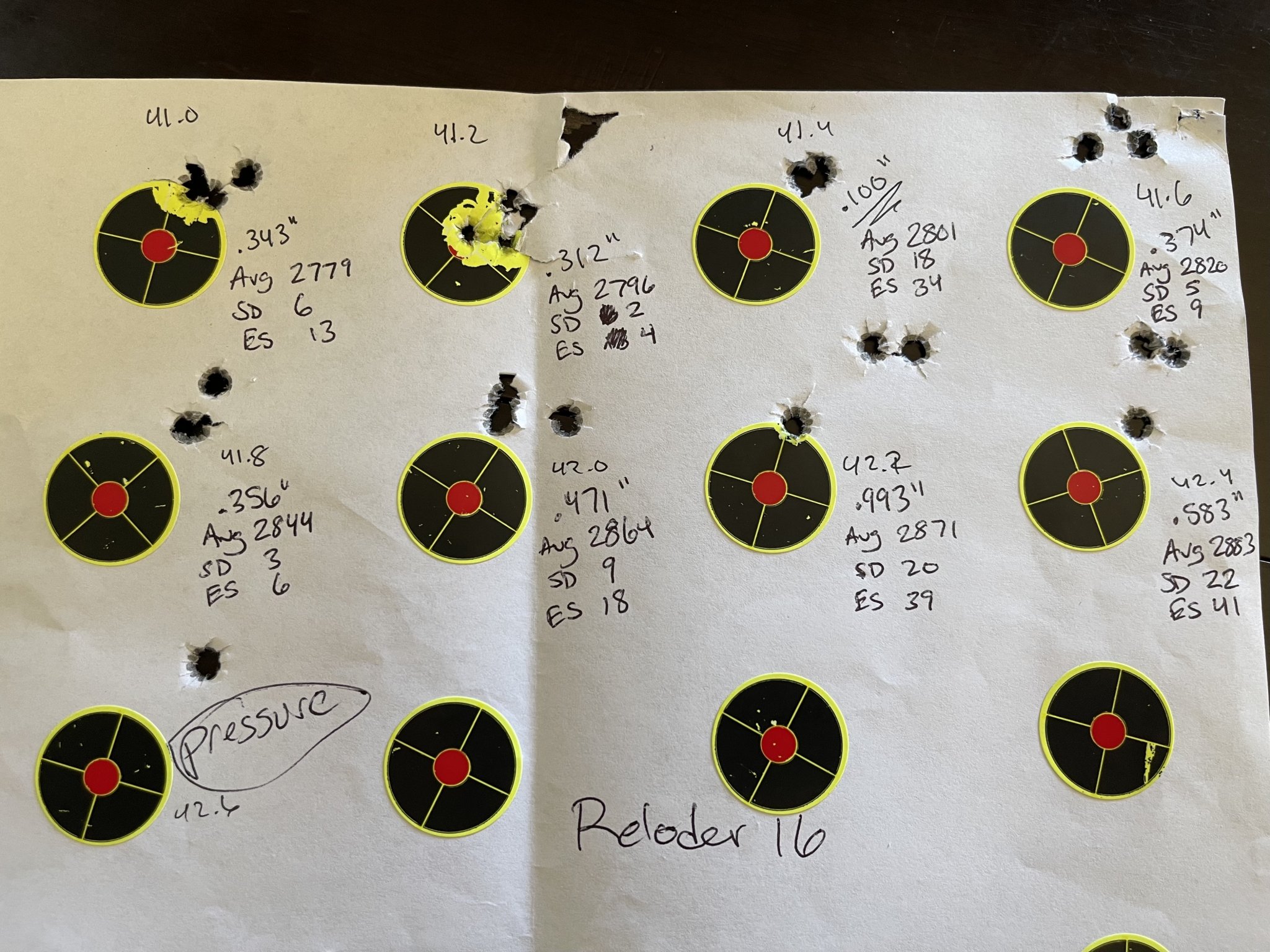

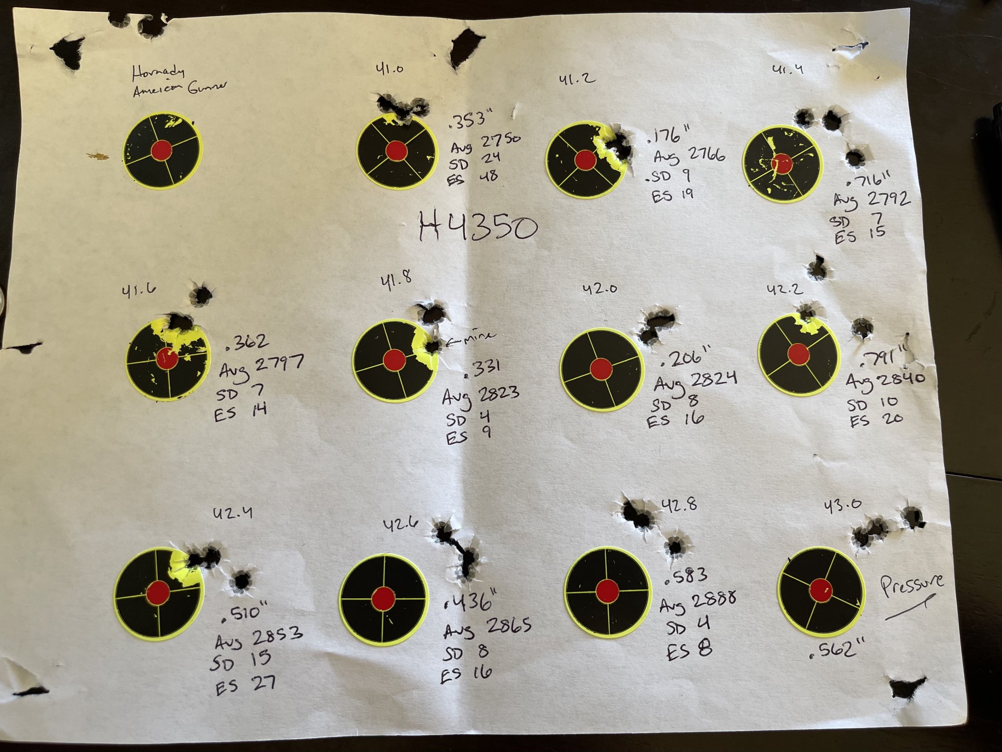

My average velocity decreased by 15fps on my once-fired Alpha brass. It seems that most people see an INCREASE of velocity. Also, ES and SD are FAR from where I want them. Using only a 3-shot group per seating depth, per primer brand (shot 3 shots at 2.260, 2.257, 2.254 etc with Fed 210, and another 3-shot group, same depth with CCI 200) some groups were in the single digits ES-wise and some were 40+. I realize that 3-shot groups aren't statistically relevant, but from my understanding seating depth produces very, very little effect on ES/SD Overall ES on 10 different seating depths (30 shots each primer) using Fed 210s was 49fps and 61fps using CCI 200s. I did manage to get some nice groups at 100, with some good ES and SD numbers. All groups at .250" or better were at or less than 15fps ES (again, only 3-shot groups). Not a happy camper at the moment. I'm using a FX120 scale to measure each and every powder charge, Redding Comp S seating die, Redding Comp S FL resizing die (bumping .002") with a .288 bushing. No mandrel yet, but one on the way as the only thing I can think is holding me back is proper (consistent) neck tension? Everything else is quality instruments and measured every single time. Any ideas? This is damn near the same ES/SD numbers I'm getting from crappy AG rounds.
If your powder is consistent I would assume it’s neck tension. Seating depth would not cause that large of a spread on its own, in my opinion.
I would definitely invest in a mandrel and then buy yourself pin gages. 0.2610 to 0.2640 and verify if you have consistent neck tension. I know I’m meticulous on brass prep...each piece gets the same treatment (typically Lapua) but out of 100 cases I’ll get 10% that “fallout” on either side of my target by more than 0.0005 (and I anneal every firing). Something to watch for is how large is your fired neck and how much are you trying to size it down...you may find for the most consistent sizing you need to use two sizes of bushings and size in increments. Pin gages were the missing “tool” for me. (I use Vermont Gage ZZ minus pins)
Agree, that ES is way too large for Alpha brass. Something else is going on here….
The commonality seems to be the gun and not the ammo: The America Gunner ammo could be expected to give a larger than ideal ES, maybe around 40-48 fps, but the Alpha brass loaded on a good lab scale should be 20-30 fps, maybe 35 fps at most.
Could be firing pin fall: Maybe there is oil, grease or gunk left inside the bolt body occasionally retarding the firing pin movement, leading to some normal and some light primer strikes? Some triggers can also get defective and cause this problem. Some bolts do a lot better after they have been bushed (Gretan is a good choice, but there are other options too), as the bushing guides the firing pin in a better way.
I would check these mechanical issues first. If you have a buddy that loads good ammo with an ES of say 25 fps or better for a large sample of 50+ cases (so an SD below 10 fps), try his ammo in your rifle. He may need to correct his shoulder bump for head space differences. Pay more attention to SD than ES. ES is an unreliable statistical metric, one bad outlier due to a dud primer or a powder charging mistake can skew it really badly. You will likely not be in a “node” (flat spot on the speed graph), but SD should go up (at most) to 12 or 13 fps. If ES is 5x the SD (or more) in your rifle, then almost certainly it is the rifle, not the ammo. It means you are getting statistical outliers due to a “process” (mechanical) change, and you don’t have a true Normal/Gaussian distribution anymore. [Or try to get Berger factory ammo (unobtanium right now, except for Gunbroker, and then you have to tolerate their extortionist prices). I always get an SD between 8 and 12 fps with this ammo. ES should be 3-4x the SD number. ]
Now for the possible but rather unlikely causes:
Check your scale for drift: Measure a pan, zero it, pull the pan out, and watch that negative nr over a 3 day period. It should not move by more than 0.04 gn. It is VERY unlikely for the FX120 to do this, but very easy to check.
Brass could perhaps also contribute to the problem: Check the weight range of the Alpha brass, should be 3 gn or less difference. VERY unlikely to be the problem. [Yes volume sorting is better, but it is slow and messy.]
Could be neck tension, and using a set of pin gauges is a great way to check them. I use a K&M arbor press with a force measurement tip to accurately measure seating force. In my experience, springback differences due to different flame annealing times or perhaps different metallurgy (brass composition, so a factory mistake) could lead to a 50% change in seating force. [You can pick this up with cheap pin gauges, and you don’t need to spend $200 on the K&M press and an LE Wilson seater die.]
AMP machine is very consistent if the necks are fairly similar thickness. [I neck turn all my brass, but the benefit is tiny if you start with premium brass.] You can easily feel a 50% change in seating force with a standard reloading press. It is possible to get it down to 10-15% if you cull the cases that have exceptionally thick or thin necks (rarely seen in premium brass), cases that consistently have way different springback (have seen that in all brass). Mark those suspect cases by putting a deep scratch on the case head. If it happens twice in a row, cull it out.
Btw: Using graphite lube like Imperial Dry Lube could help to lower the seating force (which may help or hurt, as it changes the bullet exit time during the barrel whip cycle). I have found that it makes seating force a little more consistent. But it does seem to help minimize “bullet weld” problems if you store the ammo for a long time (weeks to months).
AMP machine leaves a red copper oxide inside the case neck that can lead to high and variable seating force, thoroughly brush that out or tumble for another hour after annealing. There is a video on the AMP web site about this.
Check your primer weight range for 20 primers. If ES is more than 12 milligram, you got a bad batch of primers, and you may need to weight sort them (and that is a royal pain in the behind). Unlikely in your case as you tried two different brands already.
Best of luck!
Btw i have only seen this problem twice in 10 years: One time the inside of the bolt body got dirty, first symptom was that the ES went way up (doubled), then after a while i started to see misfires (light primer strike), and eventually the gun would go click but the round would not fire, and there was not even a light mark on the primer. I put the same round back in the chamber and it fired, and had the normal speed. Went home, cleaned it out with a gun cleaning solvent, and the problem went away.
The other time it happened, i dumped powder into a brand new stainless steel bowl to set up the autotrickler, and the remainder went back into the 8 lbs jug. Did not realize that there was a sticky oily residue in the bowl from the manufacturing process. It seems the powder got contaminated and ES went to hell. That 8 lbs jug soon became fertilizer for the garden. Turned the grass into a nice bright green. Expensive mistake!
Reactions: kjmdrumz3

TONS of great info here. I'm going to have to get your phone number because you always seem to respond to my posts with very helpful tips and suggestions :p. Lots of info to unpack here, so here goes:
-I haven't seen ANY light primer strikes. All of them look perfectly uniform. I haven't had any misfires or hang fires. Also, as you said, I'm seeing the problem with both brands. Unlikely to be the primers.
-I've checked the scale for drift. Left it on for a week at a time and it doesn't drift. It read -74.96gr for at least a week. I don't think the scale is the problem.
-I measured 30 random cases (10 out of each lot of 100) and they were all within .78 grains. I didn't bother weight sorting them with measurements that close.
-I use an Anealeez (always read "Anal-Eez" lol). It seems to do a perfectly serviceable job. I have it set on about 45%. In a dark room, the brass JUST barely starts to glow when it's taken out of the flame. Haven't used Tempilaq and sacrificed a case, though.
-I have a K&M arbor press and an LE Wilson seater, but just got the VLD plunger for it yesterday so I have been seating on the Redding micrometer (all within .0005 of my target depth CBTO). No noticeable difference of feel, but that's on a Lee Classic Turret. I'd love to upgrade to a "better" press, but I've seen perfectly good ammo made with this press by lots of people, including some .243 done myself.
-I have an expander body and mandrel on the way, along with some Imperial Dry Lube and pin gauges. I was sizing with the bushing only (expander ball and decapping pin removed) which apparently pushes any imperfections to the inside of the case, at least from what I've read.
I think that about sums it up for now. I'll keep updating as I improve the process and HOPEFULLY get where I need to be. I'm sure this thread will help out others in the future that are in the same boat as me. Thanks!

No, it’s the IMR4350 in the picture above. The bullets are Berger 140gr Hybrid Target (sku 26714).
The fire formed case after firing showed nothing out of the ordinary. F.L. sized with a Whidden bushing die (.288”) which gives .002” neck tension with the Lapua case and this bullet. I’m only bumping the shoulder .001”. No pressure signs. No ejector marks on the bolt face. The web looks normal. The primers are still seated deep after firing. No flattening.
I saw the data on Hodgson. I’m not sure what to say, but it seems to work. The smith who chambered it used the same reamer that he used for a fellow by the name of Alan Alton. I guess he’s a competitive shooter up here in the north. He told me that he shoots the 140’s at 3000+ in a 28” like mine. I’m not that brave. I stopped where you see it above.
You are on the edge. I have run 142 SMKs and 144 Bergers around 2900 with H4350, RL16 and now N560. H4831 is another good powder. My current load is 44 of N560 with Fed 210m running 2815 with sub 20 ES in 27" barrel. I can't find RL16, I think N160 would be better. I also tried N555 but could not get the speed I am used to seeing. The 2900 load is hard on barrels and brass so don't expect long life lol. Last barrel went around 1400 running 144s at 2885. I chose the 2815 load as it is very stable and did not show pressure signs even shooting in pouring rain. I have not touched barrel tuner yet and it is shooting sub half, last group was .34"
Reactions: 6MT
Maybe edit your original post (include the text “Edit:”) and correct the powder type. Before some new shooter spends a week looking for a magic powder that does not exist. 😊😊
Btw 44.0 gn of H4350 would be fairly hot in most rifles, with a 140 gn projectile... [Edit: Well, a custom reamer was used to cut your chamber, so that helps to explain why you can get this high.]
My 3 rifles in 6.5 CM all showed bright ejector marks at 42.5 gn or below when new. Hard bolt lift at 43. As the lands moved forward (after 1,500 rounds), they could handle a little bit more powder. It seems you are running a 28” barrel, so you may be gaining an extra 70-100 fps over a 24” barrel. You may be lucky and have a nice fast barrel, and/or a roomy chamber, or a longer freebore, which all together can perhaps add another 50 or 60 fps. Your batch of powder may also be slightly different from nominal spec. Added together, your speed is possible, but few rifles will be able to handle 44.0 gn.
In my experience, H4350 is not ideal for exploiting long barrels. I have a 30” barrel on a Savage 12 that does 3,000 fps with 140s but only with double base powders like RL-17. Could not get H4350 beyond 2850 fps in that barrel, chamber was too tight and hard bolt lift arrived at 43 or just below that. In future i will not go beyond 28” for the medium calibers. [A 416 caliber ELR rifle will of course benefit from a 34” barrel.]
Hornady (in their 11’th edition) lists 42.0 gn of H4350 as max at 2750 fps for a custom R700 with a 24” barrel. Hodgedon web site lists 40.0 gn as max, which is quite conservative, and they list the load as “compressed”, which implies a very short freebore, and the bullet sitting deep in the case robbing case volume. Must have been a rifle with a min spec chamber throated for 120s? Strange indeed!
Maybe check the base of 10 cases for expansion (0.1-0.2 thou growth per firing is typical - once you go over pressure), but use a good micrometer, and good consistent technique. This is right on the limit of what a micrometer can measure.
Also, Lapua brass is ‘reluctant’ to show clear pressure signs. If i recall correctly: Lapua claims a 30% safety margin. Of course, the idea is not to use up all of that! 😊
For the new reloader: Start low and work up in 0.3 gn increments. The folks that run the superb Pressure Trace strain gauge system all report the same observation: By the time you hit visual pressure signs, the actual chamber pressure is already significantly over 62,000 psi - so back off 0.5 gn and assume that is your max nr. If load development happened in winter, you will need to recheck in summer. No powder plus primer combo is totally immune to temperature changes, whatever the marketers choose to call their product. Btw: All primers are temp sensitive. Keep in mind that pretty much all rifles are different, even if they have the same model number. Reamers wear out, and are not replaced until they are out of spec, and the SAAMI spec is wider than you think. Some rifles are WAY different (clearly out of spec). Powder and primer batches can vary too. That’s why the load books are so different.
