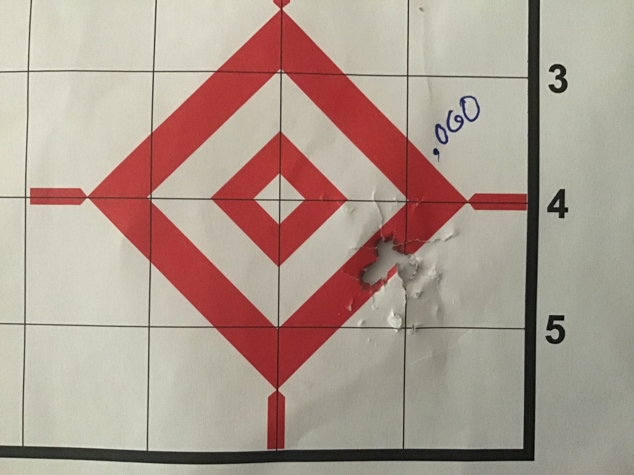

Bullet seating began at a jump of .005” and stopped at .060”. It was taken at 100y with a temp in upper 80’s.
Jump
.005”=1.229” group
.020”=1.048” group
.030”=.916” group
.045”=.373” group
.060”=.264” group
So my new load is:
57.8g h-1000, Gunwerx brass, CCI200 primer, 153.5 Berger set at COAL of 3.020 (.060 jump).

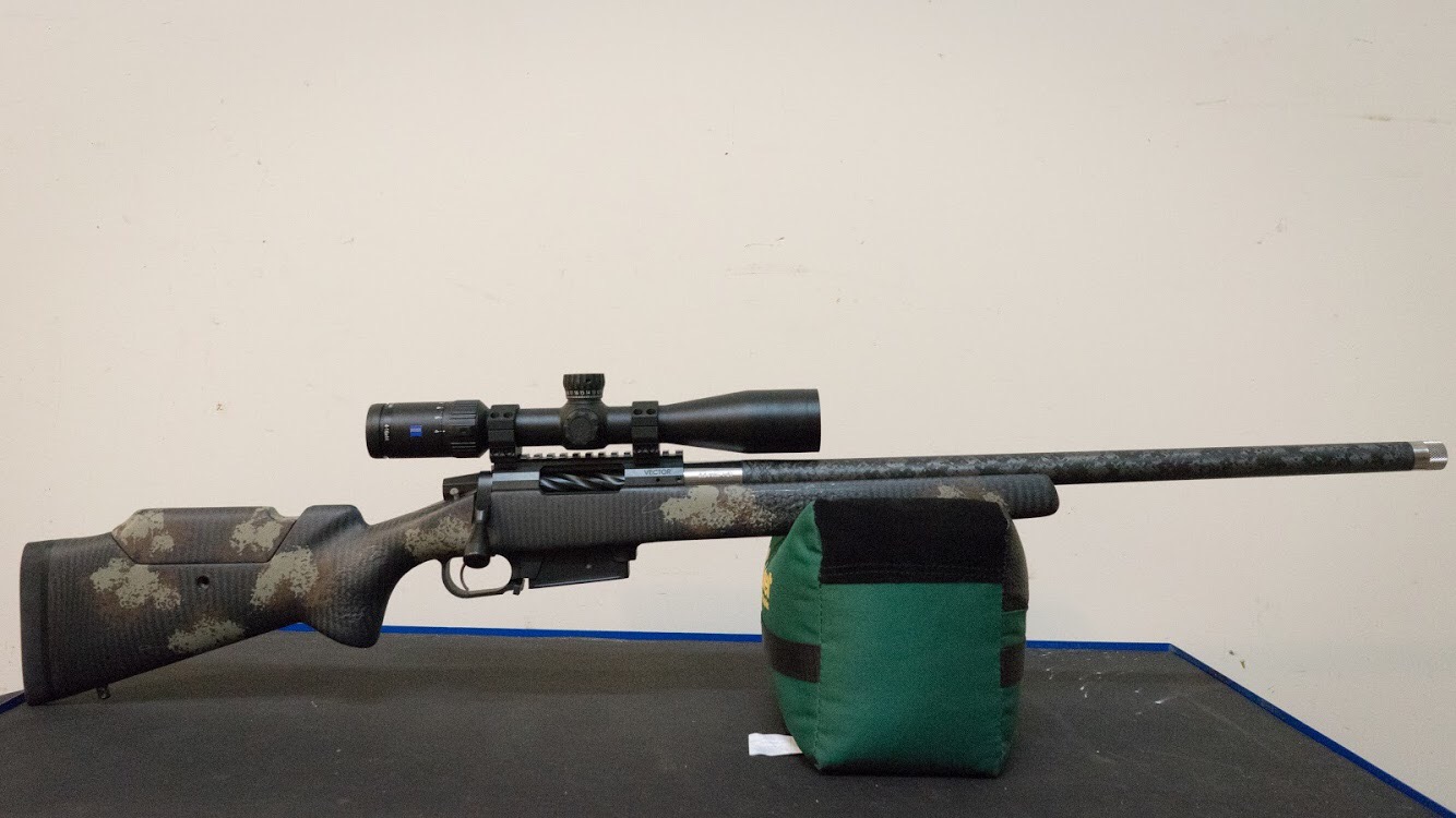

Finally got my rifle in, and now ready to load up some rounds and test.
Alamo Precision Rifle 6.5 PRC
24" Proof Research barrell
Defiance Deviant Action
Trigger Tech Primary
McMillian Carbon Fiber Stock
1:8 Twist
Vortex AMG Razor 6x24 scope

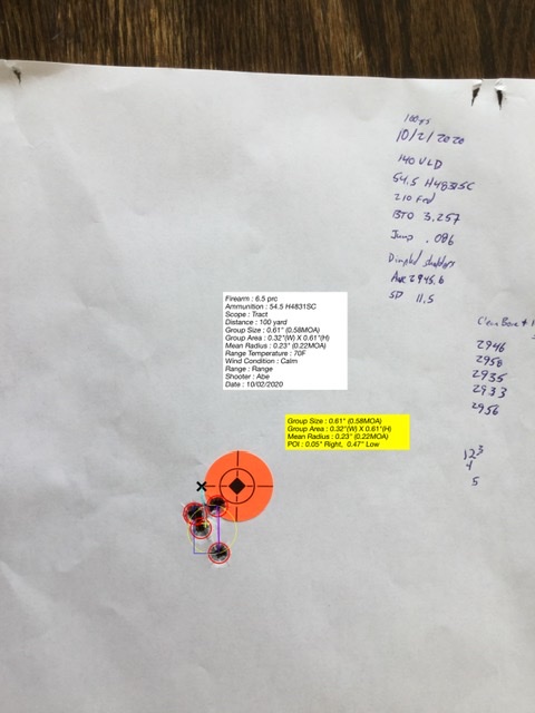

Seekins Havok bravo 24”. 140 Berger VLD under 54.5 H4831SC jumping .086, 5 shots @ 100 yards, average velocity 2946, SD 11.5, group size .58moa, mean radius .22 moa.

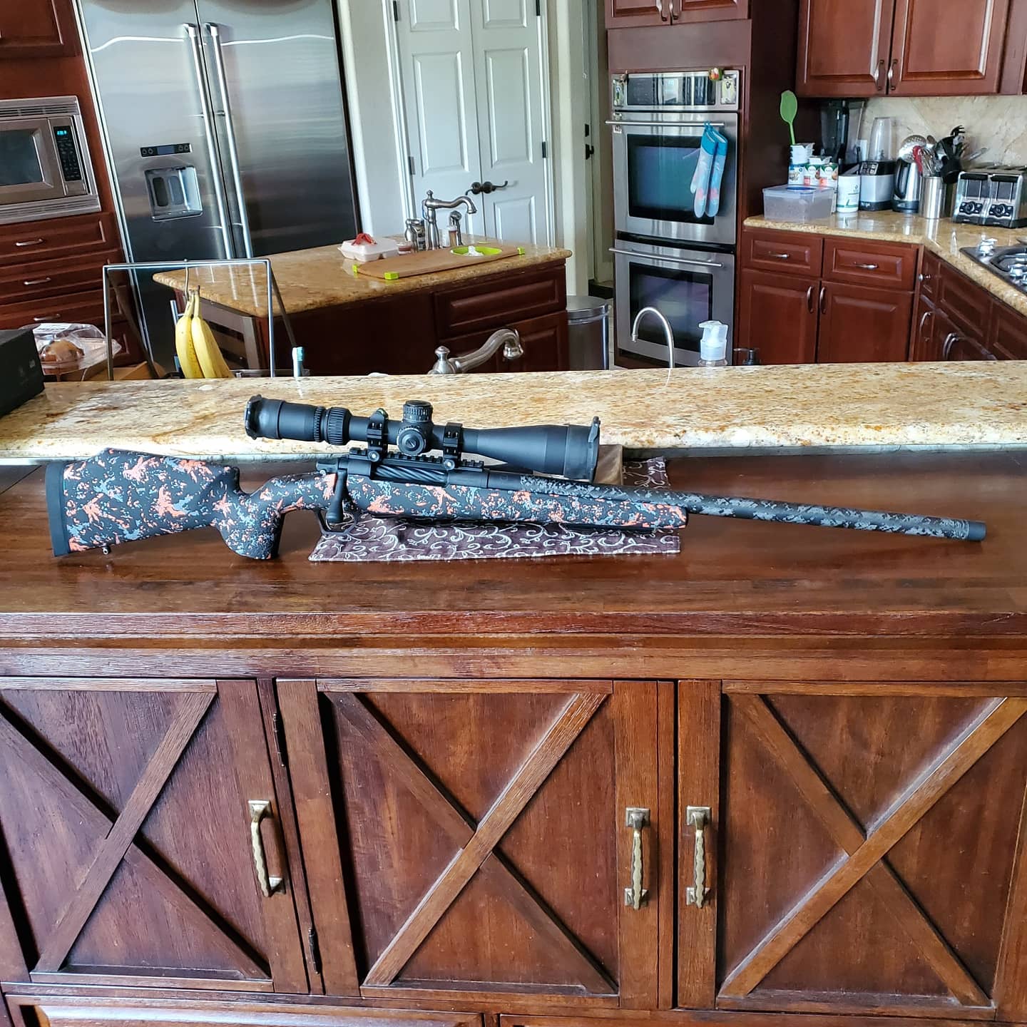

Thought I would share some info I have gathered working with my new 6.5 PRC.
Plans are for 130 grn bullets and try some 140s later. So far it is a pleasure to shoot. Very little recoil, less than 308. And is a Lazer flat to 1k. Shot some Hornady factory 147s that chrono'd about 2850, which is 100fps slower than advertised on the box.
Also ran a little H1000 and 4831sc. Never got a real good chance to group them mostly due to constant CO wind. But got some Chrono #s that should be helpful.
Rifle is Remington 700 action trued with Bartlien 26" 8 twist and APA little bastard brake. Pillar bedded Manners stock. Nightforce 3.5-15 nxs. Magneto speed Chrono.

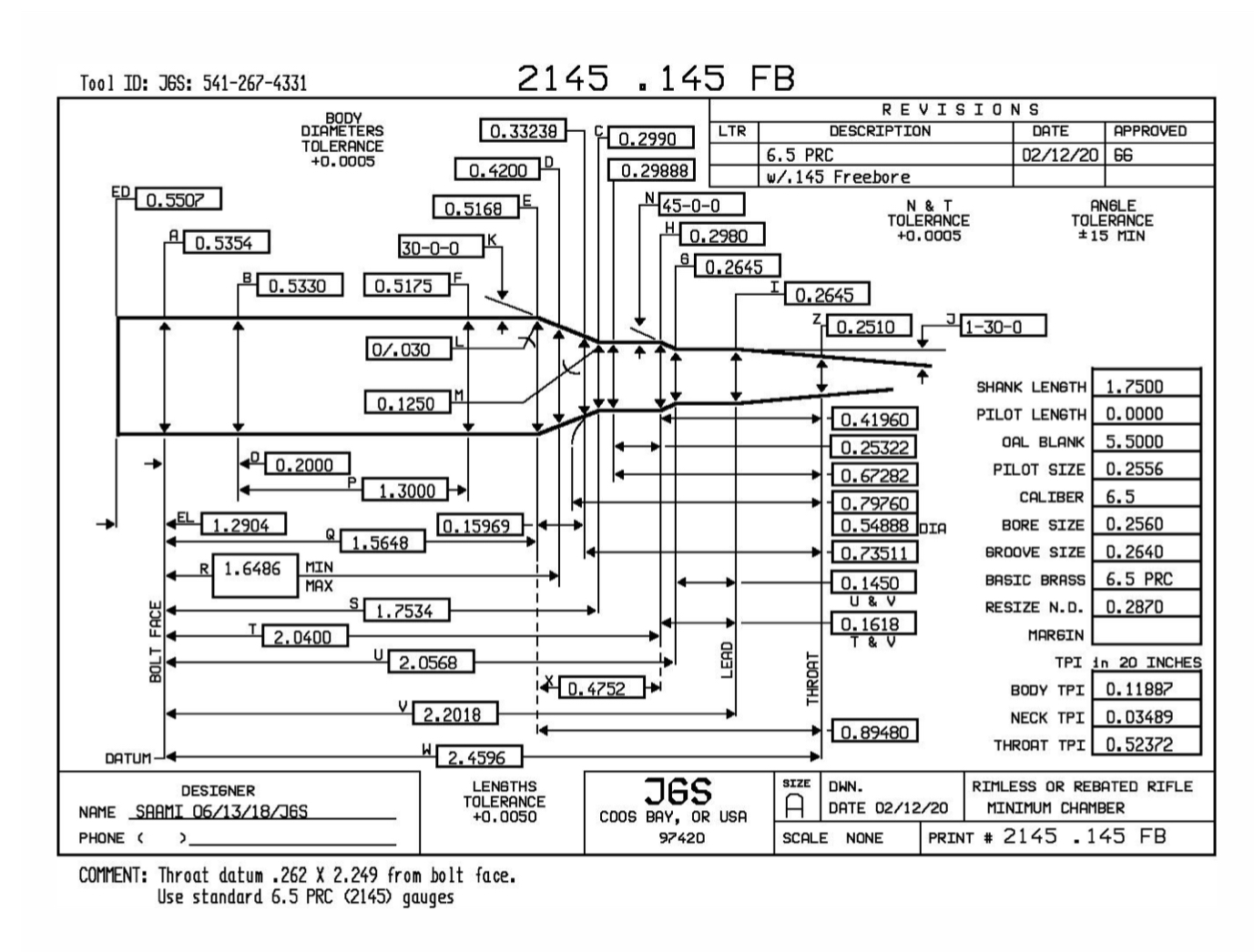

I have 2 6.5 PRC rifles built by GAP. Best velocity, grouping, SDs/ESs, are all with RL-26. H1000 is a close 2nd. You are shooting light bullets and all my data is from Berger 156 EOLs. My groups are 5 shot groups with ESs in low single digits. Could you do better using lighter weight bullets for 0-500 yds & the heavies for your distance shooting? Good luck & congrats on the new rifle!
Did you build this gun on a short or long action? And what reamer did your Smith use? I'm thinking hard about building one.
Houston, I’ve has GAP build 2 on XM actions. Strong recommendation for it and parts are easy to come by now as more people are building the short fat magnums on XMs now. My average COAL is 3.1+. My last build was throated off dummy rounds built from ADG brass & 156 EOLs. I believe the throat (Freebore) is .216.
I attached the reamer pic they used. After cutting this chamber they used a throat reamer to get the .216 throat. I’m not an expert and had to have the process and sequence explained to me.

What a great thread. I just had a shorty 6.5 PRC built for Hunting. I shot about 45 rounds of "factory" ammo from Pendleton Custom Ammunition yesterday with ADG Brass, Unknown Powder, and the 124 Hammer Hunters. One hole groups at 100, 2" groups at 400, and "hits on steel" at 700 (wind was blowing very erratically). So far I am happy with the setup. I am going to try some loads utilizing some 4831sc I have and some 124 Hammer Hunters. I think the faster burning powder will work well with the shorter barrel. I will post up some info when done.

Mines up and running... first box of factory 147 grouped .8, .6, .6 after sight in. Grabbed a few more boxes to get it broken in. Anybody loaded for 124 Hammer Hunters or have ideas for mono solids? How does RL26 work for lighter bullets? Would be pretty neat to get them singing up over 3200.
Gorgeous build. Curious about an update if you ever found a good load with the 124 HHs. I'm getting 2875 MV out of mine in a 6.5 CM but am seriously thinking about a PRC
