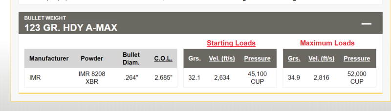

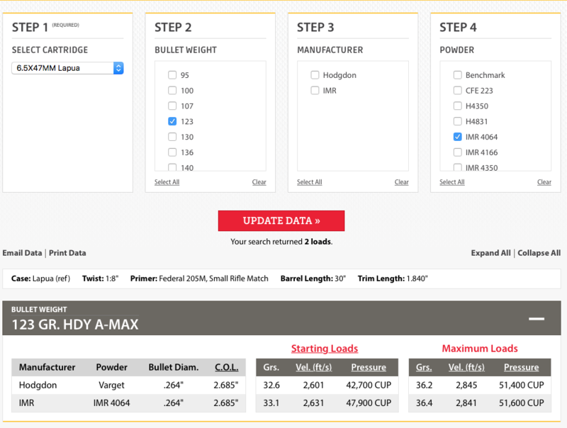

Is anyone using IMR 4064 in a 6.5x47 Lapua? I’ve been using varget with a 123gr scenars with great results but I have a ton of 4064 laying around that I could use too. Hodgdon website shows nearly identical max loads and velocities between the two powders. Can they (varget and 4064) be reliably interchanged? Any other load dat for imr 4064 in a 6.5x47 also welcome, especially for 123gr bullets. Thanks guys!​

I'd say try it! Be aware though, you may have to "tap down" the powder since the 4064 kernels are so large, when I loaded IMR4451 with 130's I definitely had to.
I use it in 6.5 CM, and since it is near similar, Varget and 4064 are identical in MV, slight edge goes to Varget for being tight groupings. I am using 139's though, no insane pressures either. Use it with confidence.

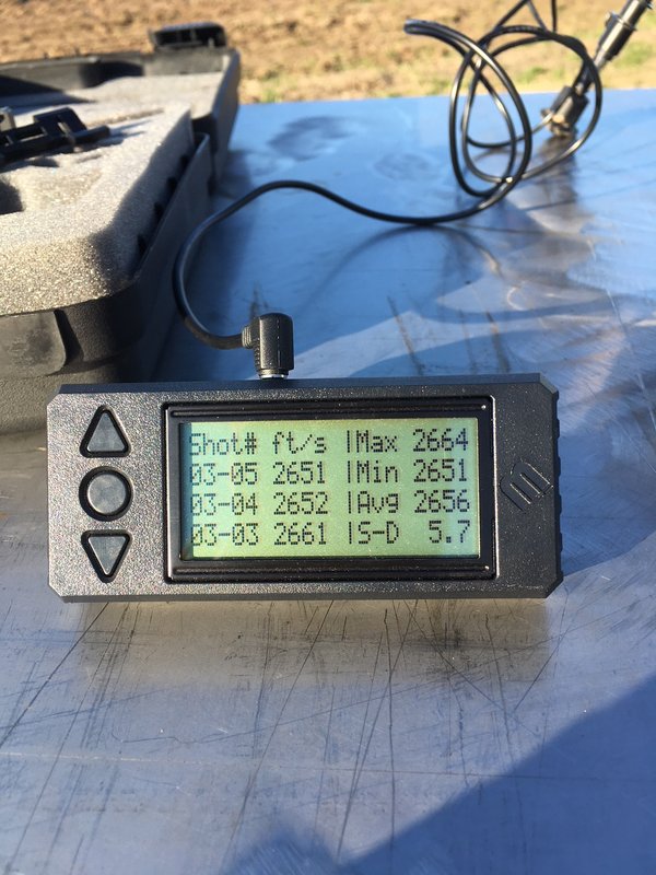

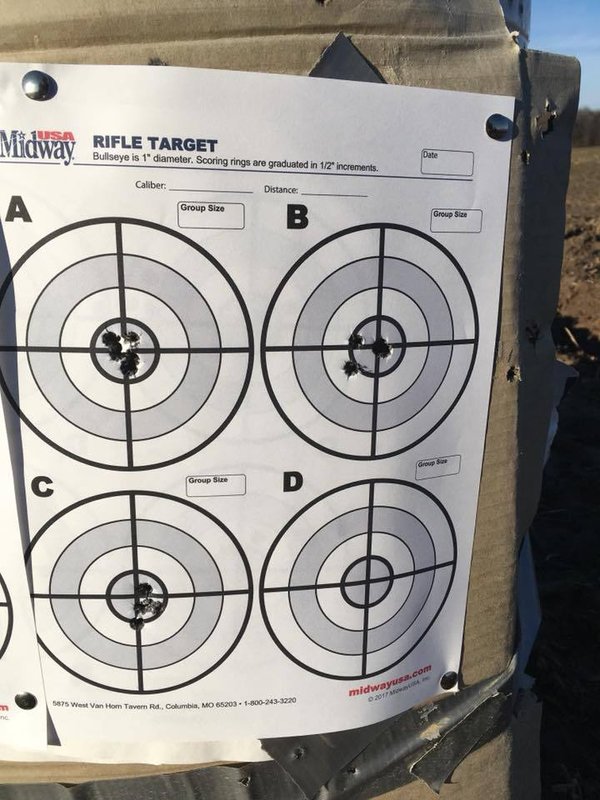

So to update i had 20rds of scenars left. Haven’t shot the 2000mr yet it’s been really cold for MS. I forgot that i only went to 41.0 on 4451 and started loading for 41.5. Noticed i was compressing powder. I did that for 7 and backed down to 41.0.
Shot those 7 and i calmed down after two shots. Shots to the right are SAUM shots, we've been having trouble with the V6 conquest as of late. It shot a cloverleaf 5 shot group with an SD of 5.7. Average was 2656 suppressed with the hybrid out of an 18” barrel. When i got to 41.0 had some condensation buildup in the chamber but it also shot a 3 shot cloverleaf with a moderately good SD of 15. I blame the SD change simply on the fact that i was running into pressure.
Either I’ve got some grease/lube in the chamber or the can is heating up and causing condensation being that it’s 27F here.

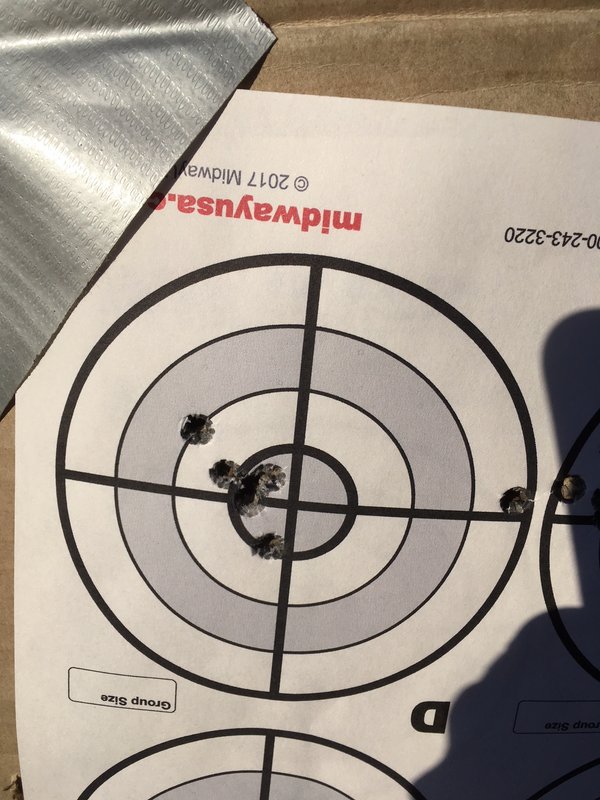

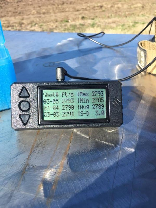

Shot 40.5-41.5 of 2000MR today with some good results. 40.5 yielded 2790ish with an SD of 3.0.
You'll have to excuse the fliers i don't shoot as regularly as i used to. I felt like the accuracy was there i just couldn't do my part. I stopped at 41.5 just felt i was probably pushing a lot of pressure. Was noticing a little more excessive cratering that usual and some flattening. No sticky bolt but still.
