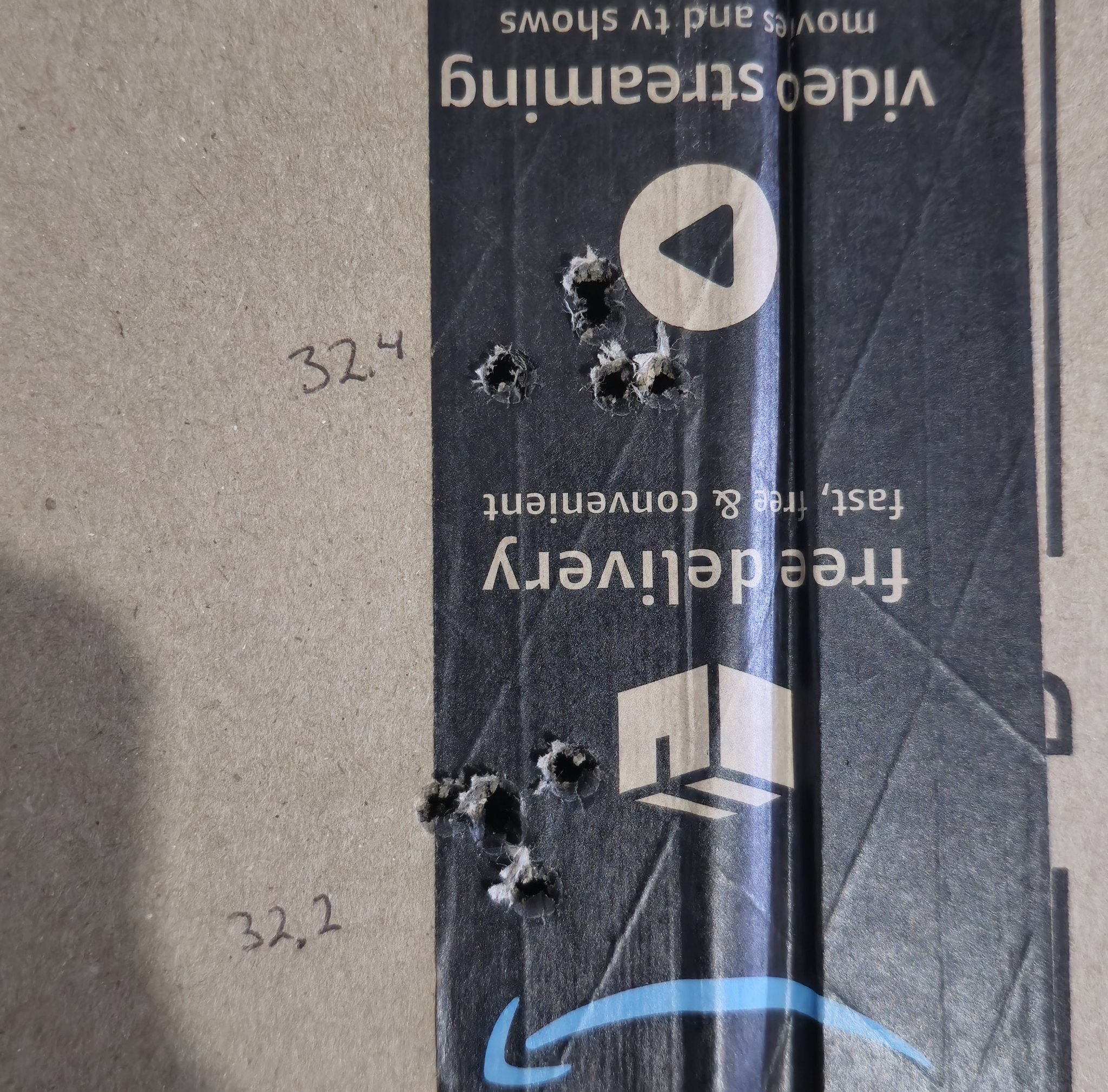

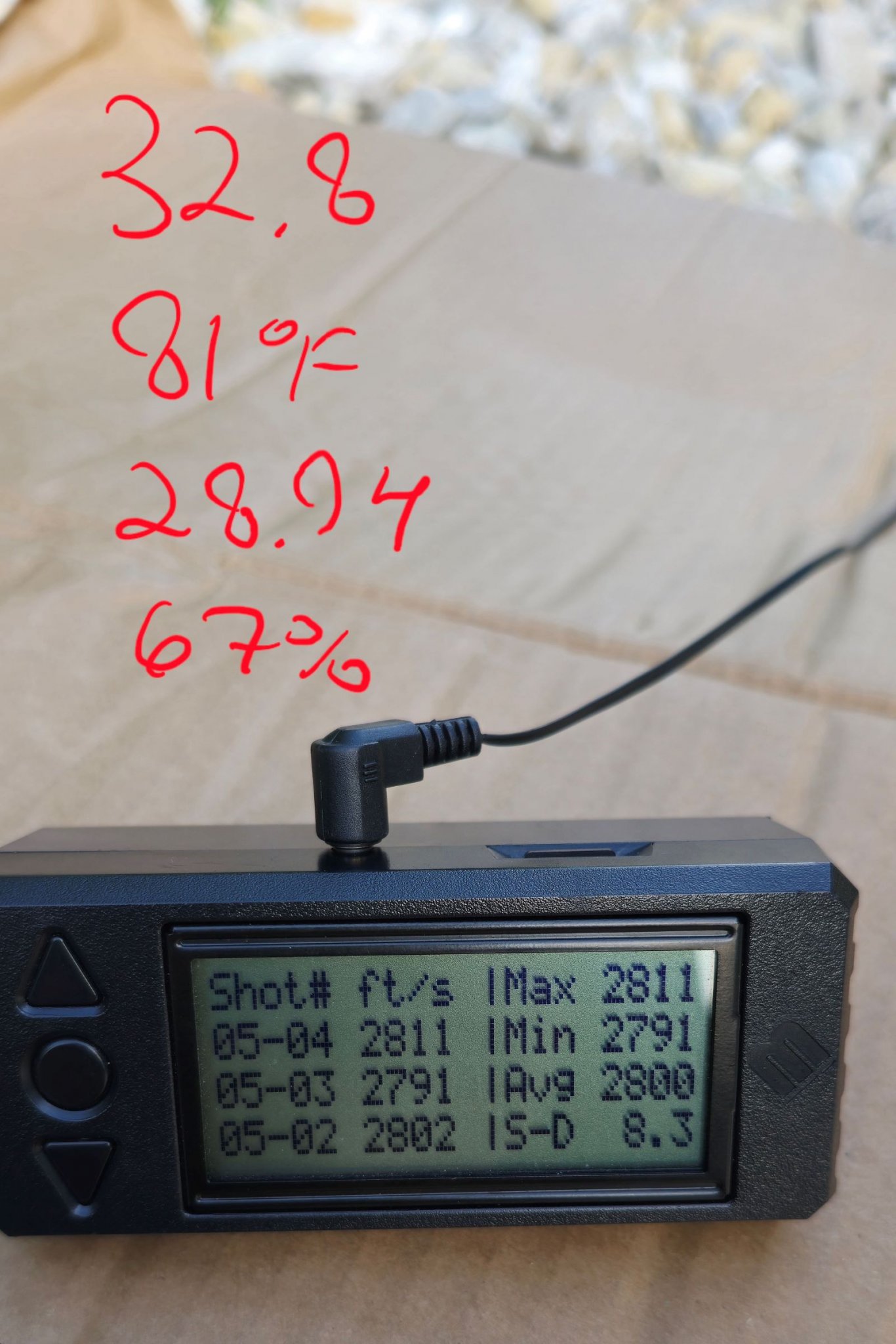

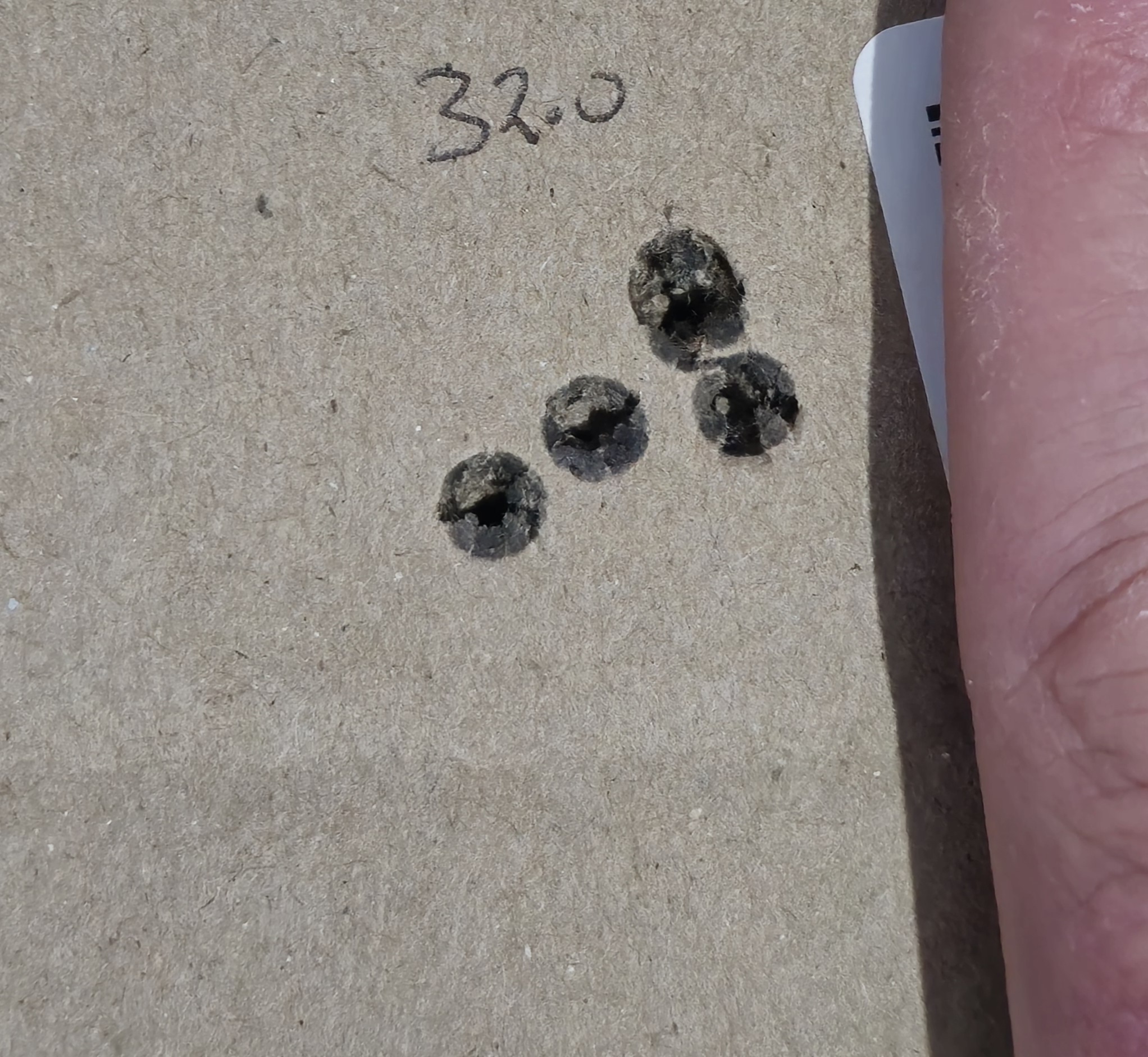

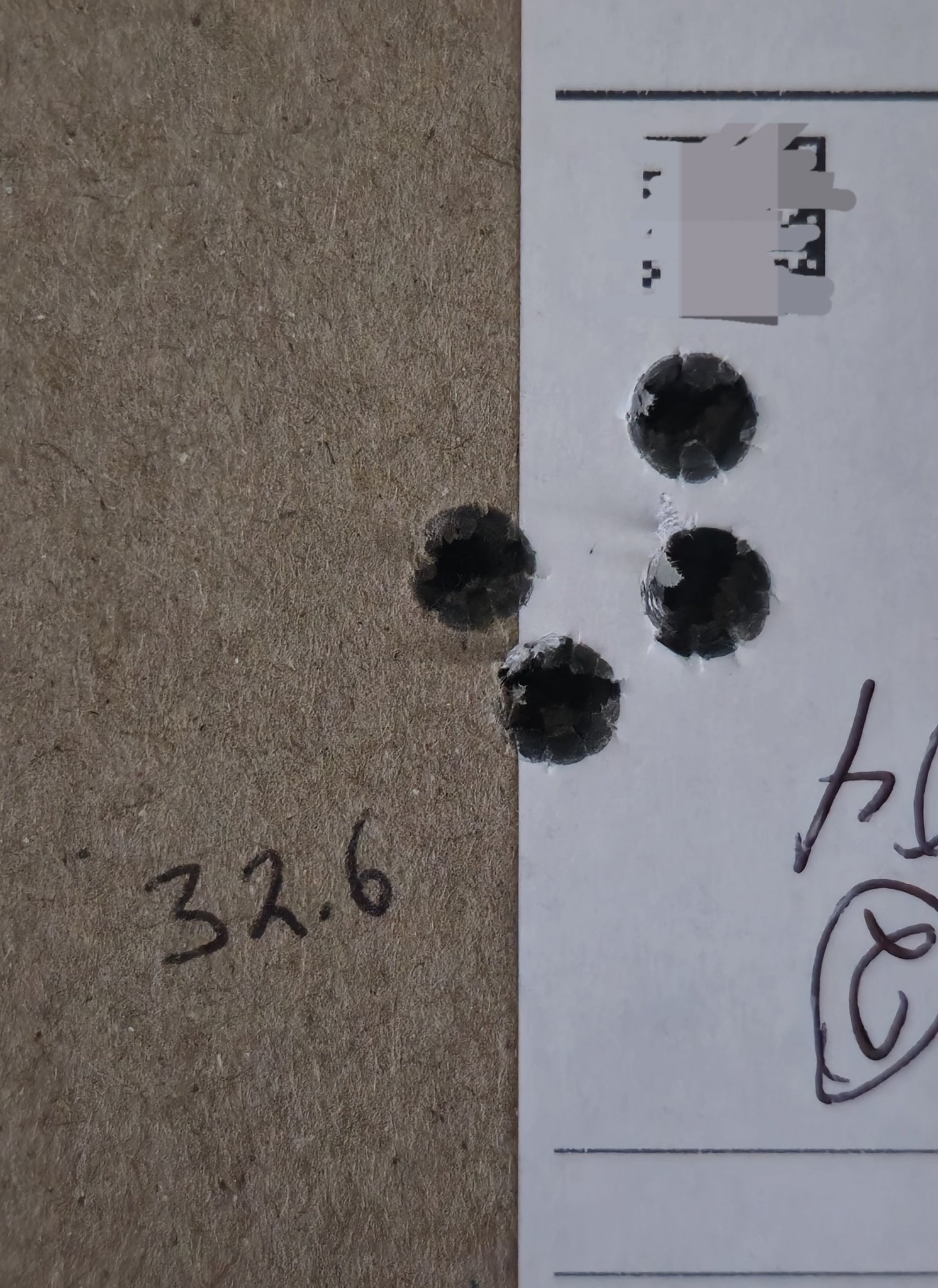

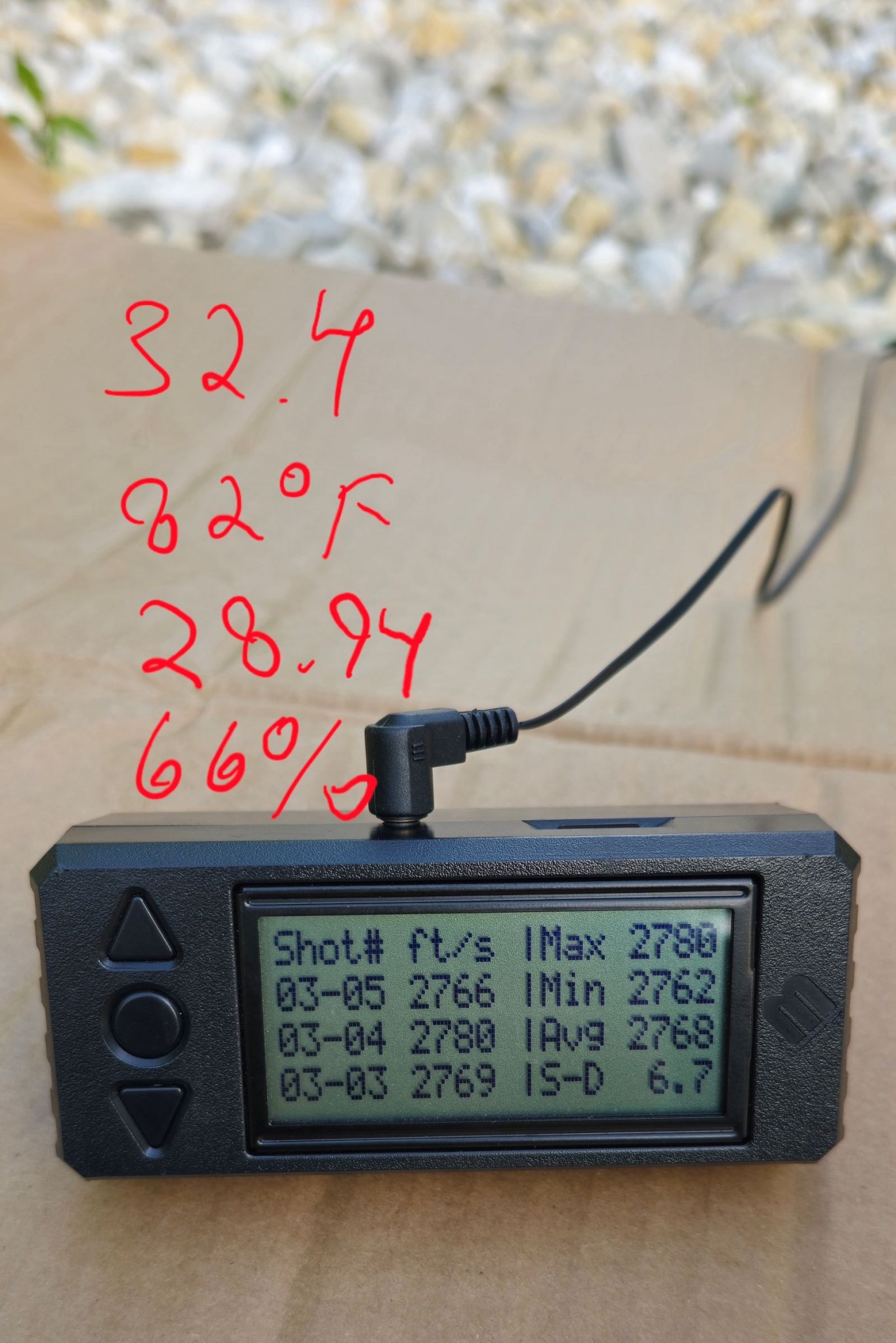

Probably from the warm to hot load I used; 34.5 of varget with 109s. Stage 5 I had a bad ejection where the case didn't eject, ran the bolt forward, spent case and the new round bonded with each other in the feed ramp. I was going for a clean stage 9/9 on that stage of 12 possible points. With that stuck case i wasnt able to clear it before timing out. Thankfully that was last stage before lunch.
Found one of the GAP guys and we looked at the bolt. The extractor was very loose. Worse they had felt. Another shooter was running a tempest and had a spare extractor.
Thought that fixed the issue until the 2nd stage of the afternoon. Cases wouldn't eject. Had to finger each one out. Also found I was missing high. Checked with a chrono real quck; 2978 with the 109, up from the 2875 in the morning. So hot.
Found this time the ejector was flush with the bolt face. We got the roll pin out but ejector wouldn't fall out. After some persuasion it came out. Along with a little piece of brass shaving.

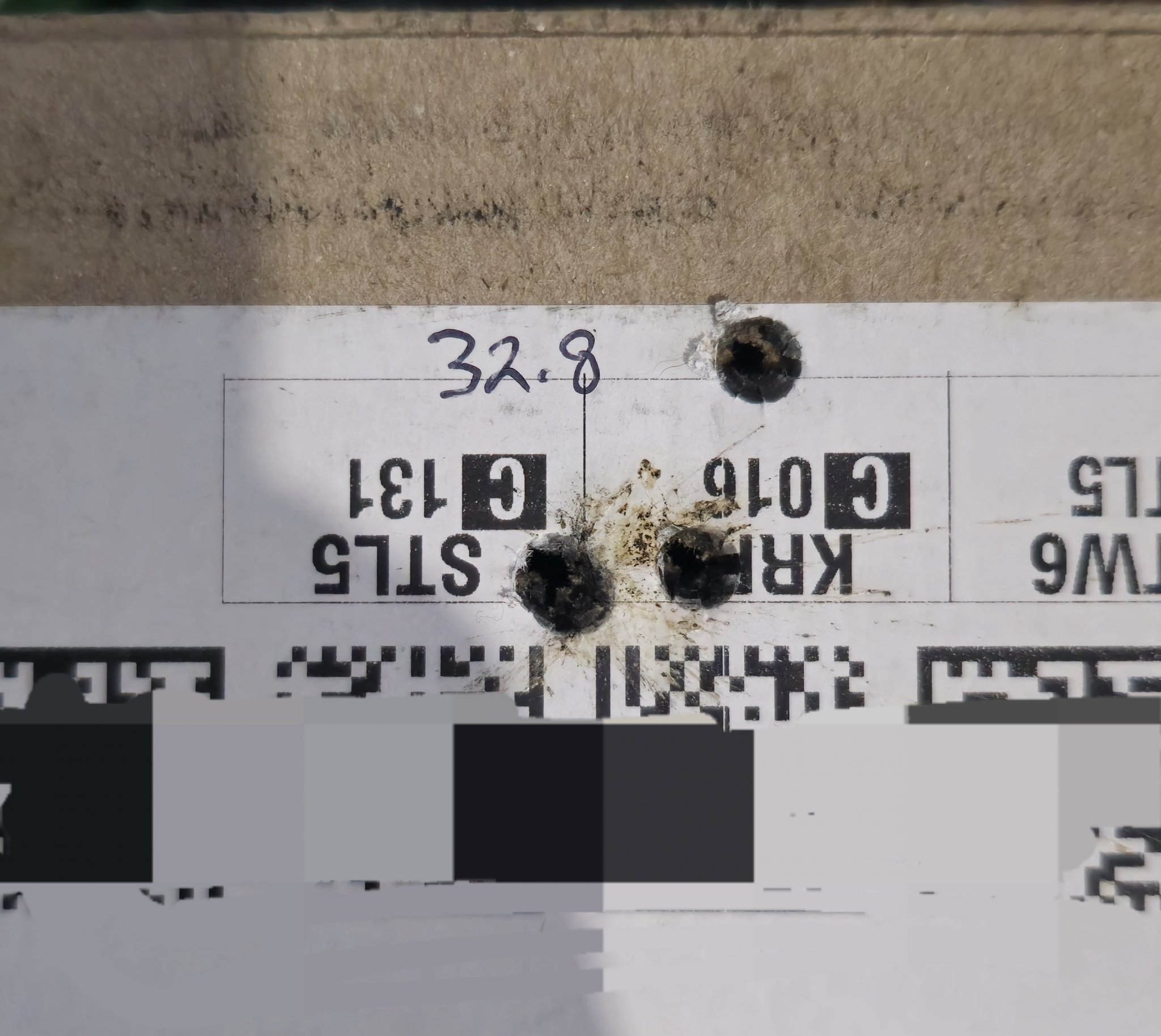

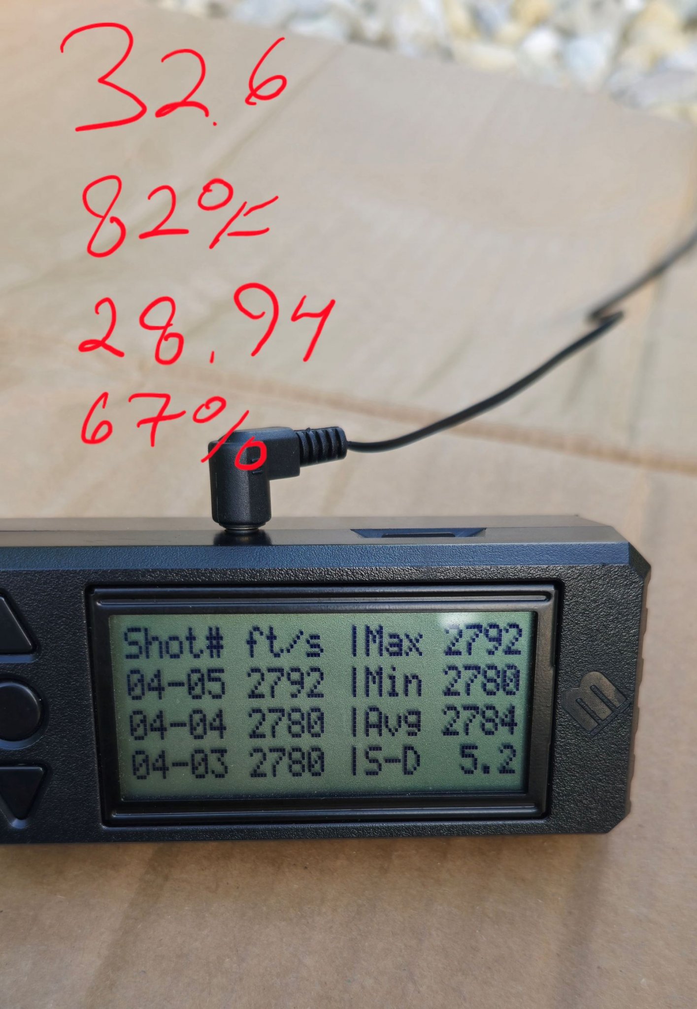

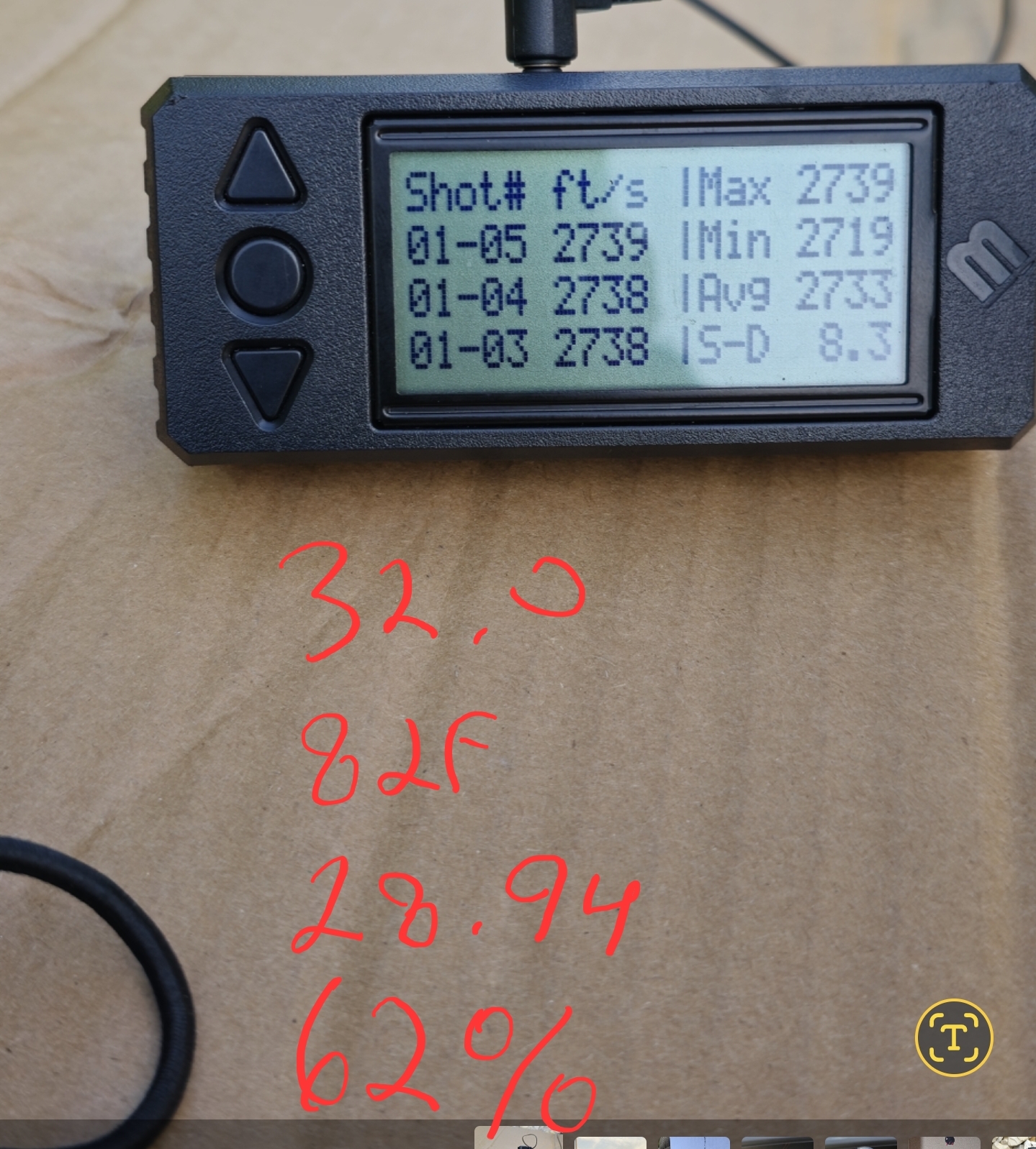

Probably from the load I was using. Was told to try 32.8gr with the 109s. Did a 5 shot group of 32.0-33.0 this evening. 32.2-32.4 gave me single digit SDs and nice little groups. Stripped the bolt today and got a little flake of brass out.
Huge thank-you to Caleb, Luke, and Zach for the help and coaching this weekend.
Pics of the groups?
What was the velocity?
109 Hornady or Berger?
Berger. Zero was good Saturday. But these loads, looks like i need to come up 0.1 and maybe 0.1 mils right.
Load is 1.9670" base to ogive. Varget, BR4 primers, virgin Alpha OCD brass.

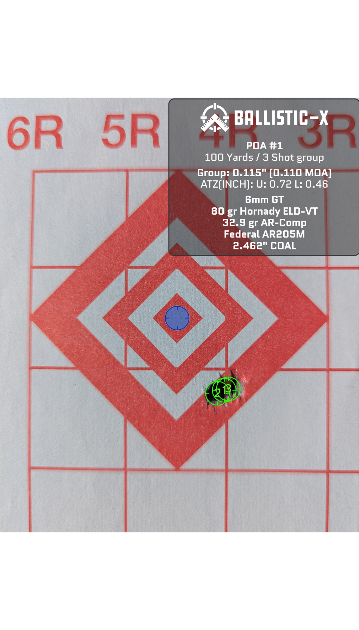

Hadn't seen anything on the 80 gr ELD-VT on here yet so here goes... Tried a couple of faster powder ladders with the 80s since it's also an 18" barrel for suppressed predator hunting and this was the most accurate load so far
I'm sure velocity is on the slow side (around 2910 according to load data) so I will probably continue working up to around the 35 gr area just to see if there's a higher sweet spot.
