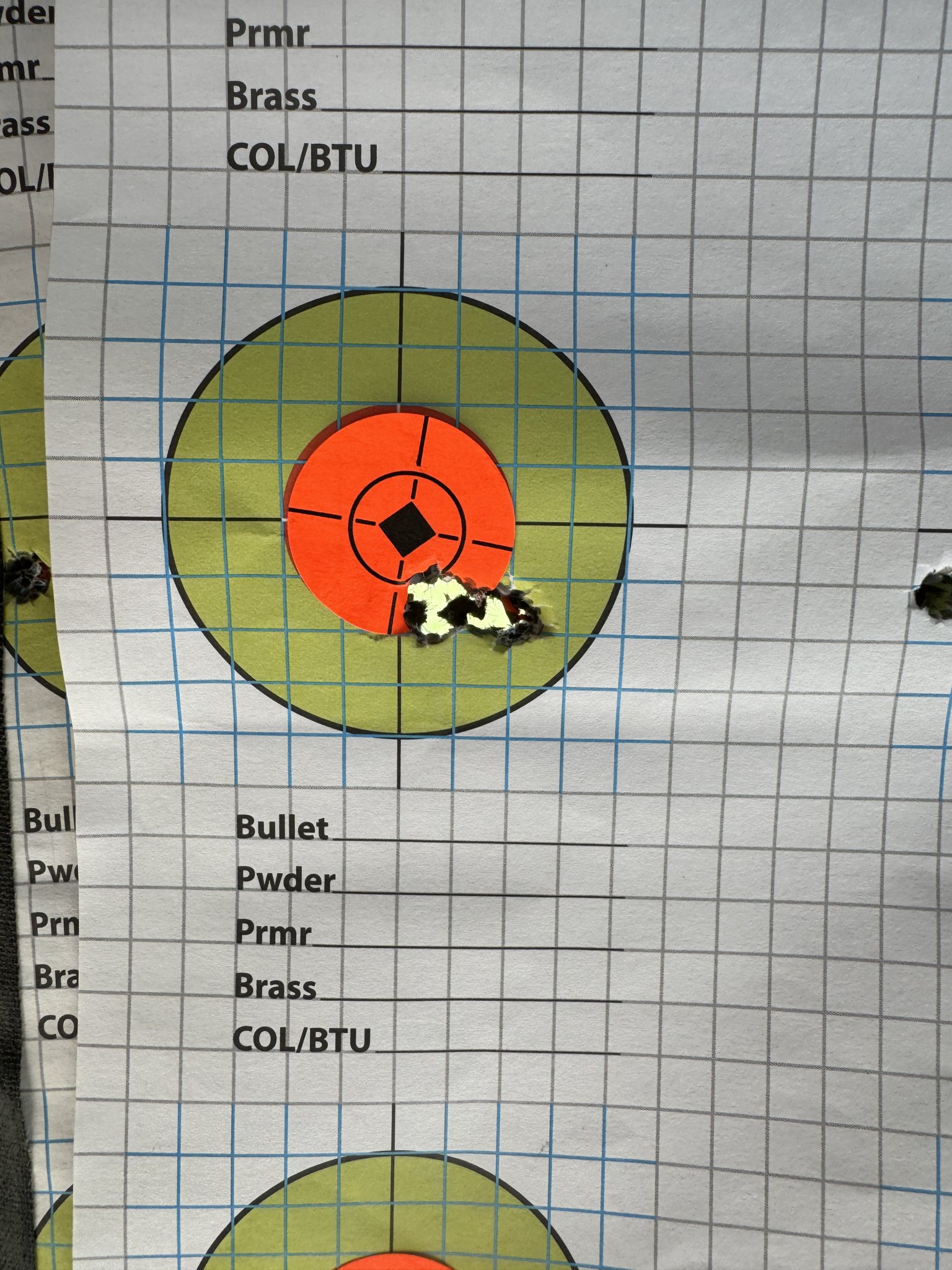

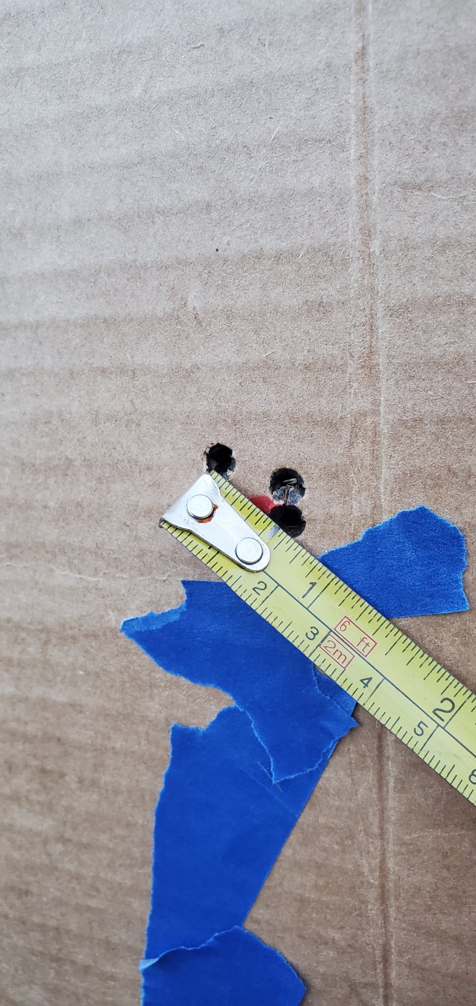

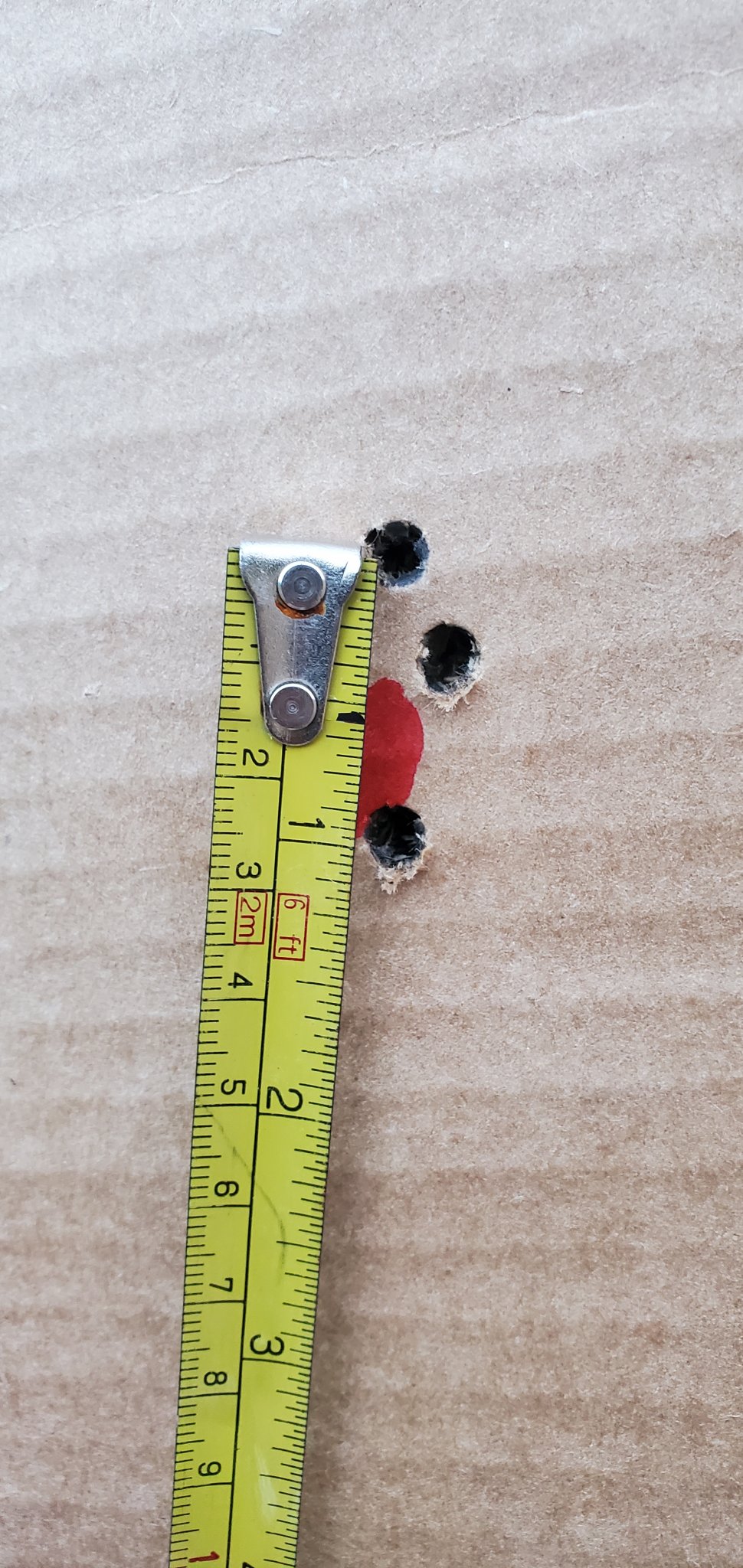

Groups with the SAC bushing being used. Not sure if it’s runout or the flare that SAC uses being at a bad spot for my seating depth.
SD with the SAC bushing was 7.5-9.
SD with the Redding was 3-4
View attachment 8391929View attachment 8391931

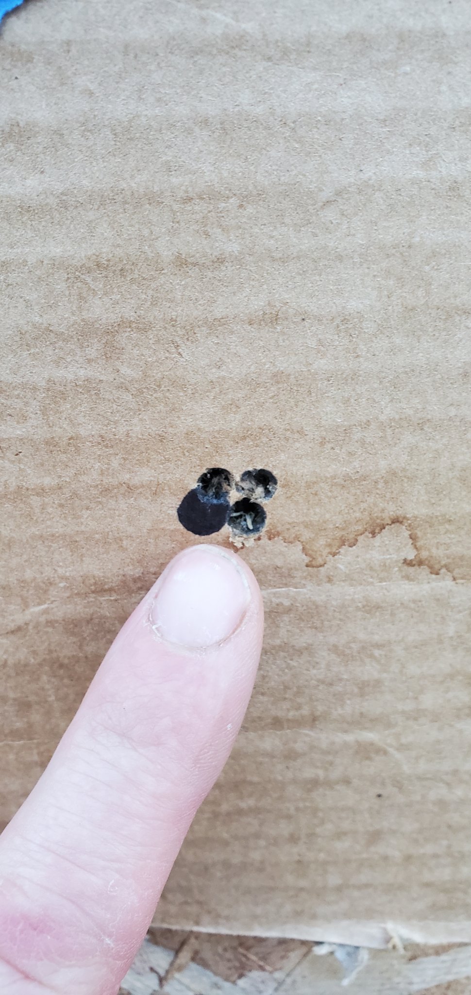

Normal groups with the Redding bushing
View attachment 8391932View attachment 8391933View attachment 8391934
Not all dies are created equal, no matter the price. That 'spensive juice ain't always worth the squeeze.
@drglock
It could be a slight difference in neck tension between the two dies? The sizing could be slightly different resulting in a case capacity difference. I bet slight tweaking would result in groups of equal size. If not you could go back to the other sizer and live happily ever after.

This was with using Redding die with the SAC universal neck bushing. Only thing I changed out was the bushings. So yes just gonna stick with the Redding bushing.
My bad I did say bushing die in the original post.
Micrometer the inside edge of the two bushings, Chances are they arent the same. Even a redding TiN coated 267 bushing sizes a thou smaller than a standard stainless 267. Then compress RCBS, Forster, Hornady 267 VS the Redding and they all measure a lil different! Sometimes a thou of nk tension will make that big a difference.
Reactions: CK1.0 and drglock
I’m pretty sure SAC has a taper to the first part of their bushing. Basically it only fully sizes about half the neck. I don’t remember who, but think Wilson does the same thing. They say flip it over if you want more of the neck sized.
Reactions: drglock

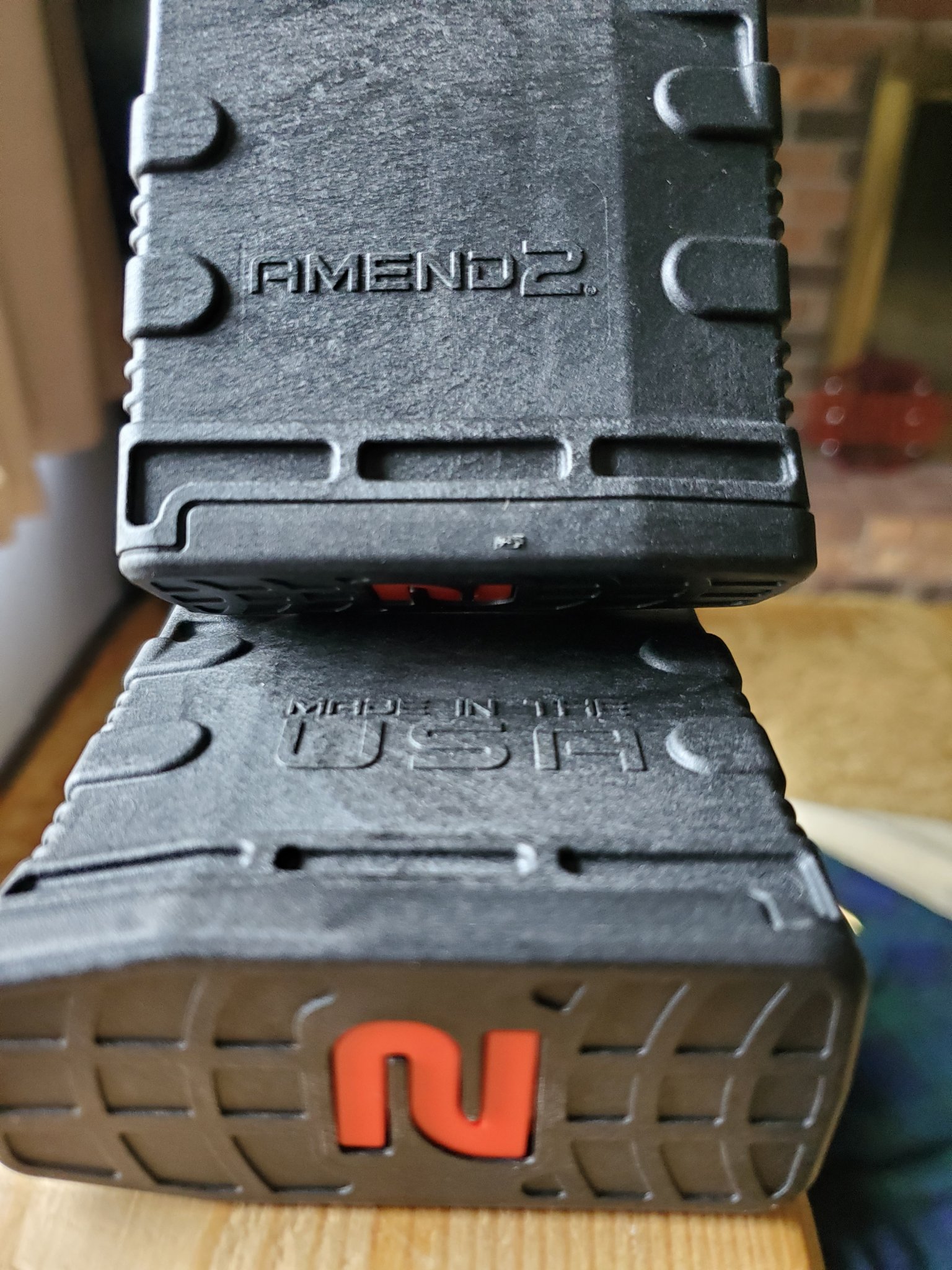

Not to get off topic with load data but what magazines are working the best with the GT?
I've talked with a number of shooters who claim they're seeing lots of feeding issues at matches
I've run arc aics mags(not in production currently) with arc, zermatt, impact, lone peaks with no issues. My first 6gt was on an impact and magpul pmags worked well after taking a dremel to the top of the lips and shortening them a bit. Tried metal mdt aics mags that didn't have a binder plate and they were problematic. Aw mags work well with my CDG action as long as you load them forward in the mag to where there case shoulder is up against the ridge in the magazine. I know there was a guy who 3d printed a spacer kit(similar to 6br spacers, but slightly shorter for longer coal) and put them in accurate aics mags and had good luck.
MDT 12 round metal AICS. Only issue is that I can only run 11 rounds reliably. If I run 12, the first round doesn't like to load every time. Generally not an issue as I usually only run 10 rounds when competing. When running 10 I don't recall ever having any feeding issues. I never had any feeding issues running 12 rounds when I was shooting 6.5 CM using the same mags.

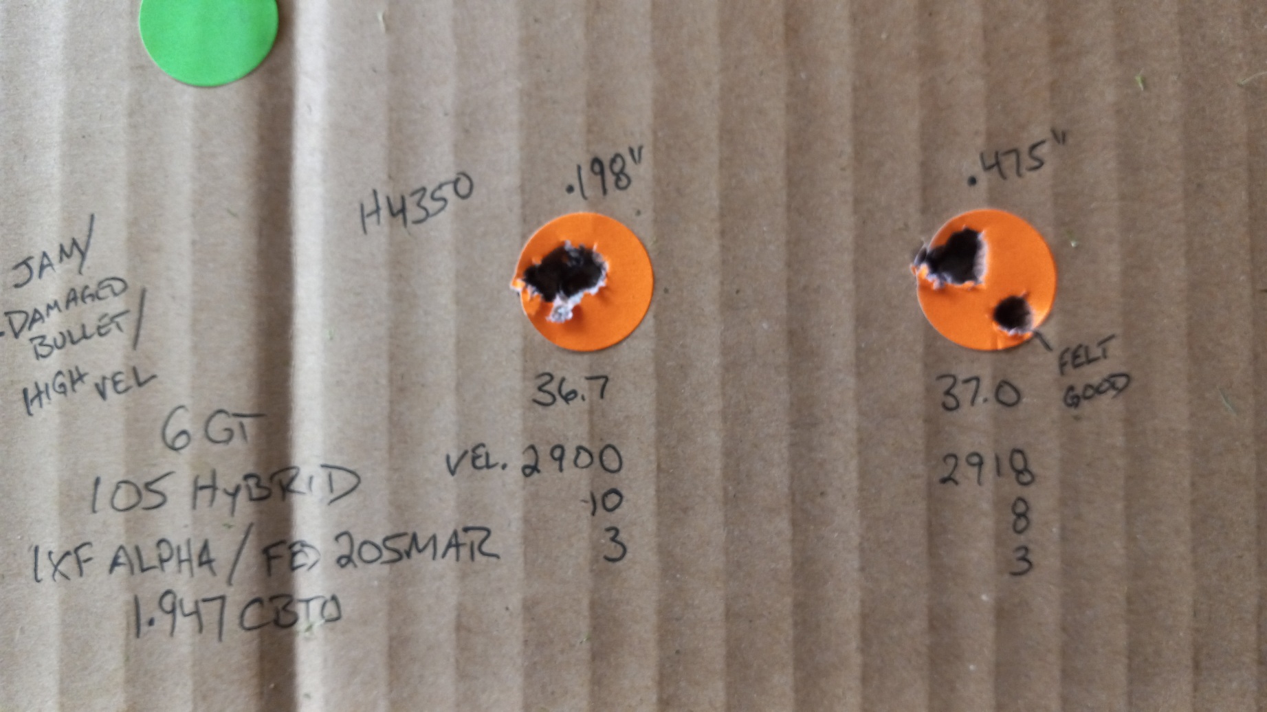

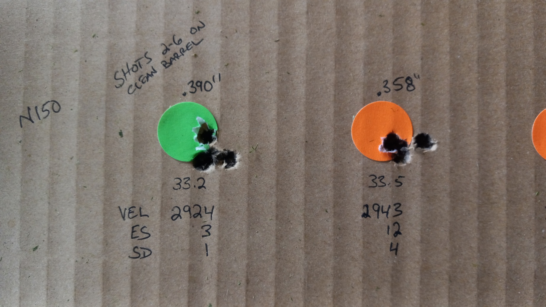

Well, this took a lot longer to get back to than I had hoped. However, I learned a ton.
I redid the ladder test and went higher than I ever plan on running it to try to learn to identify pressure better. The last 3 charges started to have a heavy bolt lift.
Pics of the ladder and the last few charged cases closer up.
Groups were better than I expected:
I dialed some elevation on the white target so I didn’t chew up the aim point.

I planned on running the speed around 2800-2850. Thinking I’ll drop the charges down to 32.0-33.0 and retest in that range. Also will need to do a seating depth test at some point. This was just a guess on the seating depth.
Overall, I’m am pretty happy with the results, being the first time I have ever tested my own reloads for groups and beyond just a ladder test. I’d love additional insight from anyone willing to offer it. Thanks a ton for all the help!
Same issue I have with my MDT 12 Rounders in my MPA Matrix Pro.

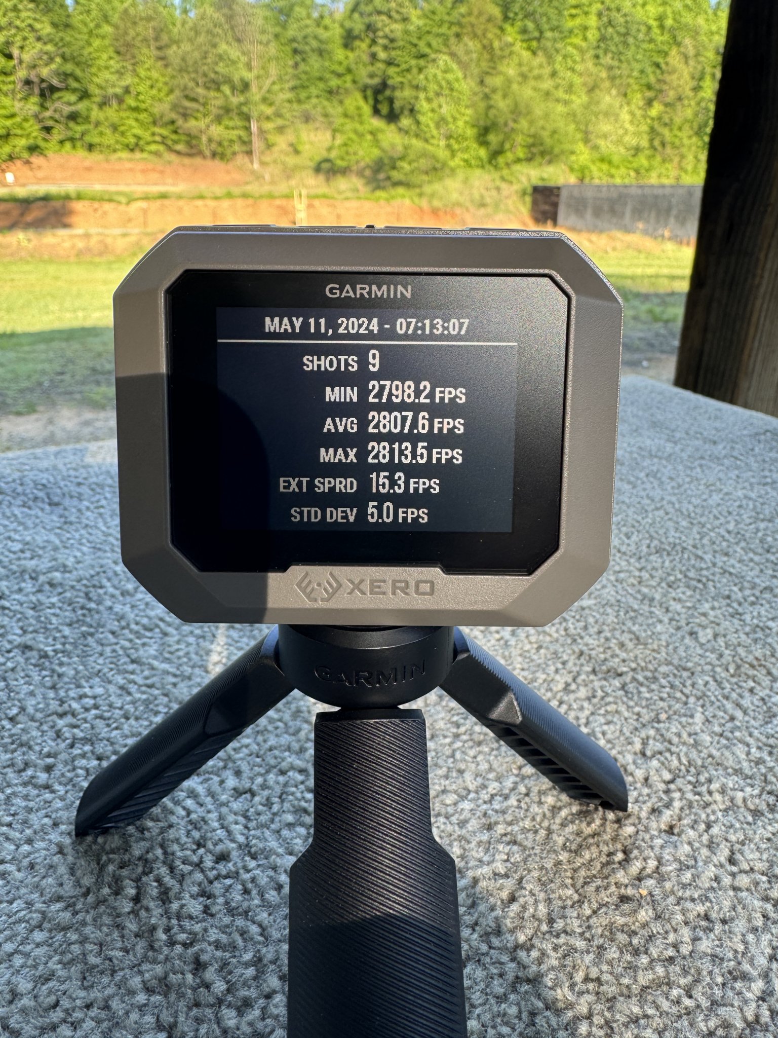

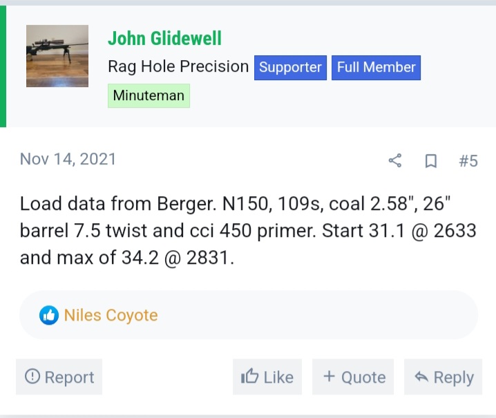

What length barrel? When I was first breaking in my GT, I was using factory ammo with a 105 hybrid. It shot lights out. I tested the last five shots with about 175 rounds down the barrel, and it ran 2,964 with an ES of 12, and SD of 4. My barrel is a 27" Krieger.
The powder was 33.5gr of what looked like either N150 or RL-16. I have both, and am going to start testing now that I have my hands on some hybrids finally.
I'm looking at screwing an 18" 6GT barrel onto an action I have lying around.
Aiming to get 2750 - 2850 with the 108ELDM & Varget.
Looks like most of this thread is running 26 inch barrels - anyone have results from an 18 inch?
