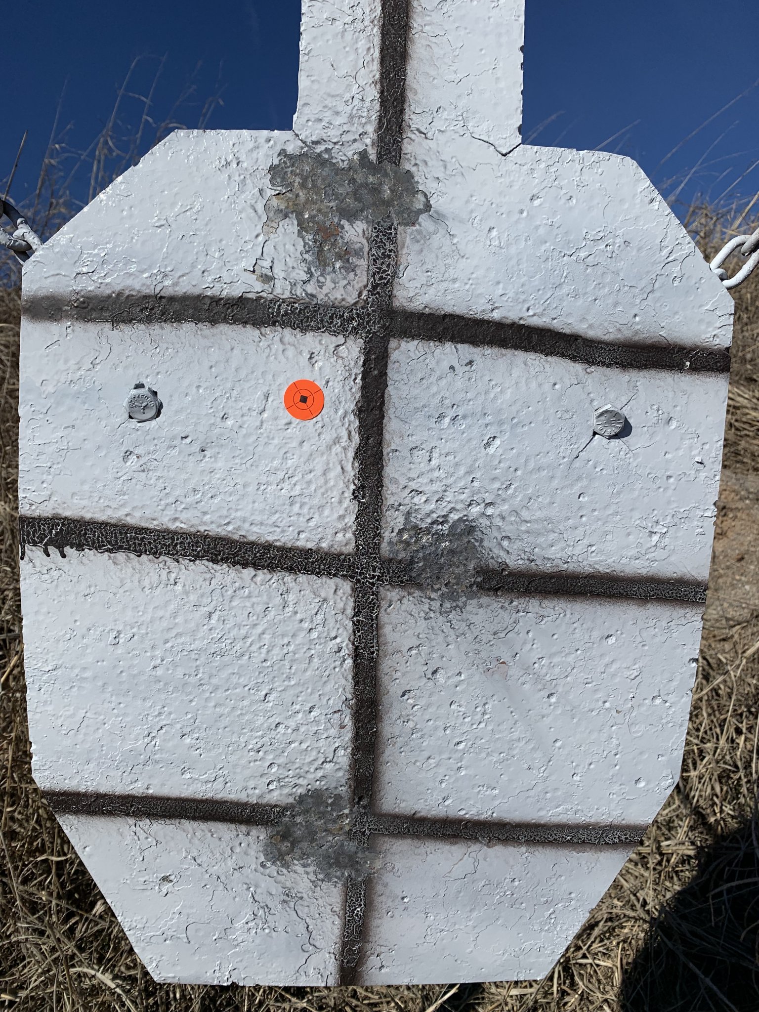

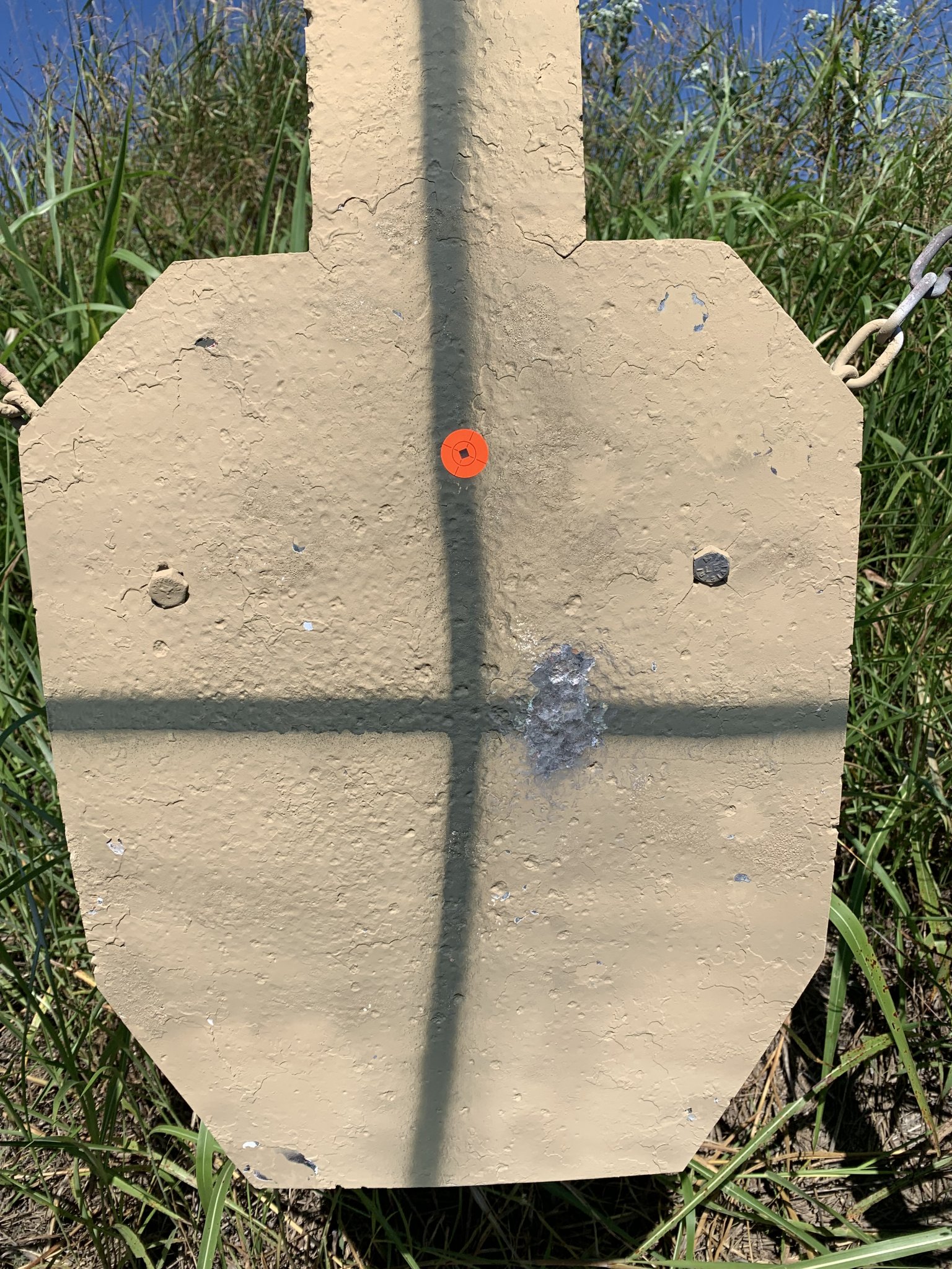

I was going just over 2700fps the other day and printed a fist-sized 5-shot group at 1000 yards.

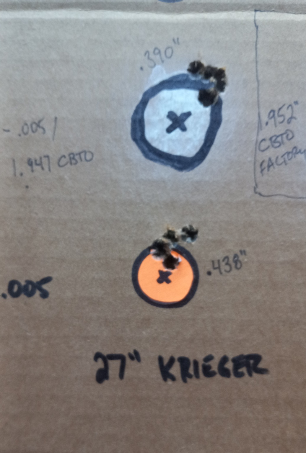

Decided to try H4350 and the 108gr ELD-M in this barrel. Made an arbitrary guess at .025 off as the ELDs always seem to shoot well somewhere between .020 - .040 for me. I went what I thought was "safe" on the charge weight range, and immediately exceeded my velocity goal of 2,925 - 2,950 on the very first weight (37.2).
Making matters worse, I managed to let a round slip low on that first group too 😄. The comp trigger on my AT-X is just too low for my numb fingers.
37.4 and I got a bit of a sticky bolt lift, and 37.6 raised an ejector mark on the brass.. I called it good there.
I'll probably drop down to 37.0 and play with seating depth a touch.

Not what I was hoping for. I did a small seating depth test with the 108gr ELD-M and H4350. Unfortunately I just didn't get the accuracy I was looking for. I have it with the 105gr Hybrids, but the 107gr SMK and 108gr ELD-M are a bit lacking.
I'm confident that I've exhausted reasonable attempts. Velocity, ES and SD are good, but I'm hunting for better accuracy.
No called fliers, those two that pushed way out on the first and last group were solid shots.

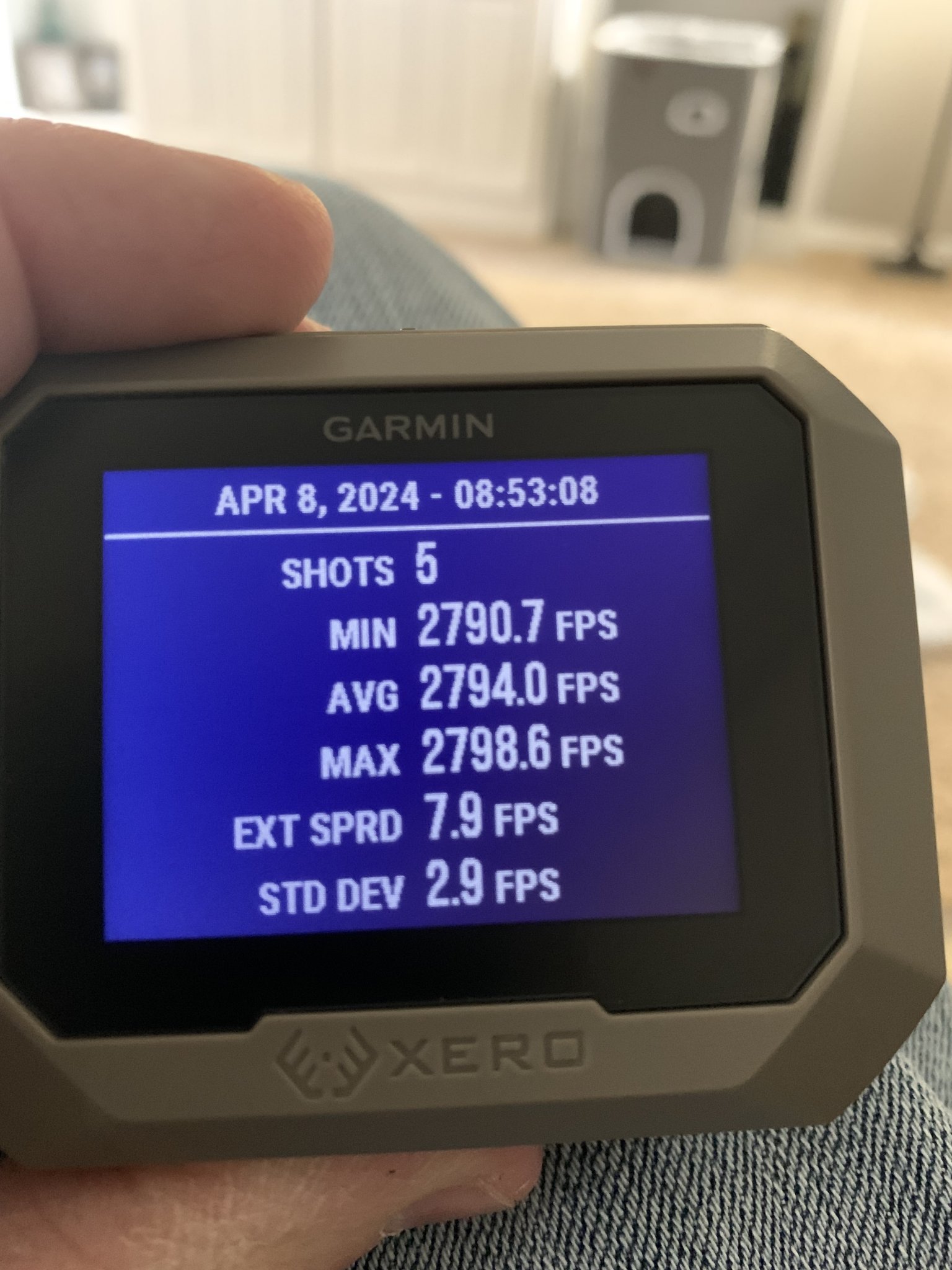

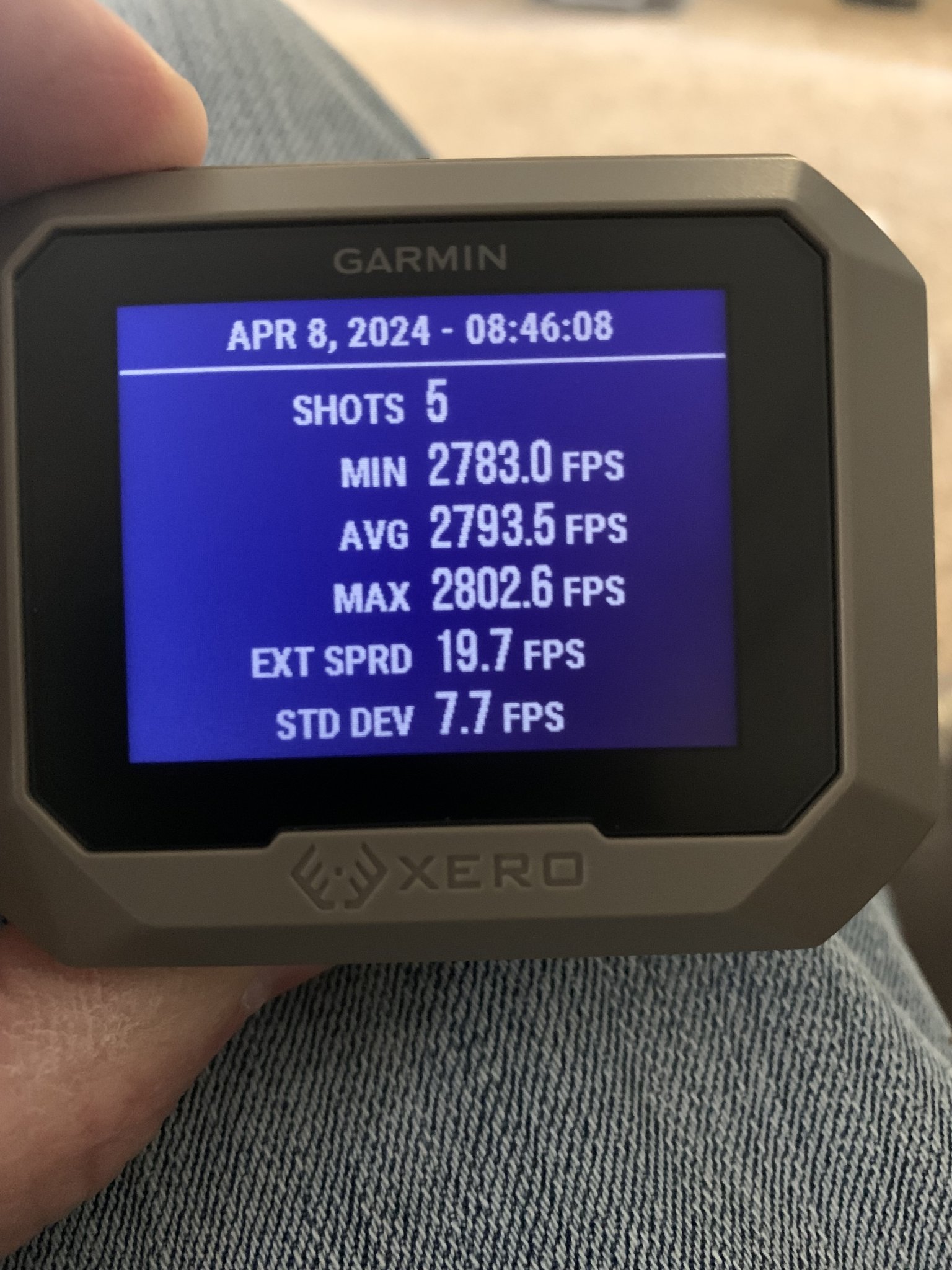

I ran the factory Eagle Eye Ammo over my chronograph, and got 2,967 FPS with an ES of 12 and SD of 4 (105gr Hybrids, and it shoots well). Barrel is a 27" Krieger.
^ I pulled two rounds and weighed charges, and they were both only 33.5gr. I'm at 37.2gr of H4350 to get that same velocity. I was thinking before when I looked at the powder granules that it might be Reloader 16...but that seems like the charge weight and velocity don't match for RL-16. Anybody try N540 in their GT? What kind of weights to velocities were you getting?

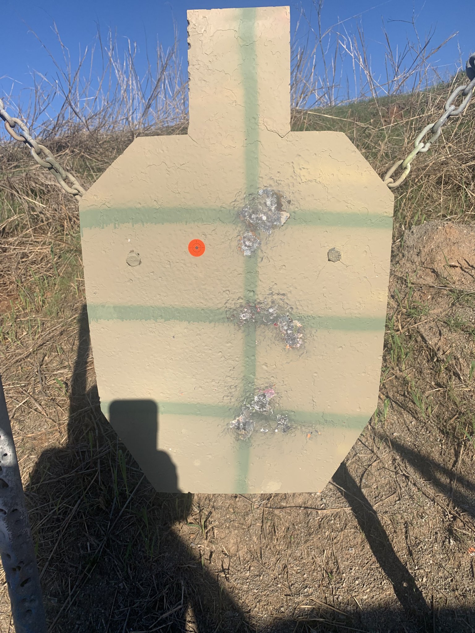

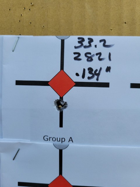

Seating test with 107s 5 each at 100yds….steel 550yds 5 rounds
4350, alpha, CCI 450s, 27” barrel .180 freebore
All mine are 0.170 cept the womans, and a barrel I bought second hand. I now have 6 on hand and have burned a few lol. I def prefer the long freebore.
Years ago I'd start close...like at or maybe .005 off then work back. When Mark Gordon did the seating testing in 2020 I think I had just replaced a 6BRA barrel and thought I'd try what he recommended. I started with a known load in my BRA and started seating at .050 off back to .080 off .010 at a time...I wish Ida kept the pics.....050 to .070 all shot 1 hole...not ragged but 1 hole... .080 started to open up but was a tight clover so I have been starting seating testing at .040 off every since and will work back to .080 and just about every time it ends up at .070-.080 I have never made .002-.005 jumps always .010 at a time.
