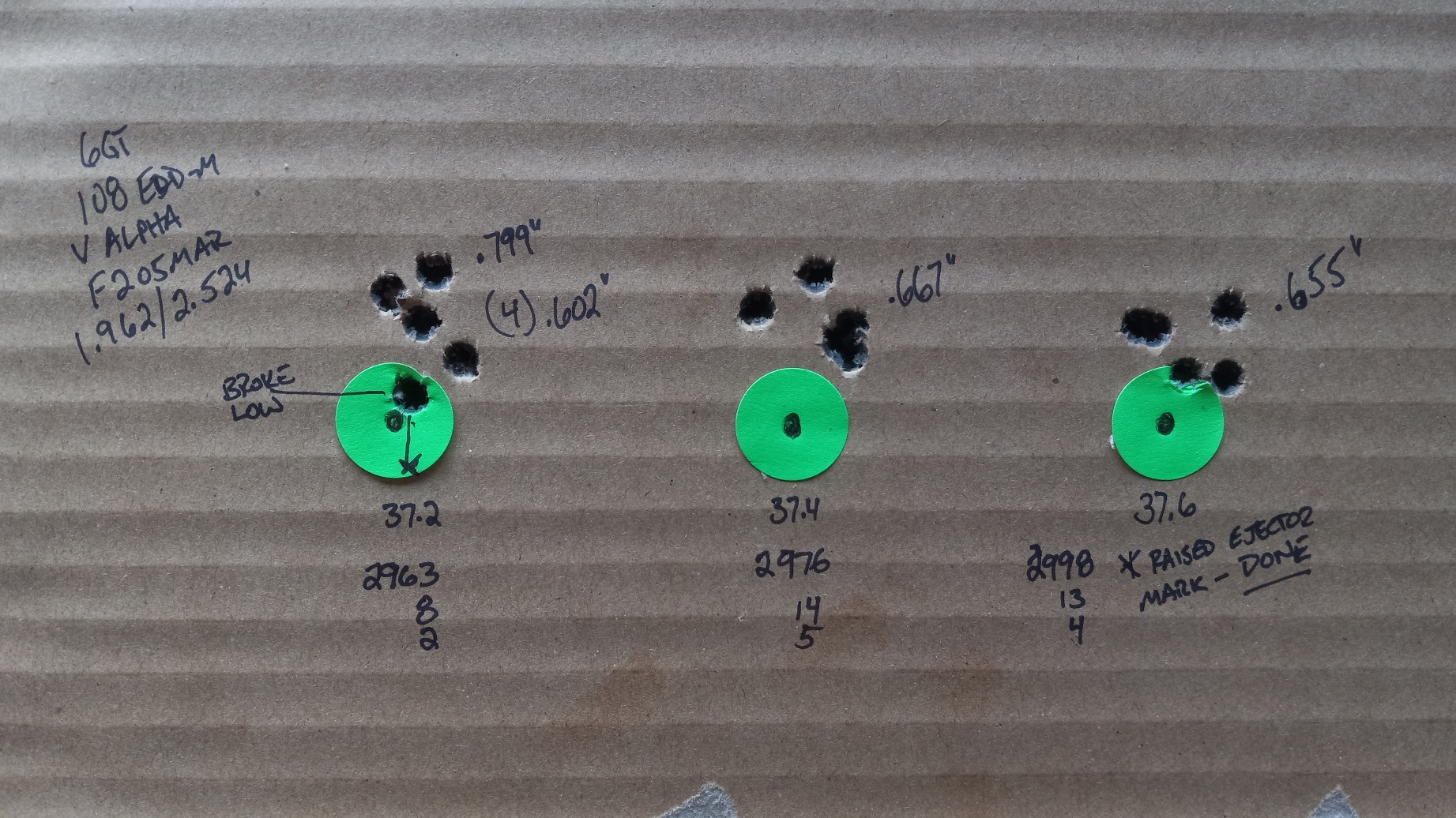

27" Krieger, M24, 1:8
108gr ELD-M
Alpha brass
Fed 205MAR
H4350
1.962 CBTO / 2.524ish OAL
Decided to try H4350 and the 108gr ELD-M in this barrel. Made an arbitrary guess at .025 off as the ELDs always seem to shoot well somewhere between .020 - .040 for me. I went what I thought was "safe" on the charge weight range, and immediately exceeded my velocity goal of 2,925 - 2,950 on the very first weight (37.2).
Making matters worse, I managed to let a round slip low on that first group too 😄. The comp trigger on my AT-X is just too low for my numb fingers.
37.4 and I got a bit of a sticky bolt lift, and 37.6 raised an ejector mark on the brass.. I called it good there.
I'll probably drop down to 37.0 and play with seating depth a touch.
Not what I wanted, but it is difficult to get too upset when I have yet to fire a group that exceeded MOA regardless of bullet and powder.

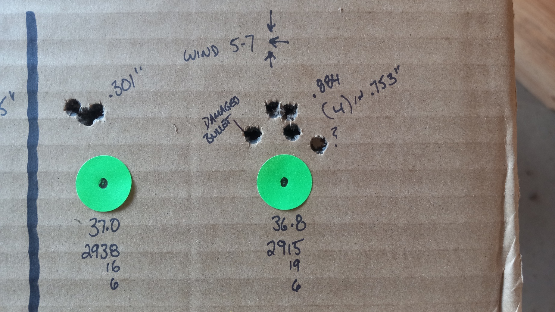

Pulled my last two loads, dropped charges, and shot them. 37.0 looks promising, but one 5-shot group is a fluke. I was getting pretty excited though when the first three shots all went into the same exact hole..
I literally started scanning the target thinking I had wild fliers.
36.8 dropped one right that was unexplained, and the left flier was probably due to that bullet having a jacked up tip that I created when I pulled it (inertial). It had a pretty good lip put in it.

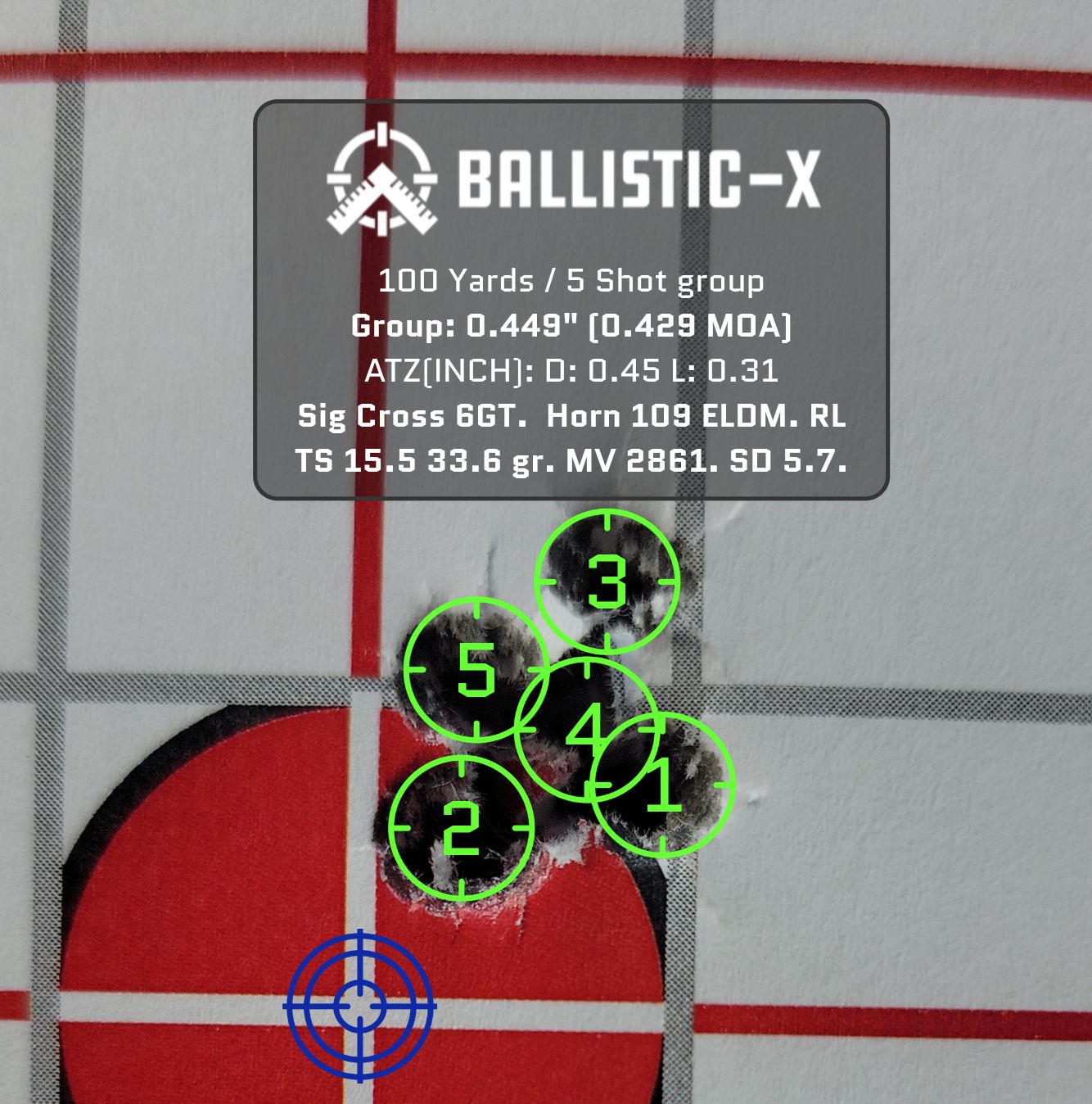

Wife's GT just went over 2k rounds. Adjusted jump for erosion and added some powder. Still shooting great. 109 LRHT and RL 15.5. And this was her shooting. 12th firing on Alpha OCD brass.
I still think RL15.5 is the perfect powder for the GT too bad you can’t hardly find it and the price being so high.

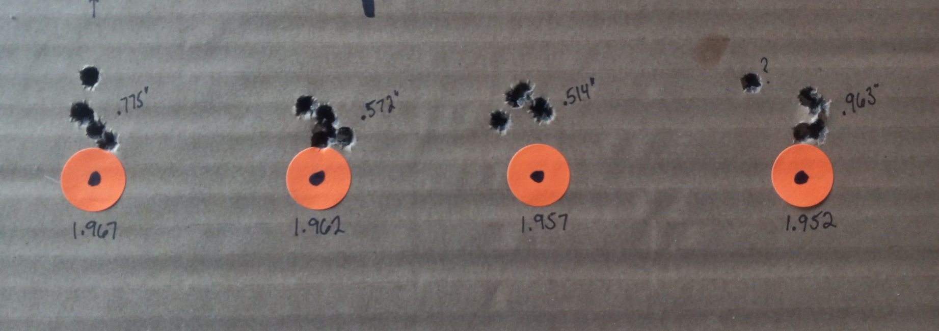

Not what I was hoping for. I did a small seating depth test with the 108gr ELD-M and H4350. Unfortunately I just didn't get the accuracy I was looking for. I have it with the 105gr Hybrids, but the 107gr SMK and 108gr ELD-M are a bit lacking.
I'm confident that I've exhausted reasonable attempts. Velocity, ES and SD are good, but I'm hunting for better accuracy.
No called fliers, those two that pushed way out on the first and last group were solid shots.

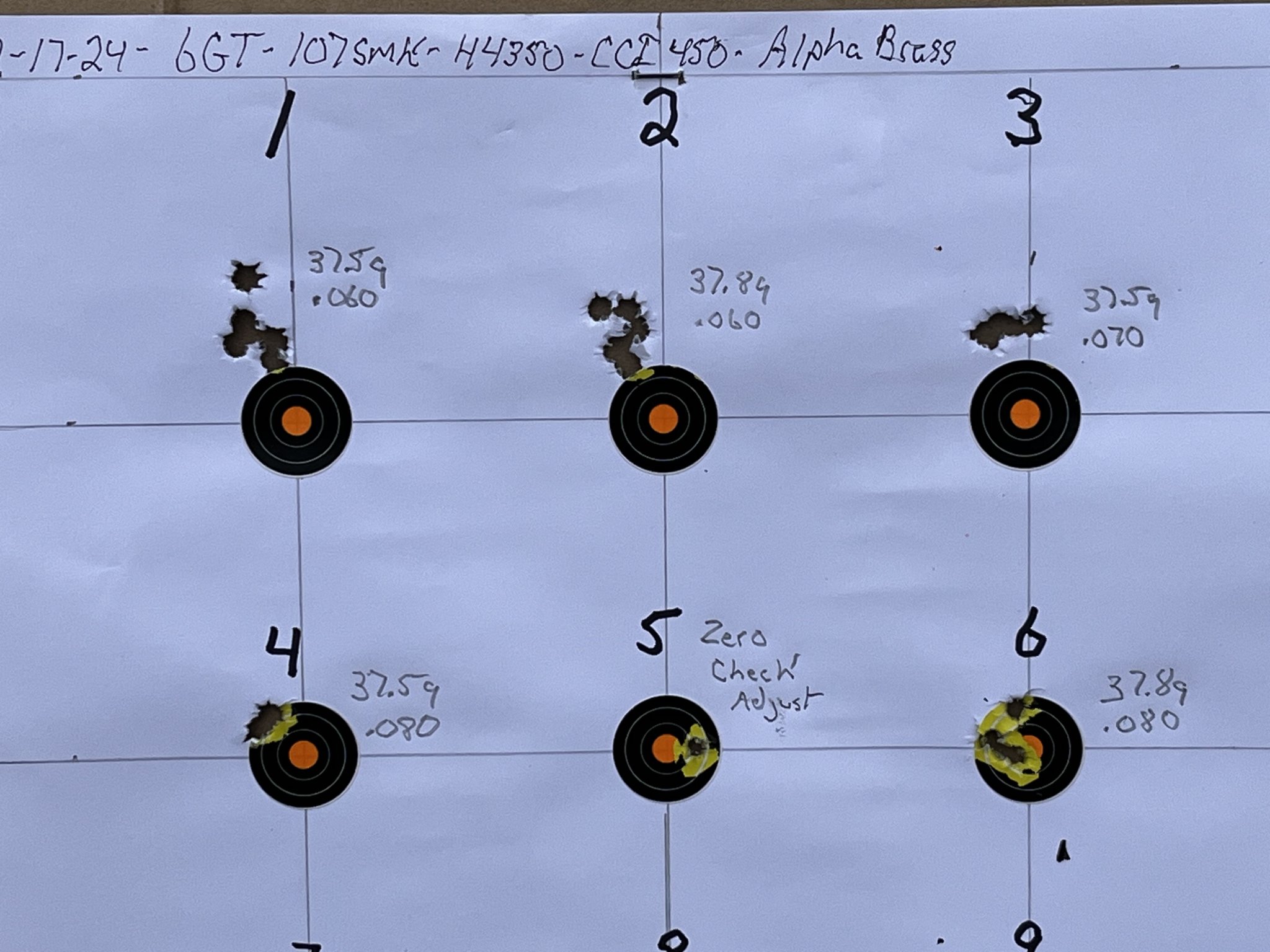

Seating test with 107s 5 each at 100yds….steel 550yds 5 rounds
4350, alpha, CCI 450s, 27” barrel .180 freebore
