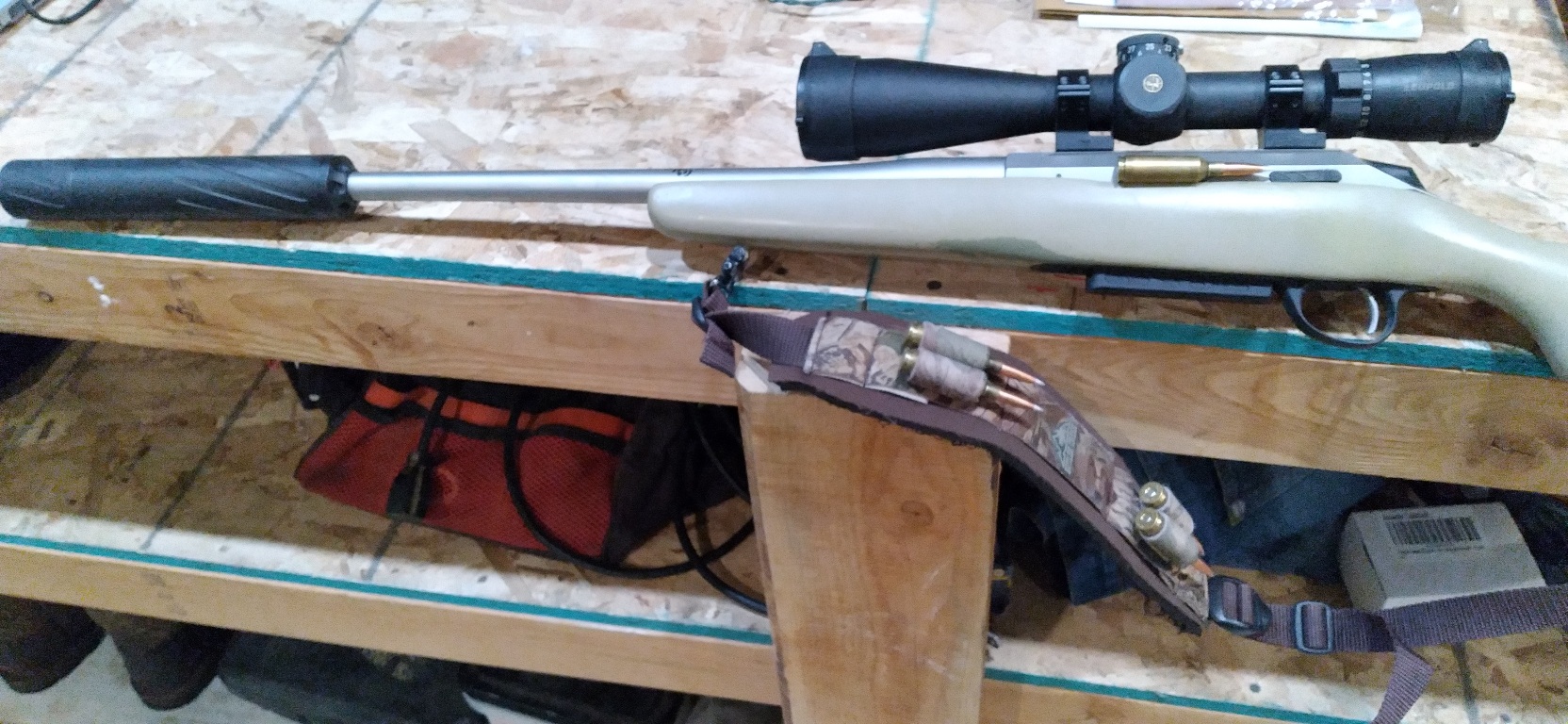

You mean like this..
.300 WSM and it's compatriots were exactly why I commented that it's an irrelevant question for bolt actions. Semi-autos have more restrictions on the action, particularly the bolt face, which is why I think there is potential in large frame semis to equal the performance of 300WSM.
Also, nice looking setup!

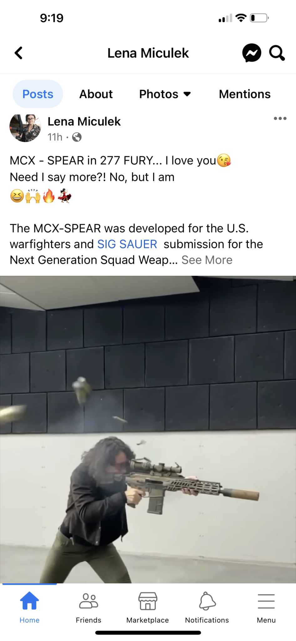

That was what I was thinking when I saw a video of the new SIG Spear running their high pressure ammo (6.8) on full auto!
I have been skeptical of the 277 Fury from the beginning. May work in a bolt gun but in a semi automatic battle rifle containing 80,000 psi in rapid fire for 500+ rounds in a firefight without the gun overheating rapidly and failing seems to me a tall order. Maybe my skepticism is misplaced. What do you guys think who have had real combat experience?
nothing to do with combat experience there, its all in the metallurgy. The higher nickel content in the alloys used for the Spear barrel gives it better heat stress and wear resistance. Same reason the alloys are used in aerospace in high heat applications (usually in engine components)
the reason they haven't been used before now is expense, as regular stainless is cheaper and easier to work with.
the Ruger SFAR is another example of using better alloys than "standard" to achieve things regular stainless isn't capable of (barrel extension made of Aermet or similar high-nickel alloy)
Reactions: Tokay444
I mean, there's videos of them putting more than 500 rounds through a full auto spear... with a suppressor on it.
