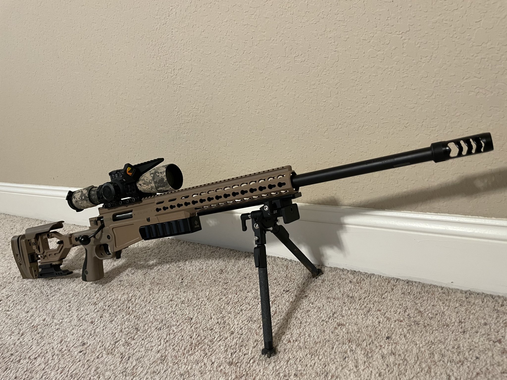

Thank you @MOUNTIC AT-x showed up. So just need to wait for the scope now. And the HRD 6br kits. Glad the weather is shit. Makes it easier.

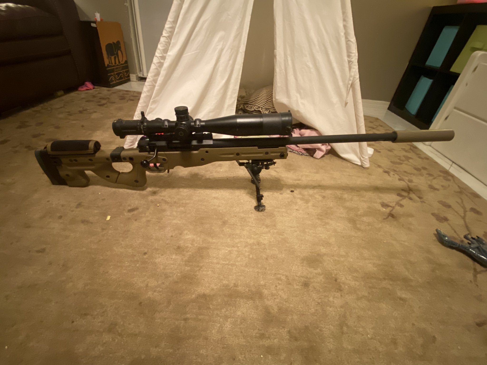

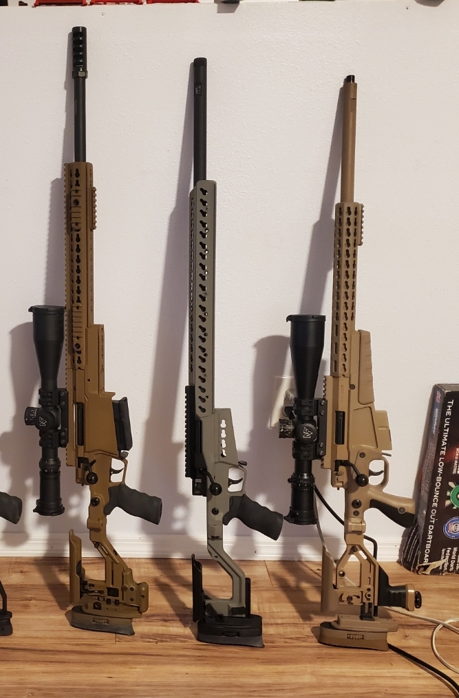

Pretty similar set up, you will like it!View attachment 8046773

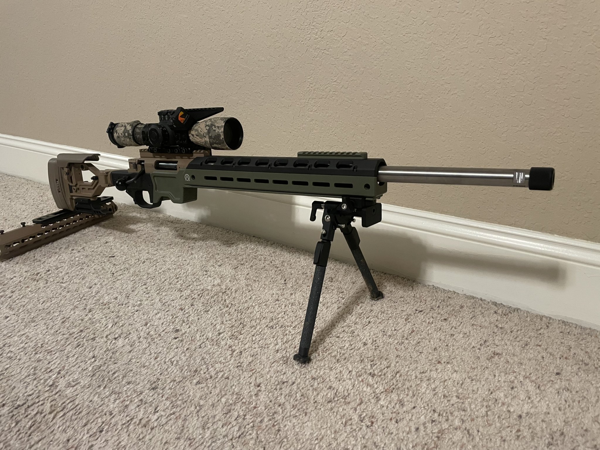

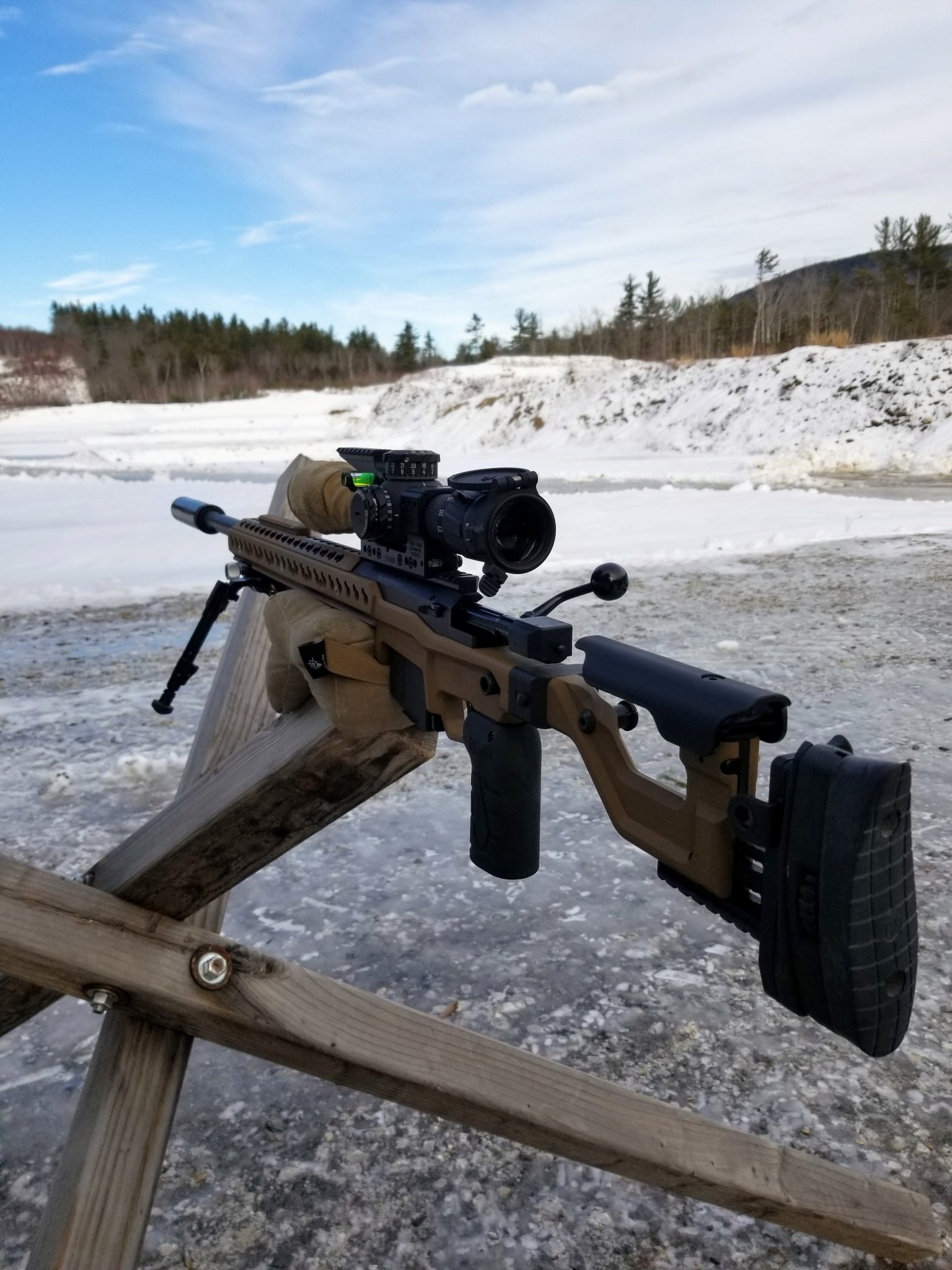

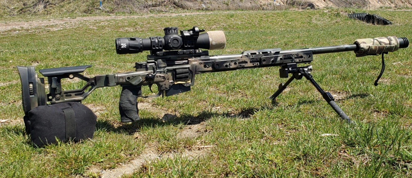

After(ish)

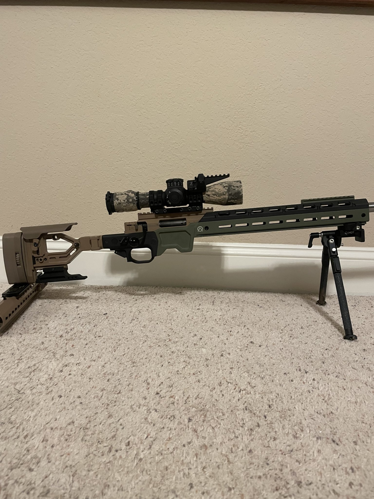

Just got the AX dry fit into the Vision chassis. Time to send it off to Primal Coatings for a burnt bronze based snake skin Cerakote job and pick a grip while it’s gone!

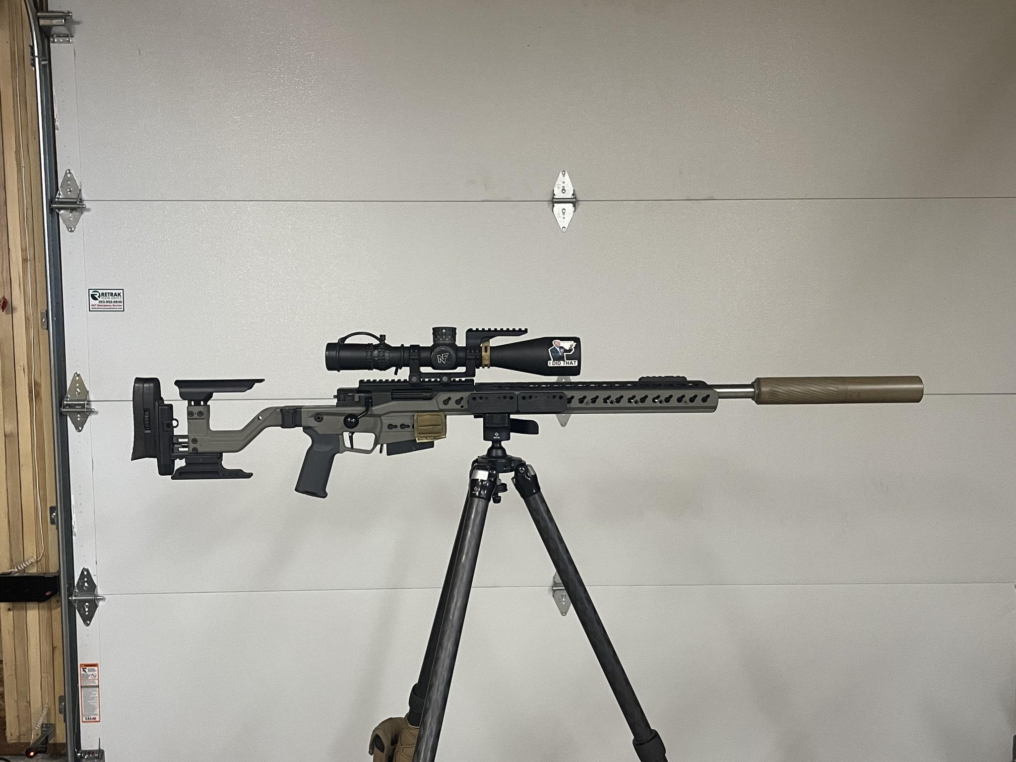

very similar setup.
Franks runs it this way too. Probably just fits him better?But why is your buttpad upside down?

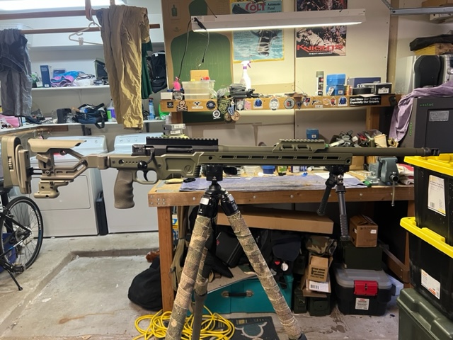

EIOk, so what's the consensus? Which spigot should I get?:
Anarchy
Elite Iron
Accu-Shot
I'm not a huge fan of any wobble/slop up front and I have arbor presses and a full machine shop for any installation needs that arise. They're all within $20 of eachother.
This is correct! (The fit part)Franks runs it this way too. Probably just fits him better?
I called them, ended up chatting with Dale at Elite Iron. One of his spigots is now in the mail.
