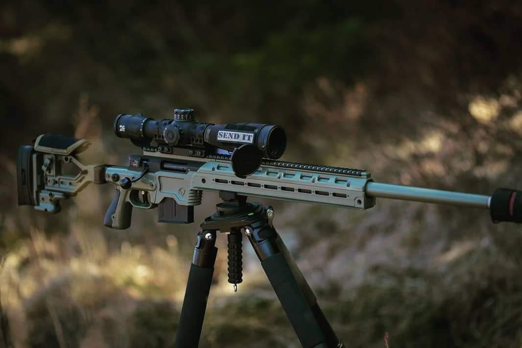

Are you kidding? SB over japanese every freaking time brah.... Tbh the 520 us is probably one of the most versatile badass scopes ever made with dtii turrets. Image isn't as great obviously as a full size scope but the size to performance is hard to beat. I doubt I will ever sell my 520s
Well I grabbed a 4306 and slapped it on. Yeah it’s pretty sweet - when I was 17 I always wanted an AI with a SB on it so I guess that ticks it off the list.

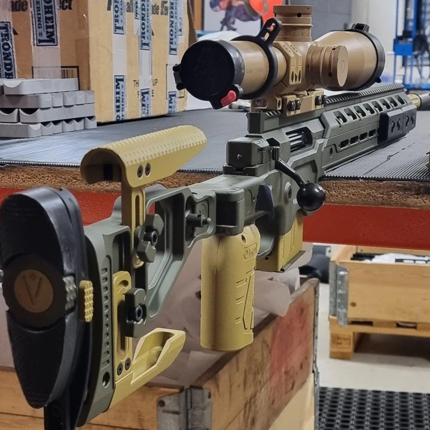

So “Accuracy Obsession” is now “Vision?”

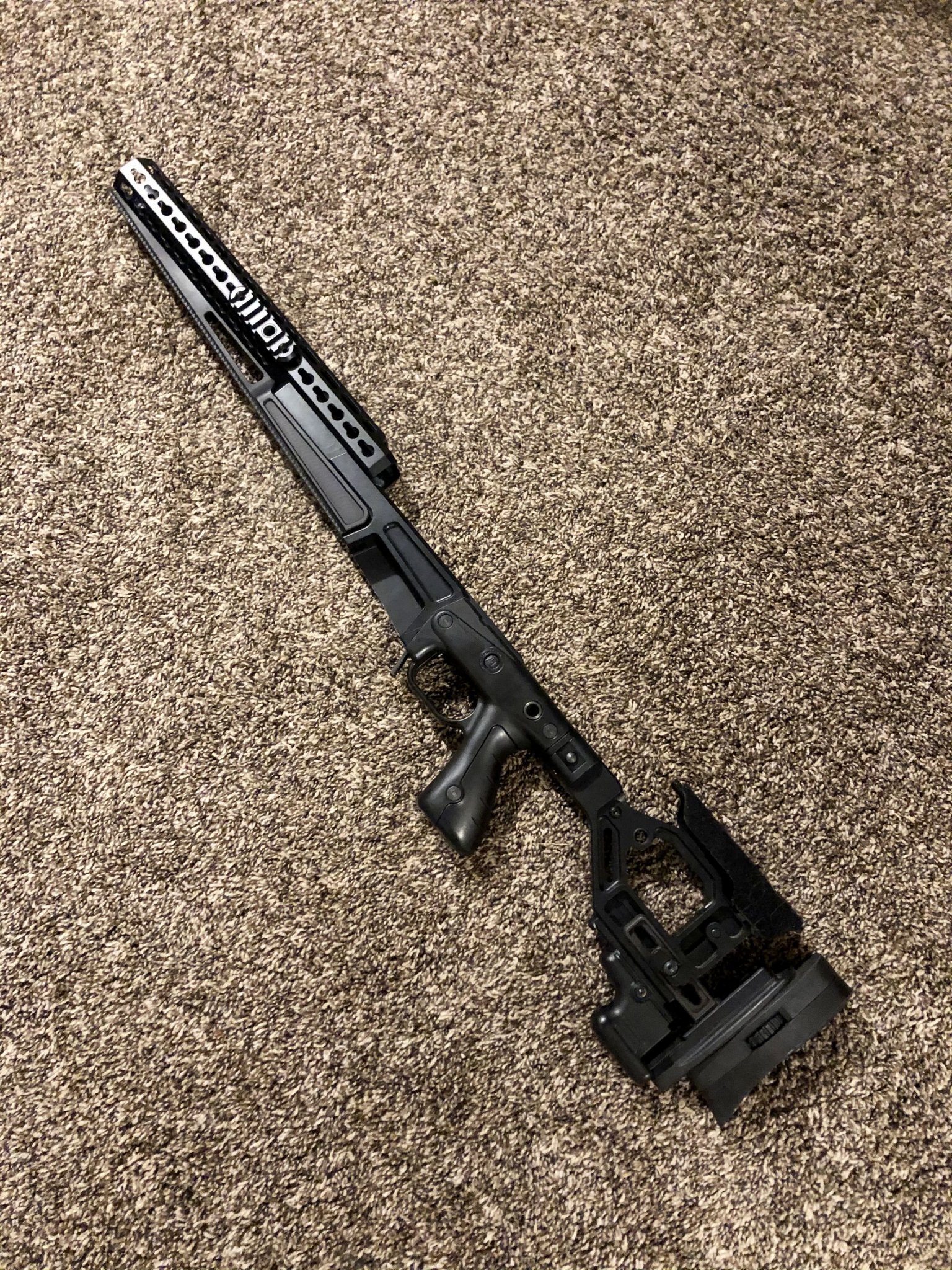

After the initial batch of AO chassis were made here, Vision in Norway started making them with a slightly different design to better integrate with his other chassis aesthetics and existing machining programs.
While a Vision AXSR chassis would be cool, the ROI probably isn't there for how niche it would be and how expensive the prototypes would be. Plus a new AXSR is like $11k as it is.

There’s a small number of us who are cultured and with fine tastes after a chassis made along the lines of the original, “conservative” AT / AW / AWSM layout, not the newer designs.
Yes, the ROI would put you in the red.
There’s a small number of us after a chassis made along the lines of the original, “conservative” AT / AW / AWSM layout, not the newer designs.
Oh man an old school thumbhole chassis made for the AXSR would be tits
Right when an AO chassis is made, they’d come out with axsr prs version a year later…
