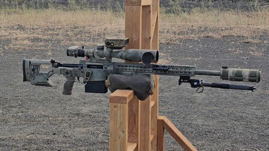

For those wanting to shoot NRL Hunter with your AXSR. I found a way without any excessive purchases or the use of a 9-axis CNC.
For the barrel I estimated the weight for a 20" CF 6.5 CM, using my Proof CF 24" 6.5 PRC (56.1oz) and my Proof CF 18.5" .308 Win barrel (48.3oz). I figured I would try CarbonSix barrels using their Sendero profile.
There's 5.1oz tied up in small parts in the stock alone (extension plate: 1.0oz, QR latches: 0.6oz each, washer: 0.3oz, stock folder latch parts: 1.2oz, and the QD receivers: 1.4oz). The standard grip is 4oz, which can be replaced with an MKM Shadow Crossover Grip (2.3oz).
I am tempted to ask MKM to make a fixed stock adapter similar to the ATX to drop around 3oz potentially.
The other option is to drop the bipods and run a suppressor, and rely on the tripod or shoot from a pack.

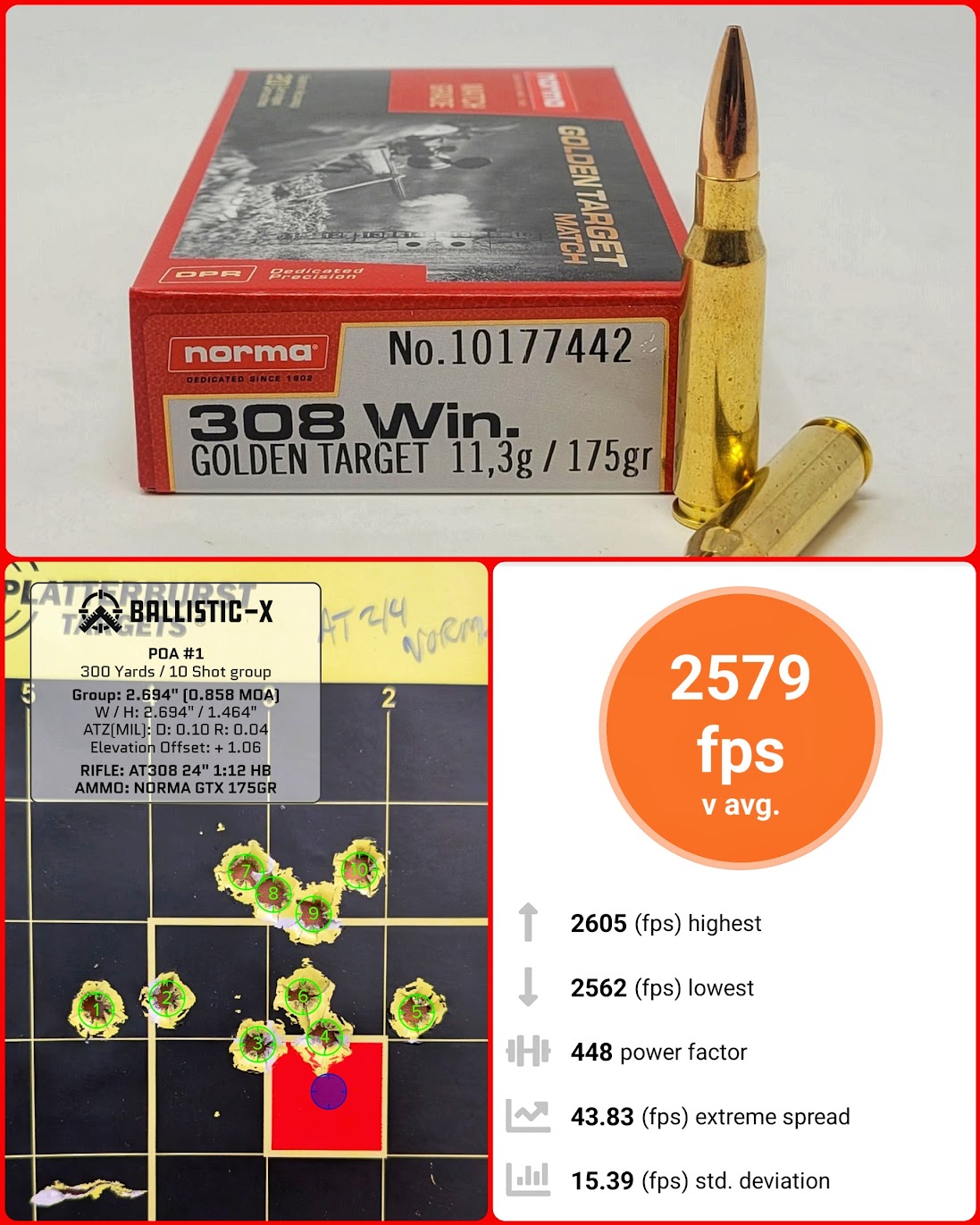

I'm throwing this into the hat as I pulled out my targets from the last range session:
Norma Golden Target (GTX) 175gr .308 for the Lothar-Walther 1:12 barrels, 20" and 24". Putting the data here so hopefully someone else can find it useful. I think it could group tighter, on a day with no wind and better fundamentals by the shooter. It has an unusually high BC of 0.547 G1 and a length of 1.236", shorter than the 175gr SMKs 1.24".
I have used these for general shooting. I'm not all that impressed with their performance.
I shot them out to 600 at my local range and 5 shot groups opened up past 400 yards compared to FGMM or TRU 168 grain cartridges.
Norma used to be cheaper than FGMM, which made them a good deal. The difference is a lot closer now. I'd rather pay a little more and be assured of better performance
Reactions: HKSniper11B
