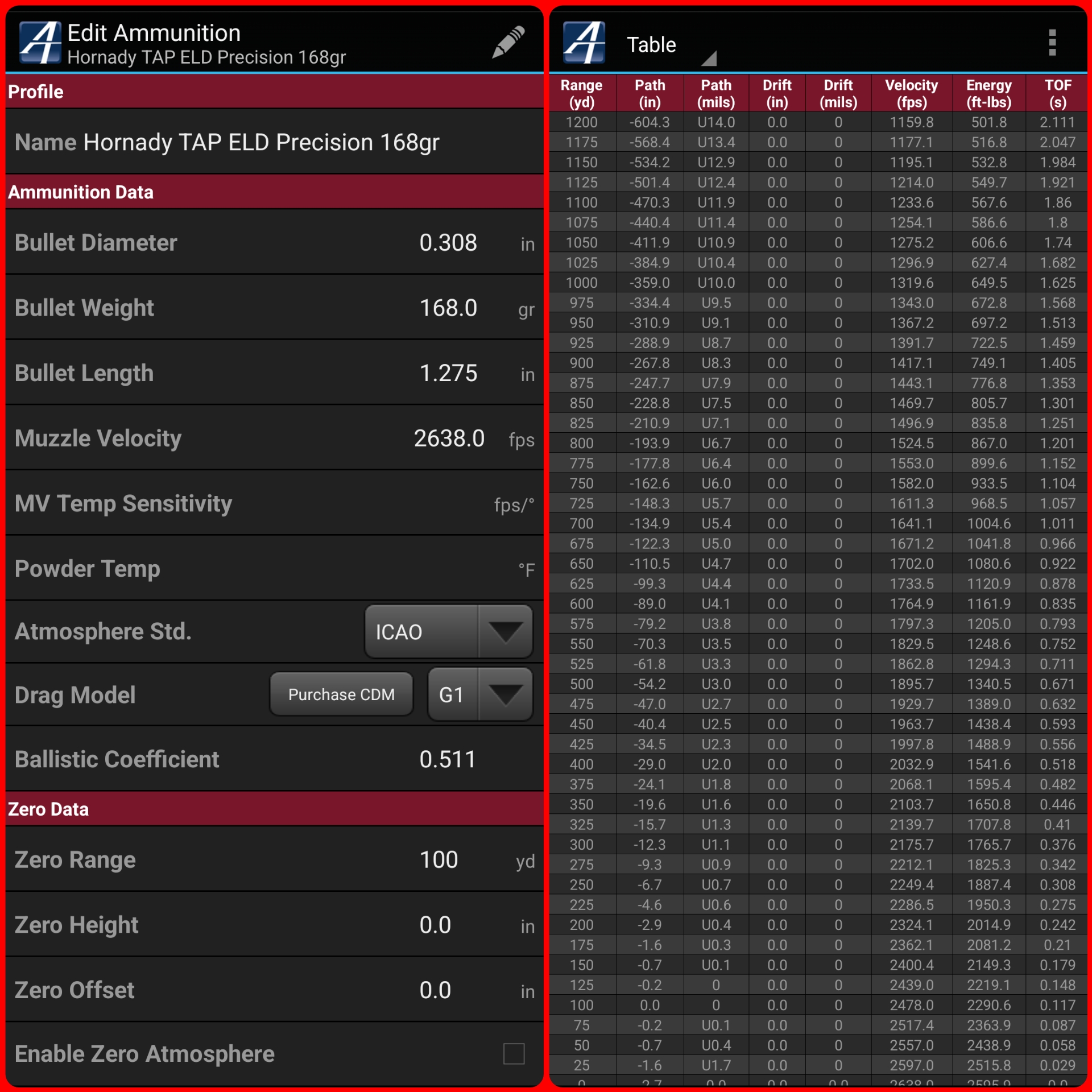

This is the sole time I was ever able to group Hornady TAP ELD Precision 168gr well; it was like a laser beam and felt effortless. This one box shot well the entire day across the board. This was in March 2024, and I haven't been able to replicate it since. I'm trying to get it to work again as it is the ammo I wish to use while also having the best BC and features for long range.

This has been the current trend with Hornady TAP ELD Precision 168gr, tested with both the 20" and 24" barrel. Since removing and retorquing the barrels on both rifles, the groups have shrunk from 4MOA down to this. The 24" likes it a lot more, and without the flier, it would have been a 0.8 MOA group. I need to get more of the ammo and test more for a greater set of data.
Both rifles now, strangely, like Hornady Black A-Max 168gr: 20" above, 24" below. They were shooting around 2 MOA prior. This is was unexpected and also needs more shot data.

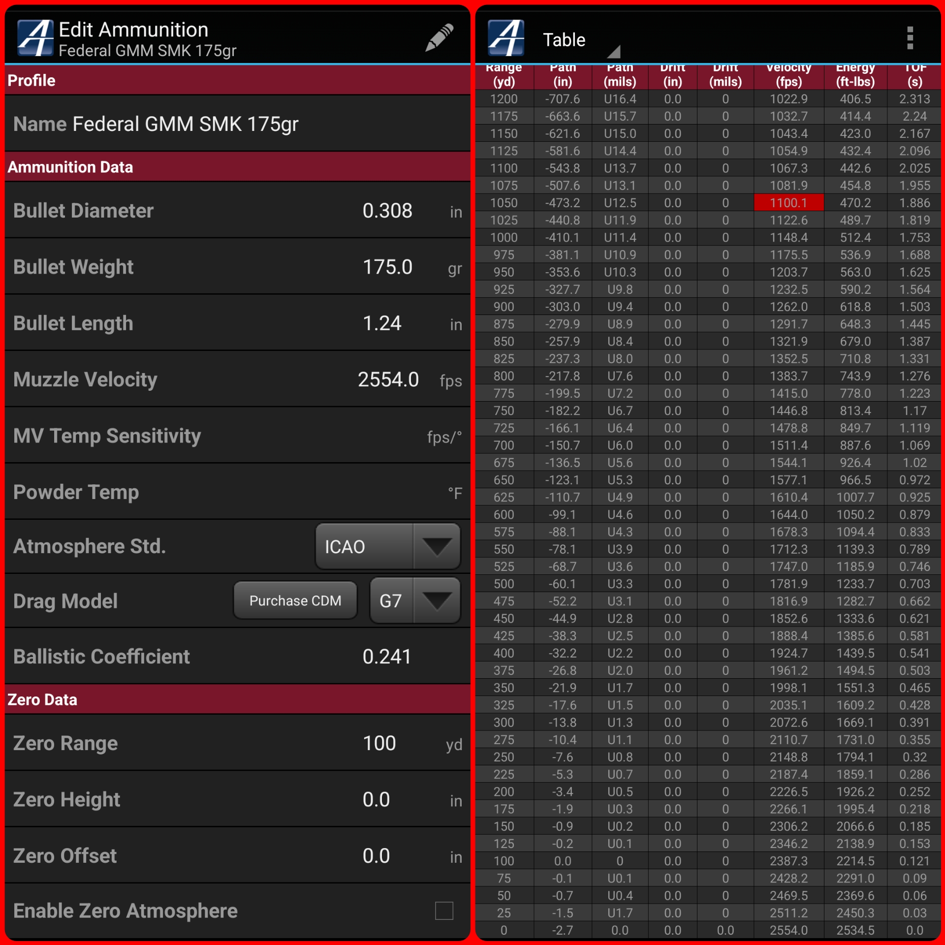

I'm getting 2512FPS from the 20" barrel. I wasn't able to record proper velocities from the 24" and redoing that is a priority of mine. But I'm suspecting around 2600FPS. With the 20" barrel, FGMM is going transonic right at 800 yards, and subsonic at 1000 yards. With the 24" barrel, FGMM is trans at 825 yards and subsonic at 1025 yards. Effectively hitting within the transonic range is not easy to do.

My factory barrel is 2750 with 175 FGMM.
Where do you live that a 175 is going transsonic at 800?
That 175 at 2550 is still going 1175 at 1000 in a standard atmosphere.
Do you live in Death Valley when it is freezing or something? It is pretty hard to get an atmosphere that dense.

Altitude is 1050 ft. I double checked latest data from my chronograph, and since reseating the barrel, the 20" is getting 2550fps from Fed. GMM SMK 175gr; I've gained 50-75fps since the reseating and retorquing of it. I don't currently have data on the 24" barrel, as it got corrupted and didn't capture the velocities.
All I shoot right now is FGMM 175gr .308 and it's consistently around 2600 in my 24" (1/10 and 1/12) and 26" (1/10) barrels. @MK20 are you sure you're getting 2750 from FGMM .308 and not the 7.62? Because that's the only way I was able to get anything over 2700.
Regardless, @HKSniper11B you'd do fine with the 175gr SMK even if it is going transonic. Frankly, I think the accuracy gain you've demonstrated with that ammo will outweigh the ballistic advantage going with something else. That said, have you tried the 185 FGMM yet?

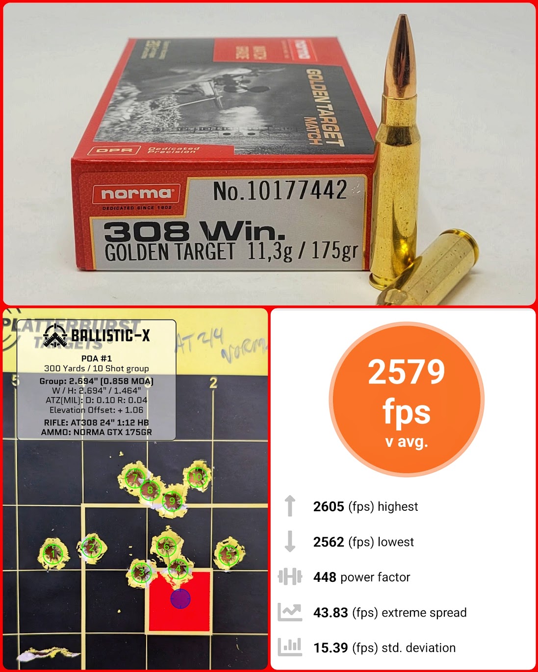

I'm throwing this into the hat as I pulled out my targets from the last range session:
Norma Golden Target (GTX) 175gr .308 for the Lothar-Walther 1:12 barrels, 20" and 24". Putting the data here so hopefully someone else can find it useful. I think it could group tighter, on a day with no wind and better fundamentals by the shooter. It has an unusually high BC of 0.547 G1 and a length of 1.236", shorter than the 175gr SMKs 1.24".

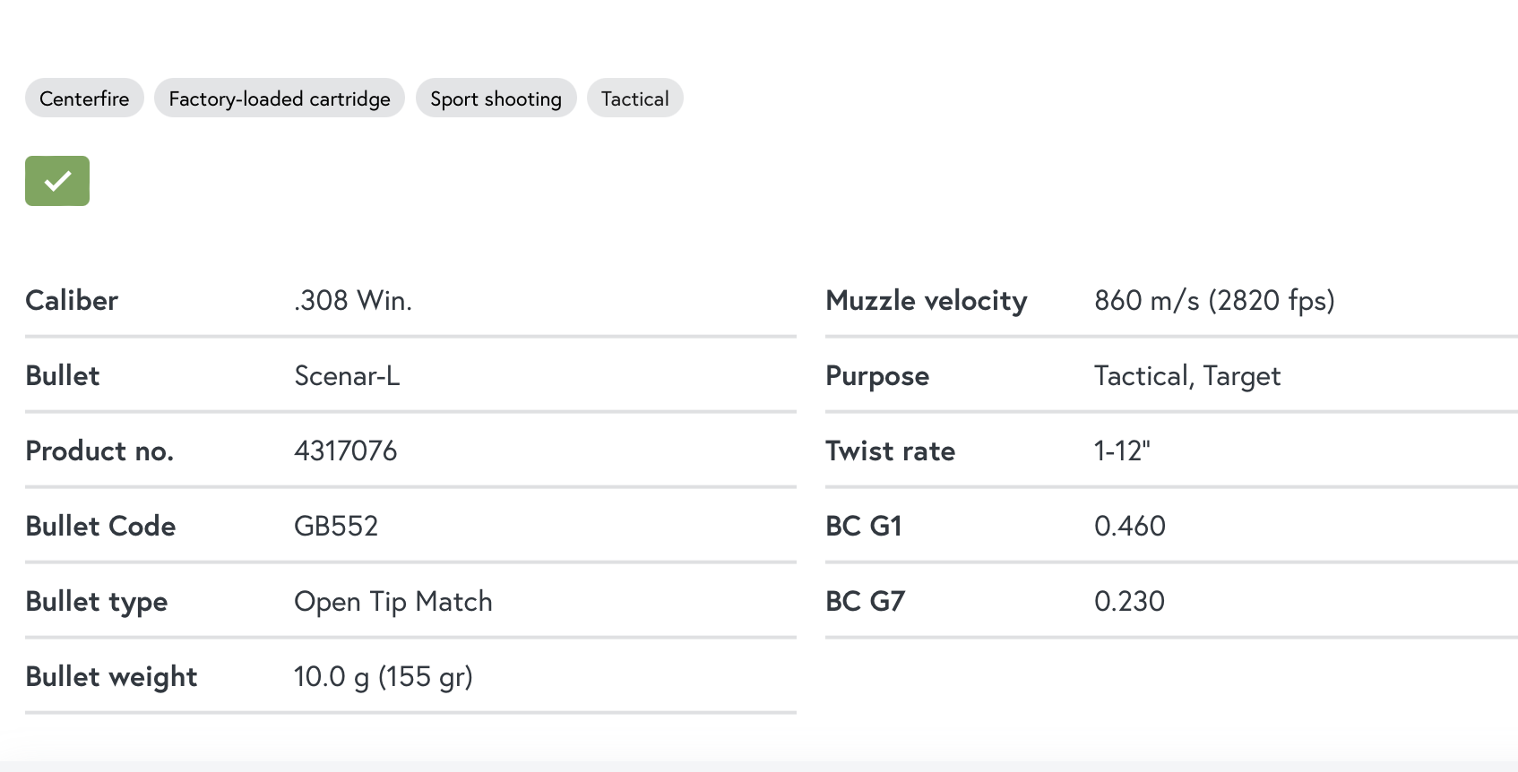

Your limits are less about bullets and more about wanting to do it with factory ammo. They just aren't loaded hot enough. My 175 sierras are super out to 1k and it's not even near its max load.
A great bullet for you would be a 169gr sierra match king to play nice with your 1/12 twist and get you a smidge more velocity. But you'll have to hand load it.
Also test the 185gr berger loads. Every barrel is different and barrel length matters as well as twist. For example a 14.5" 1/7 twist barrel stabilizes a 55gr head while my 30" with the same twist literally explodes the bullet. You might be fine with the 185. Calculators are best estimates not hard fast rules when it comes to some of this stuff.
Reactions: HKSniper11B
The ballistics are notably different in the Bartlein 5R 1:10 twist barrels, and superior to boot. Unfortunately, they are out of stock and are slowly being caught up. I spoke to Bartlein personally inquiring, but it'll be a while. Next year sometime, is what I heard. Further, they're in the $900-1000 range in price, $791 with my military discount. And as long as I'm spending money changing things, I could just switch to a better caliber, or change to a different rifle altogether. But that isn't the point, so I digress...
The Lothar-Walther barrel is extremely capable. What's baffled me is how few on SH and elsewhere have documented ballistics with it, even reviewing this thread and others from many years past. That said, the standard was 168gr FGMM for a long time, along with Black Hills 168gr. And, many at that time saw 800-900 yards as the limit regardless. Even just 10 to 20 years ago, ballistic expectations were different. Recall that the Accuracy International PM was designed to shoot (UPDATED): 7.62×51mm L2A2 144gr Ball Ammunition which absolutely does not have the ballistic capabilities of today's ammunition i.e. SMK.
So, I'm left wondering how today -- with modern ballistics and modern rounds -- are AW and AT owners maximizing the original Arctic Warfare profile 4R 1:12 twist Walther barrel and pushing it to 1000 yards. And if they are, then how, and with what round?
Q.E.D... if you are taking my response personally -- while laughing at my previous posts and disingenuously responding -- then those emotions are yours to own, and not my responsibility. We're all adults here.
I have said that I have that EXACT LW 1:12 barrel and my FGMM 175 factory ammo is shooting at 2720 which is more than enough for 1K.
What is your velocity you are getting with factory 175 FGMM out of your LW, by the way?
