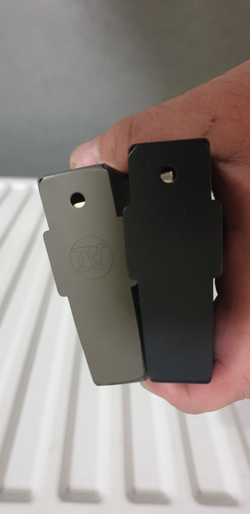

left is my AX mag that came with my rifle and right is an AW mag i picked up 2nd hand to work with it. Every other genuine AI mag I have ever seen has the AI logo stamped on the bottom. Did another company also make AW mags aftermarket? Cheers
Not sure.
I recently bought a batch of AW magazines from Mile High Shooting, and they were all stamped.
Reactions: PrecisionRifleGuy

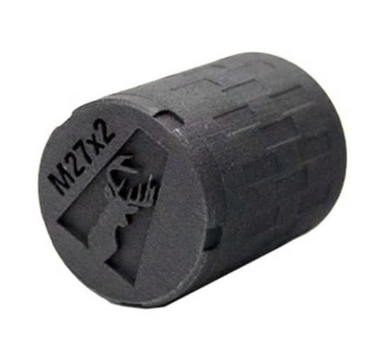

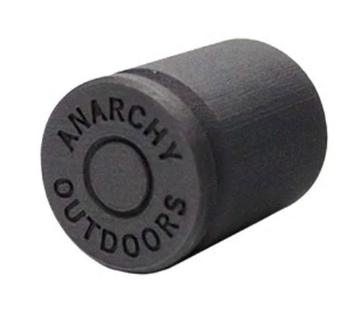

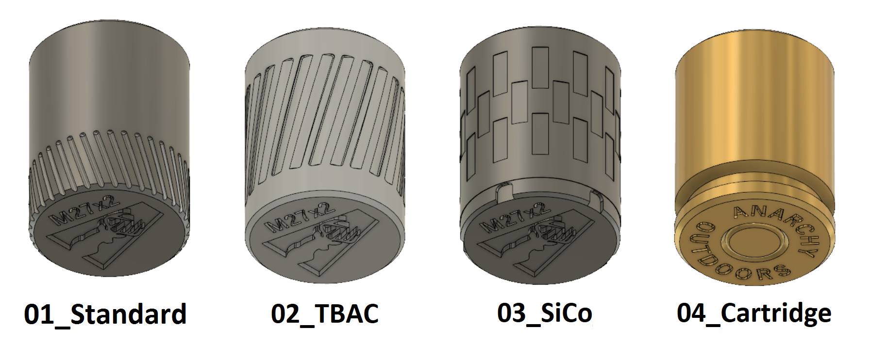

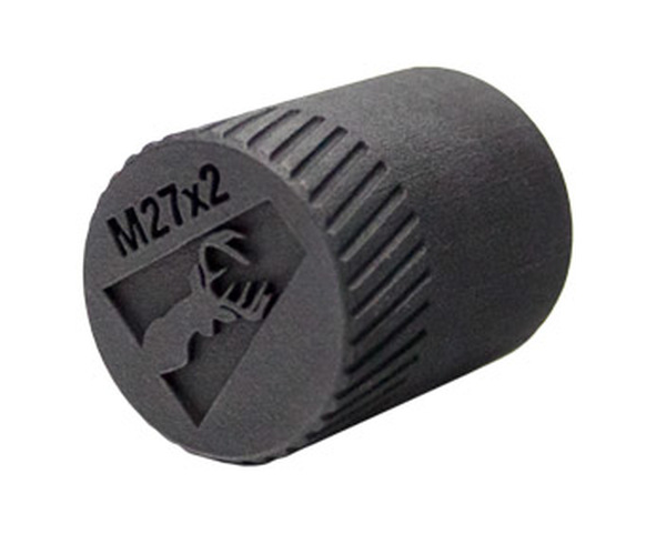

If anyone is looking for some AI barrel tenon thread protectors that are different than the rest, I designed some cool new ones for Anarchy Outdoors available now HERE. There are currently four versions, with pretty much endless possibilities for more. These are for the short action tenon M27x2 (AE/AW/AT), with a magnum tenon M30x2 (AXMC, AX338) in the works. All are 3D printed nylon, which is tough and durable, and allows the detailed designs not easily done with machined delrin like the other ones on the market. Let me know what you think!
Sam

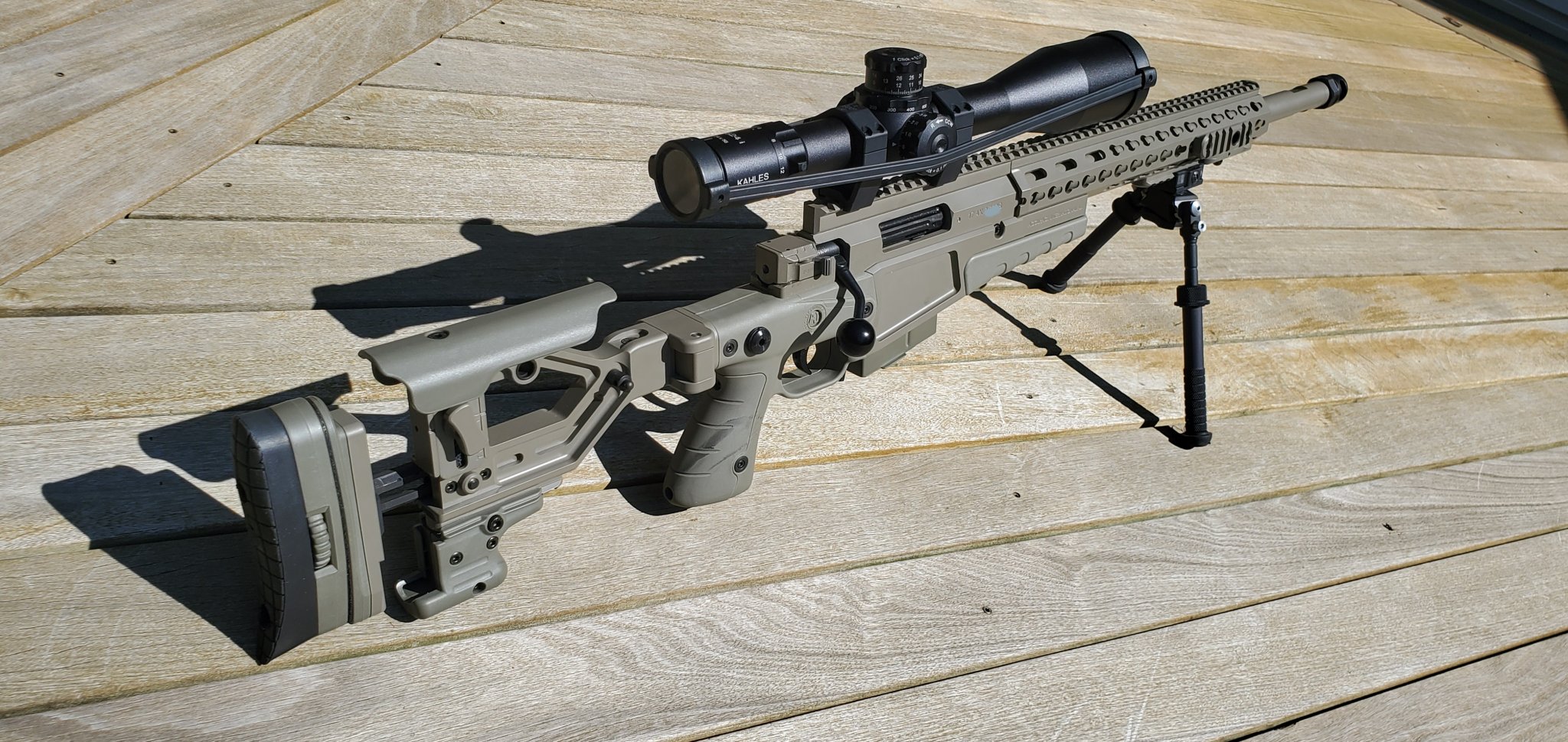

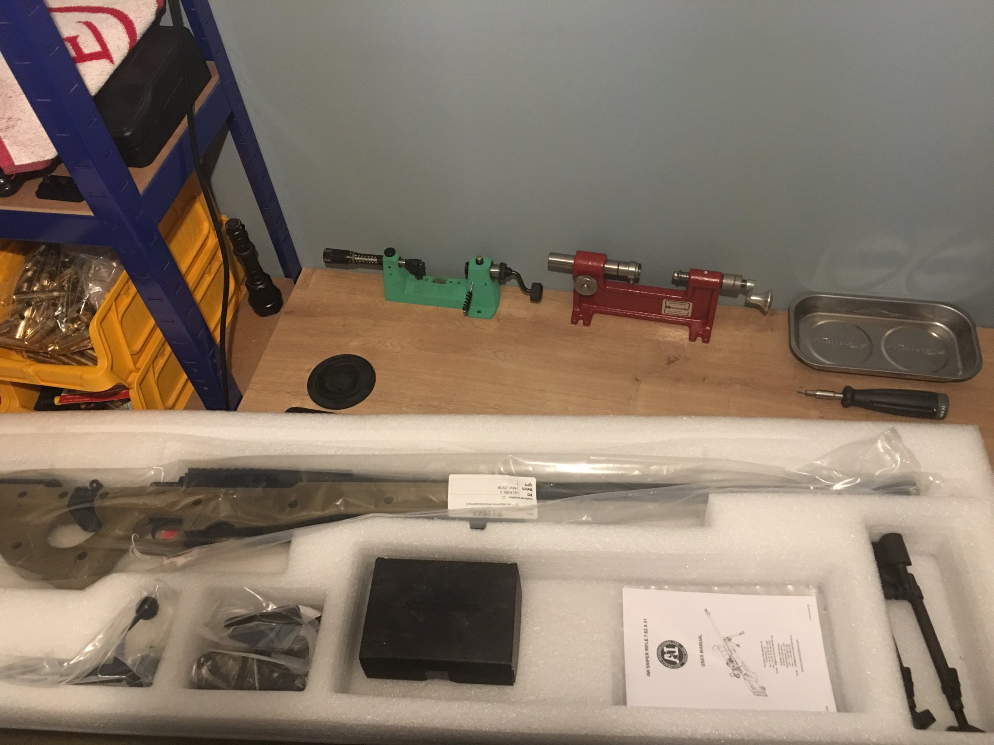

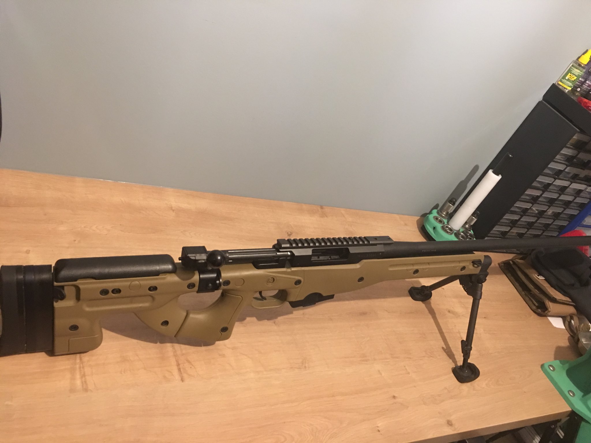

I joined the club this morning after a long week of waiting, I'm impressed! After having a few AX and AT chassis for rem 700, I thought the real deal would be slicker. I went with the Elite Sand, be because that is how i live my life, elite. I am the fastest person in my house, my mom's favorite child, and I once knew a Navy SEAL. But mostly got this color because it was a very good deal and the ability to change barrels is slick! Supposedly this was only used to break in the barrel (308).
It also seems there is no first stage at this time in the trigger pull, so the I'll have to look into that until I pony up for the comp trigger. Thanks to @samb300 for letting me try yours for a shot at the last match! Your accessories will soon follow.
