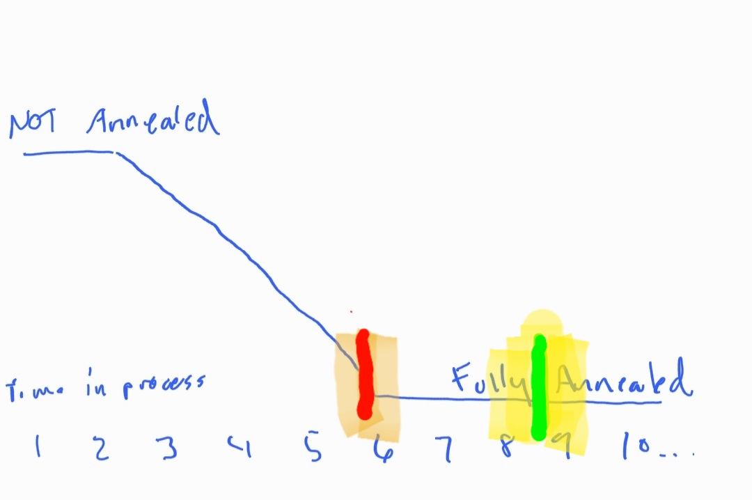

People are aiming for the perfect number which is the minimum amount of time a case is in a particular process and still reaches full anneal or a consistant % of anneal. But people actually have no idea what full anneal is or what % they are achieving.
Why not know for sure and go 100% the only way to be certain is to "over anneal" which you cant technically do.
Pardon my chicken scratch.
Instead of aiming for 6, why not just go straight to 9?
Yes, your thoughts agree with mine however, although I agree with your logic, I'm not 100% prepared to conclude that 100% anneal is absolutely the way to go just yet.
My testing to date is of 9 anneal /reload cycles of Winchester 308, 243, 223 brass at ADI book max loads with 40, 55 87 110, 130, 135, 168 grain projectiles at ADI book max loads. So far, I've had not one adverse effect accept for greater than normal neck or, case length growth.
A very curious effect is that, I have not had to FLS any of the 308 cases for the last 5 reload/anneal cycles. There has been NO measurable base to datum growth whatsoever. This is quite baffling to me as I've never experienced not having to FLS more than 2 reload cycles before having to FLS before I started annealing to 100% recrystallization. I've been reloading 243 & 308 for some 20 years & never been able to neck size only, more than 2 cycles before the bolt was obviously jamming the case.
In reference to your rather informative little drawing, yes, you are right on the money with your logic. If absolute consistency is what you are chasing, 100% recrystallization is the only alternative, at least to the average guy with normal equipment.
