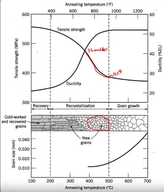

Ive always defaulted to these graphs that seem to point to different degrees of anneal that can be performed.
Sure, it can be a binary annealed-vs-not depending on if you did or did not do the process.
Or maybe if you think of it not being annealed unless you hit the point where the curve flattens out and consider anything less than that as unannealed.
But it can also have a wide range of outcomes depending on how hot you get it for how long.
I feel that dotted line is the sweet spot that we should aim for, heat it until new grains are complete but before they start to grow large.
750 on the case neck and shoulder keeping you in the median zone means that the neck which always turns tempilaq first and goes a smidge longer has probably hit that upper limit around 900 before grain growth phase starts while the lower slower shoulder is hitting the lower limit on new grains from coldworked at about 750.
But thats just how I rationalize my hair brained scheme of understanding annealing.
Oh, you can definitely make the brass all sorts of things with heat, but annealed it is not until it flatlines. I do 550°c for 7 seconds.
These graphs don't show the times at specific temps. Much of the info on the graphs is applicable in hours only & has no practical relevance to us.
Brass likes to be at a certain hardness for optimal accuracy. We achieve that hardness by annealing it. If you overdo it the brass is too soft and does not produce good accuracy. So you can over anneal brass and ruin it.
I don't know of anyone who has actually tested that because nobody that I'm aware of has brass as soft as my cases. Before I tried 100% recrystallization, I know of nobody else who thought to test it because everybody believed the brass would be ruined or" over annealed".
Going by the graphs & info I have, 750F for under 10 seconds has very nearly zero effect so, I don't know where you're getting your information but, I have downloaded every study conducted on the subject that I can find & no clinical studies have been conducted on the difference between soft or hard cases on the effects of accuracy or repeatability.
The belief that a few seconds longer at 750F or lower has any measurable change in the crystalline structure of brass is totally & demonstrably false.
The hard facts have been published for all to see if they want to know the facts.
I don't know why you persist with these fables.
He’s pulling it out of his ass, because he doesn’t know what annealing is or does, and thinks the actual definition is a redefinition.

Most of what you’re claiming here is wrong. Look at the charts in post 301 for example. Claiming there is no effect at 750* or anything below technically annealed is horse crap. There is effect, with solid metallurgical data about it, and that middle zone is what most people historically are trying to achieve, NOT the technical definition of “annealed”. The effect on the brass is gradual as temperature climbs, and is not just a yes or no thing as you claim.
“Annealing” or whatever you want to call it to that middle zone around 750-ish in the plots does prolong brass life, which is the primary reason most of us do it.
You also don’t temper non ferrous metals.
To achieve different hardnesses you cold work them.
Then if you need a softer hardness, you anneal them and then cold work it back up to the desired hardness.

Direct quote from AMP “ Our target annealed neck hardness is 98 HV.”
“AMP focuses on the end result – neck and shoulder hardness – rather than temperature.”
From the data published by AMP & elsewhere.
Lapua, Norma, & Hornady supply brass with necks in the 100-110 HV range and primer pockets in the 200HV range.
AMP Appendix 1 Metlab report
“for cartridge brass full hard is typically 175-185HV and fully annealed cartridge brass is typically 65HV. Other publications also describe soft, 1⁄4 hard, 1⁄2 hard and spring hard etc.”
The AMP is not fully annealing the case necks.

ASTM is the Gold std. (American Society for Testing & Materials) This is the std. used by D.O.D.
5. Classification of Tempers
5.1 Annealed Tempers, O—Tempers produced by annealing to meet mechanical property requirements.
5.2 Annealed Tempers, OS—Tempers produced by anneal- ing to meet standard or special grain size requirements.
The above taken from here.
Literally the std for copper alloys.
5.1 = Vickers hardness spec
5.2 = Recrystallization grain structure spec

Again, you’re quoting “temper designations.”
Tempering is a process used on ferrous metals. It’s also air cooled. That’s not the process used on aluminum.
And no, the proper terminology for amp is annealed. Not partially annealed, not under annealed, not tempered…….annealed. The brass recrystallized.
If your salt bath, flame, electric, or even a hair dryer method achieves recrystallization, it’s annealed. If it doesn’t, it’s not. It’s that simple.
If your necks get soft enough they are ruined, that means you started melting the zinc. That means it’s not annealed.
You’re getting a lot of stuff confused.
“Annealed tempers” doesn’t mean it was “tempered.”

Except that none of the data posted here or elsewhere supports your claims. Ignoring the reality of how most people use heat to PARTIALLY reduce the hardness of cartridge brass, but not dead soft, and refer to that as annealing, is just asinine. You’re either being so pedantic that it’s just stupid, or you’re flat out wrong. Which is it?
Wrong. The AMP gives a full anneal
According to who?
Are you referring to the fact that an AMP machine can do that? Or claiming that’s what they always do? Or what, and based on who’s data? Certainly not AMP’s.
If you pedantic geniuses are right, that annealing is only one thing, dead soft, and there is no in between, then there’s no reason to buy an AMP or any other annealer; just heat with a torch till it glows and call it done. That’d be fully annealed after all, and apparently your “ideal” condition.
Of course sooner or later you might figure out that there are situations where dead soft brass doesn’t work well. Something about semi autos, bullet setback, runout, that sort of thing.
You can prove that your fully annealed brass works well in some conditions. I wouldn’t even argue with that, and the idea that fully annealed is most consistent is right. No issues so far. But once you encounter conditions where that doesn’t hold a bullet adequately, it’s hard to claim that fully annealed is always best. It’s just not.
