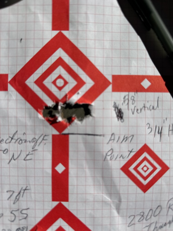

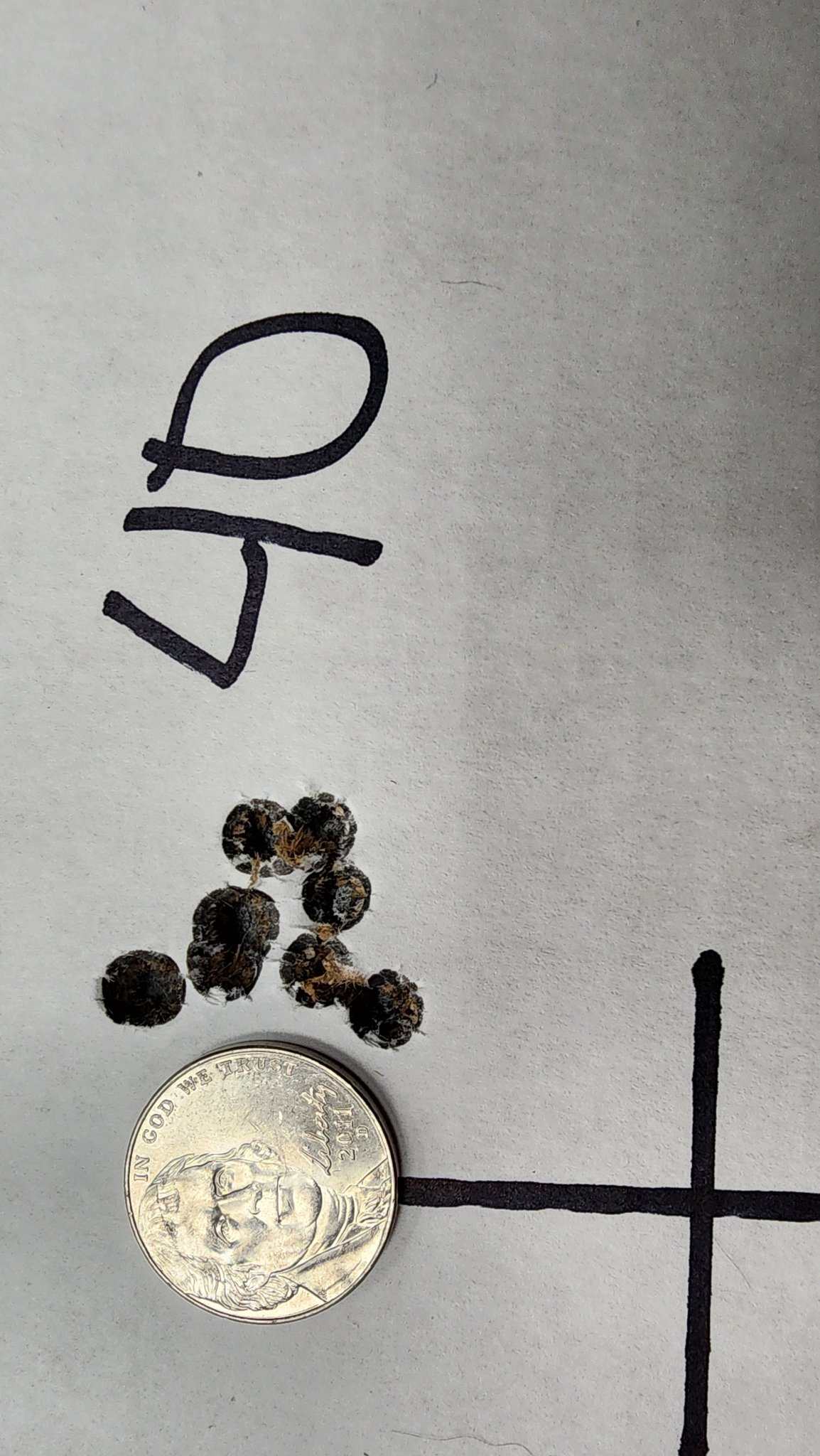

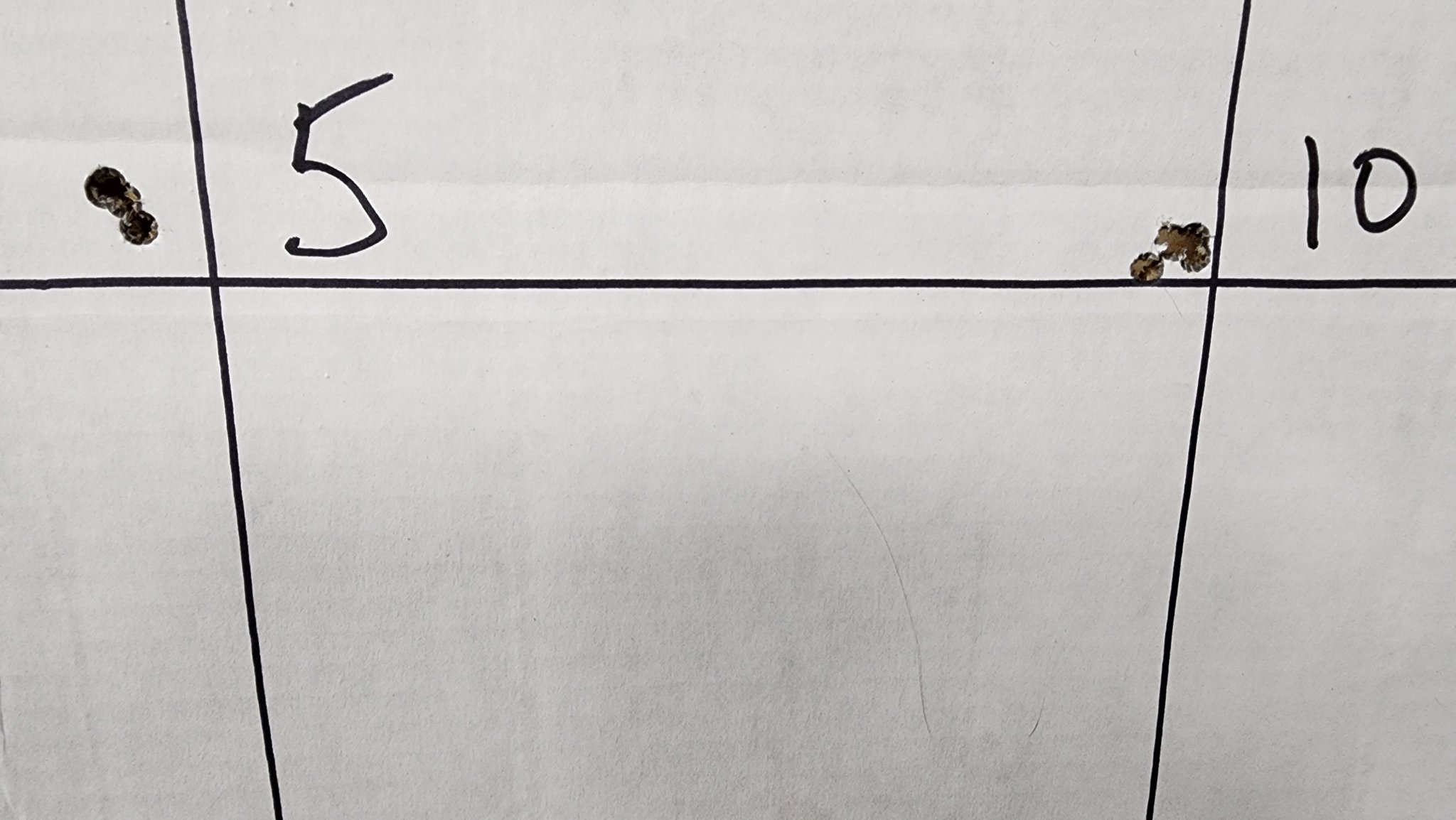

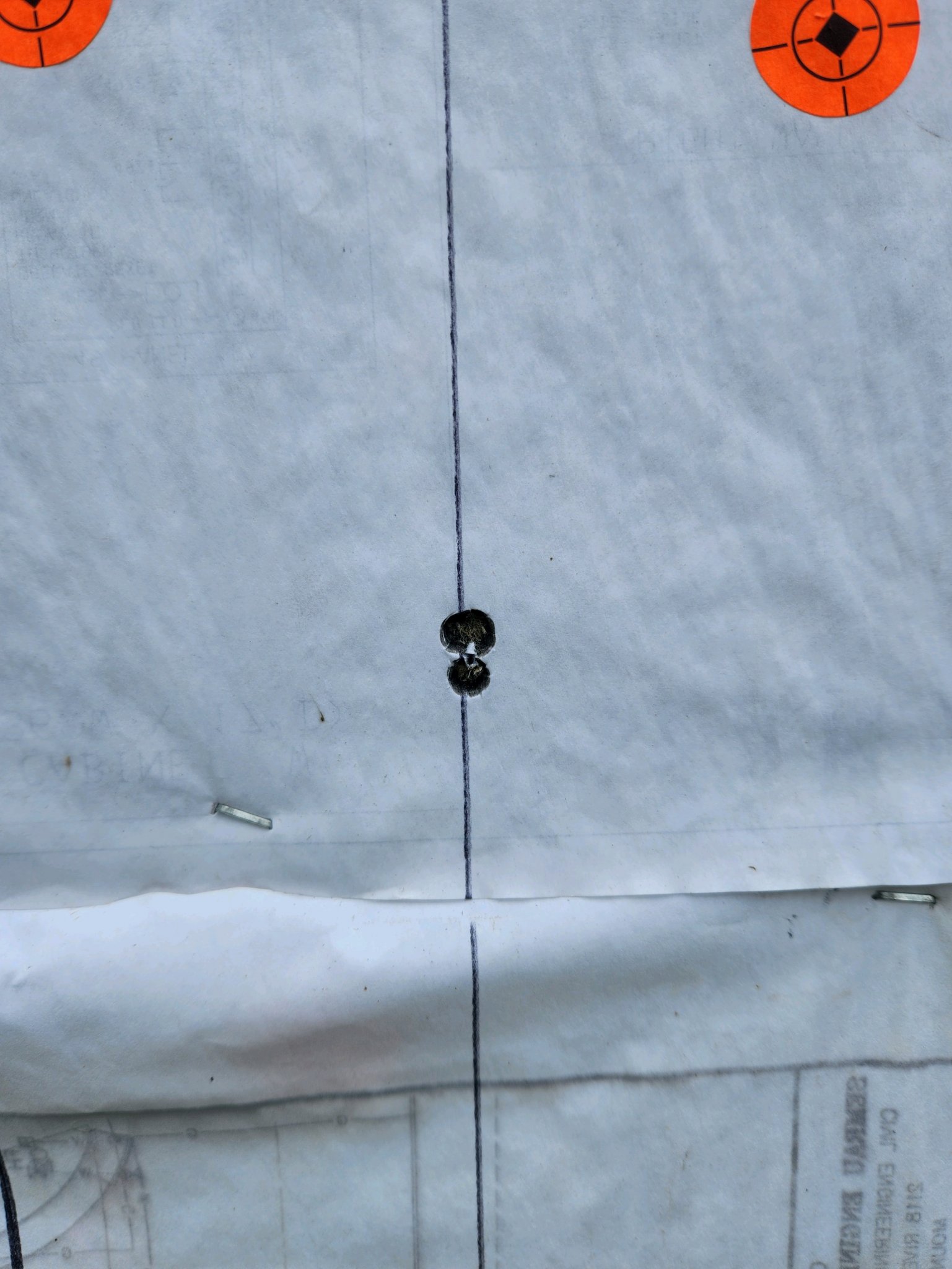

John is advocating super rigid which is great meaning any bullet shoots same poi same tune at one hundred yards and does not go out of tune by reducing if not eliminating the negative or downward bending of the barrel. The only reason I am not using his barrels is I need lots of bending for positive compensation and am tuned for only one bullet at any velocity..so I am doing it from a different angle. Both ways can shoot well at all distances as evidenced by Chris Schmitt's world record and with a cold bore 3 for 3 at 2800+ Chris can keep his ES good so the rigid Barrel is parallel during all exit times with any bullet and any speed. Try going and shooting two or three different good quality bullets noting POI change there will most likely be a change which means your barrel is bending. Even with big velocity between bullets they should only drop a few thousands of an inch , If it is more than that than your barrel is bending and if it is you better at least control it.

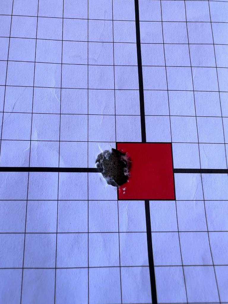

5 shots each group.
6xc, 1/2moa dot holding corners
View attachment 8312637View attachment 8312638

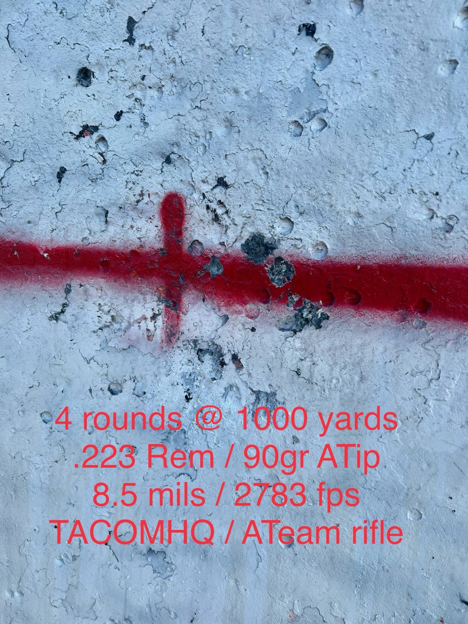

4 shots 223 - 1000yds, 4 shots .416 (current ELR Cold Bore record) , 5 shots 7mm

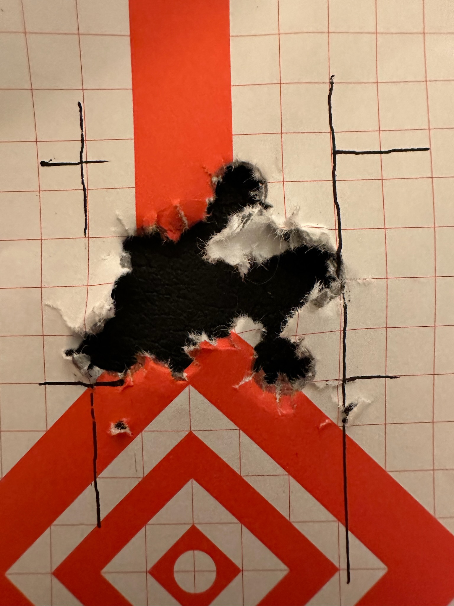

Rounds 21-30
300 Norma, 208gr, 58deg, 34.7%RH, barrel could be picked up by hand at the end of the string... temp 110deg. 18min for 30rounds. Tubb Gun, Tangent Theta.

Rounds 21-30

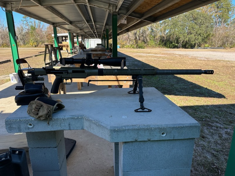

Rounds 31-40 6xc Tubb Gun, factory ammo (2007LOL), Vortex GenIII (like that scope), 48deg, 84deg barrel temp after 43 rounds, 20min shoot time, bipod and rear bag. I know the gun can do better... RL26 6xc was shooting better right up till the scope went poof...(Not the Vortex...)
