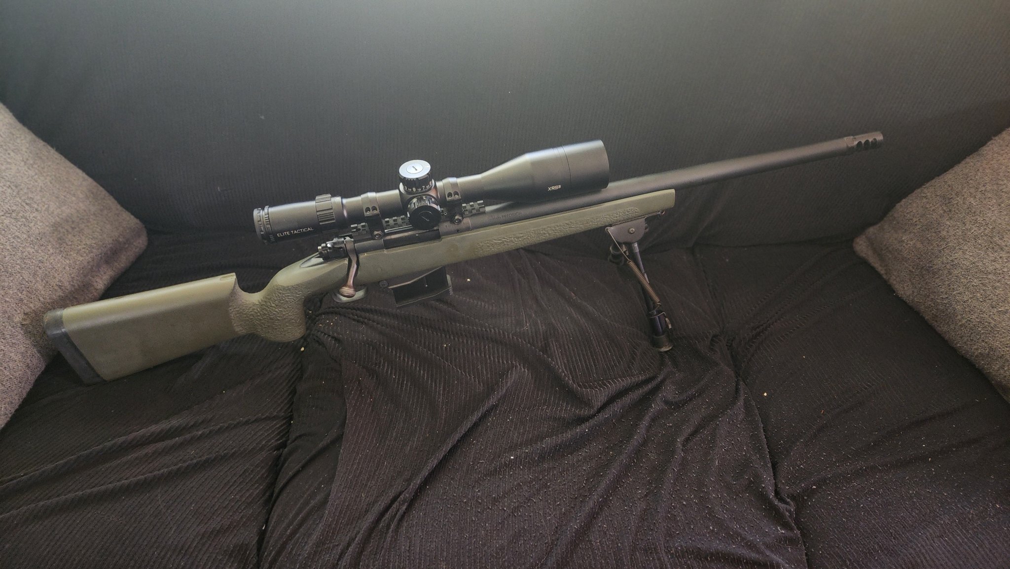

Would this stock interest you?

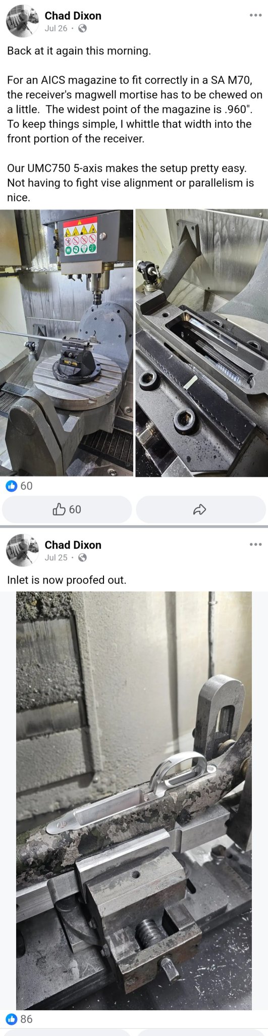

For those that have/had multiple mag systems, I have a stupid question. Is there any possible modifications that would allow an AICS to work in the TBM? Thanks.
Just run an PTG bottom metal and use MDT AI mags. You don't have to open up the action if you use MDT mags. They made them a bit slimmer to work with m70 rifles. I'm talking about the half polymer half metal with window.

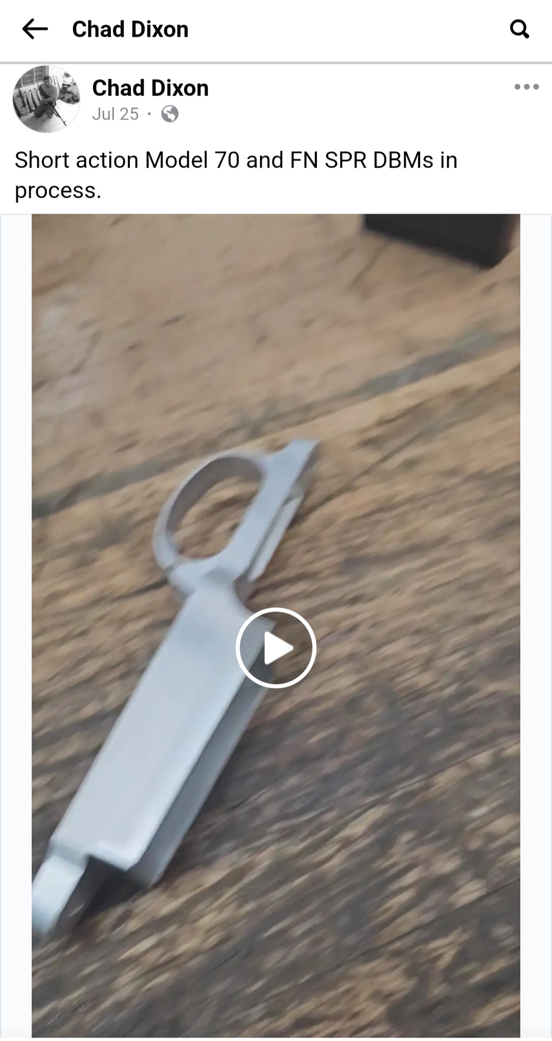

I'm pretty sure LRI is also one of the few places that'll bush your bolt face too. Makes it a one-stop shop for a barrel/receiver/bolt job.
Probably not enough of us to keep him busy off of just that, but he'll do quite a bit of business.
It's a good thing he's not solely relying on us m70 spr guys. He does plenty good without us. So anything he gets out of this is just additional. Win win for both sides.

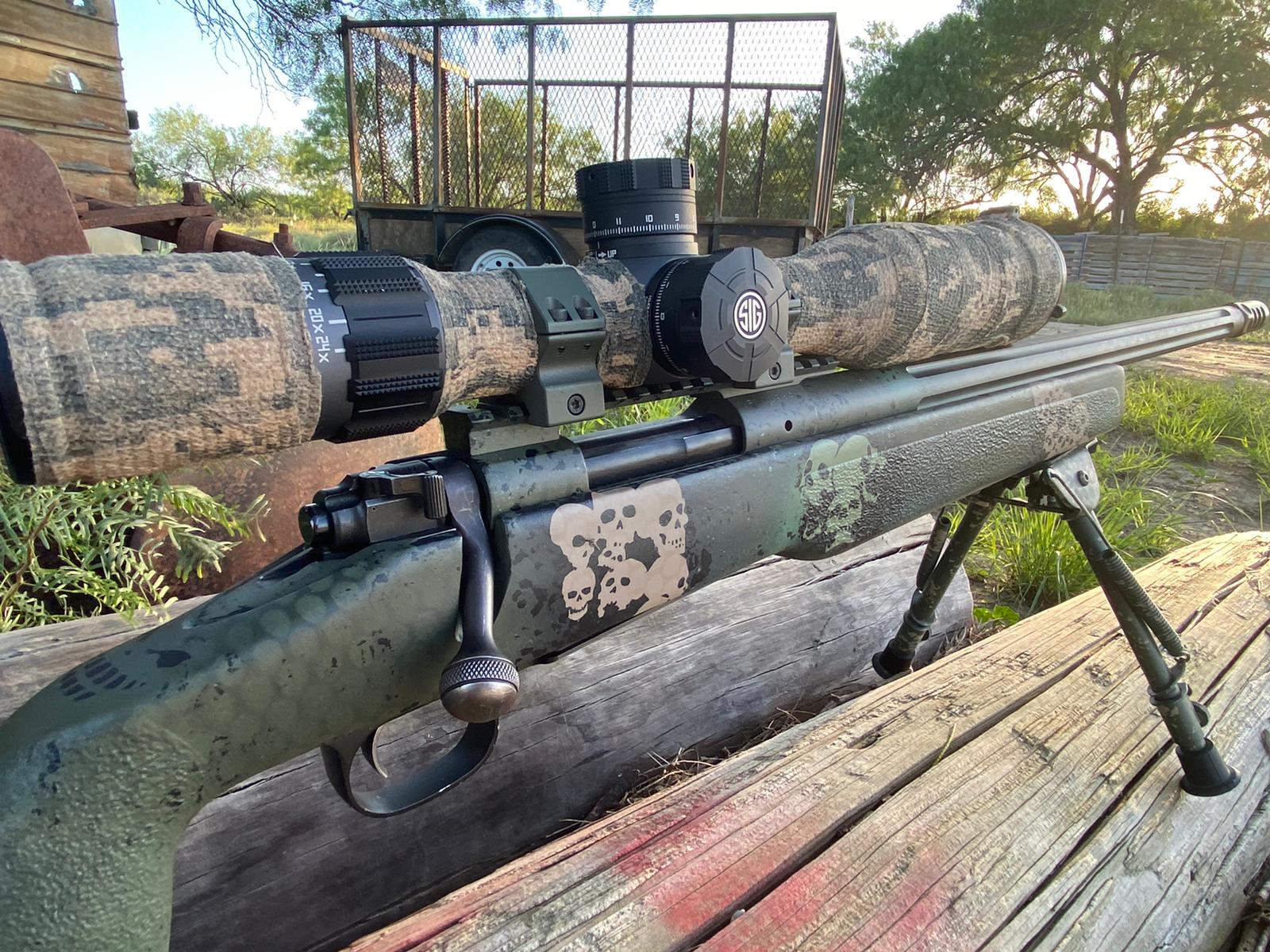

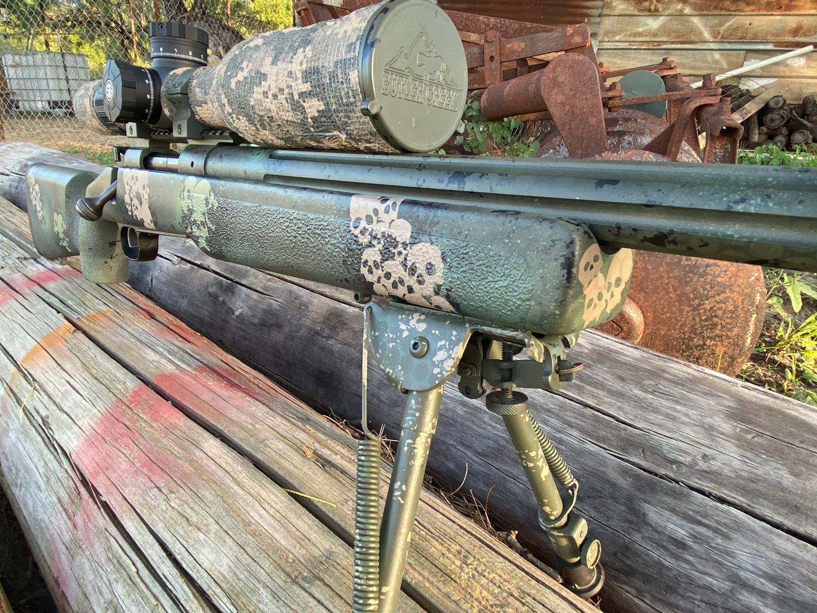

Full build. Blueprint. Tbm bdm. Bartlien. Pillar bedding in the original stock. Everything. I looked for a CDI for months. Got a screaming deal on the tbm. And GAP did a hell of a job on it. It's a .3MOA gun with 175 smk.

Have you posted it here? Let's see what she looks like...

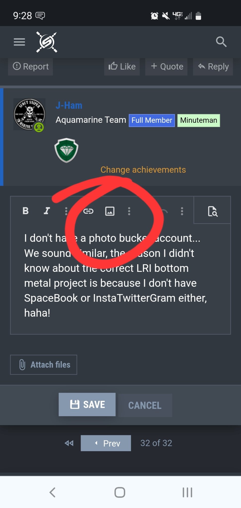

I don't have a photo bucket account... We sound similar, the reason I didn't know about the correct LRI bottom metal project is because I don't have SpaceBook or InstaTwitterGram either, haha!
I just click on this button, then add whatever picture from my gallery. 🤷‍♂️
Use the little "attach files" button underneath the text box you're using on your computer or phone. When you click it you should go to your images on your phone or computer. Select the image and then "open". You can hover over the image to choose whether you want to upload a thumbnail or full size. Super easy.

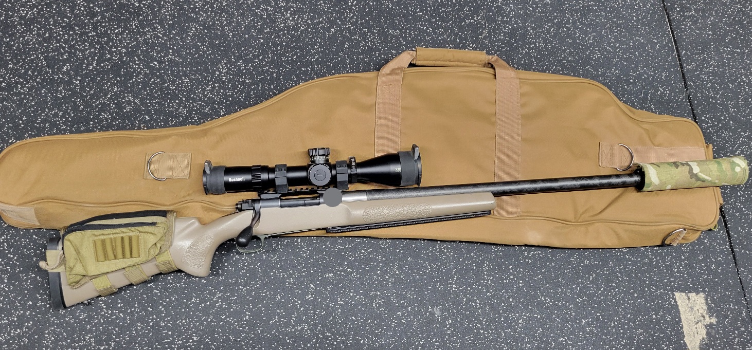

Sweet pics.
