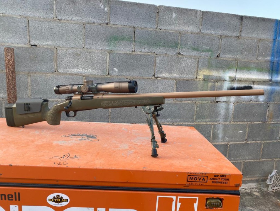

Are the FN SPR enthusiasts extinct?
Got this SPR recently. It came with a custom barrel which I believe the previous owner said was a rock creek. Work was done by precision barrel works out of Hempstead texas. Action face has been squared, magwell has been opened up.
Barrel is 25.5" long and has a very well blended muzzle break. The rifle came with a PTG bottom metal, FN TBM, and an fn flush mag bottom metal & mag. Previous owner also included a drag bag into the deal.
Can't wait to see how it's gonna turn out. I have no idea yet what glass it'll sport and what kinda paint job it'll get but if anyone knows anything about me, its that I like to give my rifles some wicked paint jobs.View attachment 8328619View attachment 8328620View attachment 8328621View attachment 8328622View attachment 8328623View attachment 8328624View attachment 8328625

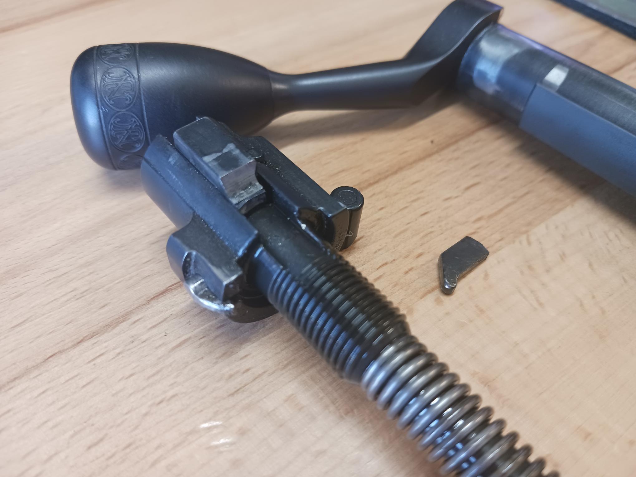

Just had my bolt break on my FN SPR A5M XP 308.
I live in Australia and we don't have an FN dealer. I've emailed FN to ask what the part is and am waiting for a reply, hopefully that nets a result.
I got told to check with Winchester as it's a pre-64 action and Winchester has gone back to making the pre-64s but when I asked Winchester they referred me to FN.
Does anyone know where I can get a replacement firing pin for the SPR and/or does anyone know the appropriate alternate part from Winchester?
Thanks

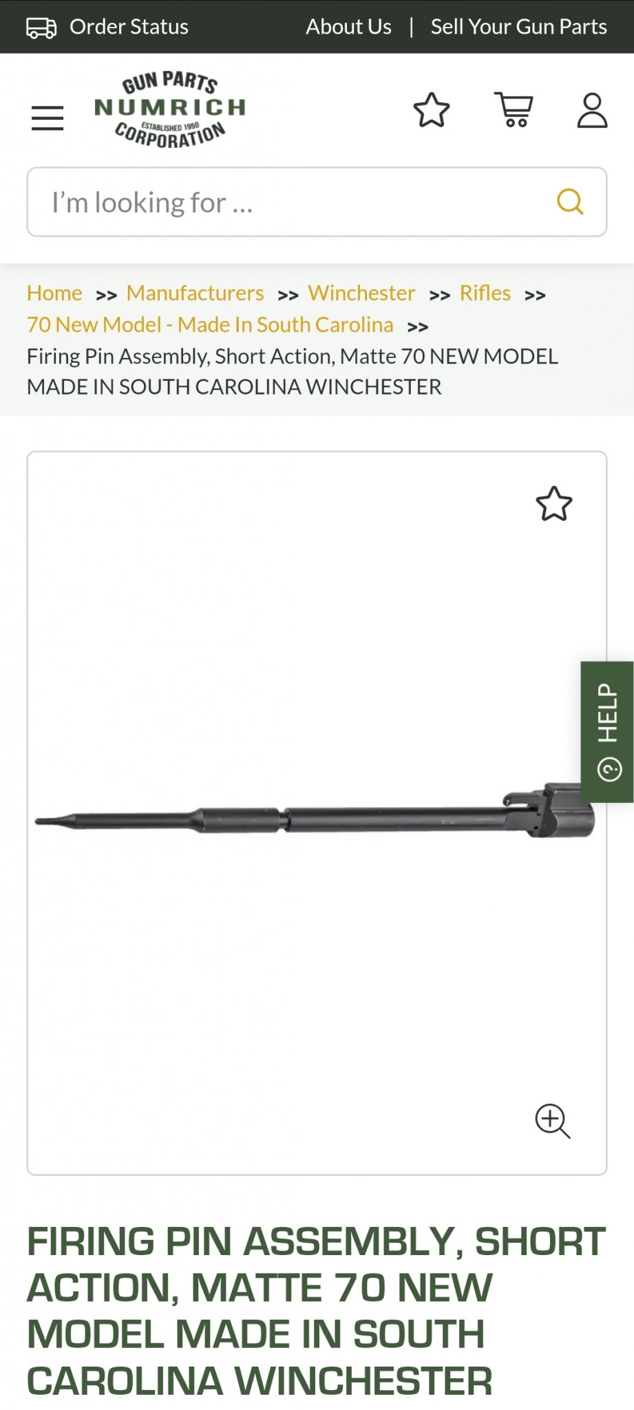

Most likely it is this, part number 14
Reactions: Zigjib
Thanks for the reply mate, but the link doesn't work - maybe because i'm in Aus.
The SPR uses a short magnum action doesn't it? is that the same size as a standard 308 action?
Thanks
CarsoView attachment 8332084
Midwest Gun works sold lots of FN parts for the SPR. I would send them an email or call and i bet they can point you in right direction if not have the part you need. Hope the link works
Reactions: Zigjib
Yeah bud, link works, i'll hit them up.
Thanks!

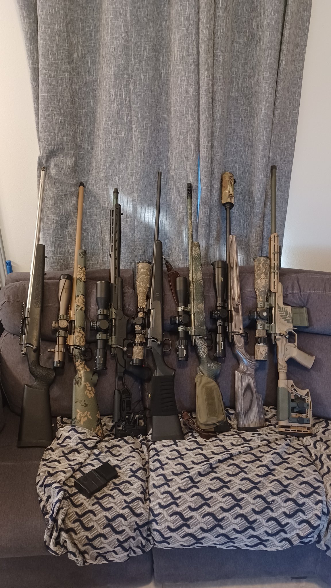

Decided to do a Lil family photoshoot...
Left to right:
Fn spr
Rock creek 25.5" .308win 11.25 twist
Win70 heavy varmint barrel
Factory barrel 26" .223rem 9 twist
Bushnell lrts 3-12
Fn spr w/ MDT chassis
Shilen select match 22.5" .308win 10 twist
Minox zp5 3-15
Win70 (run of the mill hunting rifle)
.270
Bushnell lrhs 4.5-18
Howa mini w/ B&C Stock
Factory 20" barrel 6.5 grendel
Sig sauer 4-16
Howa mini w/ boyds pro varmint
Factory 20" cut down to 18" 6.5 grendel
Bushnell lrts 3-12
Howa 1500 HCR
Factory 24" barrel 6.5 CM
Sig sauer tango6 4-24

The Winchester part number you need is U352300980.

Seems like a weird thing to break! Has anyone known of this happening to other SPR's? This piece is shaped differently on various FN Model 70s from what I can see.
The portion that broke - is it only responsible for cocking the firing pin or does it also take the brunt of dry-firing? Just trying to think of what would cause that.
honestly mate, she's seen some work.
If it takes the whack from the dry fire then it would make sense that it broke. I have dry fired this gun millions of times.
Reactions: CrazyHands13
This part should not impact anything during firing or dry fire. The firing pin shoulder should act as the stop when dry firing. The part that broke here is the cam that interacts with the bolt body cam slot: cocks the firing pin/striker when the bolt is opened.
You can see the relationship if you install the striker into the bolt (out of the rifle) and rotate the striker (must press the bolt sleeve lock to rotate) into the fire position with the safety on fire. The firing pin protrusion that broke will fall into the cam slot in the bolt body and there should be plenty of clearance with the firing pin all the way forward. Rotating the striker shroud to recock the striker will demonstrate the caming action of cocking. With a broken cam, this will not work as there is nothing to interact with the cam slot.
The only way (I can logically see) the cam protrusion could impact something it is not supposed to is if the bolt handle is not complete down when the trigger is pulled. This will result in the cam protrusion hitting the cam slot as it moves forward. This force could break the cam in the manner your photo indicates. Not sure how many of this type of event it would take to break. It is also less likely that the rifle would fire if this is occurring because the striker will be robbed of energy as it forces the bolt to completely close via the cam slot aligning with the falling striker. Not saying it can't fire, just that it depends on how far the bolt handle is raised and how far the bolt is forced to turn, being forced by the striker and whether there is enough energy remaining to ignite the primer.
Hope this helps and good luck.
AG
AG
Thanks for the technical outlook. I have confirmed what you stated about the clearance in the cam slot of the bolt body and the little cocking piece cam, with the firing pin all the way forward, there is clearance.
