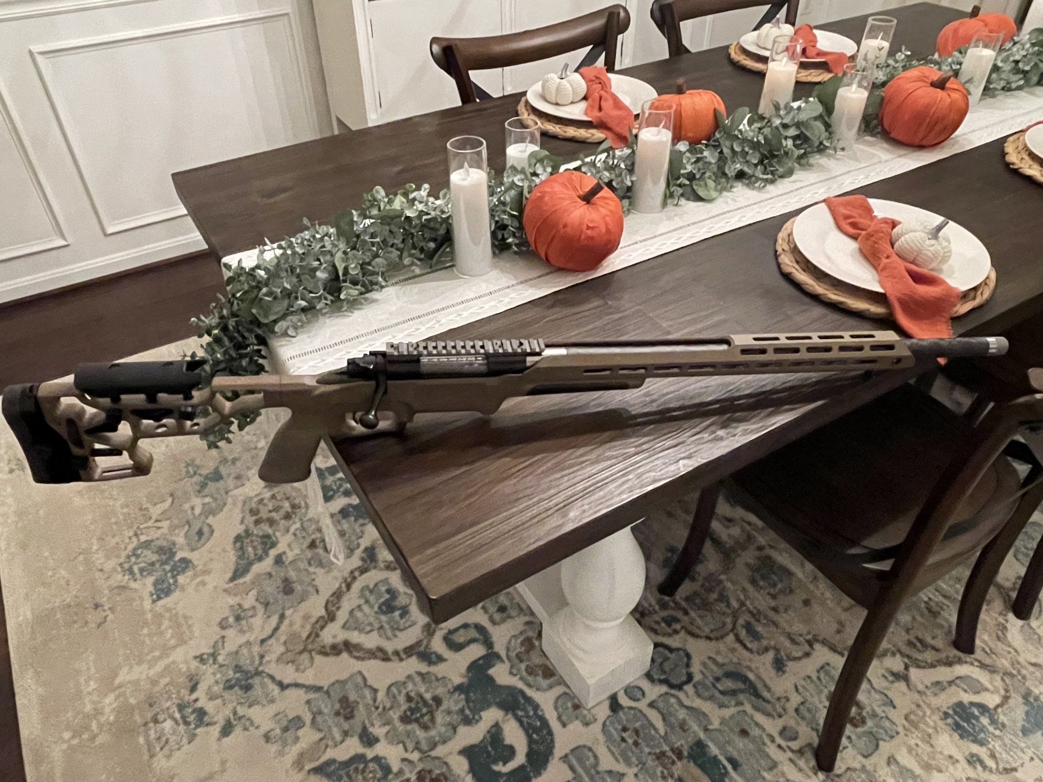

@stello1001 did you have to mill out the bottom of the receiver to feed from the AICS mags when using the chassis?
What a great piece of factory equipment they are!
Absolutely not. MDT made this chassis that bolts right up to the m70. If you run their MDT mag that has the window, you don't need to open up the action. They made the magazine slightly slimmer to be able to work with this action.
If you wanna run any other mag, you won't be able to unless you open up the action. So we do have options, many say the m70 actions don't have a lot of aftermarket support, and I agree. However, they have all they need.
The only thing I had to do to the mag was tweak the mag feed lips just a tad bit. Straight from the package, it would not feed at all. This is common with CRF actions but there is a solution. I bent in the feed Lips at the front of the mag only just a little, literally almost nothing. Tried feeding it again and it's been very consistent and reliable. Super fucking smooth.

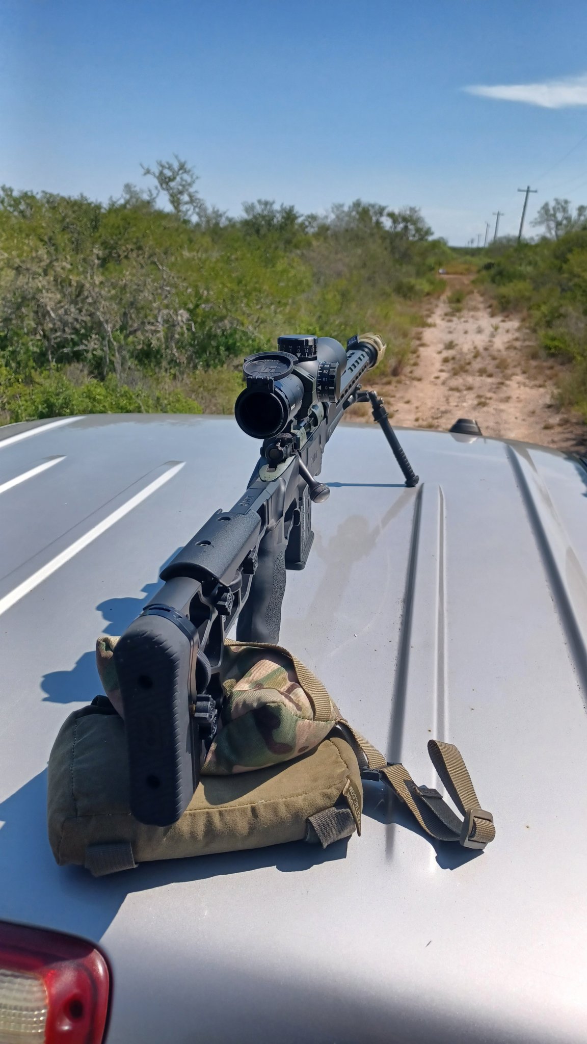

I've had this A5 since 2013. Love everything about it. Used it at a precision rifle course that Frank & Laura taught last week at the Mifflin County Sportsman Association range (1000yd @ a 17 degree angle. Was able to place rounds on a 12x12 square plate @ 1000yds. I'll never get rid of it, but a 6.5 is in my future haha!!

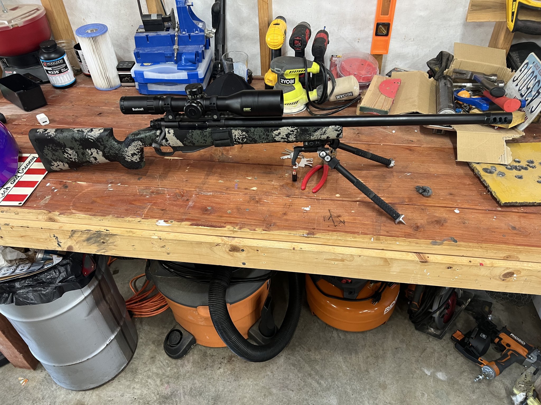

Late to the party and not a SPR exactly but it’s a Model 70 .308 controlled round feed made in Utah with all FN goodies. A Timney MOA trigger 1.5 lbs, a OPS Inc muzzle brake, 8-32x Nightforce Benchrest. It’s getting a the Schneider M40 barrel I bought 10yrs ago one of these days but it still shoots so well still. The match book group was shot at a little over 400yrds 420-430 in really crappy field conditions lots of wind gusts and shooting off a backpack. The cheese ball 3 shot at 200yrds was so tight I just stopped and grabbed it. I feel the gun is a pretty consistent 1/2-5/8 MOA gun with 44grs VV N540 with a 168gr Hornady match bullet, CCI large rifle match primer only with Lapua brass. Any other brass the groups open up to 3/4-1” I did all my proofing at 200yrds with 10-shot groups. I did shoot some single hole 100yrd 3 shot and semi-ragged 5 shot groups using H380 and Berger 150gr flat base but I was after a 600yrds F-class rig it’s kinda fun to chase around that short range benchrest stuff. When friends have had broken REM 700’s over the years it’s gone hunting and head shot a couple deer too. I can see why the pre-64 action is the dangerous game choice simple and rugged it always works.

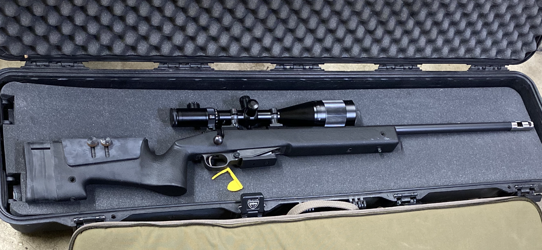

I have an SPR A5M XP. I replaced the factory fluted and chrome lined barrel with a 20” Proof CF Sendero to shave a little weight and added a APA Little Bastard brake. I’ve also added a Timney trigger because I didn’t want to modify the factory trigger in case I sold the rifle. Curiously, the rifle came with an out-of-spec picatinny scope rail. The rail had taper to the rear and the rear ring wouldn’t tighten on the rail without bottoming out. I tried 3 sets, Nightforce, Seekins, Badger. I replaced the rail with one made by Precision Armament and life was good. Other than having the world’s heaviest bottom metal (the proprietary detachable mag bottom metal is steel), everything runs very well and the rifle shoots superbly. I shot my first 2-day long range class with this rifle and was very impressed for a factory rifle.
I added a SKD Tactical Pig stock pack/cheek pad on top of the adjustable stock and it’s one of the most comfortable rifles to shoot that I own.
