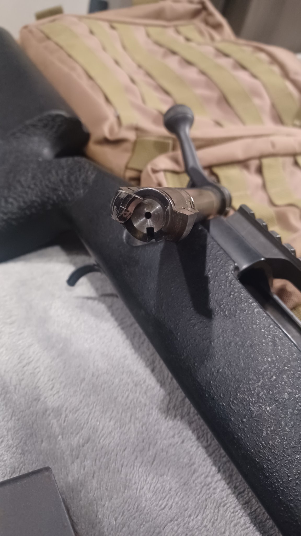

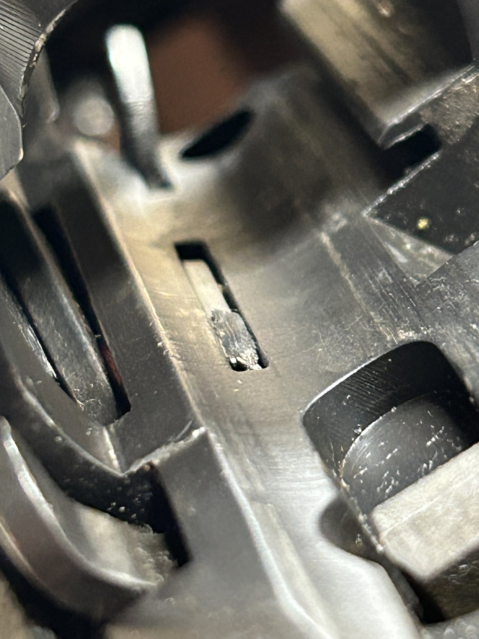

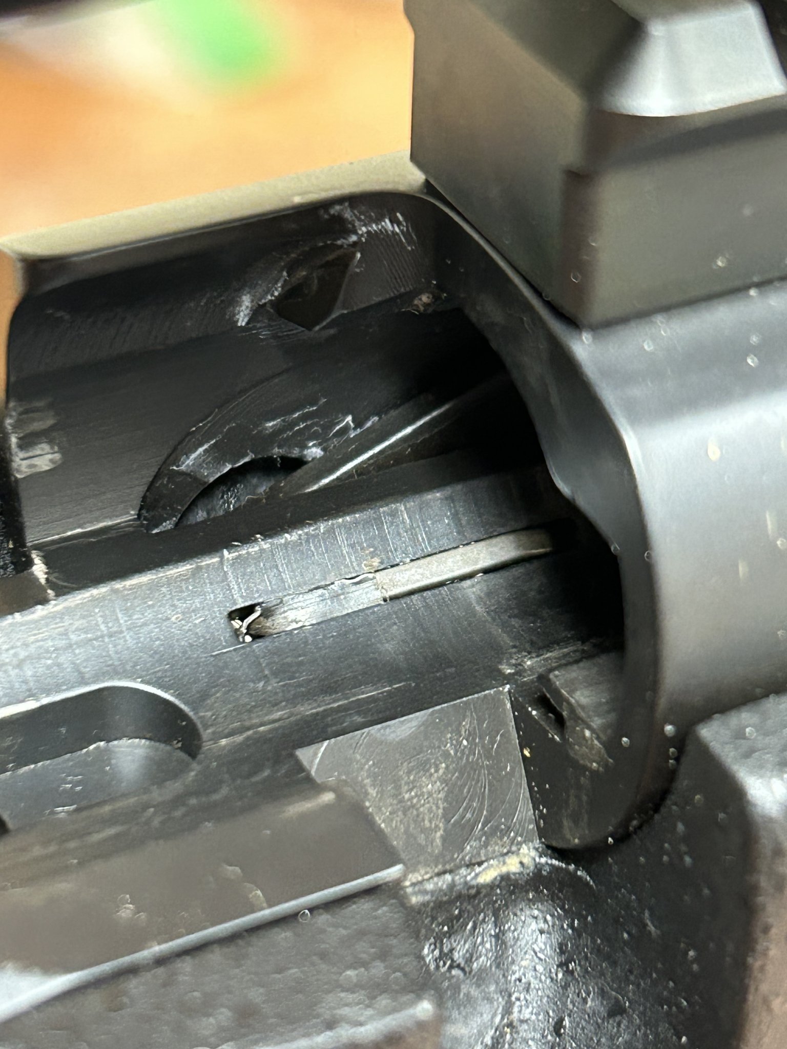

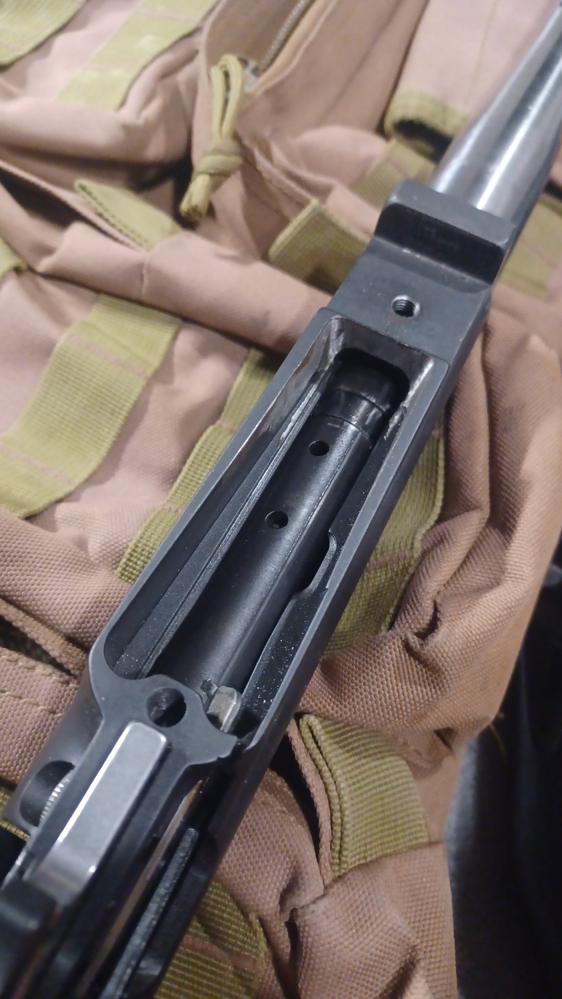

That is the rear of the ejector. It appears to be protruding into the bolt raceway, causing interference. It should stay below flush in this area.
AG
Just replied to your other response before reading this. First off, thank you for the help. I really appreciate it. Do you know what part of the ejector that is? It doesn’t look like the main blade
That is the back of the ejector, near where its pin is located. Behind this is the spring that powers it. If you look into the receiver and just behind the ejector where it is damaged, you should see the spring partially visible beneath and behind it.
I you pull the barreled action out of the stock you can see and appreciate how the trigger, ejector and bolt stop parts parts interact and how simple and robust they are.
As @diggler1833 stated in the other thread, taking the SPR apart is pretty easy and straight forward. Getting the ejector out requires removing the trigger and bolt stop, but that's one pin. You don't even need to take the nuts and adjustment screw loose from the trigger if you don't want to (which I don't recommend for this as it would require re-adjusting the trigger). The ejector is held by one role pin. All you need is the 5/32 hex to remover the action screws and the two punches to remove the trigger pin and ejector pin. Taking pictures along the way is a great idea and should ensure you get it back together, although it is really simple, which is one of its strengths (in my opinion).
I would pull the ejector and clean the top part up with a file or simply replace it.
Good luck.
AG
Reactions: diggler1833
Good luck.
AG
Thank you!! I will do that and post pictures I take during the process. I appreciate your help so much, none of my google searches could provide the info you did. But maybe I was searching the wrong stuff lol.

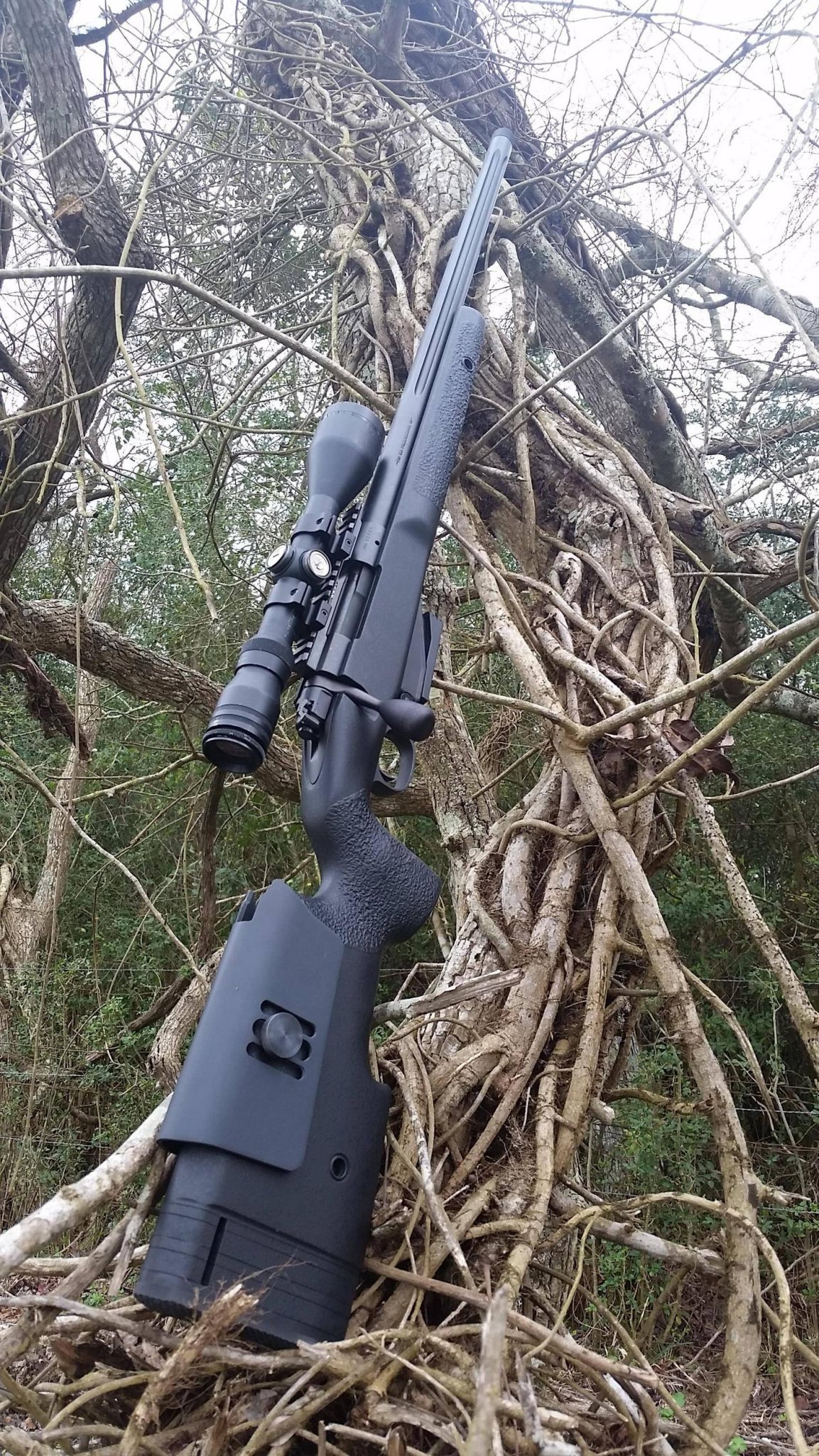

I've had this A5 since 2013. Love everything about it. Used it at a precision rifle course that Frank & Laura taught last week at the Mifflin County Sportsman Association range (1000yd @ a 17 degree angle. Was able to place rounds on a 12x12 square plate @ 1000yds. I'll never get rid of it, but a 6.5 is in my future haha!!

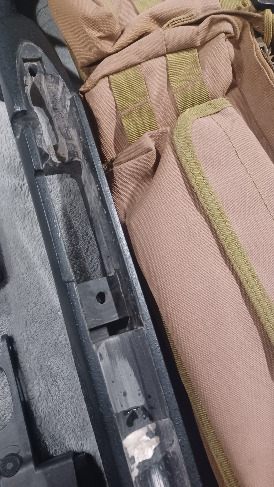

Does any one of you have the print with dimensions for cutting a model 70 in order to take AI mags? Or do you know who does?
If I just run ptg bottom metal alone it's not gonna work unless I also have the action cut out for it right?
I would check with chad from long rifles.
Not free but the work is excellent, reasonable and quick
The PTG DBM system works great.
If you can avoid buying directly from them and use one of their dealers.
Inletting is an easy task.
I just wish Jeff @ CDI was still with us.
He was an asset to our community.
Do you have a link or pics of a PTG? I ordered a ptg bottom metal for m70 once. After trying it out, it wasn't for AI mags so i probably ordered the wrong one.

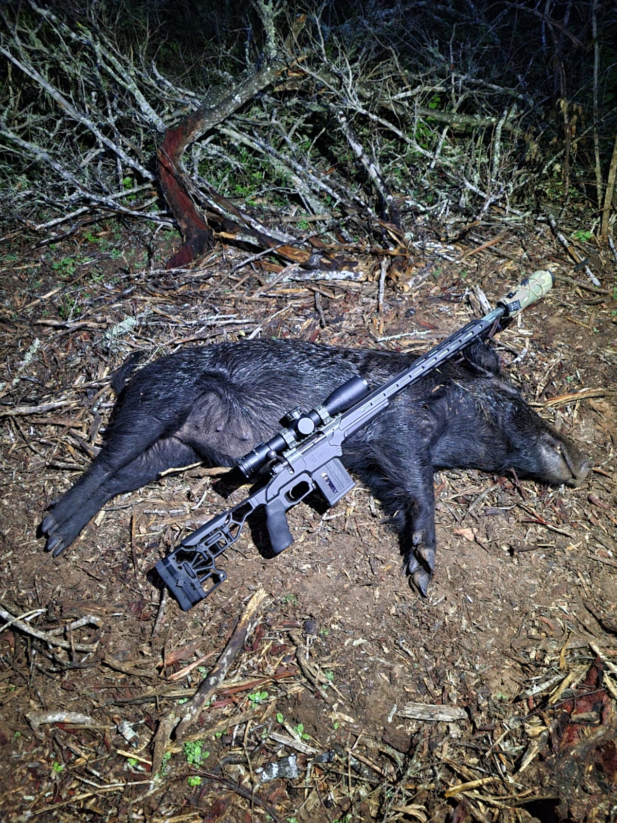

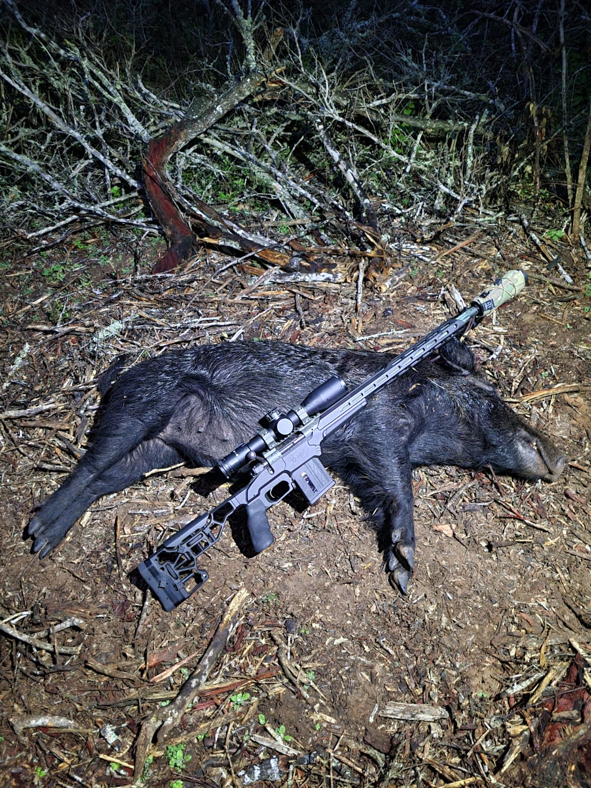

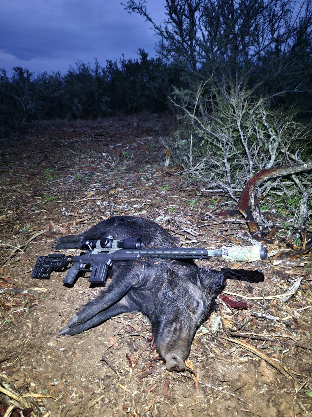

Got this piggy yesterday evening at about 130-ish yards with the SPR. Shot it head on as it never got broadside. Placed the crosshair right on its forehead and the rest you guys already know. She let out a few squeals and kicks before it was all over.
Used norma factory ammo with a 175 golden target.
Wierd that she squealed, but nice kill regardless man.
I've experienced cold bore shift with the suppressor on this rifle before. So I'm guessing it wasn't a direct hit to the brain. I thought the same thing and wondered why she squealed and kicked around vs just turning off like a light switch.
I looked for an entry hole but with all the thick hair and entry holes being tiny AF, I wasn't able to find the exact hit location.

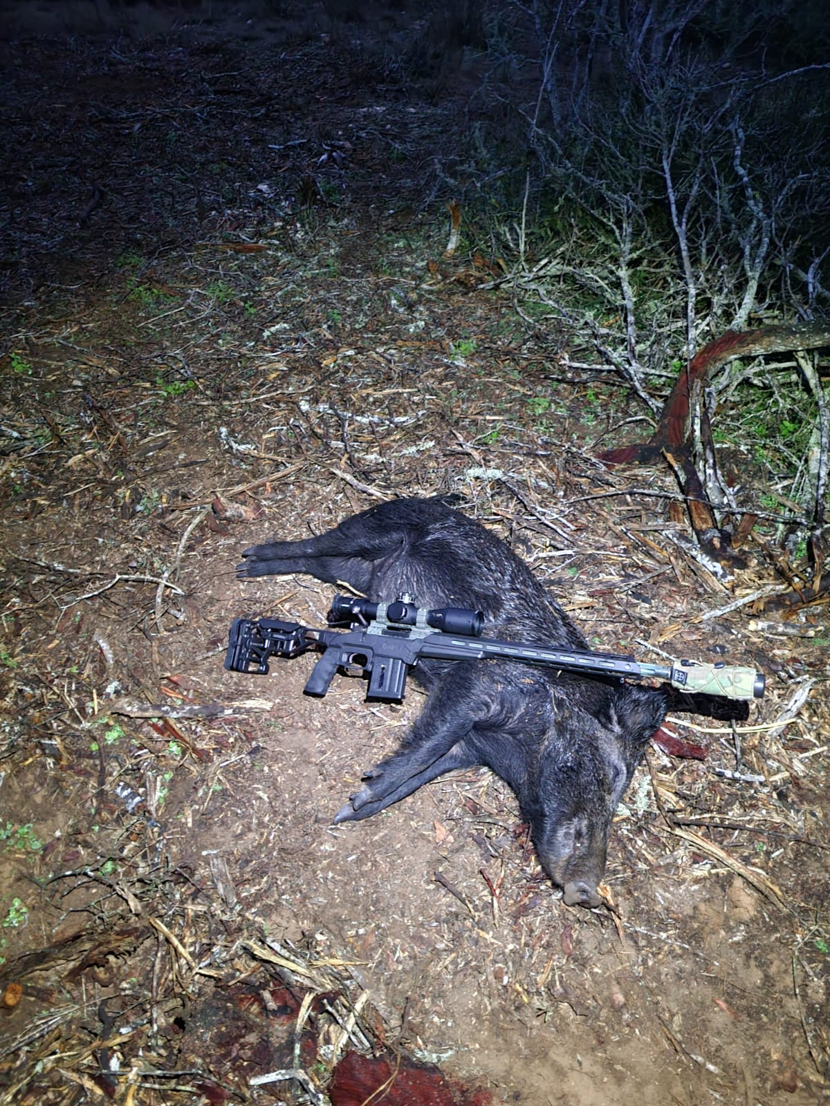

Used norma factory ammo with a 175 golden target.View attachment 8304839View attachment 8304840View attachment 8304841View attachment 8304842
It's the same one you sold me @Basher
I'm pretty sure it's my favorite rifle

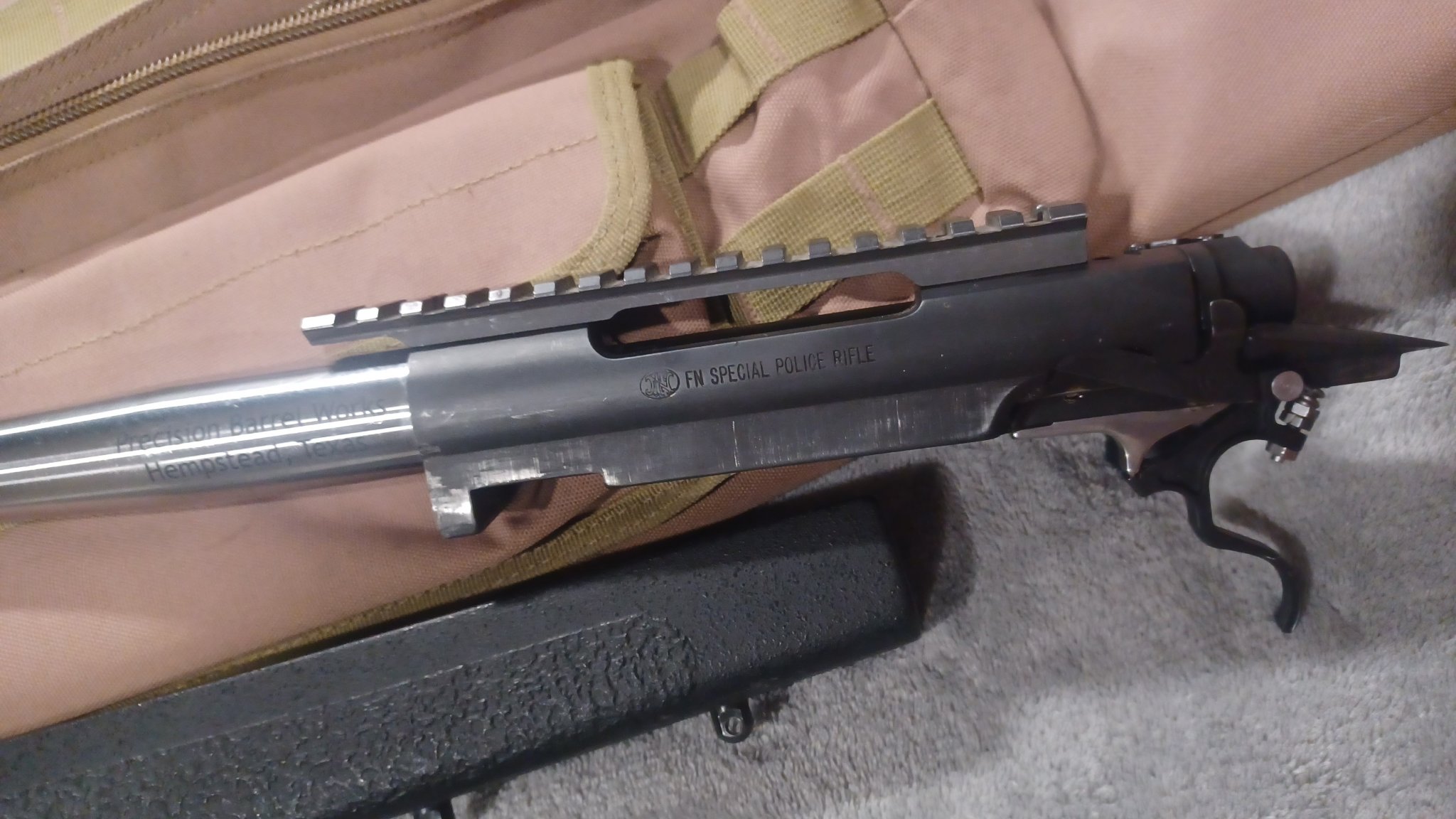

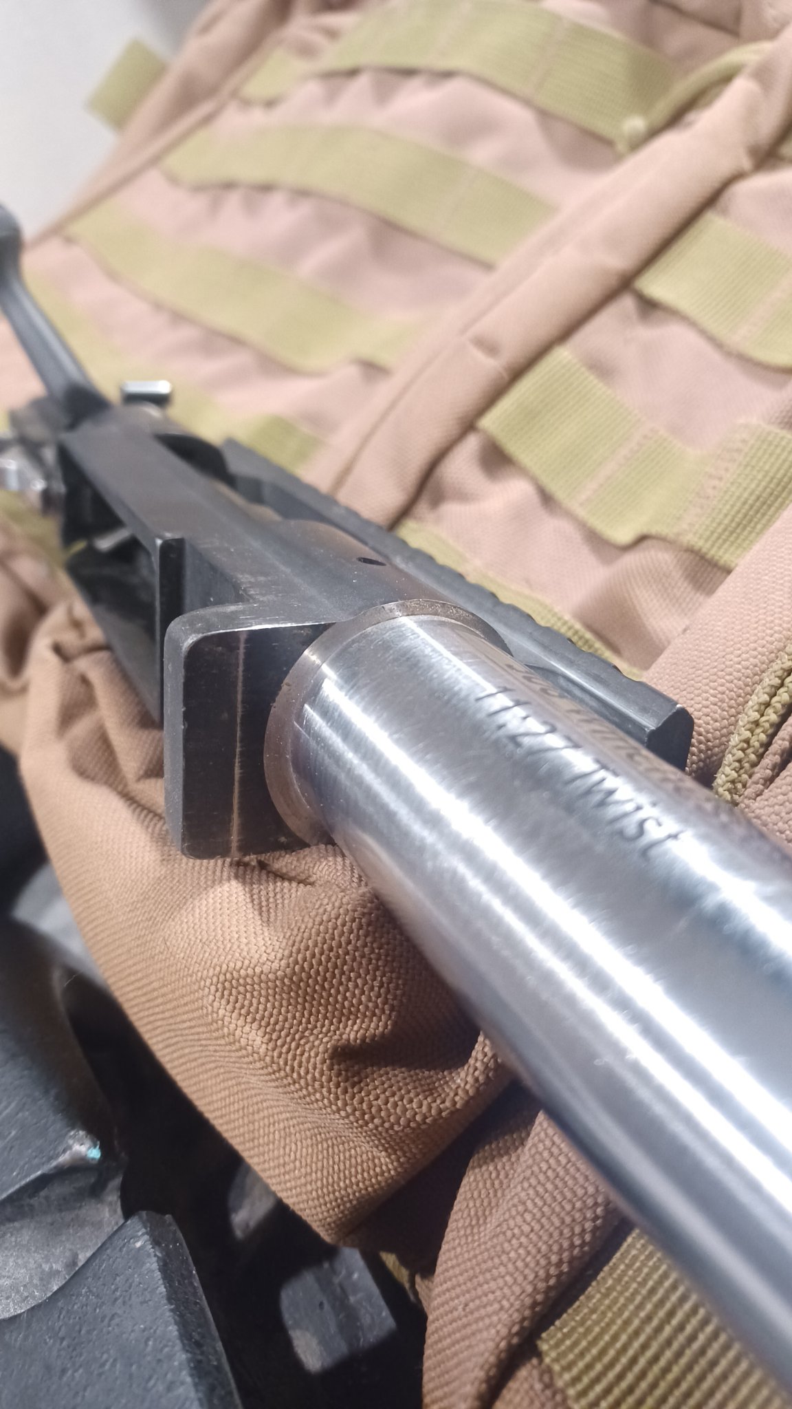

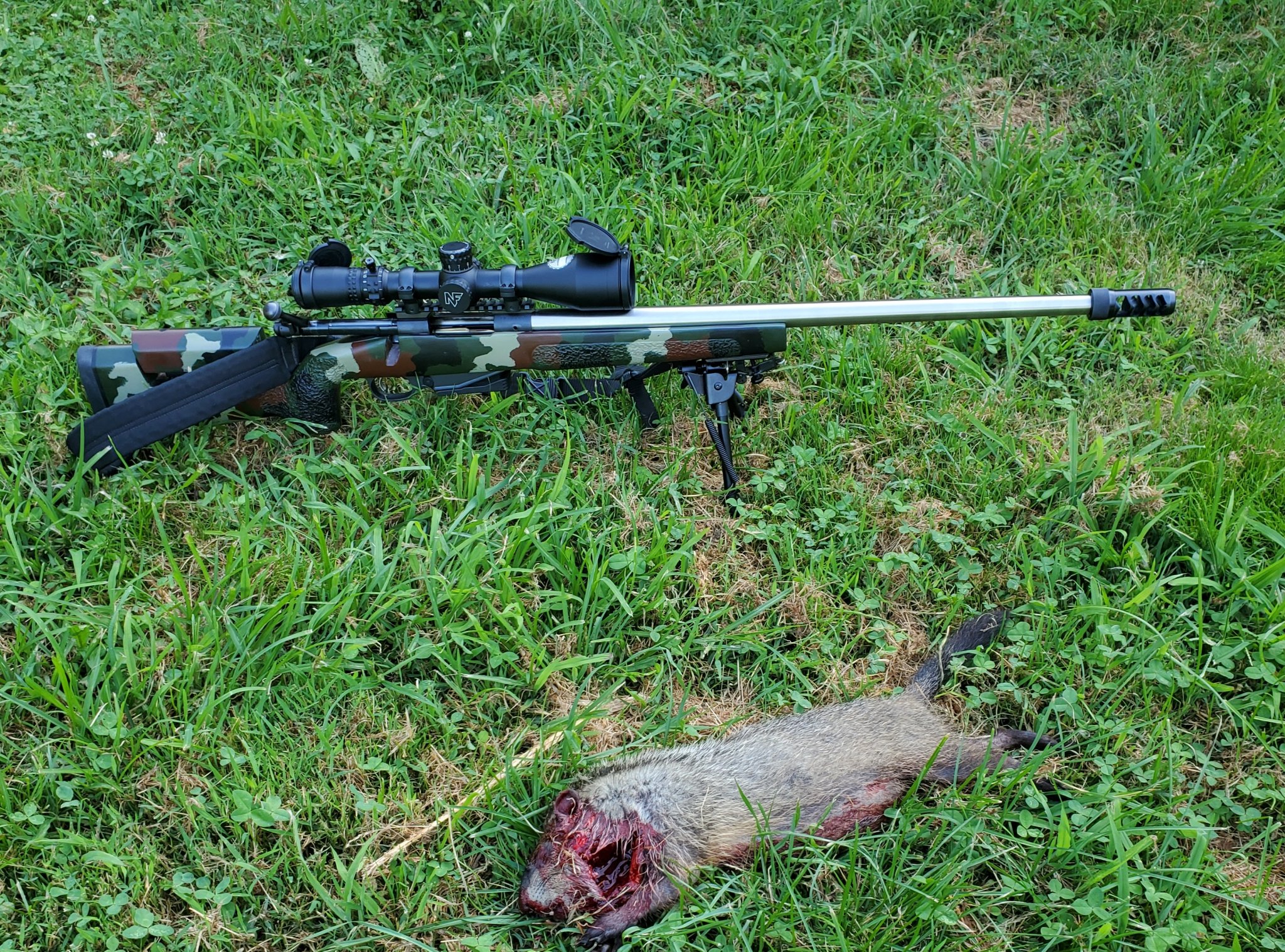

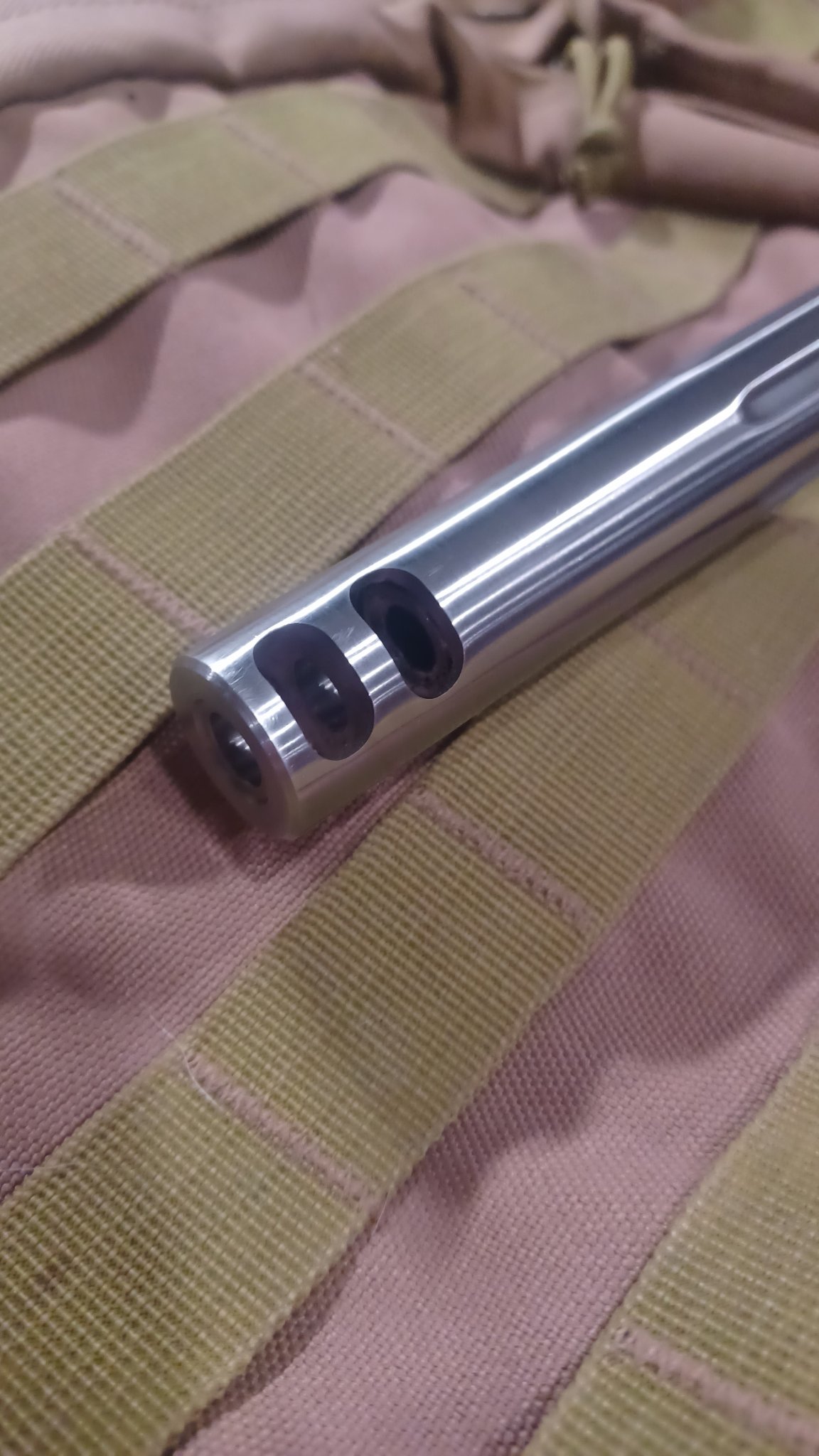

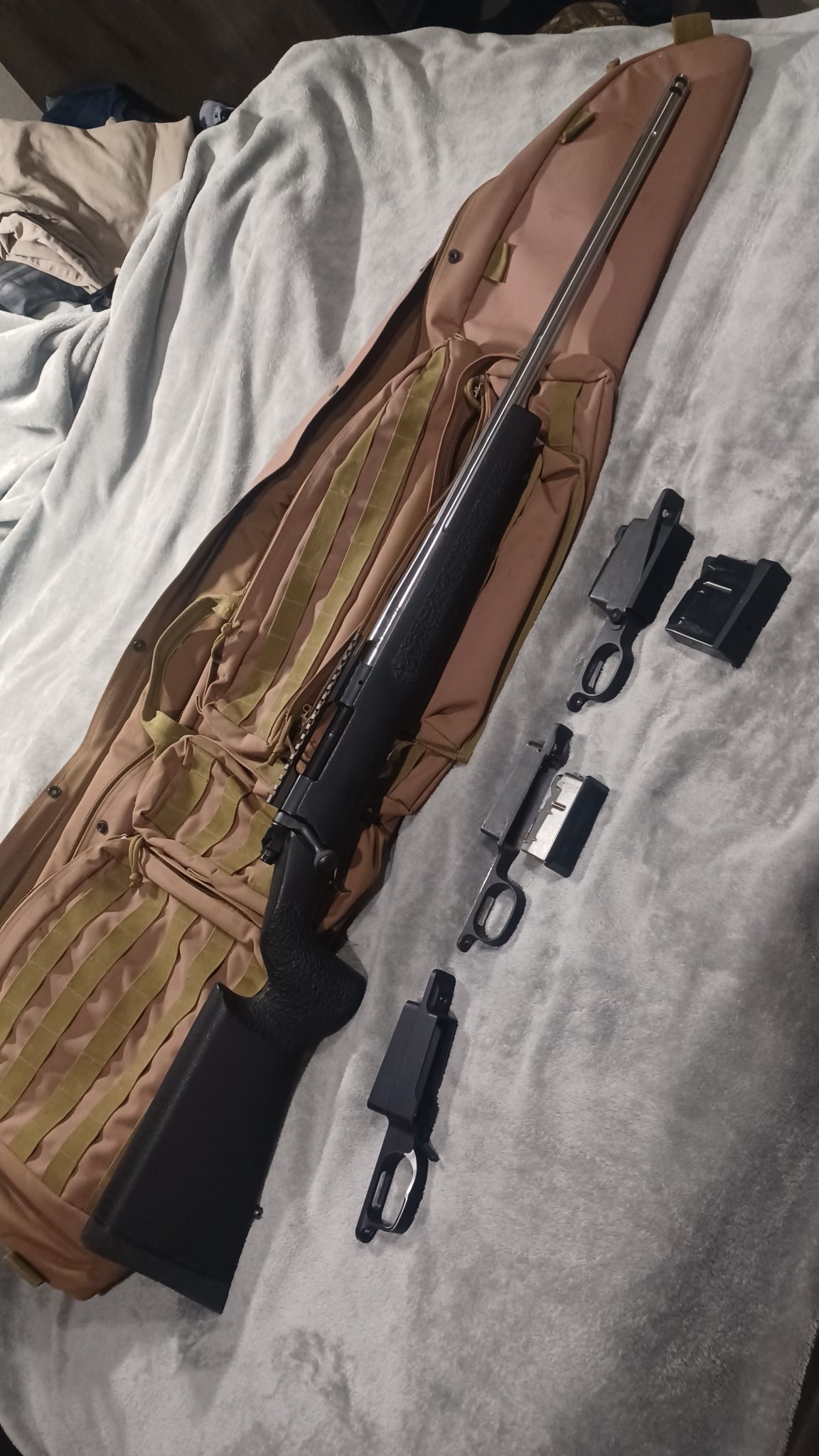

Got this SPR recently. It came with a custom barrel which I believe the previous owner said was a rock creek. Work was done by precision barrel works out of Hempstead texas. Action face has been squared, magwell has been opened up.
Barrel is 25.5" long and has a very well blended muzzle break. The rifle came with a PTG bottom metal, FN TBM, and an fn flush mag bottom metal & mag. Previous owner also included a drag bag into the deal.
Can't wait to see how it's gonna turn out. I have no idea yet what glass it'll sport and what kinda paint job it'll get but if anyone knows anything about me, its that I like to give my rifles some wicked paint jobs.
