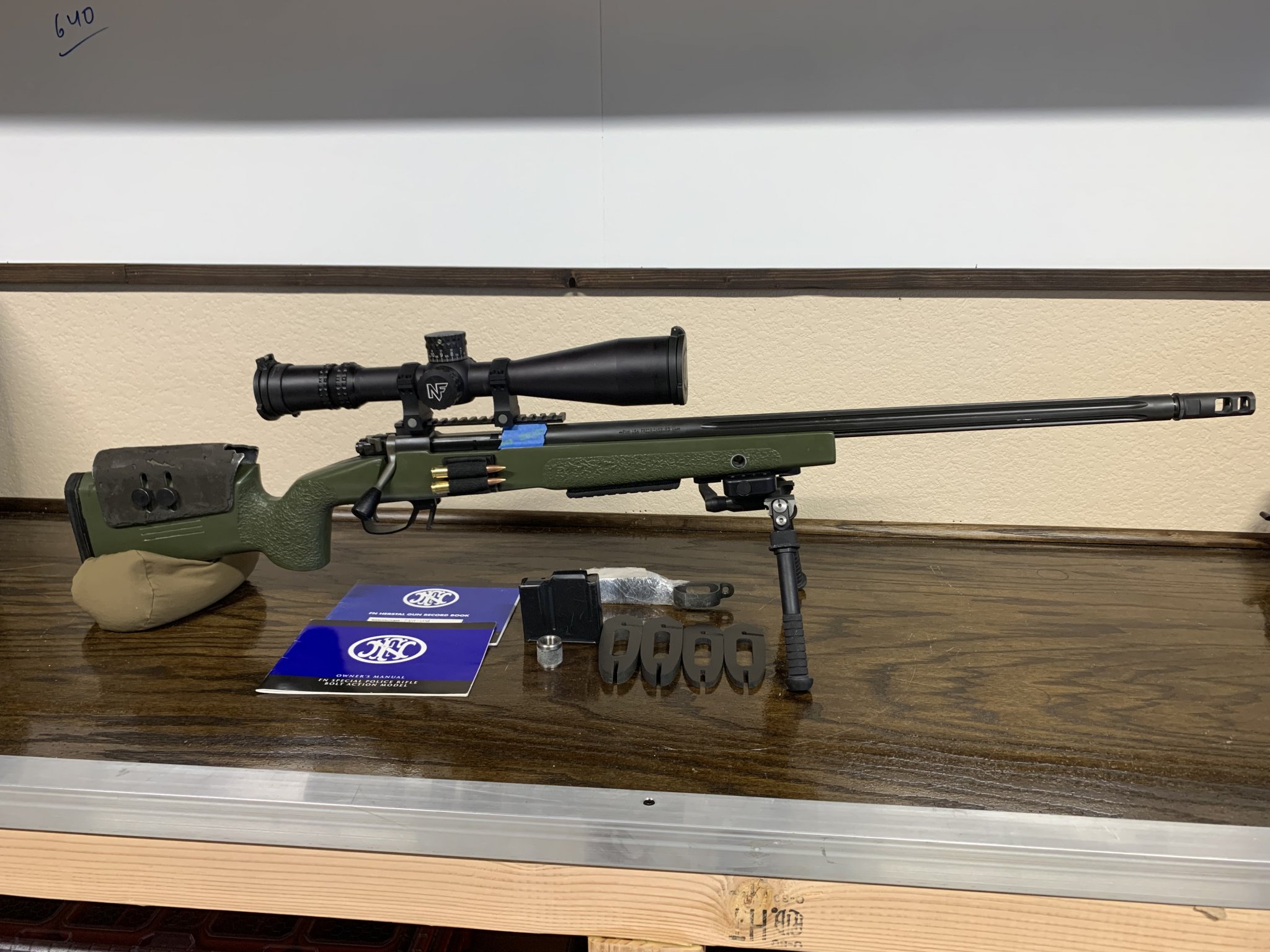

Fn -TBM question
My 10 rounder 99% fumbles the last round. Nose up and binds. Anybody else have this issue?
Yep have had the same problem with the 10 round mags. I did the spring stretch trick and it helped a bit. I also bent the mag feed lips to get the round to ride a little high. Seem to help a bit more.

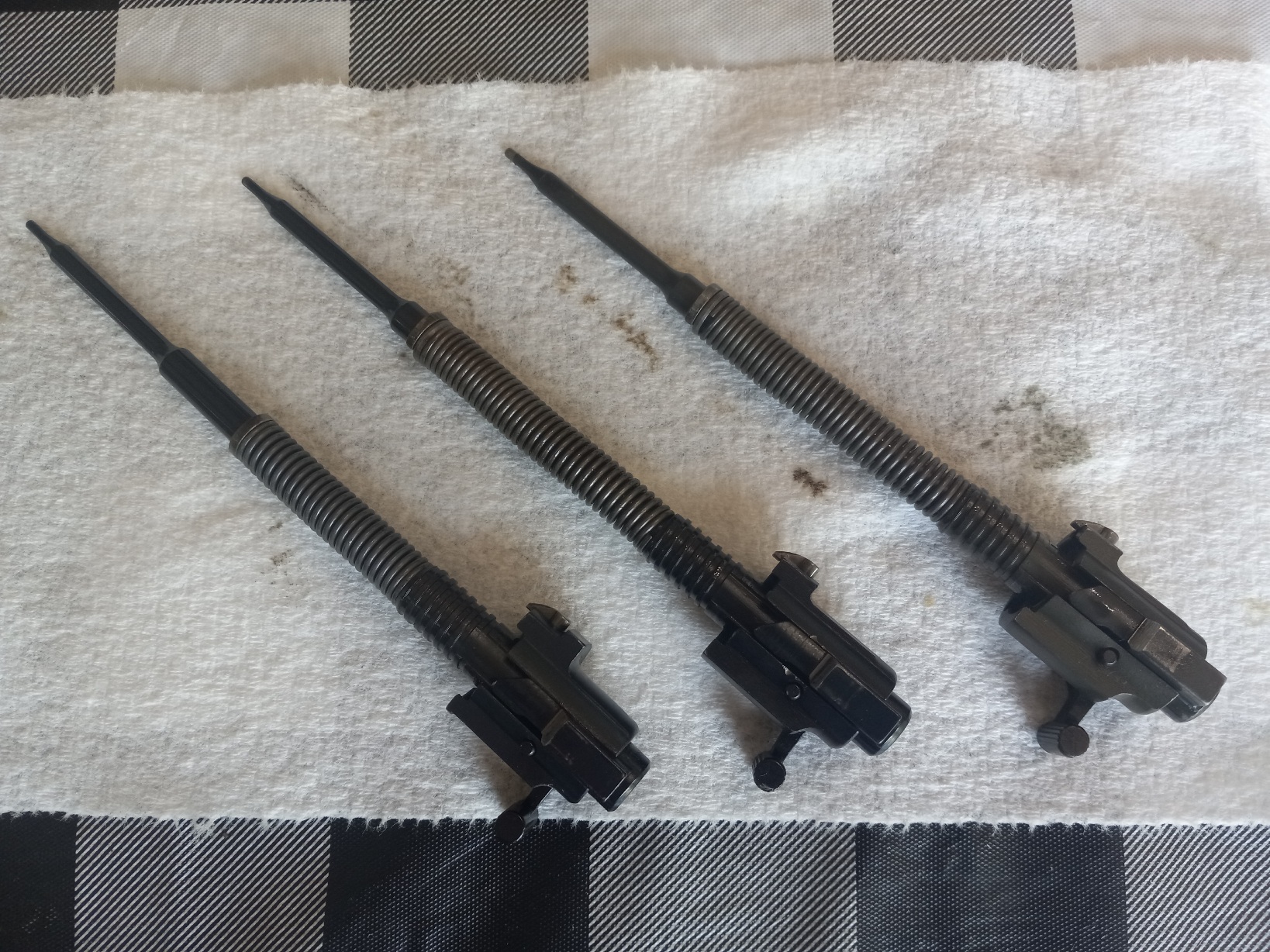

Got this yesterday
Sorry for the crap photo.
Left: FN SPR A2 (S/N: FN2027X). This one has a different pin assembly, and the shroud is a bit different too.
Middle: FN SPR A1 (S/N: FN1030X).
Right: FN SPR "first gen with H-S stock" (S/N: FG1069X).
As I don't intend on ever getting rid of these rifles, I'm just looking at trying to stock up on a few extra firing pin springs as the round counts increase.
Reactions: jetmd and M77
For the older FN103XX and the FG106XX you need the long spring #U356401670. For the newer FN202XX you would need the short spring #U356402100. MWGW looks like they have both in stock.
I would also recommend ordering a couple of the firing pin spring retainers #U356432040 while you're at it. Installing the spring runs the risk of this retainer flying off into the nether regions of your shop never to be seen again. MWGM has these, too.
Hope this helps.

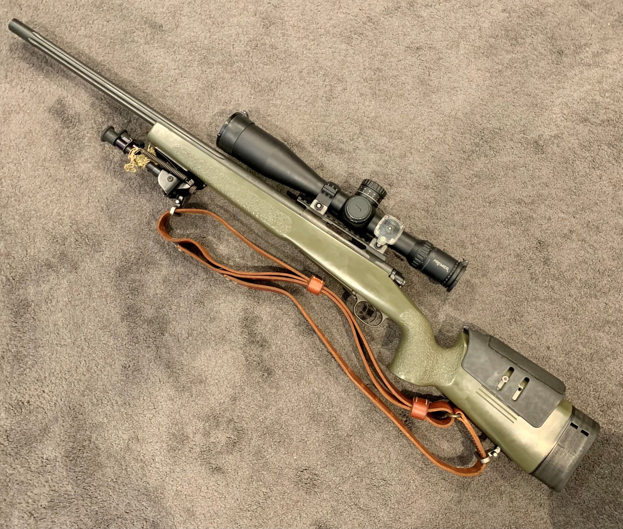

Shit man I wish I actually shot it but the AXSR is just so damn nice. I can’t justify taking it out when I can take the AI.
It was my first bolt gun too. But room has to be made in the safe for more AI barrels 😂 #FirstWorldProblems
I don’t blame you one bit! I had to move the other direction a few years back (went from an AIAT that I absolutely adored to an A5M XP that I got a killer deal on), and while I truly enjoy the SPRs, nothing beats an AI. Prices on them have gone up some, so it may be awhile yet before I can get another. So I guess it’s a good thing the SPRs are so nice lol.
Yeah, I have 3 SPRs and an AT-X. My particular AT-X is fantastically smooth (maybe it'll get even better with more use). It is certainly more appealing to run than any of my SPRs.
That being said; I have quite a few rounds through the SPR action, and have never had any hiccup of any kind (other than one particular factory DBM magazine). I actually still grab one of them more than my AT-X.
I would argue that the SPR action is still a valid design these days. Yes, it lacks an integral rail, or QC barrel feature (could you even do prefits with an extractor cut?), and the trigger is going to be too heavy these days for guys with poor fundamentals (yeah, I went there). However, it would take a pure troglodyte with simian strength and intellect to damage one, or even get it to malfunction.
Color me a fanboy stuck in 2005, I don't care. :ROFLMAO:

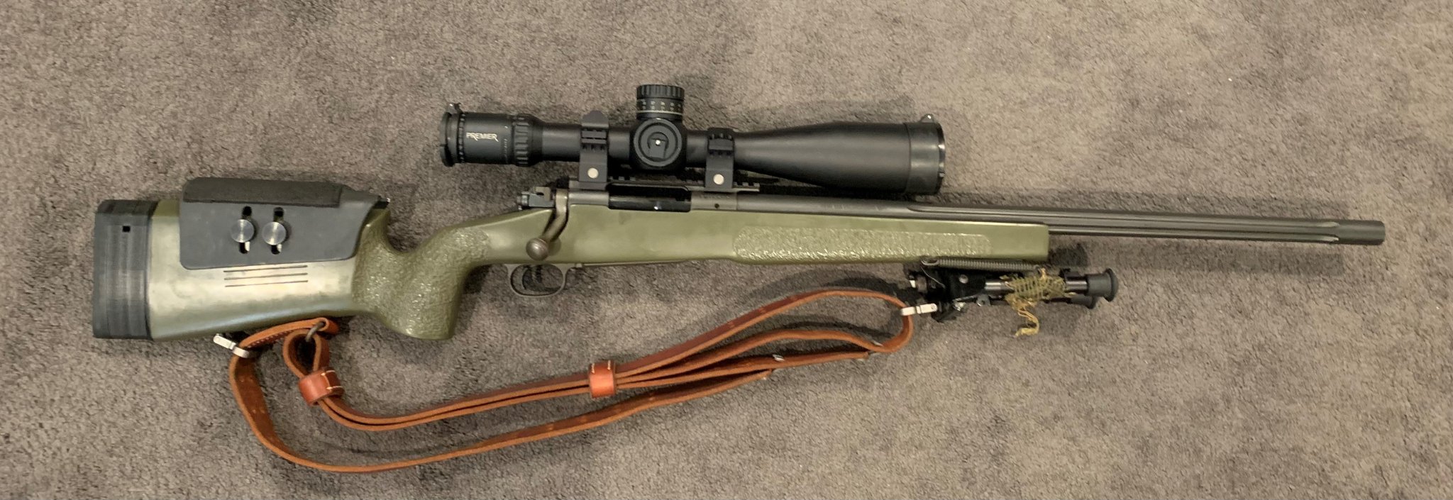

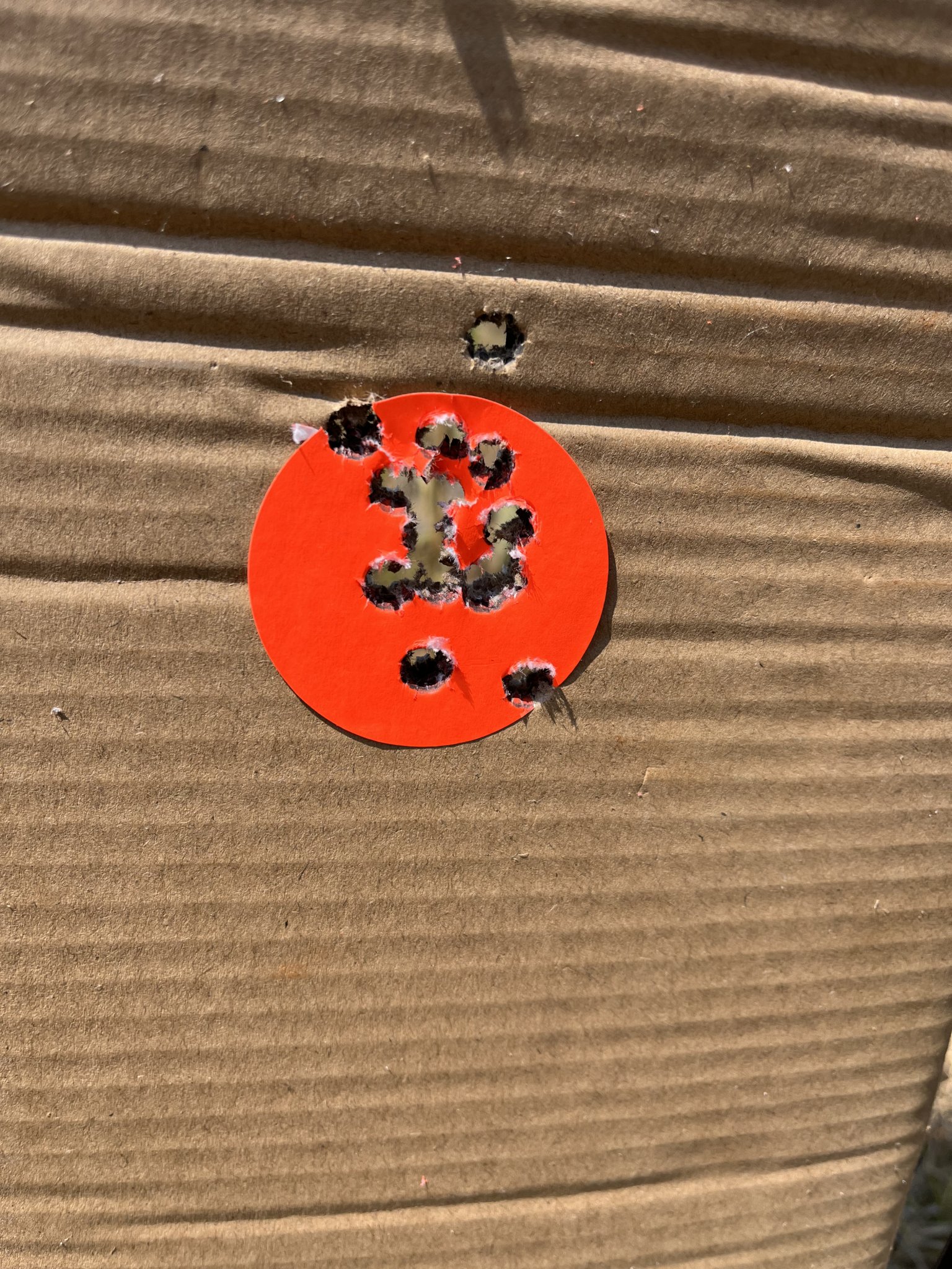

picked up my third FN SPR last week. 20”A5M XP. New in box, built in 2014.
Had a McMillan HTG cut for it here at the house with all the different bottom metals. Not sure what bottom metal I will end up using.
Have to do some trigger work for sure.
Mirage was terrible, over 100* when I was in the pasture today.
I think it shows promise. 168 gr gold metal match.
