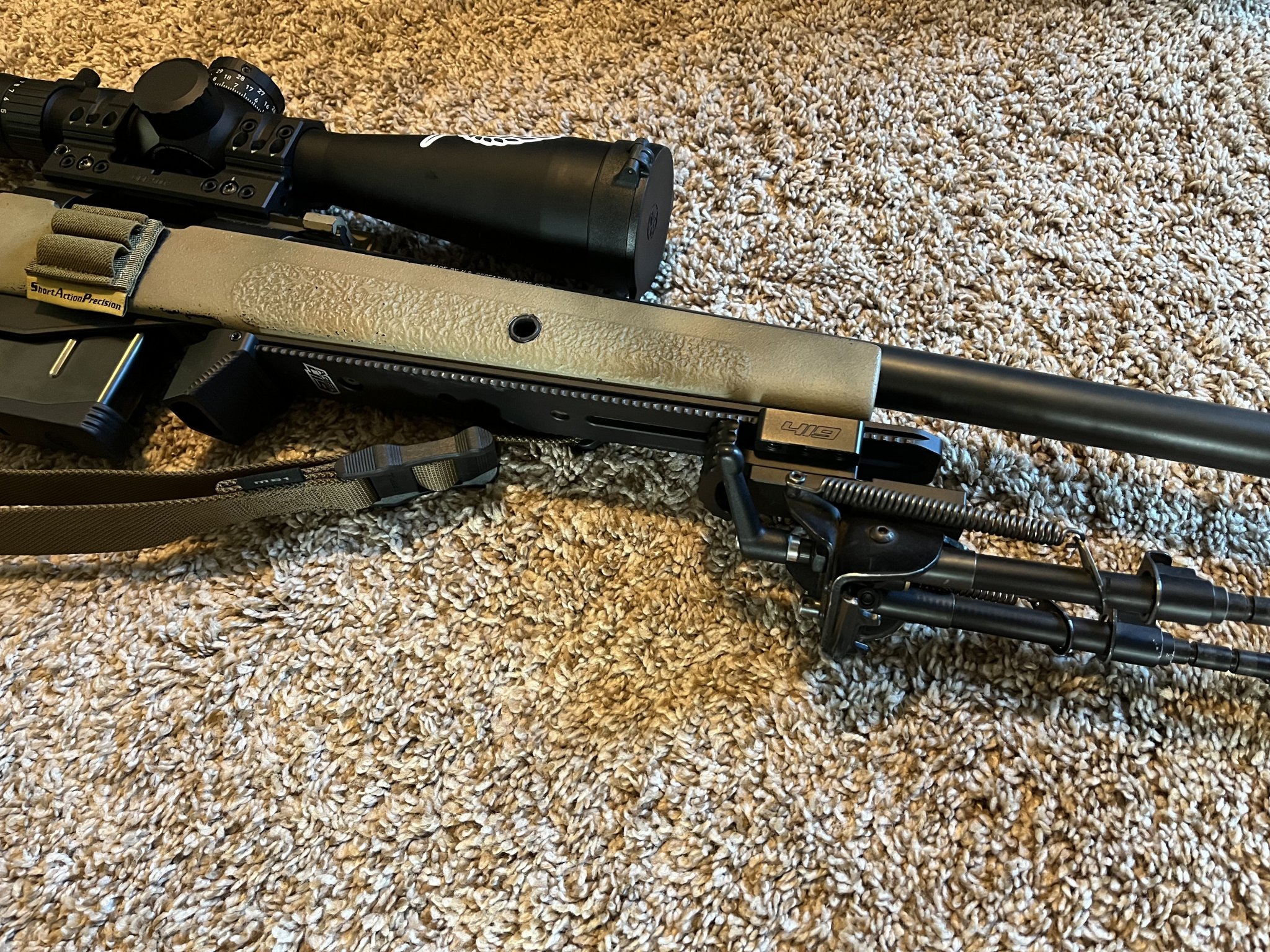

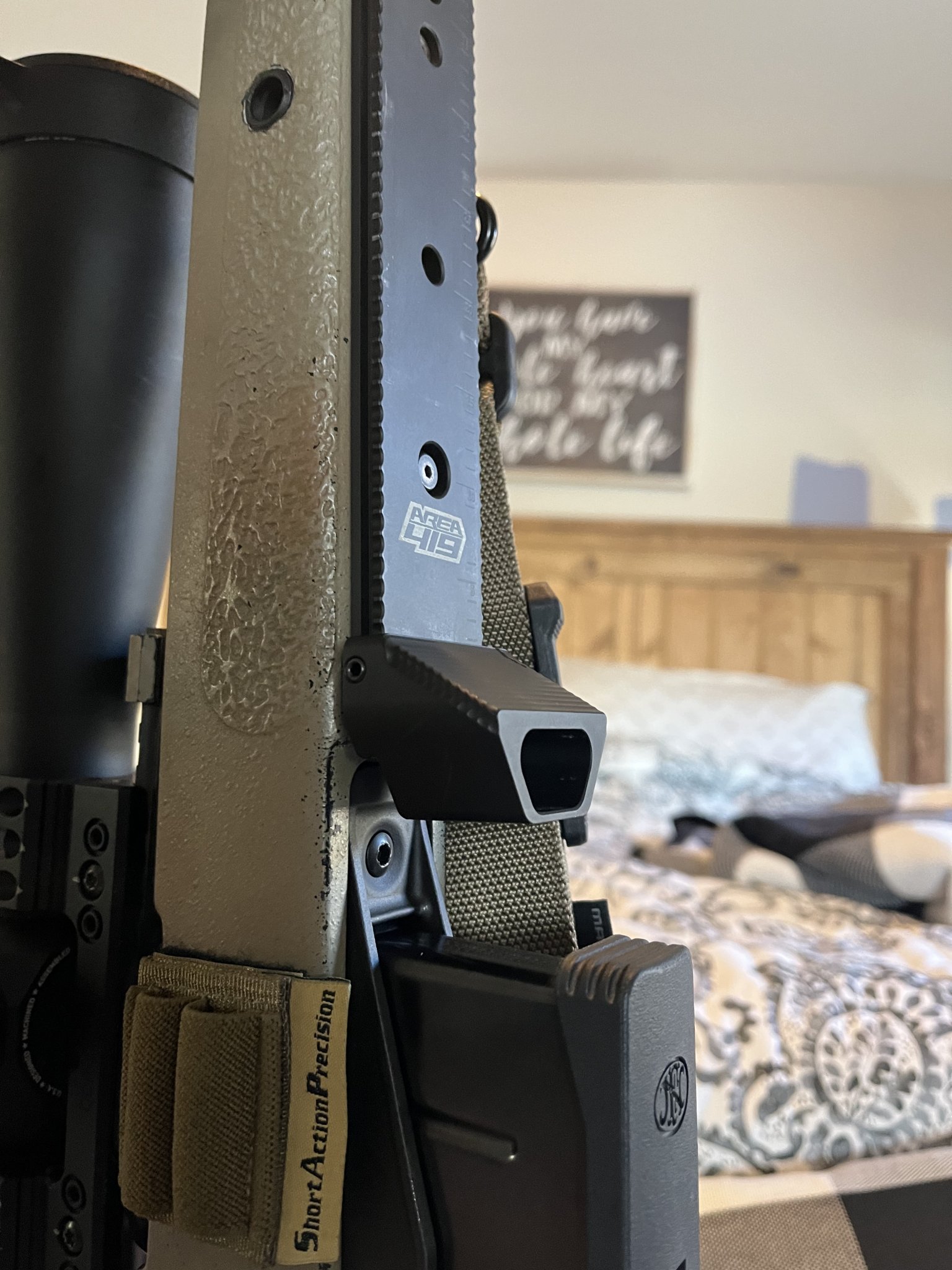

I used the area 419 12 inch universal rail on my SPR A1. I drilled and mounted the rail in front of the action screw and bottom metal so I wouldn’t have to remount the rail if I wanted to pull the action or have to go find a longer screw. I have about an inch or so of overhang at the front and acts as a spigot really. I think it works great.
