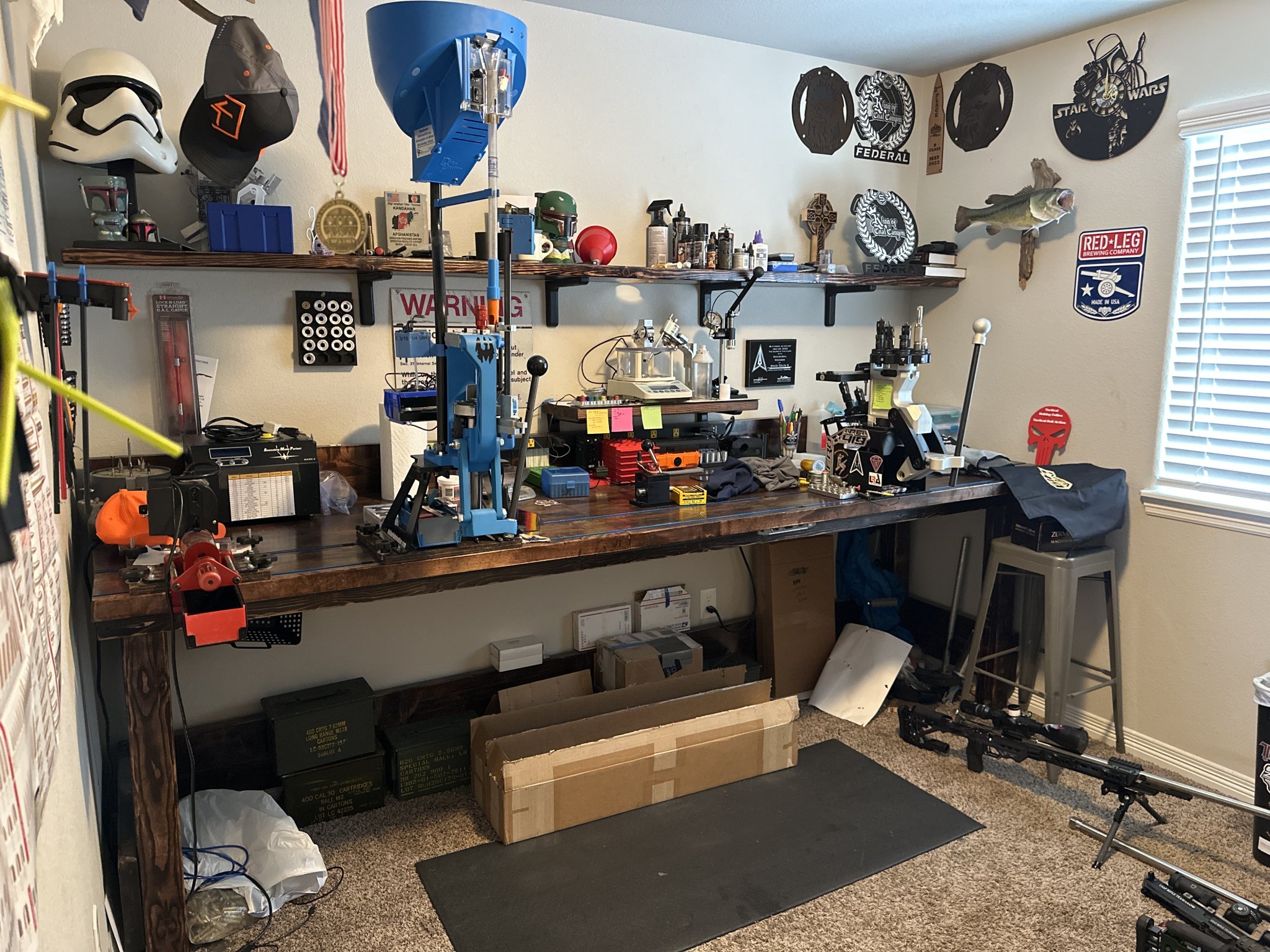

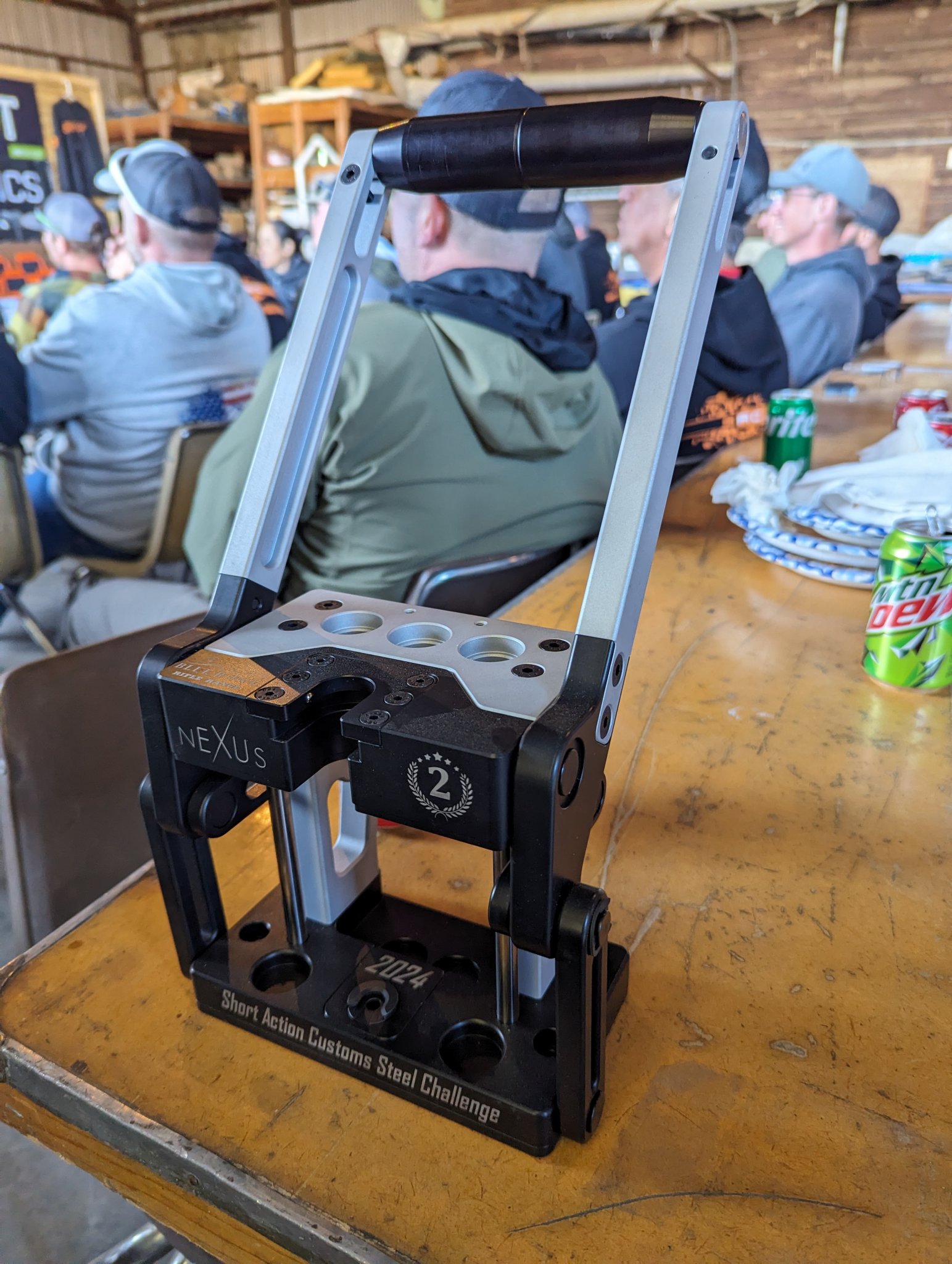

So im going to keep on sitting in my $150K shop/office behind the house with 300sqfoot climate controlled reloading equipment, dank expoxy floors and over 30 feet of reloading benches and the best equipment money can buy. If a 419 press offered anything better, i would probably have a few of them. It would probably be sandwiched between 2 ST , the AMP and more Bergers than your car is worth.
