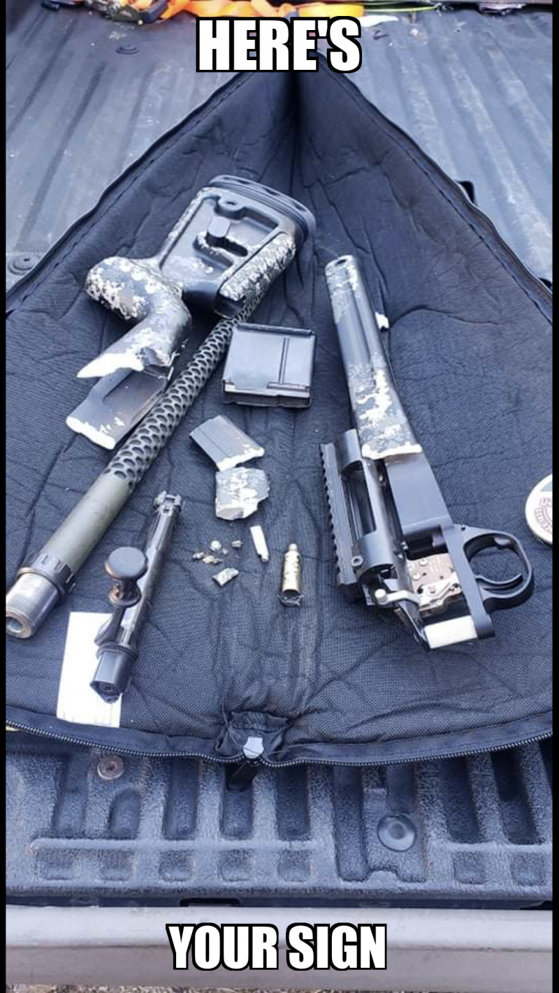

Buddies 22 creed blew up…. Any ideas
It’s not about pressure signs and particular rifles.
When people say their particular rifle…it means nothing unless your under the max sammi pressure.
The weakness is the brass
No matter what a rifle is designed to withstand…the brass will let go when pushed to far.
And almost all brass on the market…because it’s only brass…85k is too much

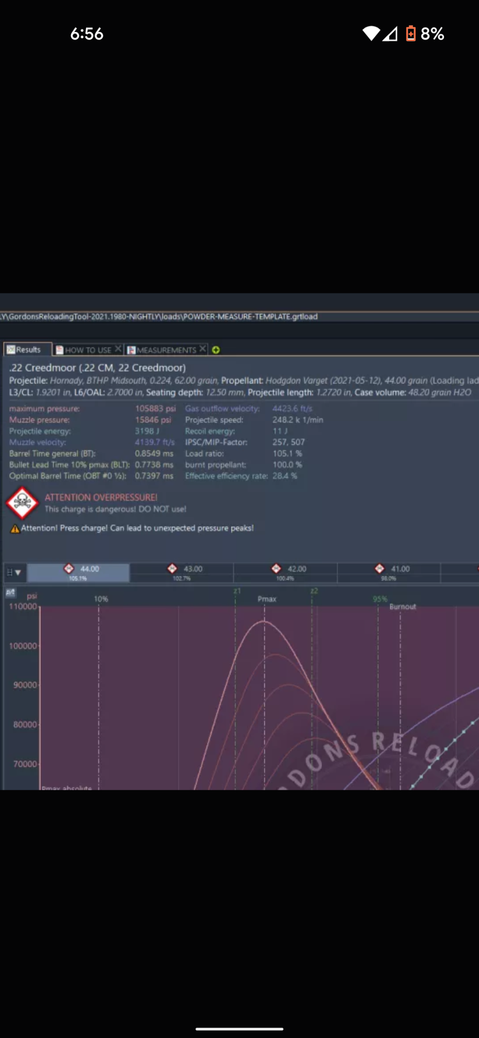

Assuming a 26" barrel, 44gr of Varget and a 62grain bullet at 4150 fps, with some rough Quickload calculations....
Somewhere north of 85k PSI.
Don't forget the controlled chaos is a solid copper bullet, so increase the start pressure in Quick Load over the default for jacketed lead bullets-- that might bump the pressure even higher than the 85ksi estimate.
Scary pics, but it does give me confidence in Ted's design and steel and heat treating choices for the ARC actions.

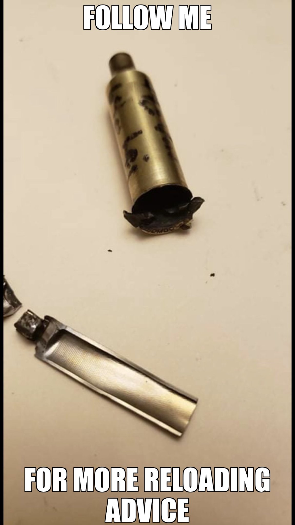

I’m surprised that that brass hid the pressure signs. Sure the primer is super flat, but I would have expected to see ejector Marks long before it would let go like this.

Sheared extractor off bolt and case head separation? Brass failure?
Brass was twice fired copper creek 22 creed brass.

Luckily the action contained all the shrapnel and he just got a wake up call and a little fire ball.
Gun had 200 rounds through it.
Thanks to your buddy for illustrating why "no pressure signs" is bullshit. 44 grains of Varget? I guaran-fucking-tee there was pressure, and a lot of it. I can also guarantee that the case doesn't have the capacity to double charge - hell, I'd be surprised if 44 grains didn't crunch when he seated the projo. My suspicion is he was right on the ragged edge of what his gun/brass could handle, and for whatever reason this particular round was "the one." Might be a little heavy on charge weight, little high on engraving force... and presto.

I can't find any published load data for 22 creed, but a 60-65gr 6mm Creed data with Varget has ~44gr as a MAX in a SAAMI chamber with Hornady brass. Necking down to .22 is definitely going to increase pressure. Hornady to a thicker brass is going to increase pressure. I'm going to ballpark guess 3-4gr over sanity.
Reactions: HOOFER
Don't forget the grenade also used a 62gr solid copper bullet...

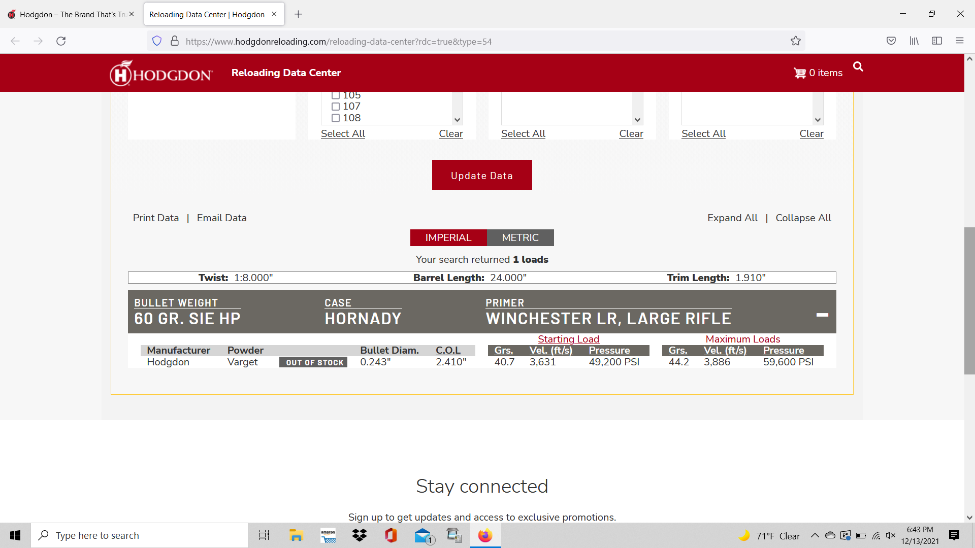

I know there's a pressure differential between jacketed and solids.
I'm puzzled about the posts stating this was an obvious and "stupid" overcharge at 80 to over 100 KPSI.
Now, I know a 60 Sierra HP isn't a 62 grain solid- but Hodgdon's reloading data, which I've always regarded as conservative- shows 44.2 grains Varget as max load w/velocity of near 3900 and pressure under 60 KPSI.
WTF am I missing here?
