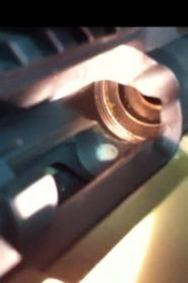

It seems to me that round was not running over pressure and simply unsupported.
The short tenon is a likely scenario and then a major screw up. These things need to be verified and then verified again.

What type of bolt extractor was it? Factory, sako, m16?

Culpeper, as for the extractor, looking closely at the action pic you can get a pretty good guess as to the manufacturer and that will answer your question. Of course that does not indicate who assembled the rifle. I'm hoping for some good technical analysis on the build.
Because we are all theorizing about the cause, here's my theory.
Rifle builder took all his bench measurements with a .188" thick lug. He then forms the tenon, cuts the threads and creates the counterbore to match these measurements. Happy with his work, he sets the action and lug back on a bench with other miscellaneous parts while he sets up his flush system and reamer. without any thought, off the bench full of parts he grabs your receiver, bolt and a .300" lug and goes to town on the chamber setting the headspace with this combination. Since his wife is bitching at him for being late for dinner, his thoughts are elsewhere and didn't notice an eighth inch of headspace gauge sticking out the ass end of the chamber. After all, the bolt just closed on the go gauge and didn't on the no-go so all is well. He then snugs the barrel onto the receiver and boxes it up ready for shipping before his brussel sprouts are cold and he has to sleep on the couch.

Missed the pic but I can see now. Blew the pic up a little for better viewing.

A lot of people keep suggesting that the rifle may have been chambered for 300wm. I'm of the opinion it would be very difficult to enough primer strike force to fire the round. Another thought if it was a 300wm chamber and 308 win case the primer would of been off center.

I can see this happening...... That would certainly account for the excessive boltnose clearance and unsupported case, while still "appearing" to be OK.

The OP isn't entirely descriptive as to the detail and fallout of CF event. Photos and measurements of the chamber, I suspect, will be forthcoming. But if you ask me right now, there are a number of things that could cause what has been described. In reverse order of potential:
Barrel obstruction - Highly unlikely, as warranted by OP.
Ammo - Unlikely, as OP warrants reputable ammo, and the failure to the brass suggested brass was un-contained.
Human Error - Remotely possible. Bolt not rotated to fully engage lugs, but enough to set firing pin.
Bolt face issue - Possible, but cartridge rim must have been captured by the extractor for ignition.
Head space gap due to sizing for caliber other than .308 WIN - Probable, given rupture above cartridge rim, and ubiquitous ".308" caliber stamp on barrel. Shame on builder's smith.
Head space gap due to faulty installation of barrel - Probable, due to rupture above rim. Chamber OK, but barrel not fully threaded into receiver. Shame on builder's quality control.
The OP mentioned that he did not feel the tangible final "resistance" when closing the bolt. This ever-so-slight resistance is not normally due to the case seating fully into the chamber, but more so the resistance of fully engaging lugs and of the firing pin spring compressing into lock-up. So I don't give this a whole lot of weight.
In any event, once the old brass is cleared from chamber, and no obvious chamber or head spacing measurement errors are evident, forensics will demand that the rifle be fired again under safe and close supervision of OP's third party for the record. As suggested, this will eliminate a number of the possible CF causes listed above.
