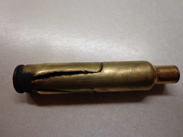

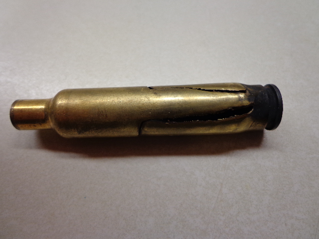

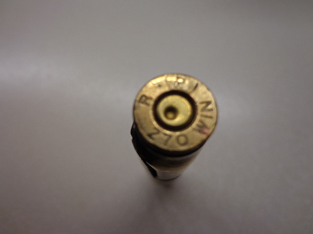

A lot of people keep suggesting that the rifle may have been chambered for 300wm. I'm of the opinion it would be very difficult to enough primer strike force to fire the round. Another thought if it was a 300wm chamber and 308 win case the primer would of been off center.
Mike
Never under estimate the power of determined people, the guy who fired this case ( a 270 win, in a Weatherby MKV 270wby mag), said he had to raise the bolt 3 times to recock the rifle to get it to fire. Which must have been the reason he missed the deer. He was asking to see if we had any more ammo, cause he was out. After I took the camo tape of his rifle to show him he had the wrong caliber ammo, he said he borrowed it from a friend. I told him how lucky he was, but he did not seem to care or understand why. He also said he wasn't gonna pay near fiddy dollars for a box of 2-semdy boolits, and was going to wally world to get more of what he ran out of. .....Darwin?
