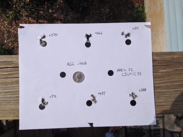

Shot another target this morning, same gun different loads from the 1st target. 308 175 smk 42 gr. RL 15
Here is my best offering. I know I will be able to get this one day but I cannot seem to settle down enough to be consistent. I know each time to pull one. It will just take more practice.
For the target bottom right, there are three shots in the bottom hole. Started out as one of the best groups I have ever shot. I got so excited that I screwed it up.

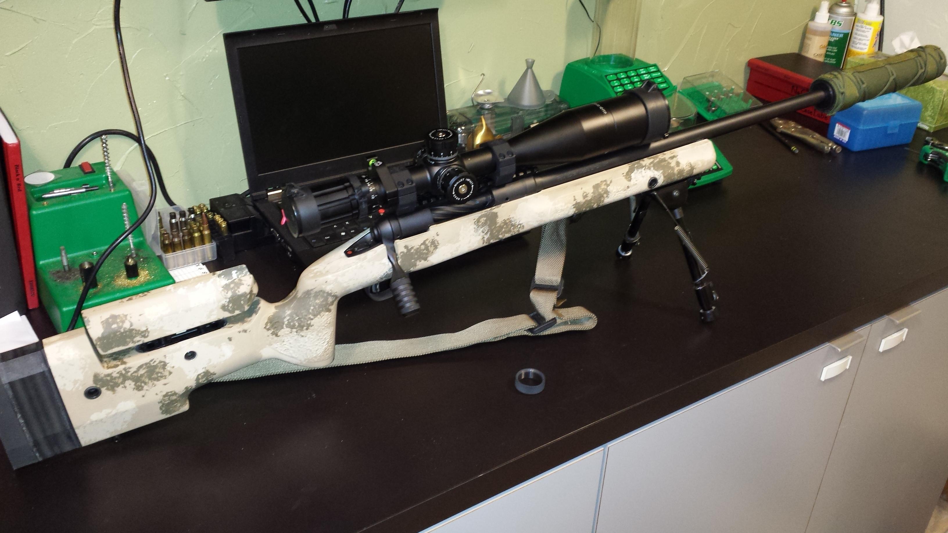

Savage 10PC, TBAC 30BA Suppressor, 100 yards, Hand Loads - SMK 168grain - 44gr. Varget, SWFA 5-20X50

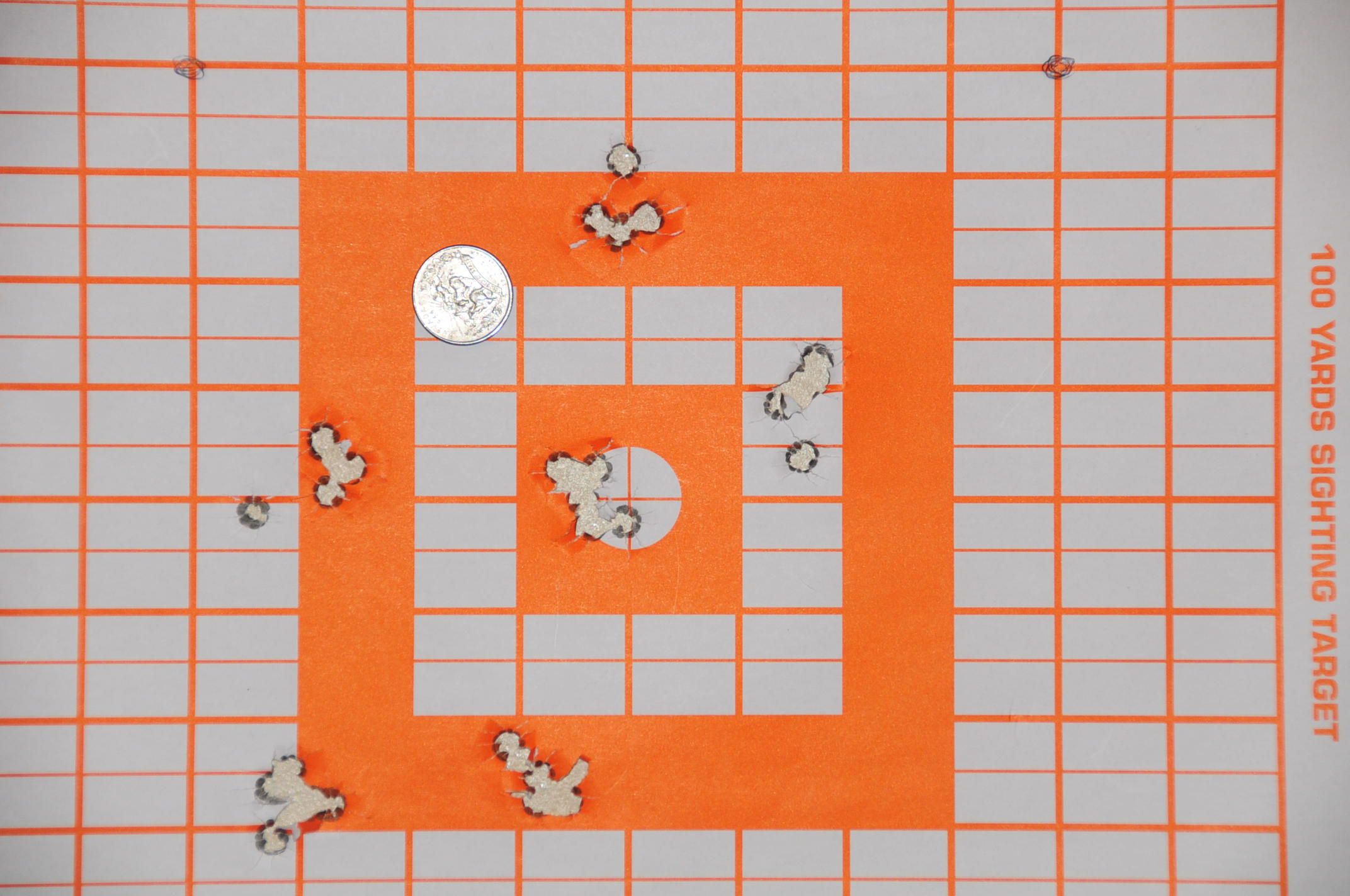

The two worst fliers are shots I rushed. It was a little harder than I though to maintain concentration across 30 shots. This was shot with a MRAD .338 If I get time tomorrow I would like to reshoot it with the .308. Distance from the muzzle was 99 yards.DLH_0296.JPG

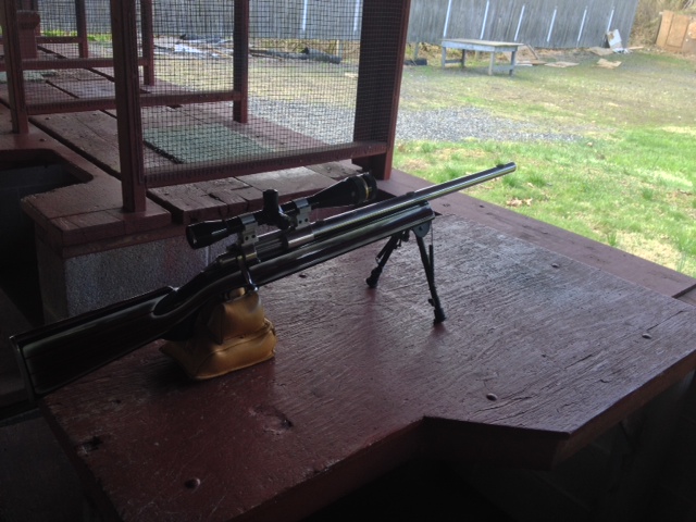

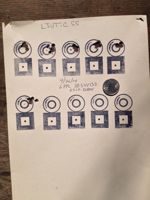

Did someone say they wanted to see 6mm groups? This was shot over the weekend, wanted to agg in the 2's but the weather was not favorable. Receiver is a Hall B with a Lilja barrel in 6ppc .261 neck bullets were Euber 65 gr. fb 28.5 gr. powder VV N 133

There are a couple of bugholes so average might be in the .2s :) Great shooting! I'll run it through the software at home in a bit.
With a scale I figured it to be around .335 group. I tried shooting a 6 target group the day before, but at my age I had a hard time seeing the cross hairs. The cross hairs on a 36x Leupold scope are 1/16" at 100 yards and I had to switch scopes the next day to a 36x Sightron with 1/8" dot, thats why there is a black dot in the square of each target. I have not shot this gun since April of 2006 and it took me 6 hours of prep time to assemble 32 cases.
I am having my 6PPC chamber recut (the throat went south) - hopefully the barrel will be back before the end of this round. I've had some really good luck with XBR-8208 in mine. I've shot it with 50x Sightron and (don't laugh) older Bushnell Banner 18x (Korean made one) - can't tell if 50x is really that more beneficial shooting off a bipod, but having different POA and POI helps a lot shooting "one-holers" as long as you watch the scope cant.

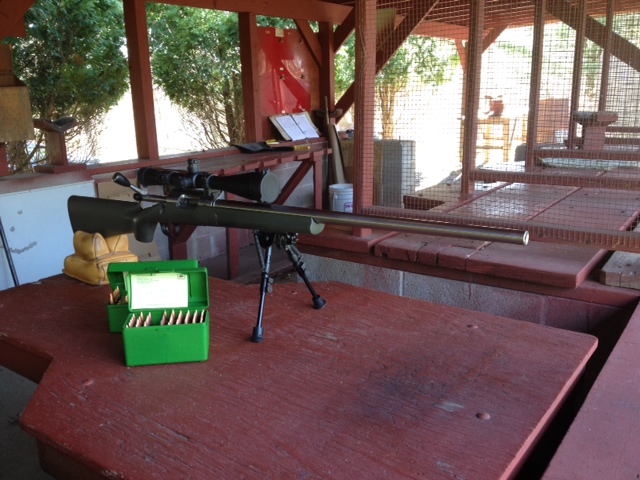

Rifle: remmy 700 SPS AAC-SD, .308 Hornady Match AMAX 168gr.
First time shooting in a comp like this. Wind was from 5-15mph straight in my face and the mirage was pretty rough too but I shot my best. Hope I submitted the target correctly.
