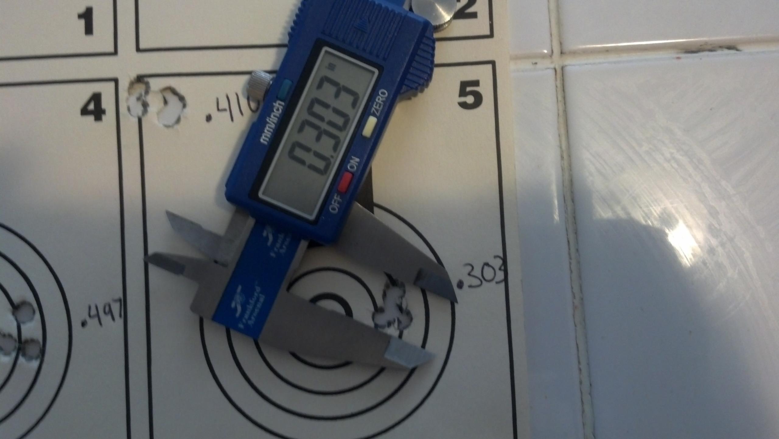

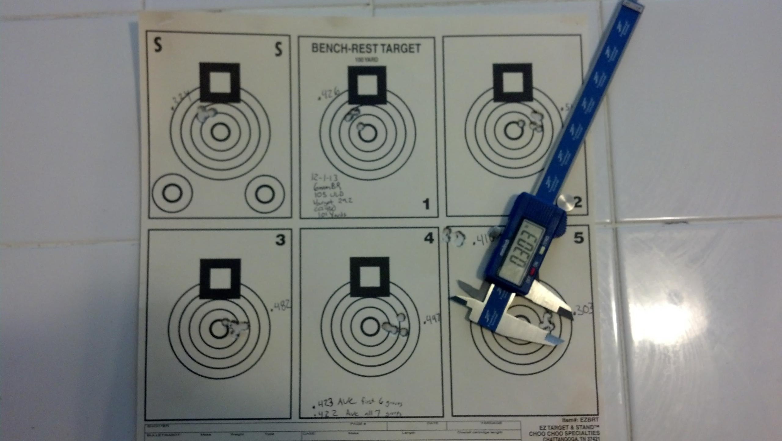

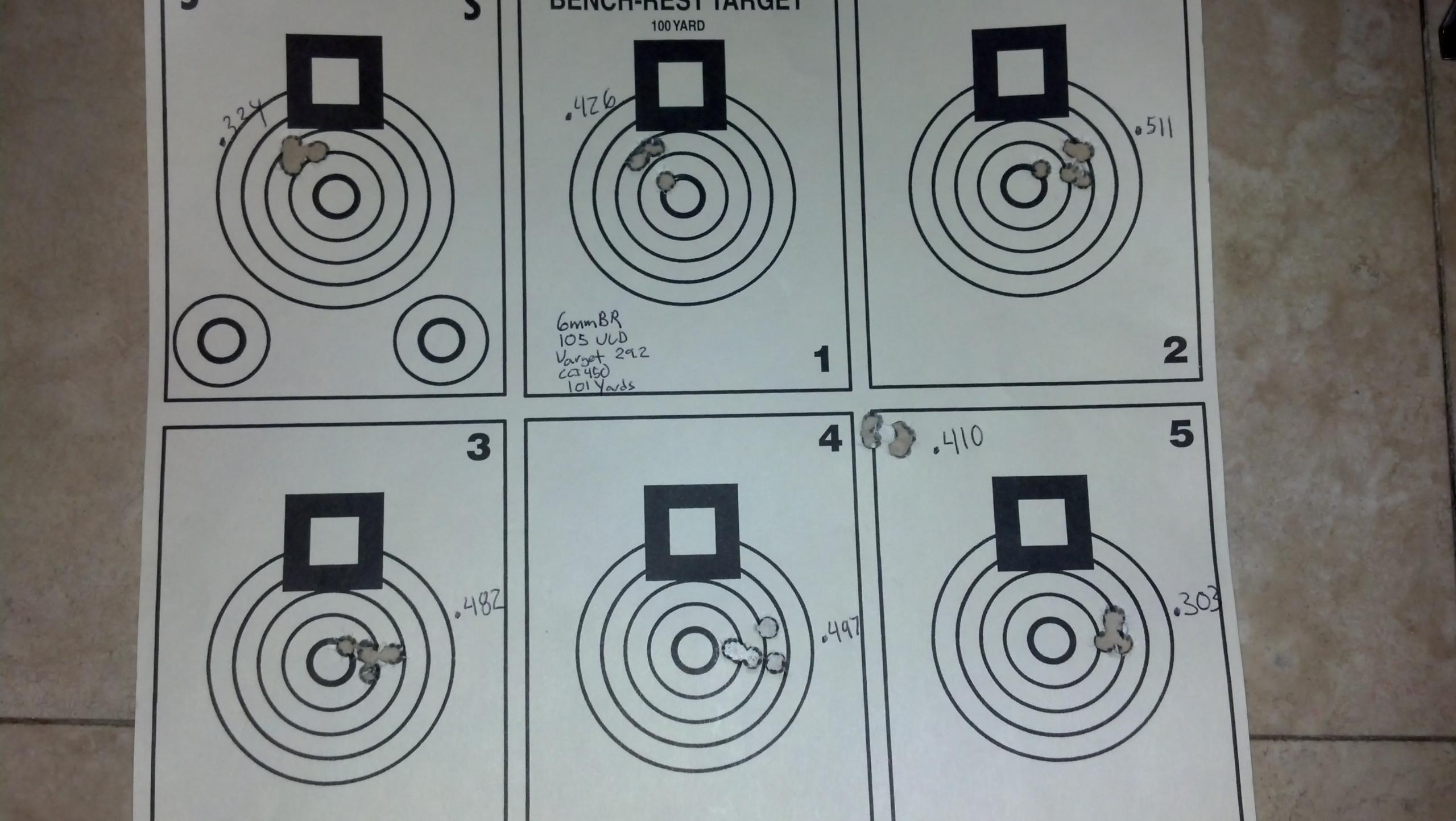

Here is my first entry. I shot it today, it was about 41 degrees out. I shot with JBell. Rifle is an AIAX, barrel is an AINA .260 Bartlein, scope is a Schmidt 3-20x50 Klein, and the can is a SAS Ti Arbiter. This was actually a load development target, five different loads.
Average was 0.479", Best was 0.320". The group on the lower left started with a flier, so I used the bullet as POA to salvage the average. The last round of the last group blew my average from 0.398" to 0.479", oh well.
