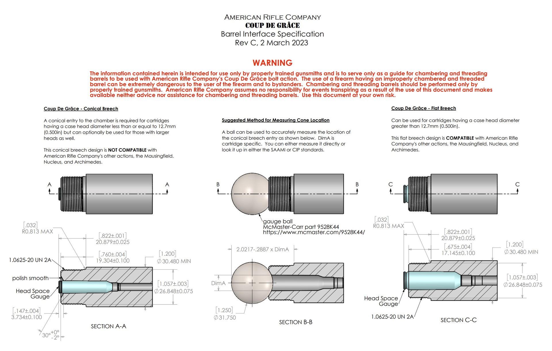

Hey guys, my smith just told me my gun is done, but I think I screwed up. When I gave him the barrel and action we were both shooting a match in almost 100 degree heat and I forgot to ask for a conical breech.
I’m assuming he didn’t do that and I had it chambered in 6 dasher. Am I going to be screwed?

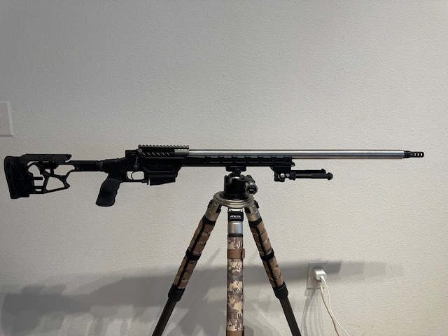

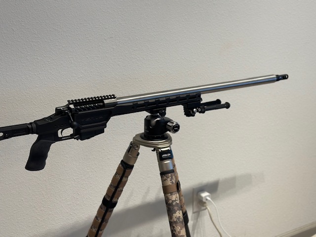

And I’ve never built a custom rifle before and didn’t even know what contour was when I started. All of this was pieced together primarily based on what I could find in stock. Next barrel is not going to be so big and beefy
that contour makes the brake look tiny
It’s bigger in person, I swear.

that's a stellar deal. idk man, you may grow to love that contour, it's what most of the top shooters shoot where I'm from.

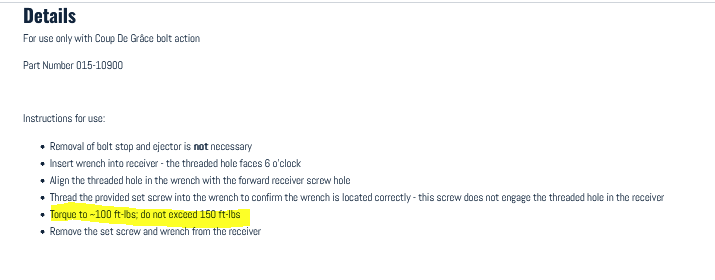

I was going to do 60ish. I was just wondering why they bothered to write that. seems like some people like to go to several hundred pounds with cheater bars. is it not safe for this actions material or action wrench fitment?
new to this whole, assemble your own precision rifle stuff.
A fair question that I believe was answered in this thread earlier, or possibly another one, don’t know.
But I do have to ask why one would worry about the upper torque limit on an action is once that number is well past what is necessary.

The limit has more to do with the wrench than the action.
thanks for the actual answer. good to know and if something were to break I'd sure hope it would be the wrench I guess.
it just struck me as odd because I've heard somewhere Ted himself talking about how the appropriate torque value for a screw the size of the barrel threads to get actual full engagement(or w/e you call it)would be somewhere in the neighborhood of 500ft/lbs, then on the action he manufactures recommends 150lbs. and I know Ted's a smart guy so I figured there had to be some reason out there besides
"have you ever torqued anything"
but yeah my gunsmith told me he does my actions to 50 and they shoot crazy good so I'll just do 60 with my shitty Lowes wrenches. if I had a problem I'd be visiting him anyway cause I don't know shit and he seems to know everything.
Well, you can either listen to the engineer who designed the action or your gunsmith/people on the Hide.
Me...I go with Ted the engineer who designed the action.

Only guy I know who does 3-500lbs on barrels does a lot more to the actions because they can’t handle it off the shelf, IIRC.
makes me think I probably just misunderstood Ted a while back when he was talking about screws and force and shit.
which is exactly why I do what my gunsmith tells me. he uses real small easy to understand words...
