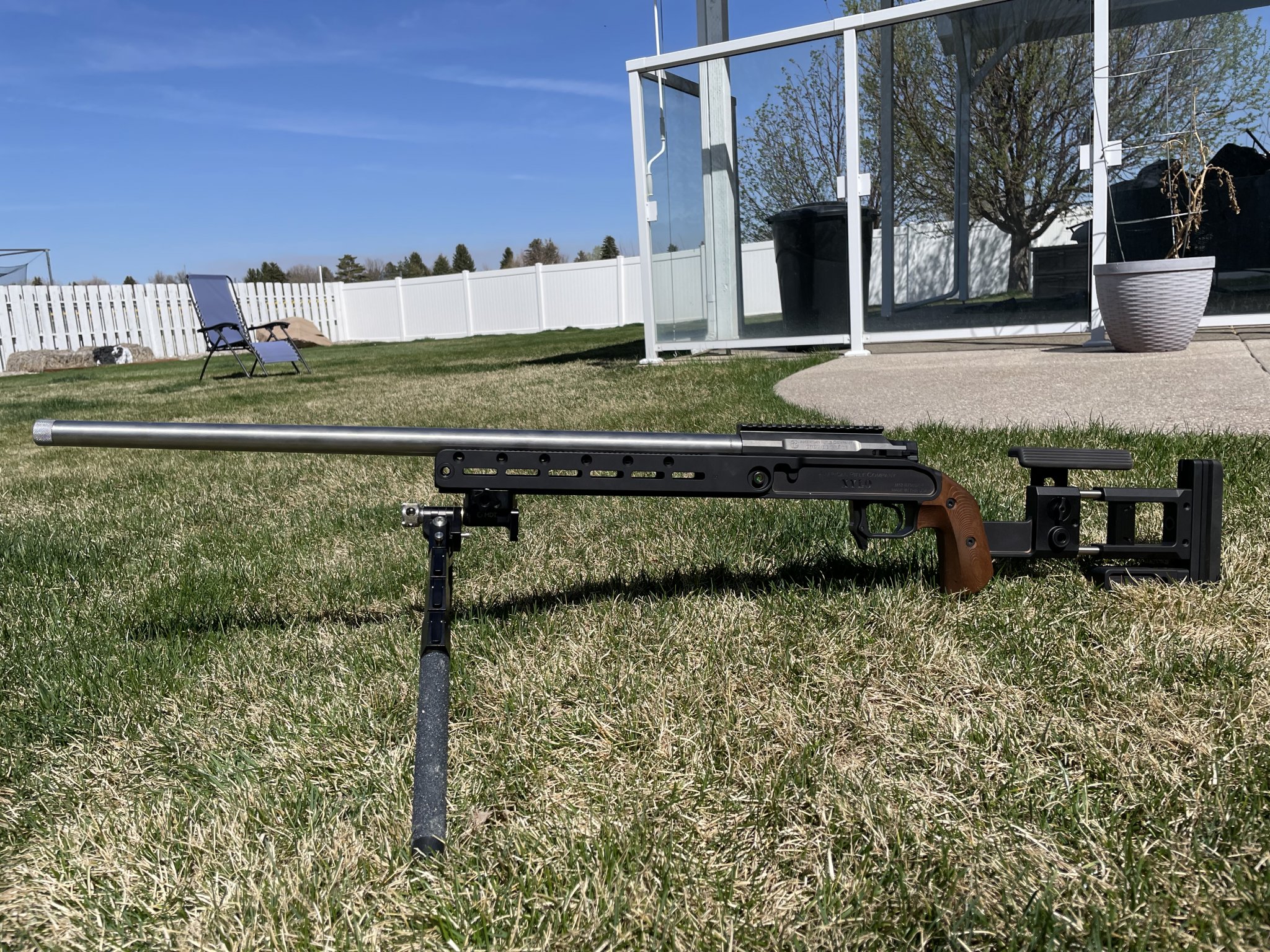

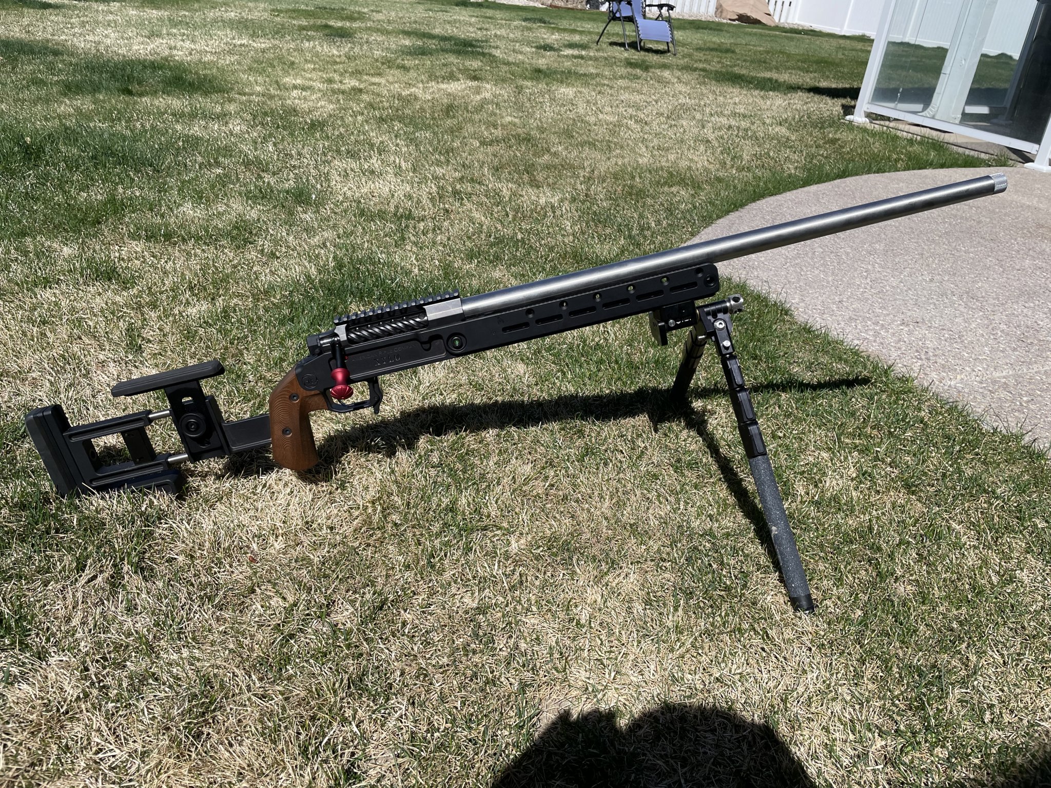

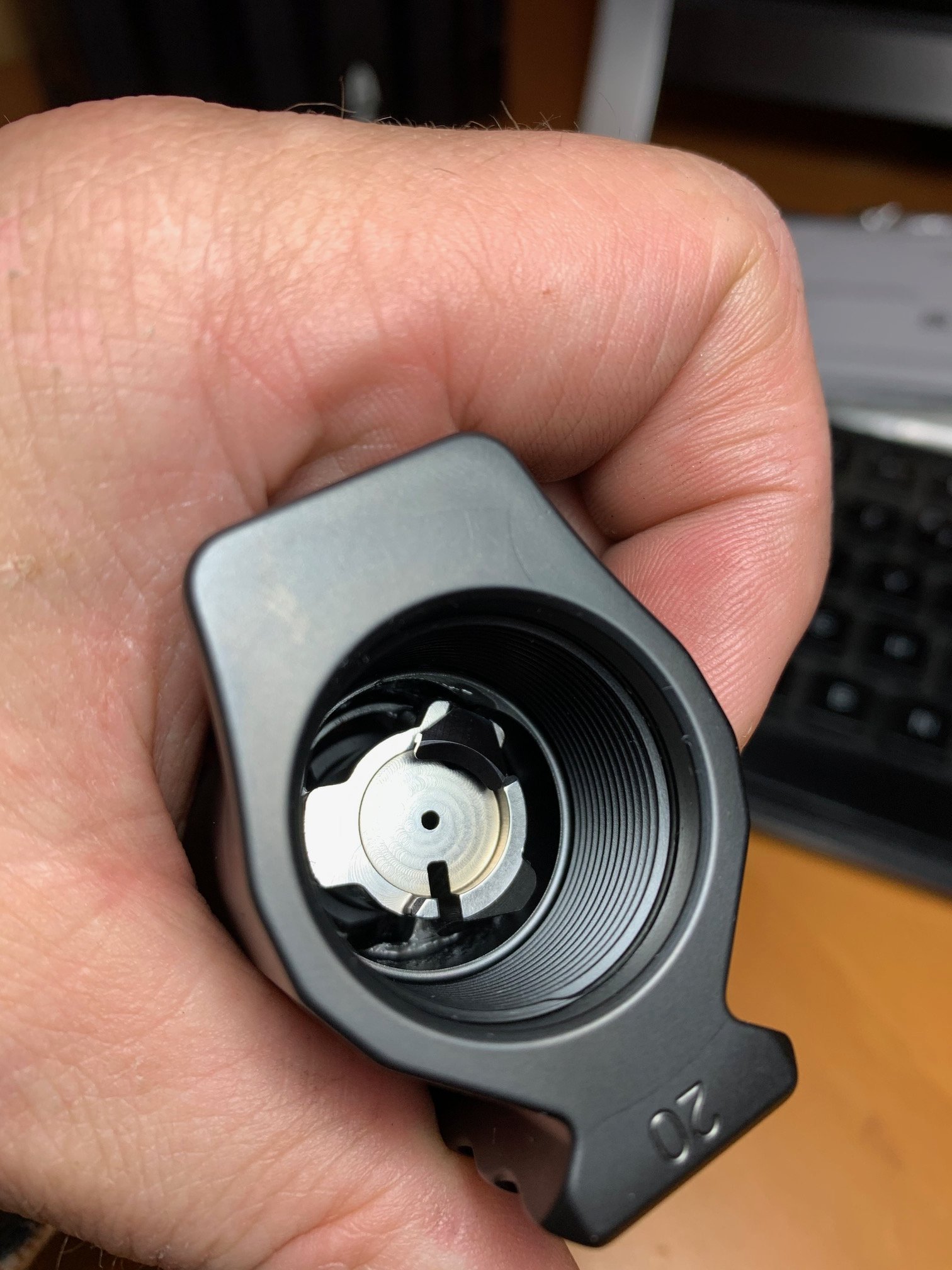

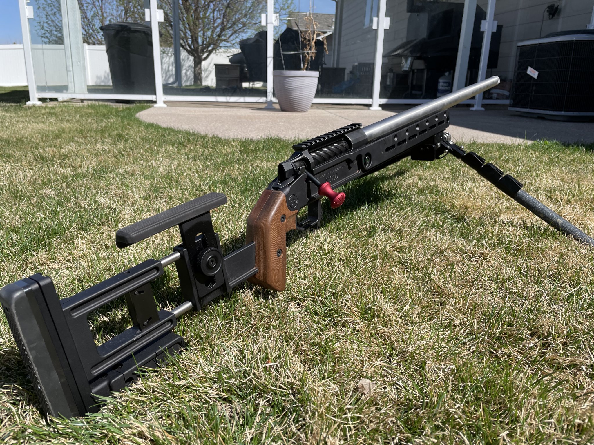

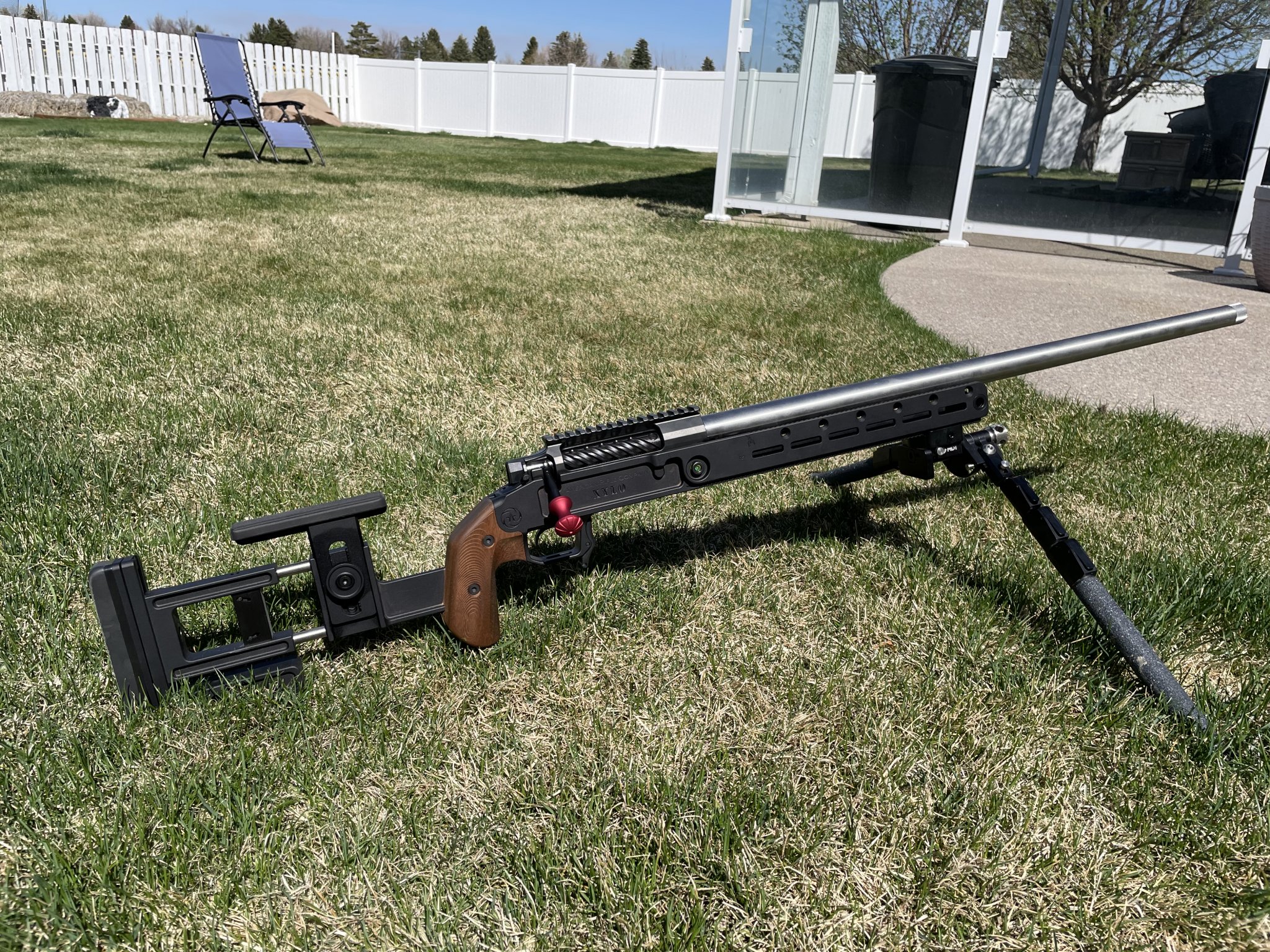

Here she is in the flesh. First impressions are - bolt cycles very smooth, nice lift also. Lift smoothness isn’t the smoothest I’ve felt, but the lift weight is very light for a 3 lug. Lift may smooth out over time.

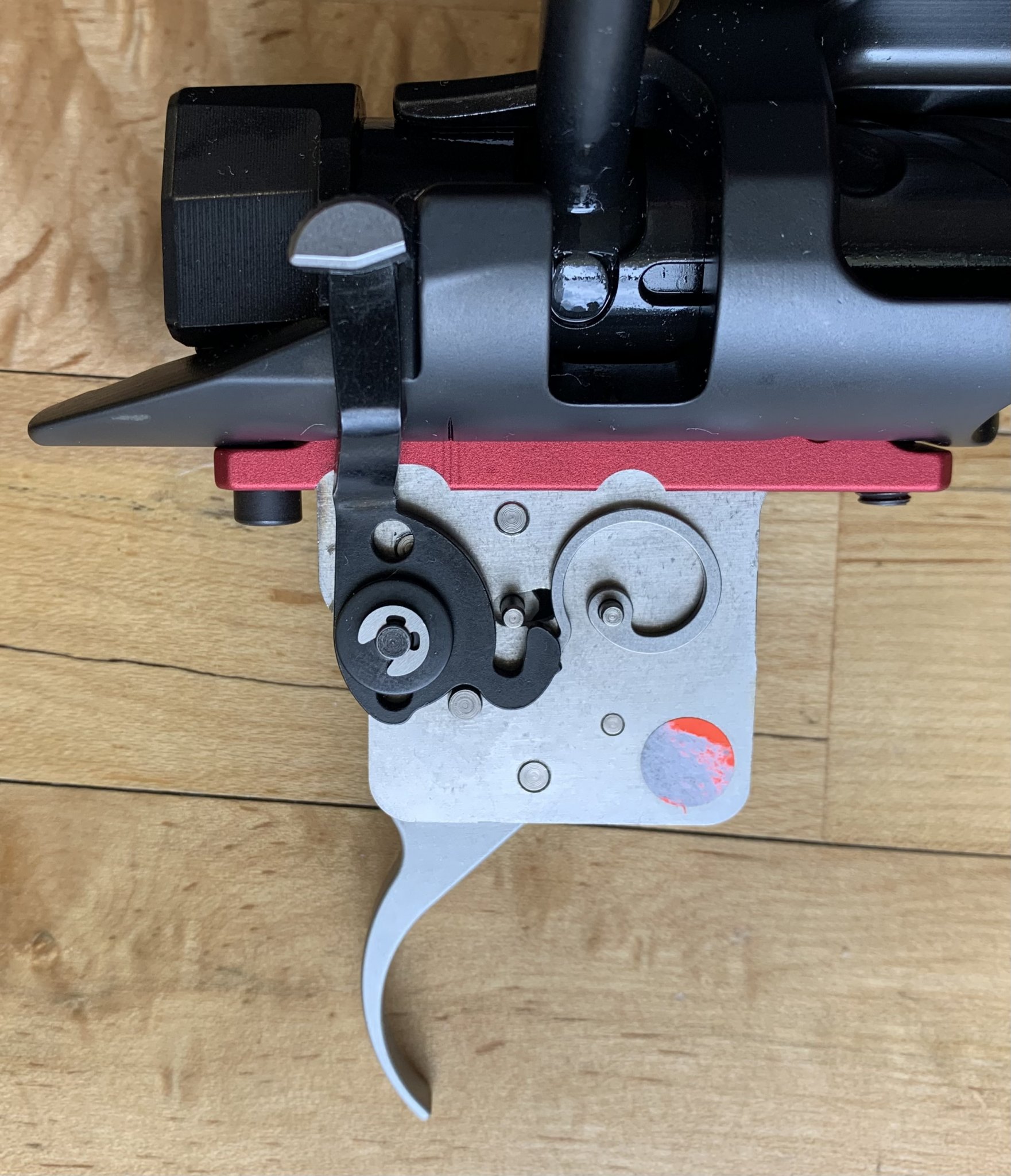

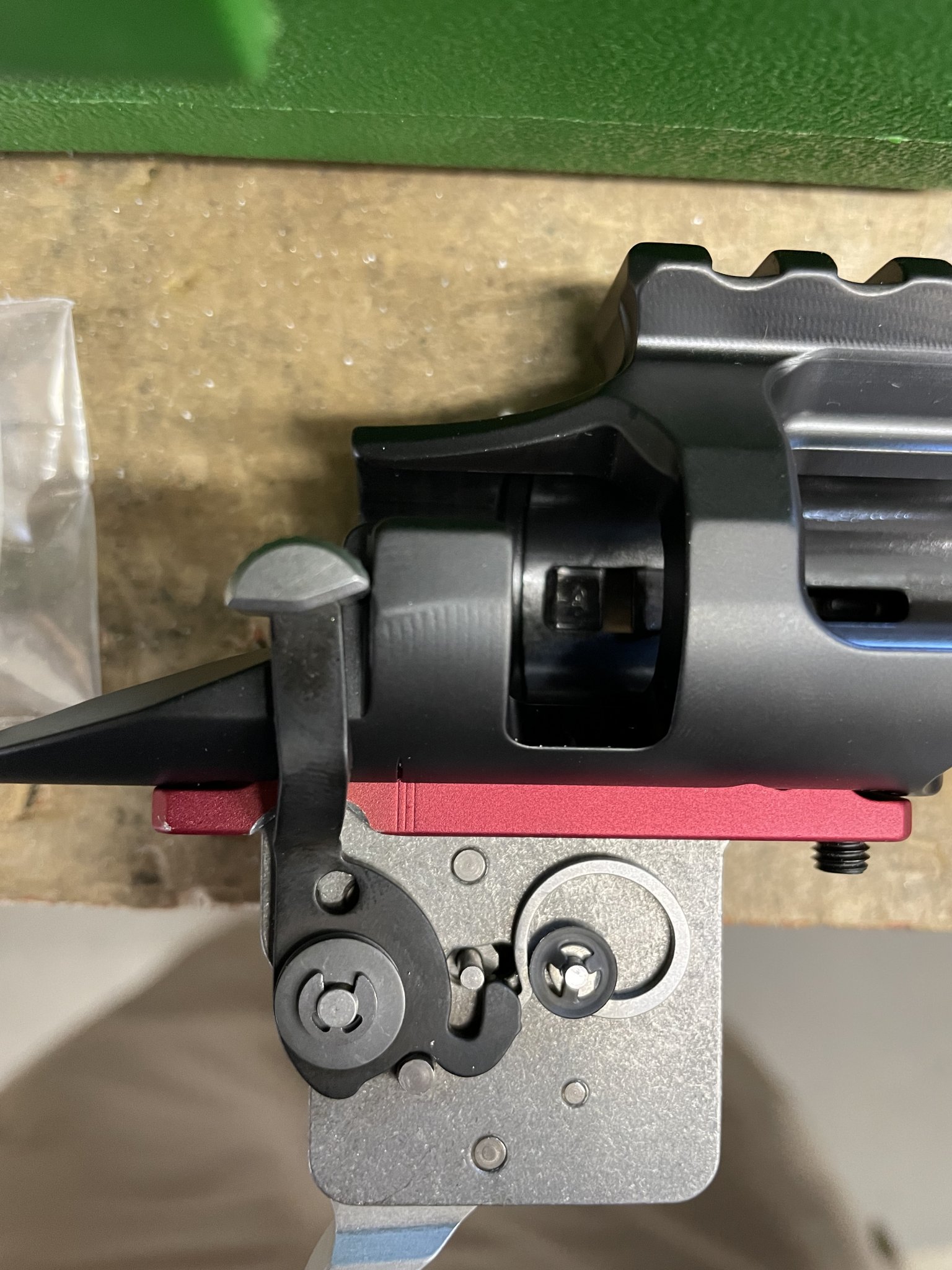

For the Bix n Andy guys - the tacsport didn’t work. The safety thumb button hits the action in the fire position, even with the trigger hanger all the way back. I ended up swapping the diamond off my night calling rifle and it seems to time up to the action really well out of the box. Haven’t had time to mess much with it yet but will more tonight.
AW mag mates up well in the xylo, have not tried feeding yet. This weekend hopefully I’ll send rounds down range.
EDIT to add details as I’ve had some questions: 26” M24 contour, cut rifled rock creek, in 6.5 creed.

Looks good buddy. Can't wait to shoot it and you will probably want to sell it in 6 months so just add it to my tab.

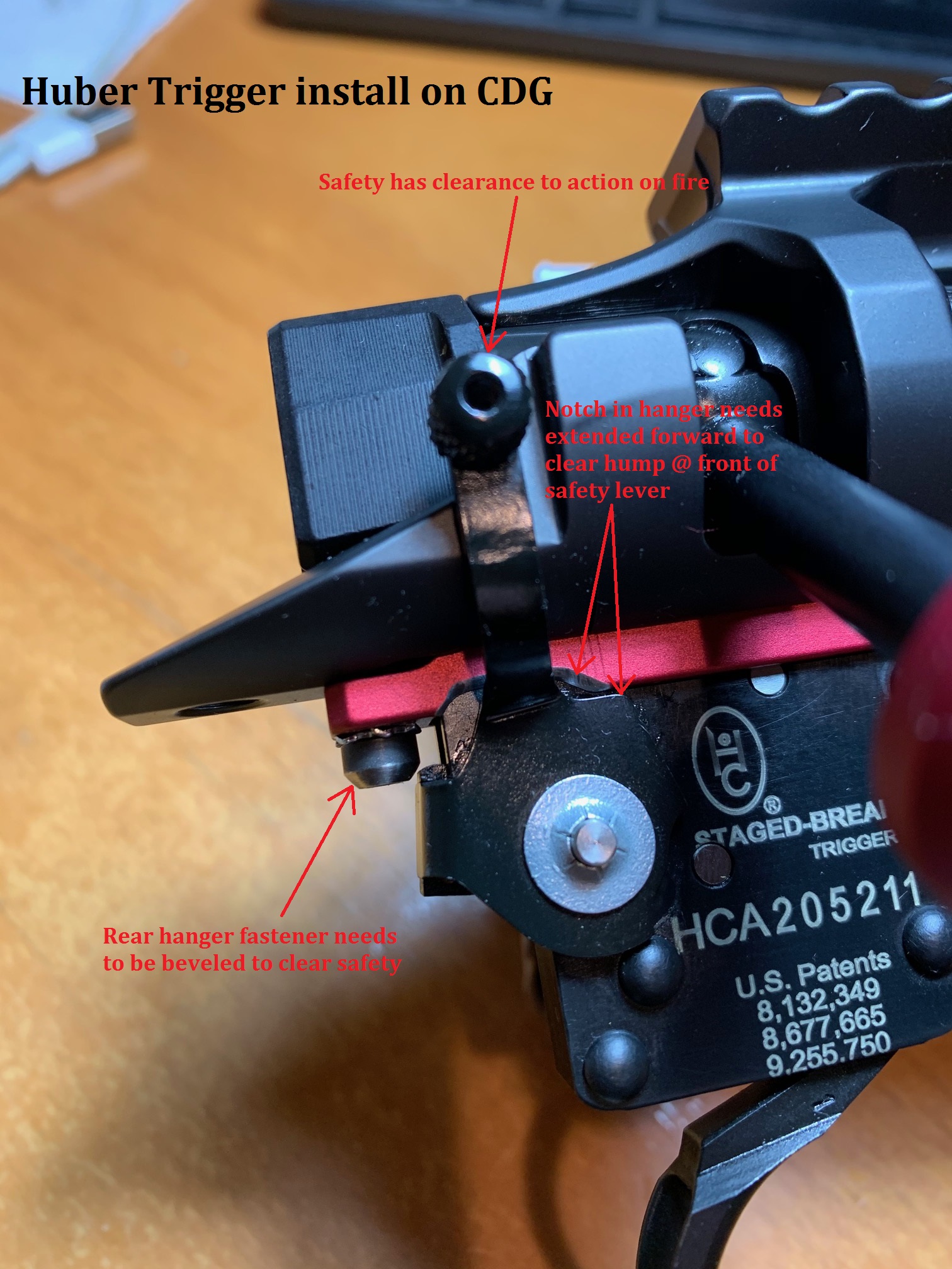

Easy fix if you want to use the Bix.
The cocking cam/cocking piece smoothness will come. Keep it lubed and use as notmal. Mine is absolute butter with 500 or so cycles.
No doubt, I did think of that, and I very well could go back to the bix but I’ll play with the diamond in it for now. I shouldn’t say it didn’t work, even slightly contacting the action with the safety, it did cock and function fine. Overall it’s a badass action, zero REGERTS

Barrel contour & length?
You ain't lying! May not be @Charger442, but they will be there in the classifieds.
Just remember, by that time, the introductory price will be long gone. The current retail price is gonna be the used price in 3 years.
Now that mine is in my hands, im 95% certain that this is the best value in remclones. The other 5% will come when I get to actually shoot it.

Did everyone who ordered a PVA prefit from the group buy get a 30cal break? I ordered a .257 barrel and got a 30cal jet blast. Not really upset about it because I could also put it on a 7mm build but I figured a 6.5 break would have made more sense.
After seeing the negligible performance loss with using an oversized bore break, I wouldn’t be too phased.
Somebody did an analysis of performance changes with various brake sizes for a fixed caliber. The conclusion matched your assertion, I just don’t recall where I read it.
Reactions: lash
I ordered a 22GT and got a 30 Cal brake. I was hoping for a 6mm but it is what it is.
When PVA was getting ready to ship my barrel they called to verify if I wanted stainless or black as far as the brake. I told them I was planning to buy a 6.5 barrel from them in the future (this barrel was 223) and could they send a 6.5 brake (so I could use the freebee on that as 223 doesn't really need one) they told me in testing a 30cal brake on a 6.5 there was only a 3 percent loss in recoil reduction so I said go ahead and send the .30
It might have just been an oversight in the flurry to pack and ship the barrels. It might have been lack of stock for nitrided brakes. The nitride crate was slow in returning.
Performance-wise the difference is barely measurable on a sled and not something you can feel in a blind test.
If you want to switch it, send it back with a note for a 65. We have black nitride 65’s in stock, they arrived from Nitride today.
6mm brakes need a lot more cleaning, you want a 65 brake. As above, if you want to switch it, send it back with a note.
View attachment 8133225View attachment 8133226View attachment 8133227View attachment 8133228View attachment 8133229

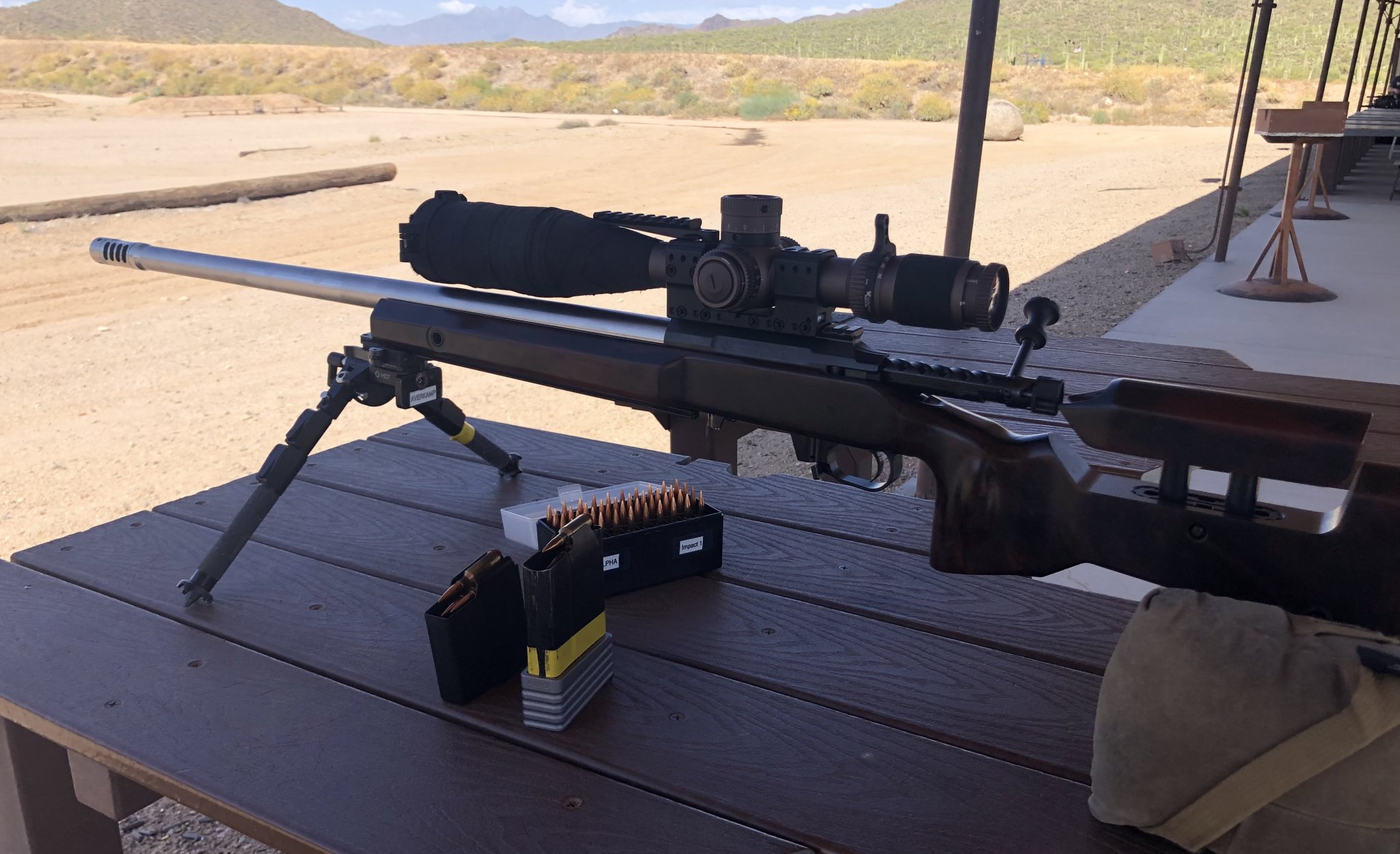

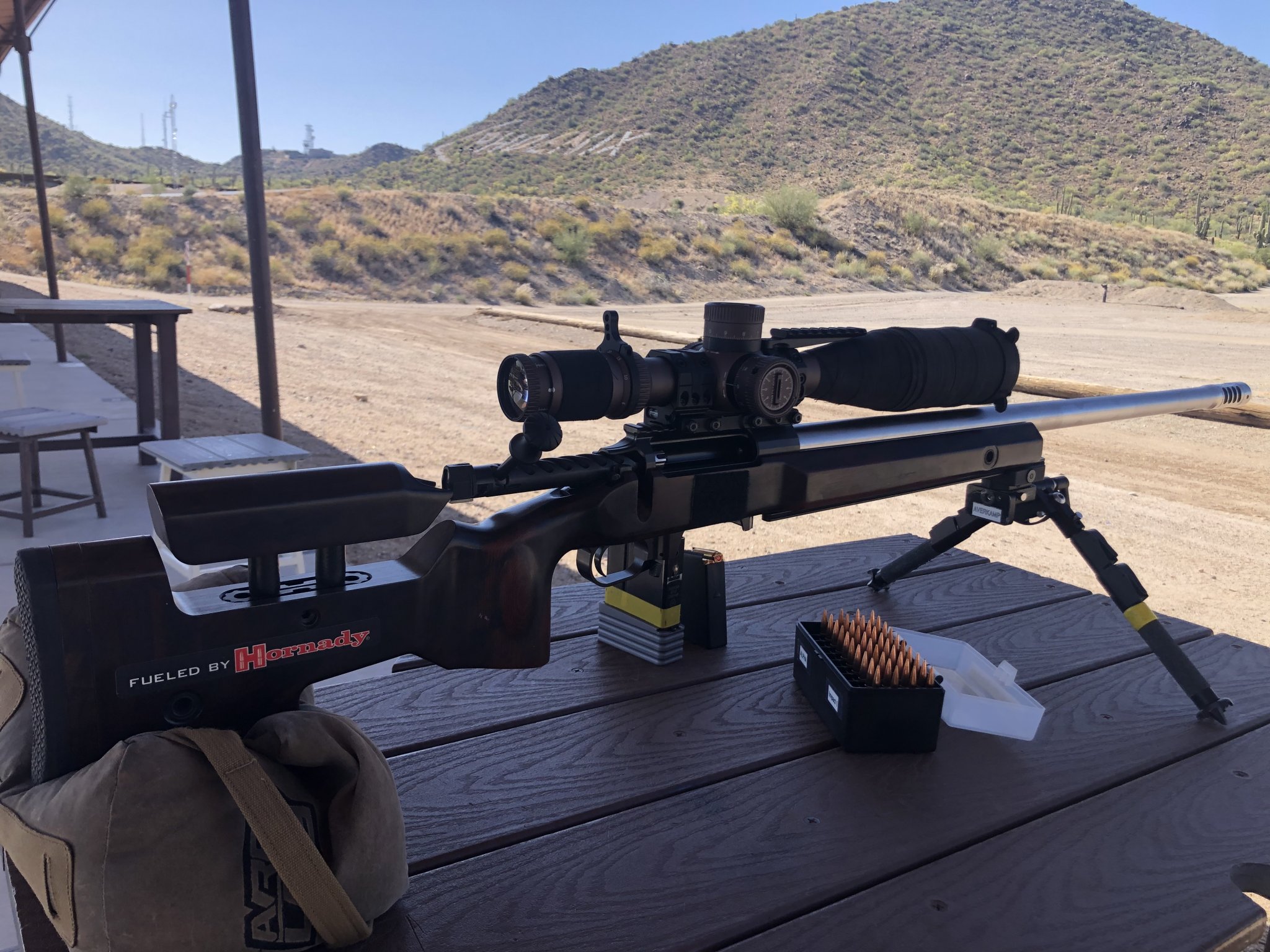

Picked up my CDG from my FFL late this morning. Was hoping it’d drop in a Centurion that had a TL3 in it, plan B was a MPA I had laying around. The Foundation only needed a bit of clearance at the rear of the trigger hanger & bolt release. I also opened it up for the massive ejection port. Fits like a glove.👍
Then proceeded to spin on the PVA Osprey in 6GT that was waiting in the barrel vise,..head spaced perfect. Kudos @bohem !
(for those wondering, the action wrench glides in without dicking with the bolt release)
As to some of the speculation going around, I run TT Diamonds light..4-6oz, and had a concern because the fixed handle I ordered, didn’t make the trip. I put my spare in it and ran it as hard I could & drop tested it, and couldn’t get it to fail. Turned it down as low as it would go (2.8oz), same thing, no issues. I only tried the one trigger, but I’m betting Ted’s disclaimer is for liability, ymmv.
Also, it feeds AW and my ARC with 419 12rd extensions like butter. Didn’t do a thing to the mag release.
I had a couple of hours and hit the range with 50rds of old ammo for break-in. (I’ve used Josh’s recommended procedure for my last couple of barrels with good results)
Conditions (gusting to 32mph) sucked and is unusual for Rio, but after a quick zero, the 12” diamond at 560, didn’t stand a chance. Can’t wait to dial this in!
While this is my first ARC action and Ted’s naming of shit is weird (which I dig weird ),.. @karagias might have gotten it right.
This thing is sick at that price point!
If anybody’s at Raton the following Friday that’s ’on the fence’, DM me if you want to test drive…

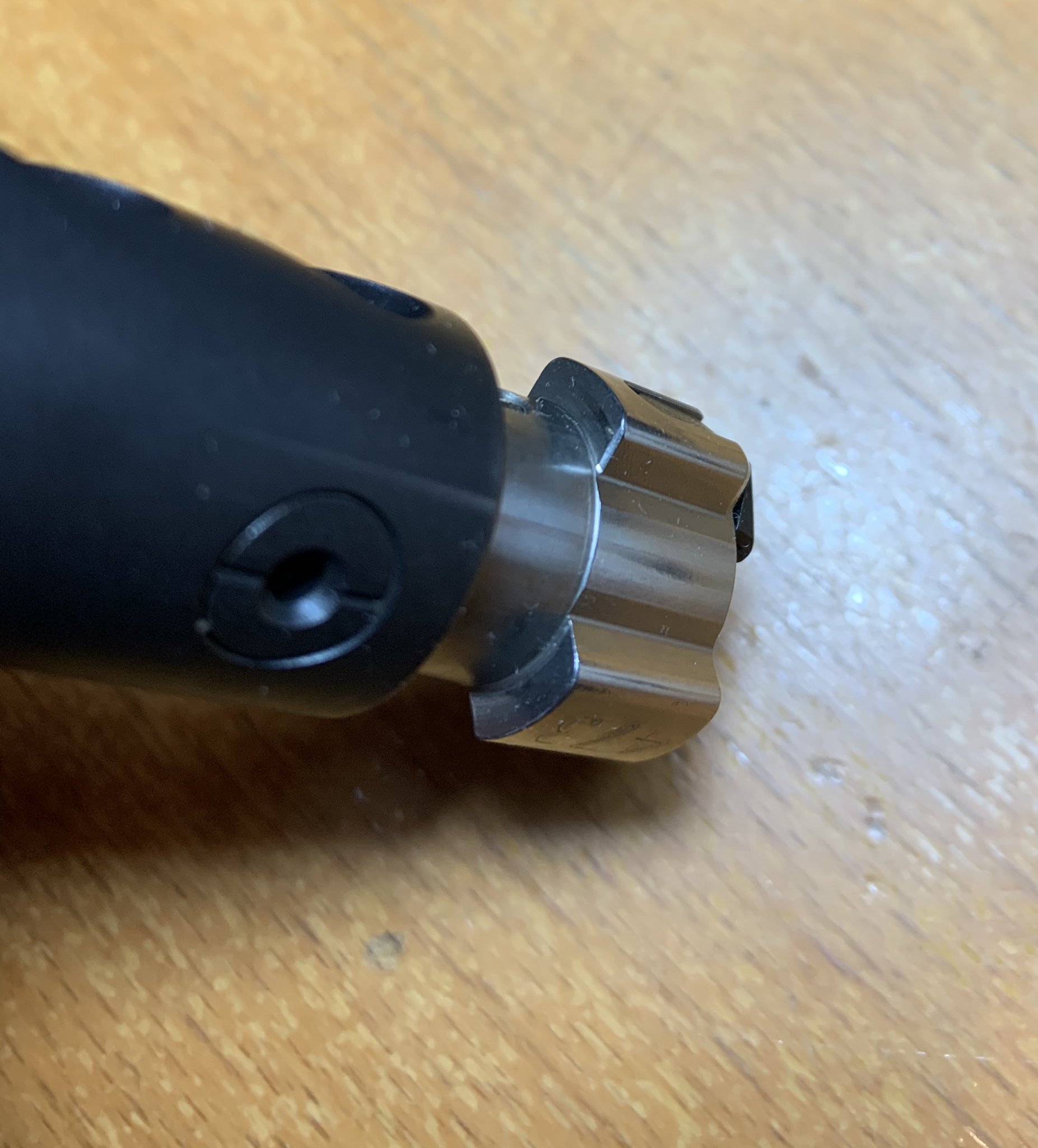

Do you have any close up pictures of the action and bolt? The CDG will be my fifth ARC action, but I’m going to be honest here, I’m not impressed with the machining marks on Supersubes and Browning442s actions. I haven’t seen anything like it on my other actions. It seems like they are trying to get them out the door so fast they are sacrificing their normal quality and quality control.
Edit. It was pointed out that my use of QC was incorrect and what I was really talking about was finish.
I'm right there with you. I'd rather wait another week or two and have the QC higher.
But got my ship notification as well. So hopefully by tomorrow I'll have it in hand and post some pics of the bolt face.
Reactions: Tokay444
I don't know if anyone from ARC is keeping an eye on this thread?
Common theme is that the trigger hanger needs to be notched. I would also suggest switching the rear trigger hanger screw to a button head for clearance on some triggers.
Here is mods with a Huber installed.

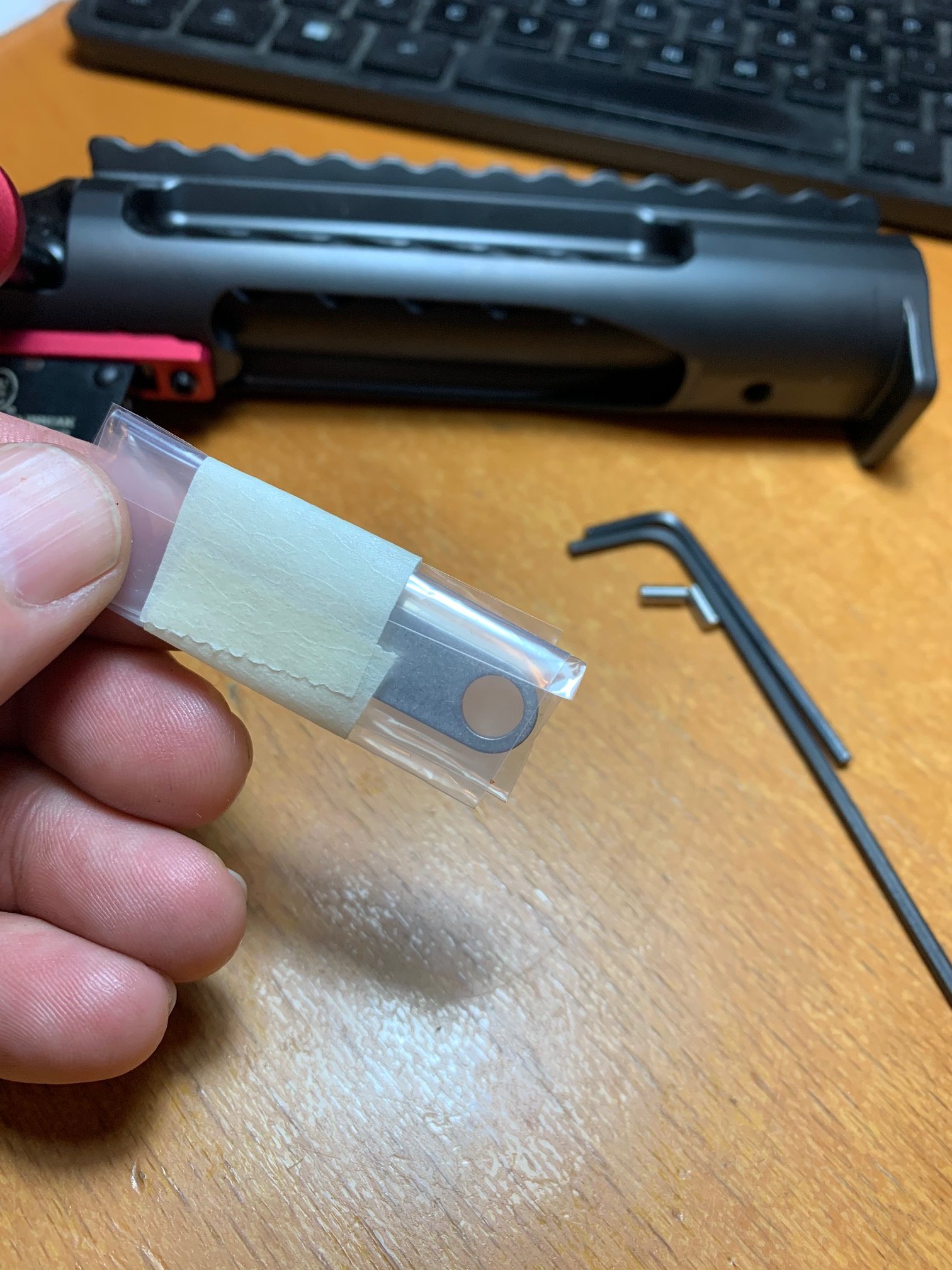

Didn't see anyone mention this yet. Included with the action was this little tab. I'm assuming this is for the front AICS mag stop if needed. Don't throw it out.
I'll admit, it looked like Supersubes dog did a number on the bolt face in the picture. The reflection on the silver bolt really make it look much worse in a photo than it does in hand. Rest easy, I seriously doubt you'll be disappointed.
Can you see some tooling marks, yes. I can also see that every edge has a radius.
What I don't know is if that bolt face was final face machined in the hardened state?? If so, I think it'd be damn hard to get a mirror finish. Every surface that needs to be smooth is, such as back of lugs.
I am not at all disappointed. The machining is Stellar. The whole action has kind of a melded look unlike any of the other ARC actions & I have them all.
For perspective look at my fingerprints compared to the tooling path marks on the bolt face. Now look at your own fingerprints. Also notice how incredibly clean the tenon threads are along with the really nice tenon thread start @ 12:00 on the action.
You won't find a tooling mark on the back of the lugs where it needs to be smooth. and again notice every single edge is machined with a radius & or edge broken with a bevel.
@357Max I agree the shine of the silver may make it look worse than it is. The extractors on my bolts show some machine marks, but are to a much lesser degree. I’ve not seen machining marks on the action like seen in the ones mentioned above.
