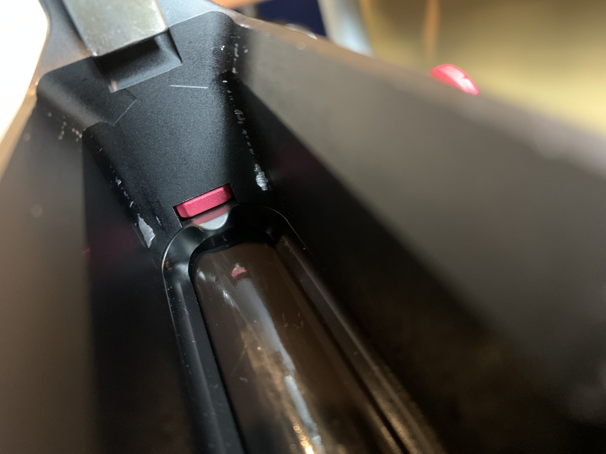

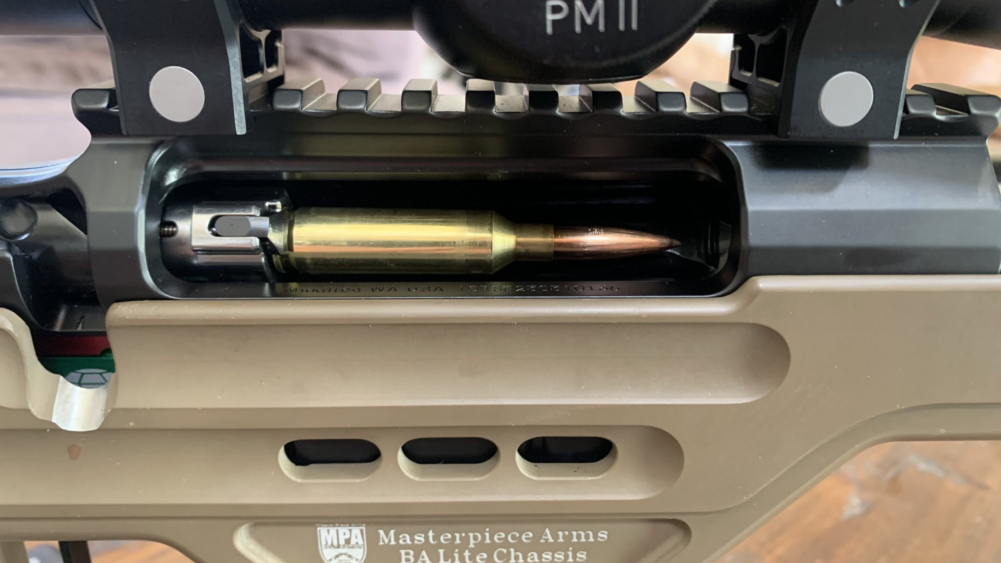

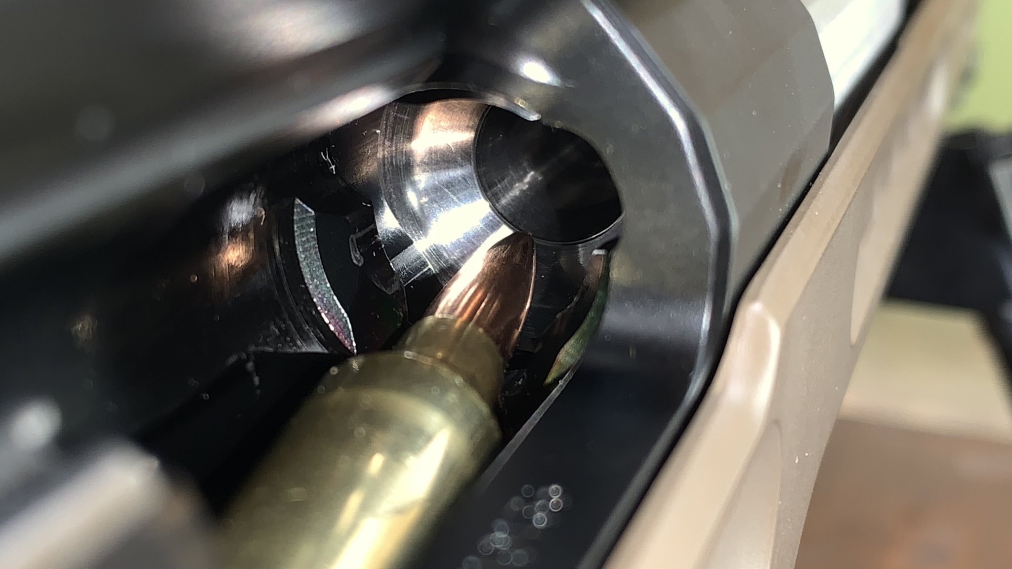

The length is deceiving, as the bolt still protrudes into the port. Its very tall though, which will help with the single feeding for sure, as you mentioned. The large bolt diameter add’s to that as well.
Additionally, for all the folks that are new to AW mags, they’ll be able to top load the mag through the port, even if they have sausage fingers.
Here’s a pic for reference. This is a 2.810 oal 6cm.

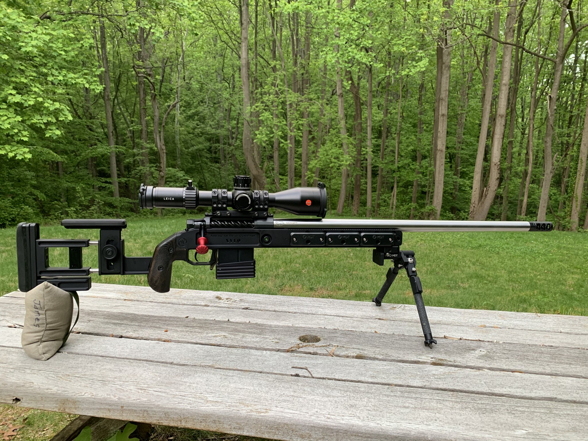

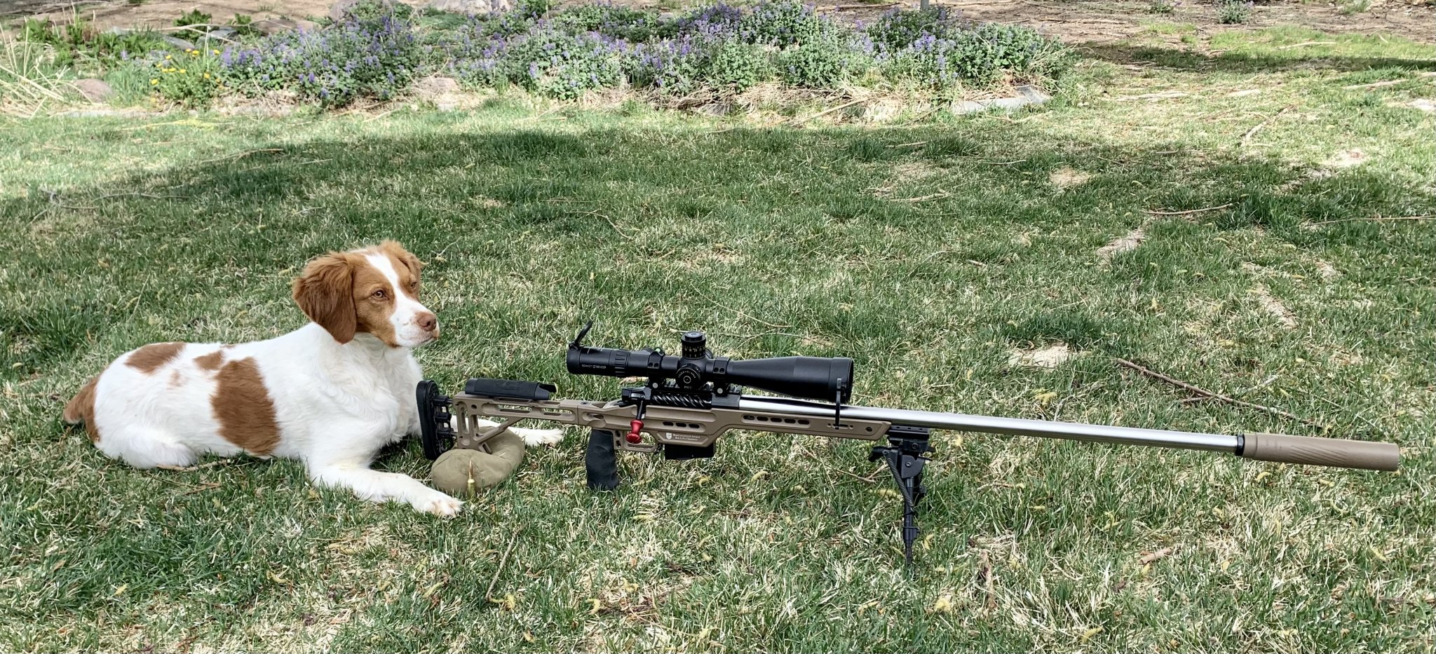

Finally got around to spinning a barrel for the Coup. Its a bartlein 5r 6mm 7t, in a bastard contour similar to a Heavy Palma. Chambered in 6cm, and finished at 27.5”. The rest of the parts are basically place holders.
Very nice.
Also really like the Brittany (it is a Brittany, right?). American (looks like ti from the snout) or French?
I've been considering getting one of the French ones (Epagneul Breton)...bit shorter and more calm as they weren't bred for horse back field trials or so I have been led to believe. And they don't care about color conformity and neither do I.

Yes, american. I have his older half sister also, she’s liver colored. My first bird dogs, and they're great all around.
That ejection port is HYUGE! Kinda unnecessary. Figure they'd want a lil more material in the action for rigidity reasons. Maybe it was for weight? That phatass bolt looks good, and all it's momentum prob really makes it feel smooth and effortless.
We found the next thing now that the bolt nose marks have been debunked.

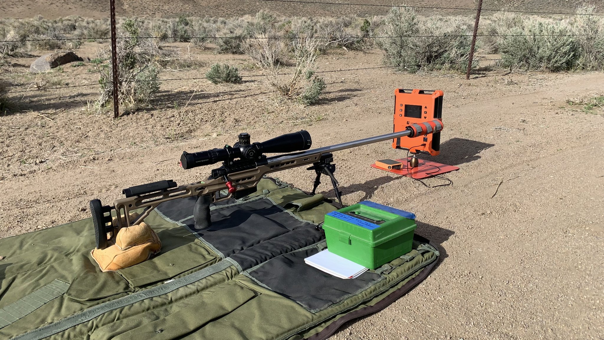

She shoots, boys!

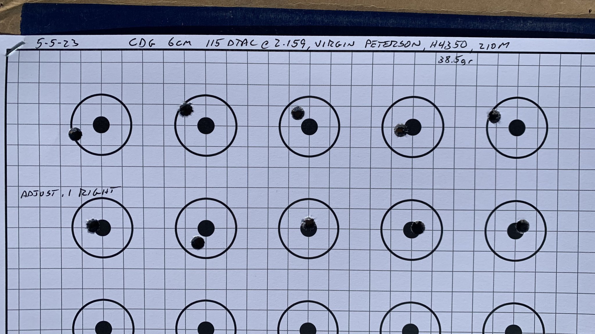

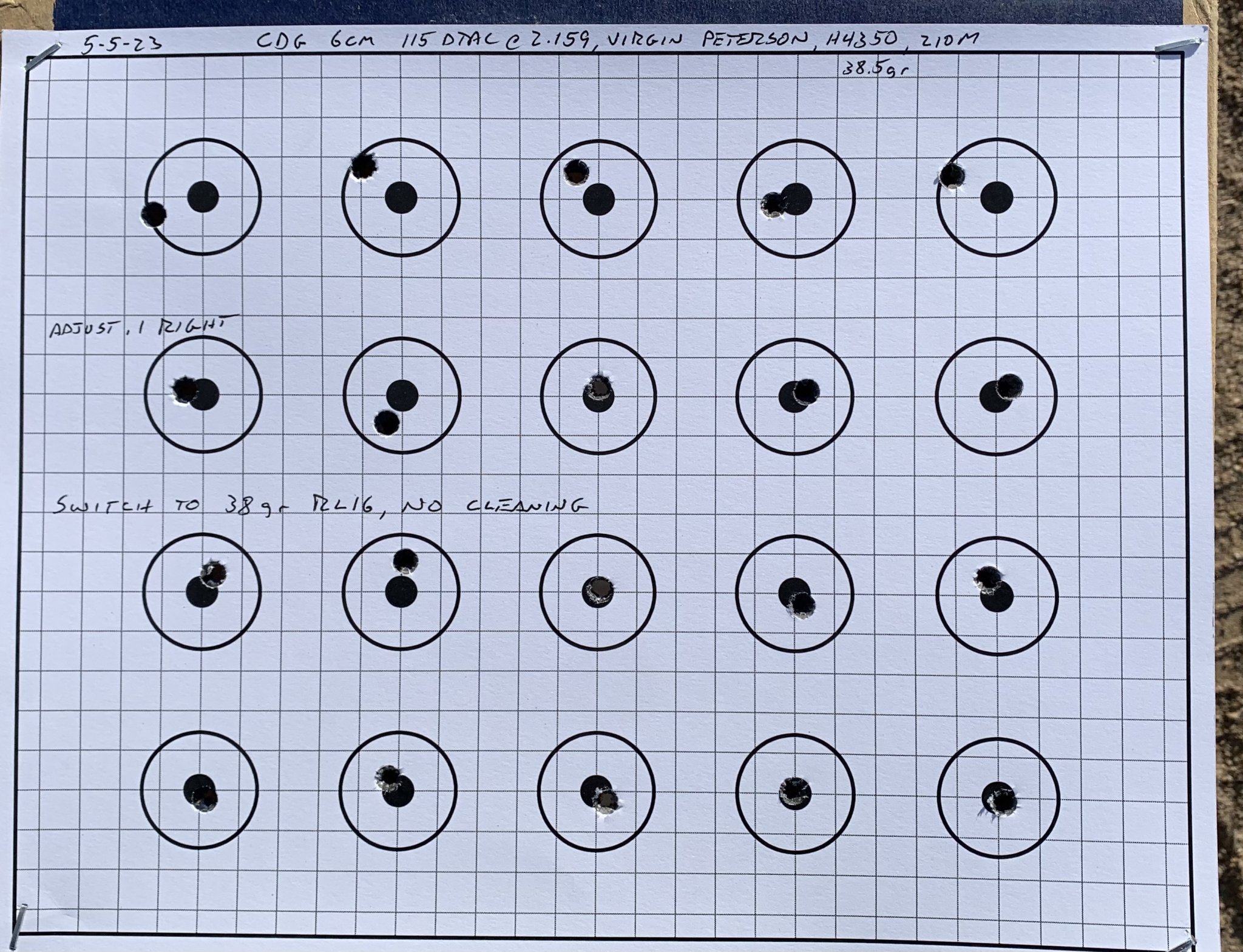

First 14 rounds down the barrel.
Three rounds from a boresight, adjust, and one to confirm.
5 rds, adjust .1 right, and another 5 rds.
View attachment 8135502View attachment 8135503
Running a TT two-stage at 13 oz. Gun functions beautifully!
I assume 13oz is the combined weight on the trigger. What are your first stage second stage weights set at? I have heard some people are setting the first stage heavier than the second which at first seemed backward, but I'm going to try it.
Yes, total weight. Not sure what the first stage is, but id estimate its about half the total weight.

I'm not saying the ejection port is a bad thing, just lil out the norm. I had a nuc g2, and current an Archimedes and I'm a huge fan. I'm excited about the pair I have on order, hopefully they ship soon! I'll be getting heavy comp Hawkhill pipes spun in 65cm, 25cm and 6gt for one action, the other is being built into a loaner rig in 65cm for new shooters to run in our local WPR matches.

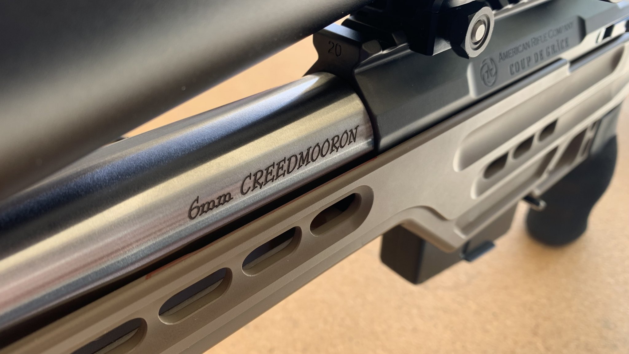

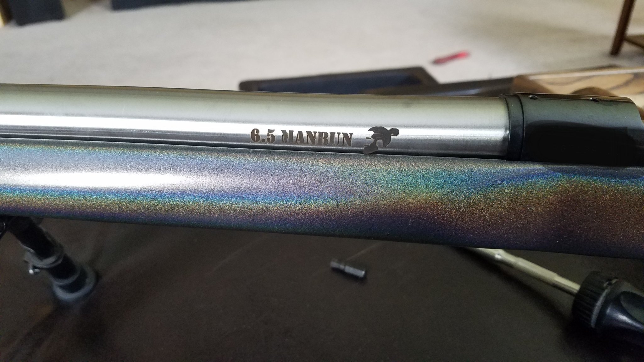

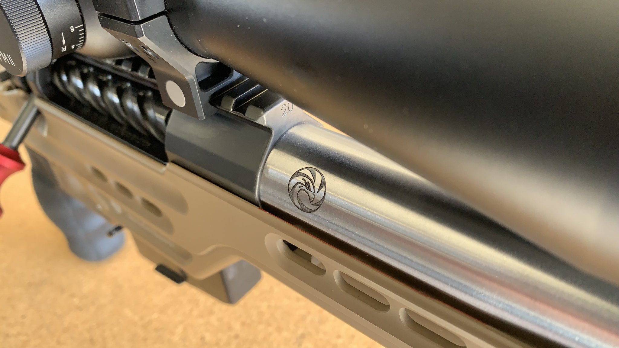

Rifling logos can only be done so many ways.
Correct, but rifling logos that have been laser engraved with LH gain twist have been proven to be the most accurate and most forgiving when it comes to load development... Frank said so.
Supersubes logo has RH rifling, which may explain a couple of those flyers in the target pictures he posted.
On a more serious note, his picture of the brass in the chamber is a perfect example of a fully supported case head even with the conical breech face cut to help with feeding. That should alleviate some of the concerns people had about the conical breech face possibly leaving some of the case head unsupported many pages back.

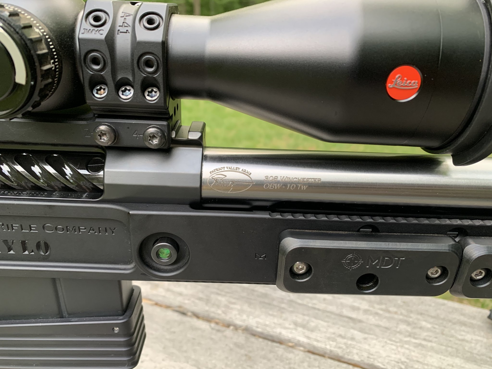

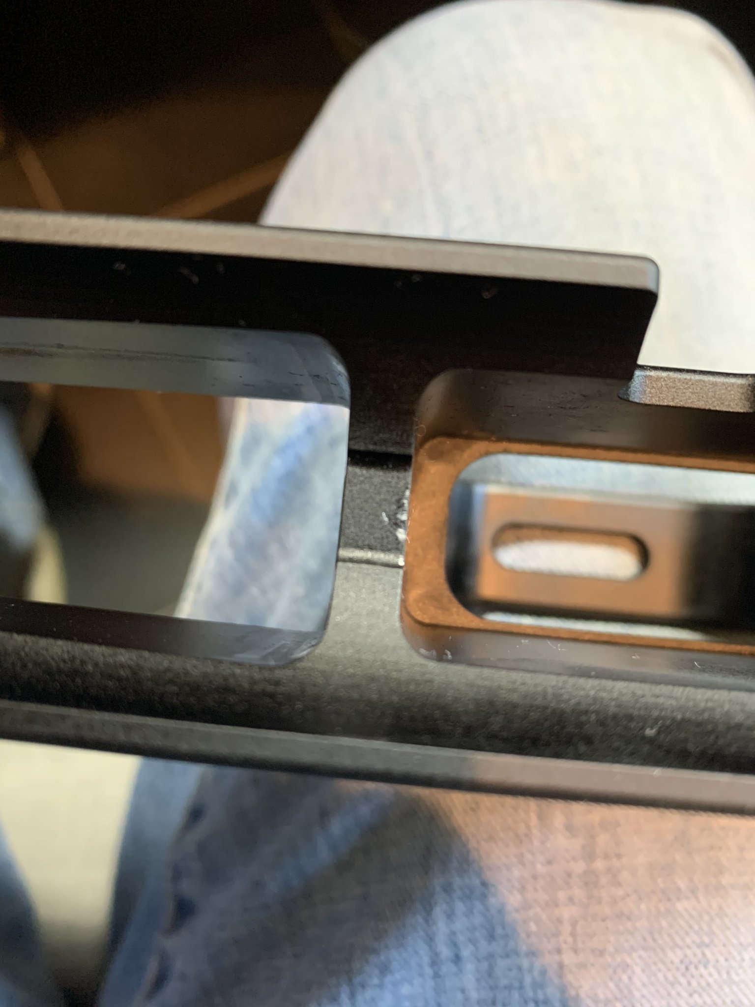

Ok I want to know how the hell @browning442 was able to drop the CDG into the Xylo???? Can you post a picture of the inlet on yours please.
Maybe his is a newer Xylo & Ted’s made inlet changes?
Mine is an older Xylo so heads up for anyone with an older version. It needs a considerable relief cut to clear the trigger hanger.

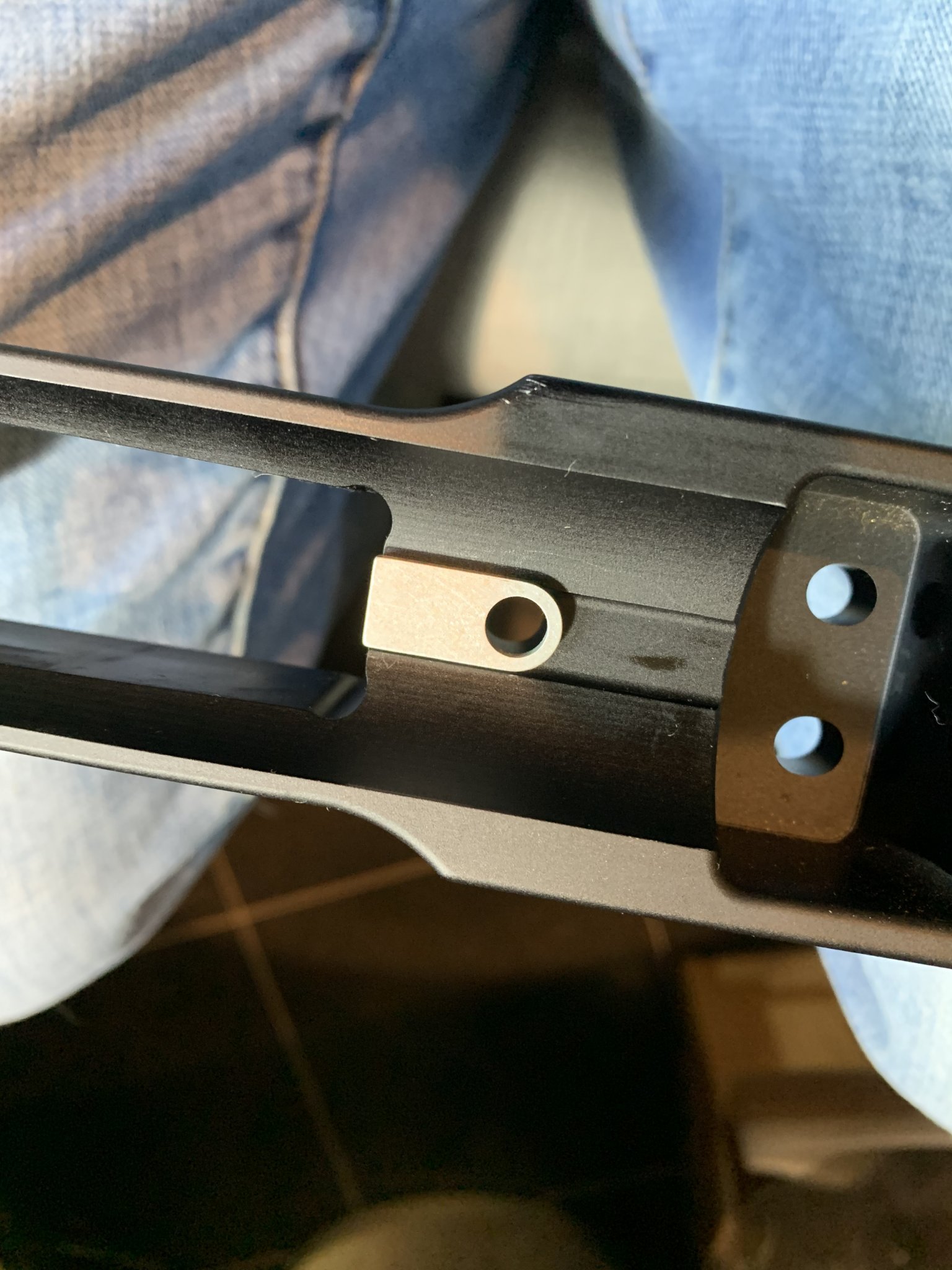

Also the AICS tab (included with action) is not a drop in for the older Xylo. It would require milling the slit deeper & wider in the chassis.

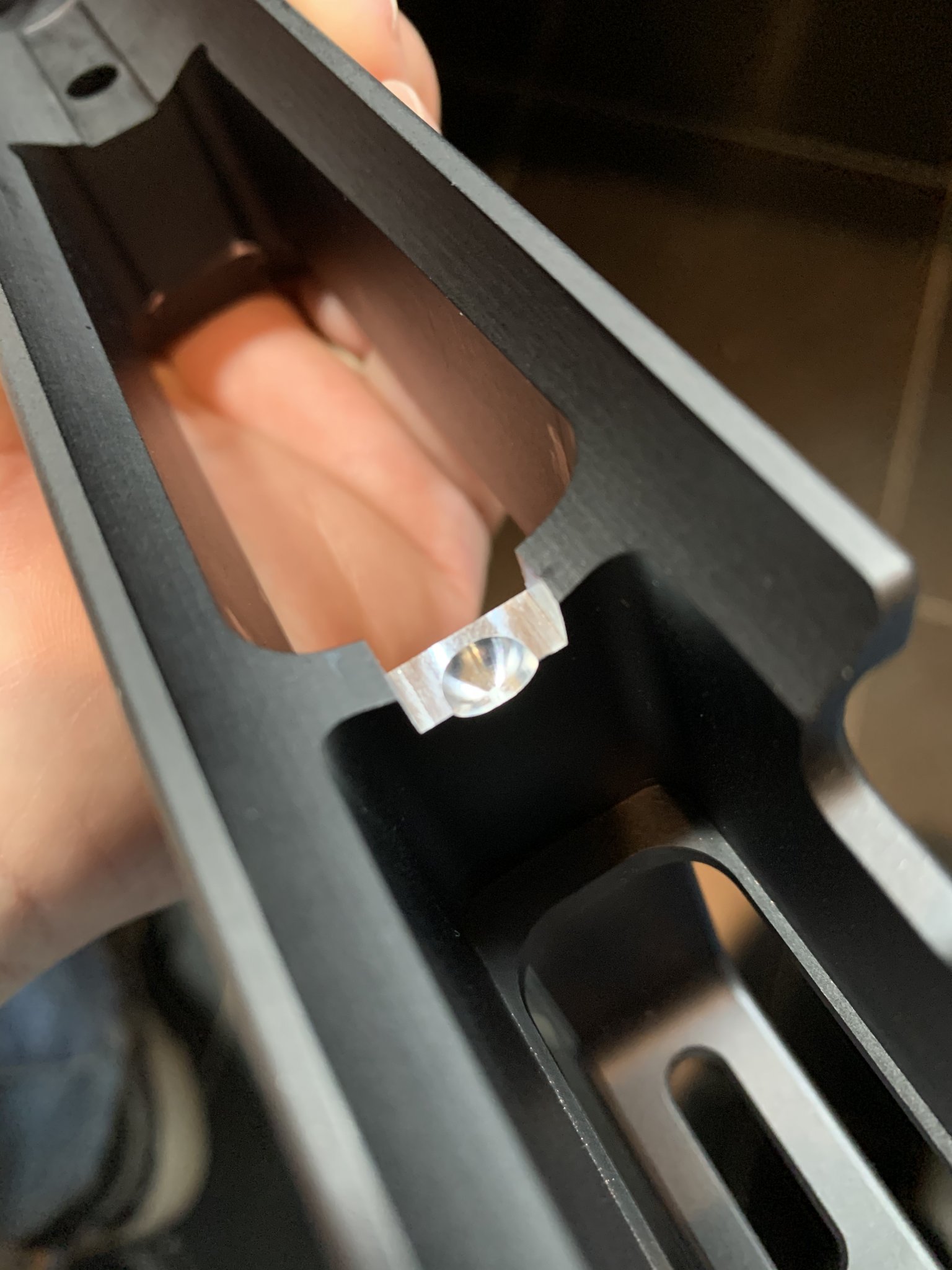

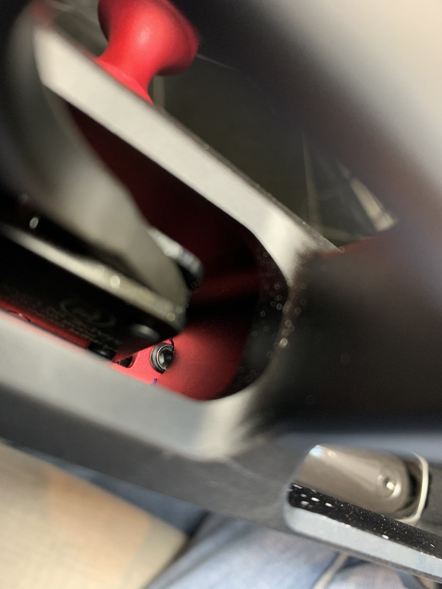

Here is what my unmodified inlet looks like. I’m running AW’s, but will show the tab for Anyone that may need to fit it.
Here is the main offender at front of trigger pocket. Back of action was about .175” high at rear action screw.
This is the minimum mod required. And shown installed. Not much room to spare with that cut.
Here’s the finished rifle. Probably won’t get any rounds down range till next weekend, but it feeds 14 308’s from the AW perfectly. I can load the mag through the huge port or just throw a round on top of the AW and feeds singles like butter. Beveled the back of the AW follower so it doesn’t act as a bolt stop.
If you are talking the two threaded holes for cap screws at the front of the mag well I have those.
Yeah mine doesn’t have those threaded holes.

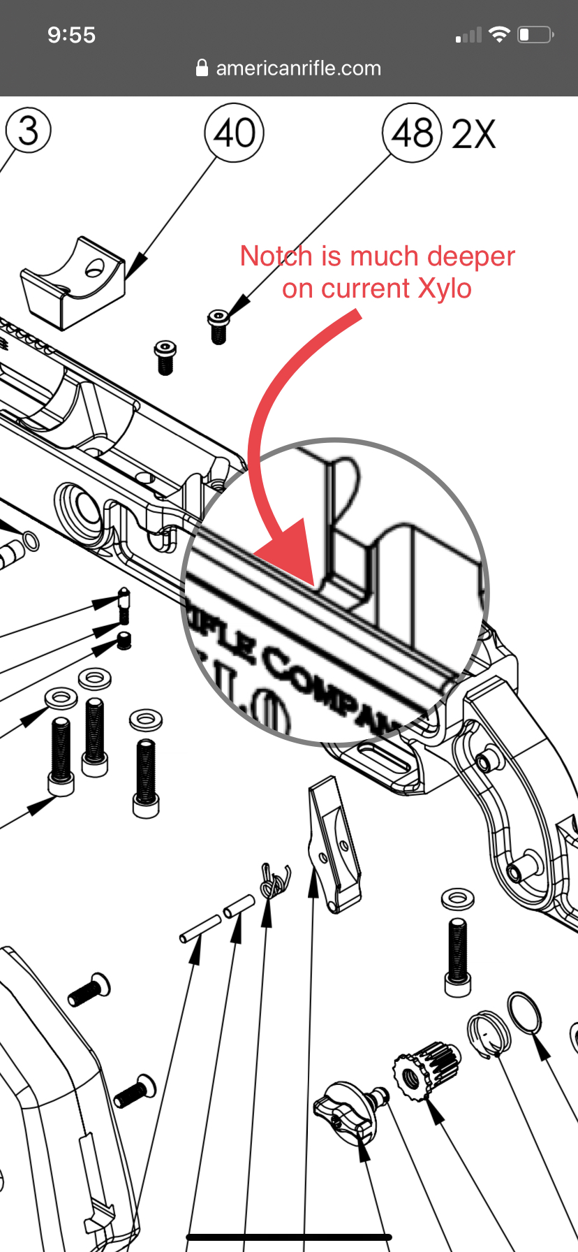

Per the current Xylo drawing, it appears to be notched much deeper @ the shelf for trigger hanger clearance.
The date on this drawing is 6/19/2020.
Mine must have been made just prior to this update.
